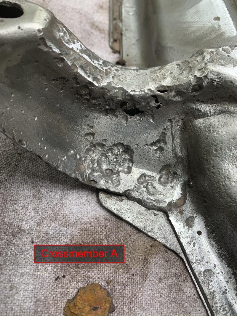

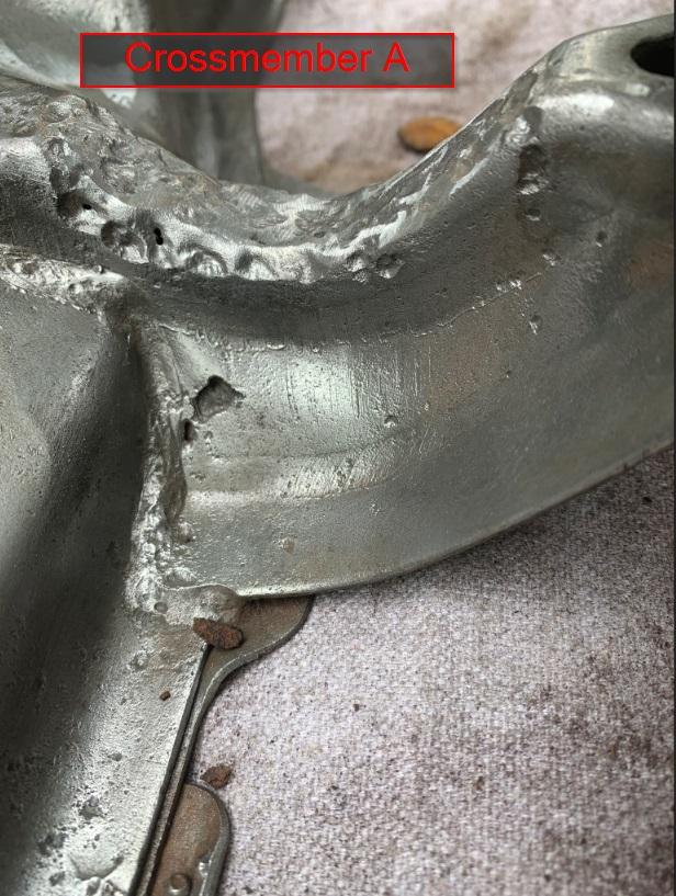

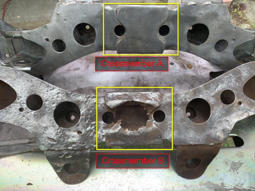

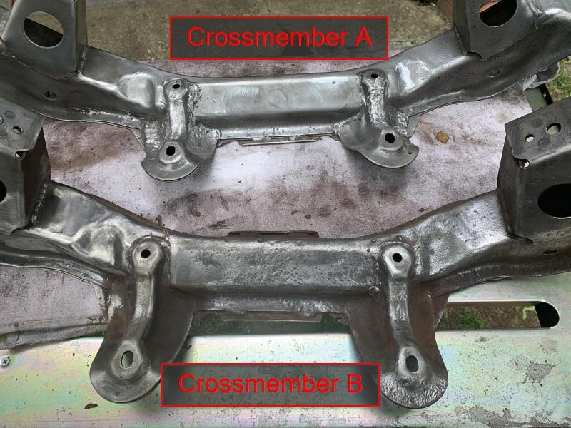

I ran into a problem and I do not know what the best solution is.   I have two different cross members and I am not sure which is the right one (easier) to repair.  Cross member A has a better under side.  Cross member B has a better top side.  In the close up's you can see the damage to A.  I am assuming that I should take the bottom of A and somehow weld it on B. Is that the right approach?  Should I cut and replace the section where I drew the yellow boxes?  How would I separate the bottom of the crossmember from the top section.  It looks like there are two pieces welded together.
@gotham22
Strictly my opinion.
I would work with crossmember A
Crossmember B has a lot more pitting across the width of it both top and bottom. For dealing with the steering rack horns...
Well several options. You could fill in the pitting on the horns. the metal fairly thick and shouldn't be as hard a filling in thinner metal.
You could even make a piece to back it up with inside the horn from the bottom for a little more beef
Possibly the cleanest repair would be to sacrifice cm "B" and cut the horns off of it and weld them on cm "A". This requires ALOT of good measurements and you really need GOOD welding skills. I weld pretty well but I'm not sure I would trust myself to do those welds. You could however get them removed and cm "A" cleaned up and ready. Then tack them in the exact proper place and have a professional welder finish them for you. Let me know, through PM if necessary, if you plan to go this route and I can give you some pointers
thanks Patcon/Grannyknot.  After consideration I think I am going to try to repair A as it is overall in better shape.  If I can't get that to work then I have plan B, literally! Your advice is greatly appreciated.  Will update the post once I begin work.

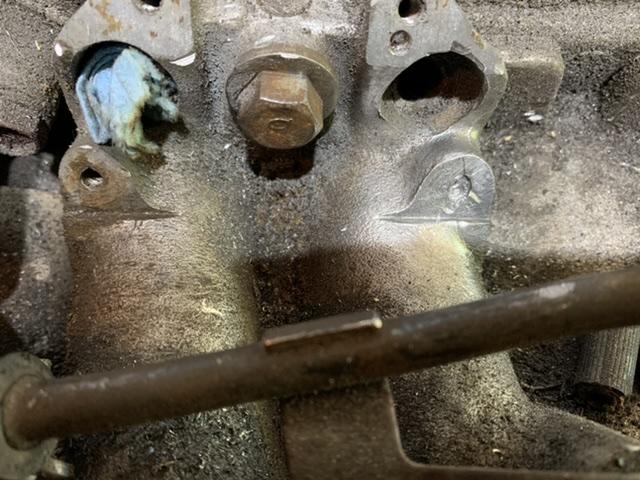

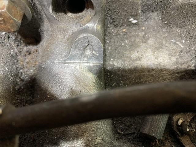

I was removing the fuel rail and I ran into 4 tough screws towards the front of the engine.  This one screw snapped and had I had nothing to grab. I tried a screw extractor which did nothing.  As you can see I am just making the problem worse. Any ideas?
