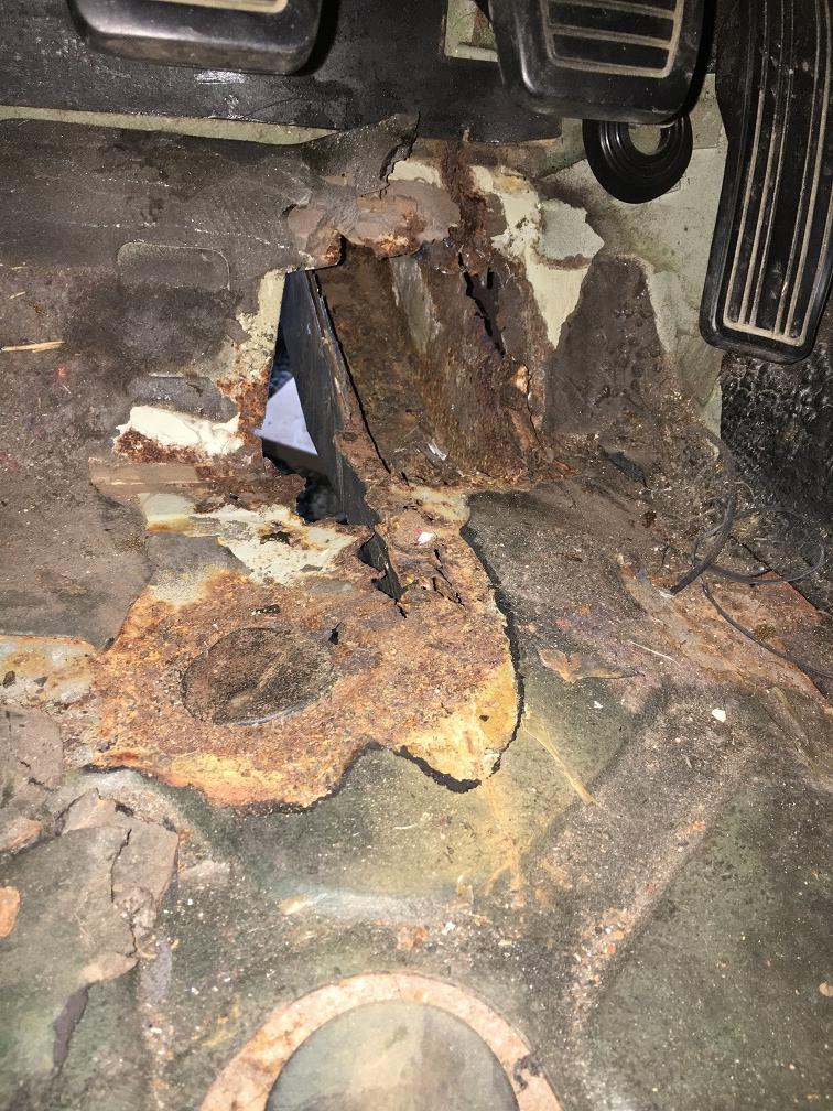

Cancer is right, you will want to fix that section completely before moving to the next area so as not to weaken any part of the unibody too much. Looks good
Wouldn't be bad idea to weld on some temporary cross members before chopping commenced.
Consider it after market cross ventilation?.  At least you had more floorboard than hole.  Repairs ON!

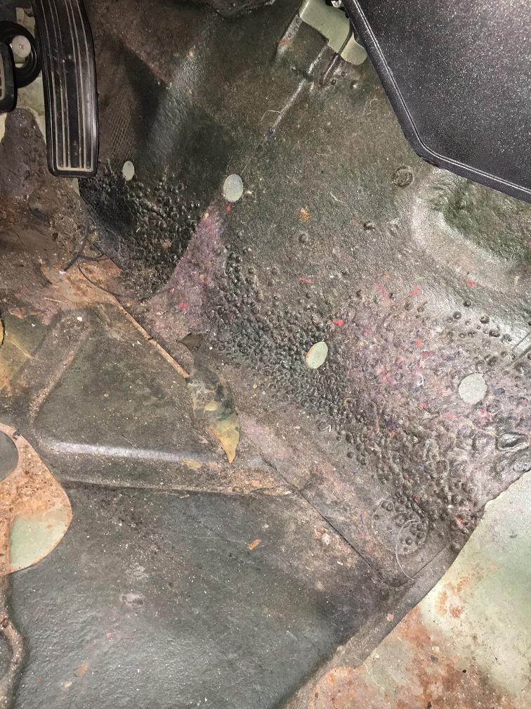

On the tunnel, that looks like typical factory sound deadening/ insulation, a tar like coating.  I've heard dry ice and a scraper work well to remove it.

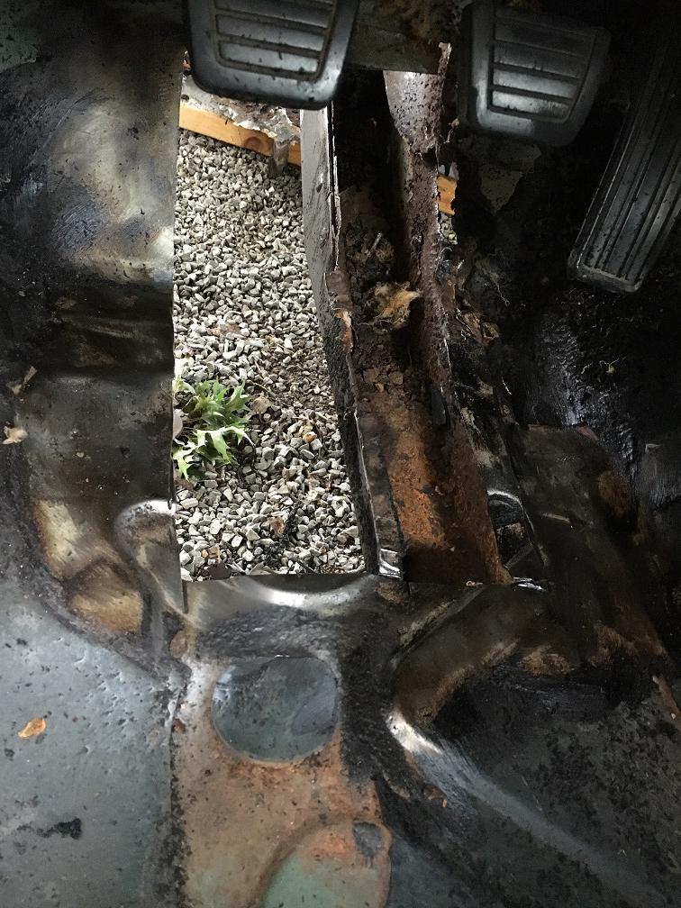

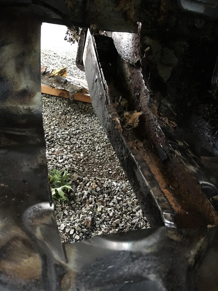

I would start by removing the pedal box, console, steering wheel ... then all the stock sound deadening and any fiber glass that was added so you can clearly see  where the rust starts.  Cutting the rust out of the floor pan first allows you to keep the rigidity of the frame rail until the floor is repaired, the rail under the floor pan is pretty easy to remove but if you can save the angled part of the rail that is visible in your pic then do so. That part of the frame is complicated and difficult to replicate as it ties together several areas.
Ideally the car would be stripped to the shell and you would be in a shop with a proper frame jig that would prevent any movement of the other components as you cut out that major support.  Since  you are working on your driveway you'll want to spread that load out equally to many support points so that the dimensions of the uni body don't change. Screw jacks are good for this kind of job, you could also use off cuts from building lumber with wedges.
Is the engine still in the car? You will have to be careful to support all the weight of the engine, the body could twist easily once that rail is cut out, maybe use an engine hoist/cherry picker to take the weight of the engine from above.
Edit- gotham22, I just went through all of your photos again and your car really is on the balancing point between parting it out and major surgery. It can be saved but it will be extensive.
My advice if you want to go ahead is strip this car down to the shell, not only so you can find all the rust that hasn't been discovered yet but also to take the weight off the frame. No half measures.
