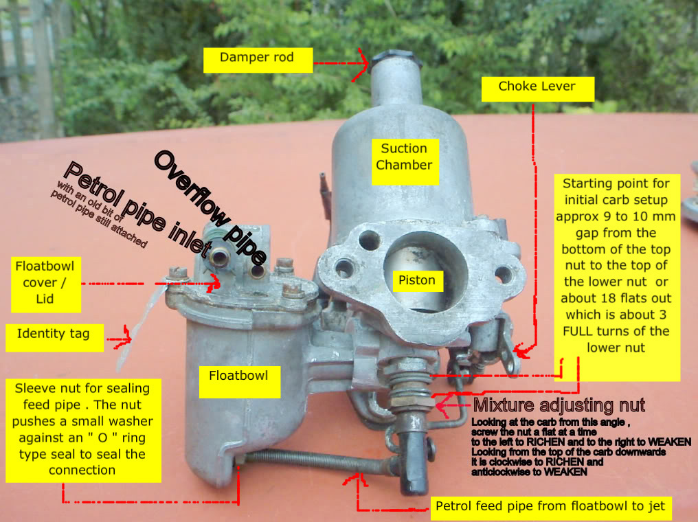

When you transition, it is the damper that prevents the piston (and needle) from moving too fast or too slow. @Austin 1800
If the damper opens too fast, you will go lean during transition, if it opens too slow, you will go rich during transition. You can experiment by removing the oil from the plunger and test driving then replace the oil with a thick 30wt and test driving to see the two extreme transition speeds of the piston and judge if this is helpful.
As you mention it could be advance.  It also could be SU piston binding or wrong needle profile.  Are your carbs balanced?  If not, have a look here: https://www.classiczcars.com/forums/topic/39221-quick-and-dirty-su-tuning/?tab=comments#comment-352697

Also check all 4  plugs at idle for baseline colour then run at highway speed for 5min then do an ignition cut and coast to the side of the road  to check plugs.  This will tell you if you are running richer or leaner than idle at highway speed.  If your carbs are balanced, valves are sealing, no intake leaks, and ignition is good then the difference is due to your needle shape.

Thanks very much for your comments... I only have a single carbie....
As an experiment I pulled the choke out a little when on the expressway home last night... it made a big difference, the car seems to free up, going up hills was easier too... I have no doubt now that it is running too lean at higher revs.... I should also say that the recent work I did on the car was as follows: New oil, plugs and filters, and I also re-adjusted the rockers as the were quite loose (Except one which was too tight)... all the rattle sound has now gone and it sounds fantastic... I should also say that it has a "Too stages above standard" cam in it what ever that means...  that it what the guy said when it was rebuilt back in 2001. Since then it did I would say 20 thousand kms then sat the then shed for 5 years due to a broken part.... then I got it back on the road again last August... since then it has done about 15 thousand kms as I use it to and from work and have also driven up to Sydney a few times (2000kms round trip).

You're just running lean. If this is a new condition, I'd suspect your fuel supply has been comprimised. Dirty filter, plugged lines, poorly performing fuel pump.  On the other side of the coin, a vacuum leak lets more air in that is expected leading to a lean mixture even if the fuel system is working well.
