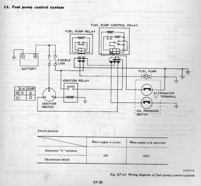

Two prongs is correct.  One prong is the pressure sensor and the other is the switch.  Maybe you picked the wrong prong?  Bottom of the T is the switch.
Thanks guys!  I'll hook it up and see what happens.  The documentation accompanying said that it was just a switch that activated on very low oil pressure or very high oil pressure. No mention of pressure-to-resistance feature for driving the oil gauge.
Don't forget that the switch is normally closed.  It opens with oil pressure.  That's the flaw in it, if you unplug the oil pressure switch the fuel pump runs with the key On.
You'll need another relay to make it act as a safety switch.
That diagram hurts my head...
