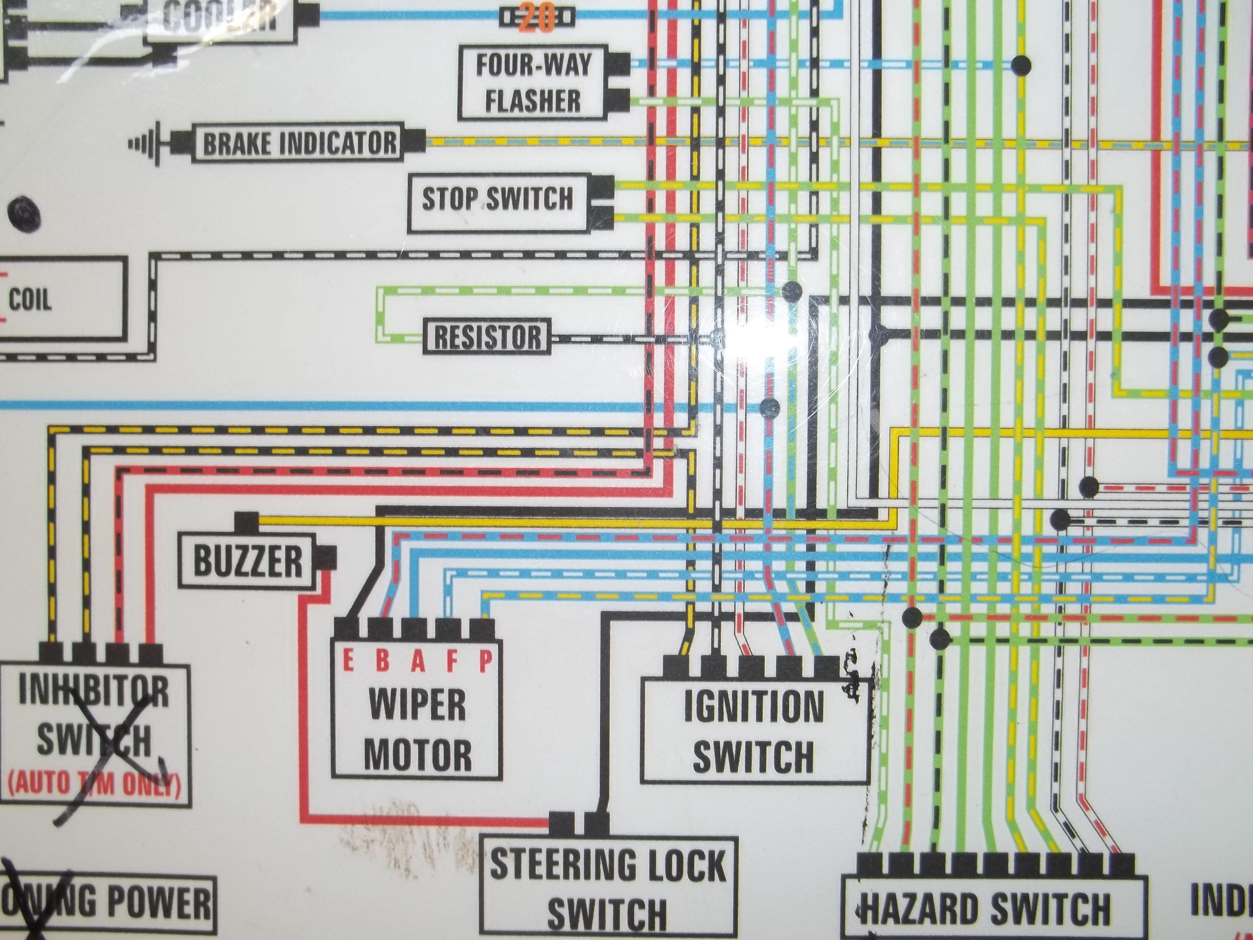

9 minutes ago, Jarvo2 said:
No need for the ballast resistor without points. I pulled mine off and the engine runs great with a full 12v going to the plugs
Coil.  12 volts to the plugs won't even make a spark. :confused:  And with current flowing it won't be 12 volts.  Just saying...
I think he already realized his error though.
