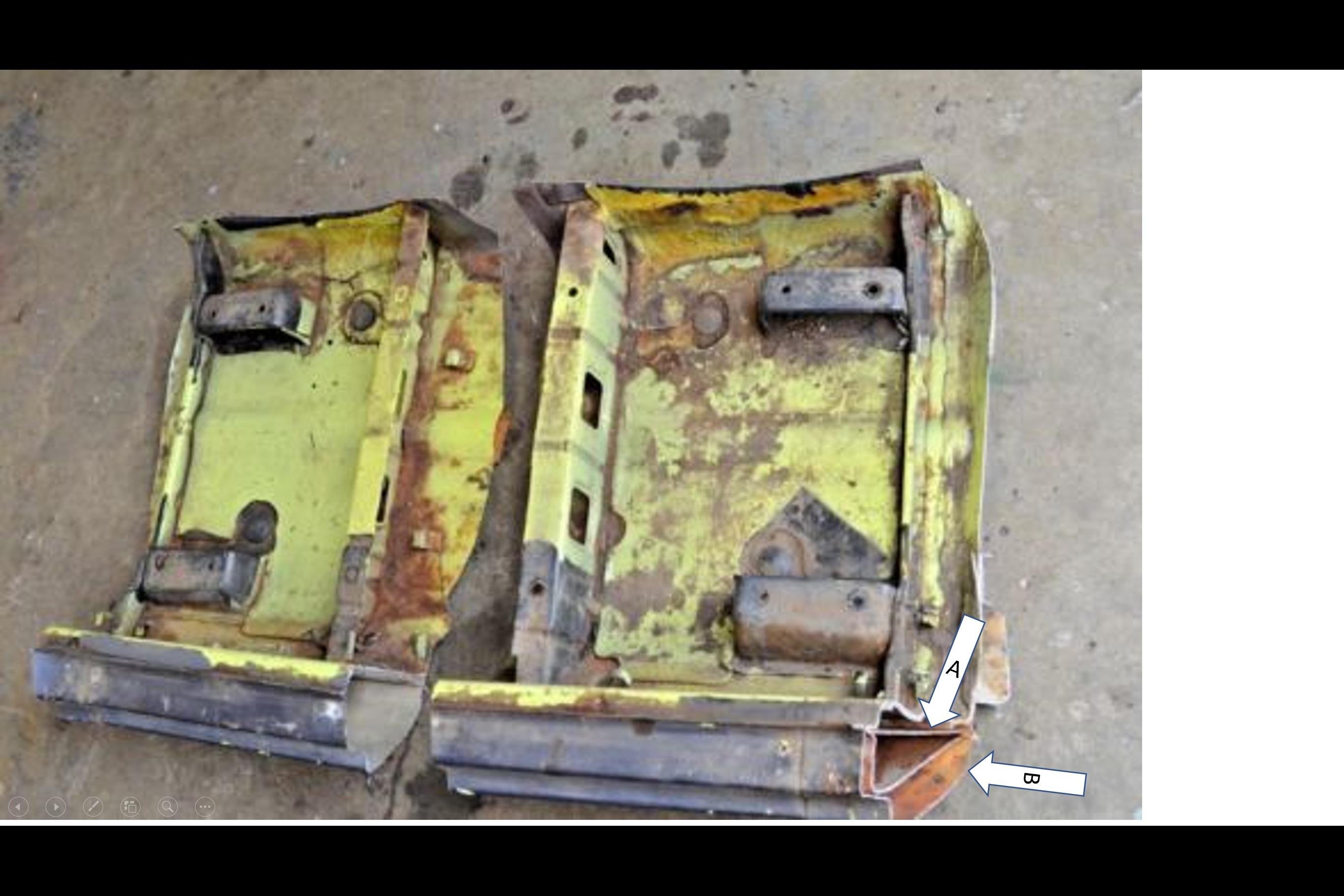

Hi All:  – I need to replace the outer rocker panels (aka "sills") and lower doglegs on both sides of my ’72 240Z.  I will purchase repair panels from The Z Store, Tabco or another supplier (recommendations on suppliers appreciated, btw.).   For now, I’m trying to get an understanding of how everything fits together, so I'll have a good understanding before I start cutting.
Question: (See the photo below as a reference.) Will the outer rocker repair panels replace the section indicated by the “B” arrow?   Is the piece marked “A” the inner rocker?  Is the green piece above “A” the inner rocker or the floor section?  Am I making sense?
BTW:  What doesn’t the floor on the left show the “A” piece?
Thanks much as always for your help!  Jughead
I don't know about the other companies but the Tabco rocker will replace B
I'm pretty sure A is part of the dog leg structure which is why it doesn't show in the floor section to the left, but turn it around and it will be there.   disepyon's thread will show you everything.
It is part of the inner rocker and disepyon is I think the only guy making those pieces.

The section in that pic was cut just behind the seam where the dogleg meets the rocker. B is actually the dogleg, not the rocker, the piece between A and B is the inner rear section of the rocker, and A, I'm not sure about, but I suspect that is the bottom section of the inner portion of the quarter panel/dog leg.
If you are unsure of what you need, I would recommend posting some pictures of what you need to fix on your car, and then we can direct you from there.
Also be aware that Tabco products are not all that great, and you may need to repair the repair panel before you weld it in. I know of at least one issue with the rocker panel where the die basically stretches the metal too thin, and splits it. And you'd probably never notice unless it was pointed out to you.
