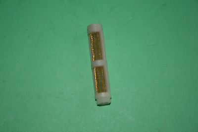

February 1, 20196 yr comment_567135 While I'm drooling over the new paint photos, I've been browsing the net for "brass 1/4" fuel filters", "Hitachi in carb body fuel filters" and similar searches. I also emailed Burlen Ltd, who now own the manufacturing rights for SU carbs and parts, and advertise parts for SUs, including SU HIF carbs.   I had asked them about SU HIF carbs and if they had any fuel filters that might fit the Hitachi SU HIF flat tops. They do not, but I'm impressed with their apparent efforts in response:  "Dear Mr jayhawk,  There was some development between SU and Hitachi for these carburettors.  Unfortunately the only piece that is a direct exchange is the central metering needle.  We do have some SU carburettor build sheet however these don’t state which particular vehicles, just pair of HS4 or HS6.  We have tried contacting Hitachi direct as there are drawing numbers but to no avail.   Sorry not to be able to help further. " So no joy there, but I'm impressed that they have drawing numbers and apparently tried to contact Hitachi.  Link to comment https://www.classiczcars.com/forums/topic/60309-were-bringin-back-the-flat-tops/?&page=25#findComment-567135 Share on other sites More sharing options...
February 1, 20196 yr comment_567137 My internet searches have turned up a lot of dead ends, but some possibilities. On ebay in the UK (from a dealer in the US...?) https://www.ebay.ie/itm/TRIUMPH-NORTON-BSA-UNIVERSAL-FUEL-PETROL-TAP-BRASS-GAUZE-FILTER-1-8-GAS-THREAD/254054636004?hash=item3b26d619e4:g:sOkAAOSwRYNb~AXw:rk:1:pf:0 It appears from other info in that ebay ad that the size of the brass parts may be very close to what is needed. I then found some internet into indicating some holly and other downdraft carbs had in-the-carb-body filters, but while they were cylindrical, the ones I could find were too wide. But I have found out that some Hitachi 2bbl downdraft carbs used this technique, and ran across this youtube video on replacing one that appears to be identical to what they used in the HMB46Ws. "removing mesh filter, datsun hitachi carb" https://www.youtube.com/watch?v=tU_jNSPFwP4 I don't know any model numbers yet. I have found some rebuild kits for various 2bbl hitachi carbs, but none of those kits have any fuel filters...:-( Will keep looking. Maybe the datsun fans on Ratsun have some ideas. Edited February 1, 20196 yr by jayhawk Link to comment https://www.classiczcars.com/forums/topic/60309-were-bringin-back-the-flat-tops/?&page=25#findComment-567137 Share on other sites More sharing options...

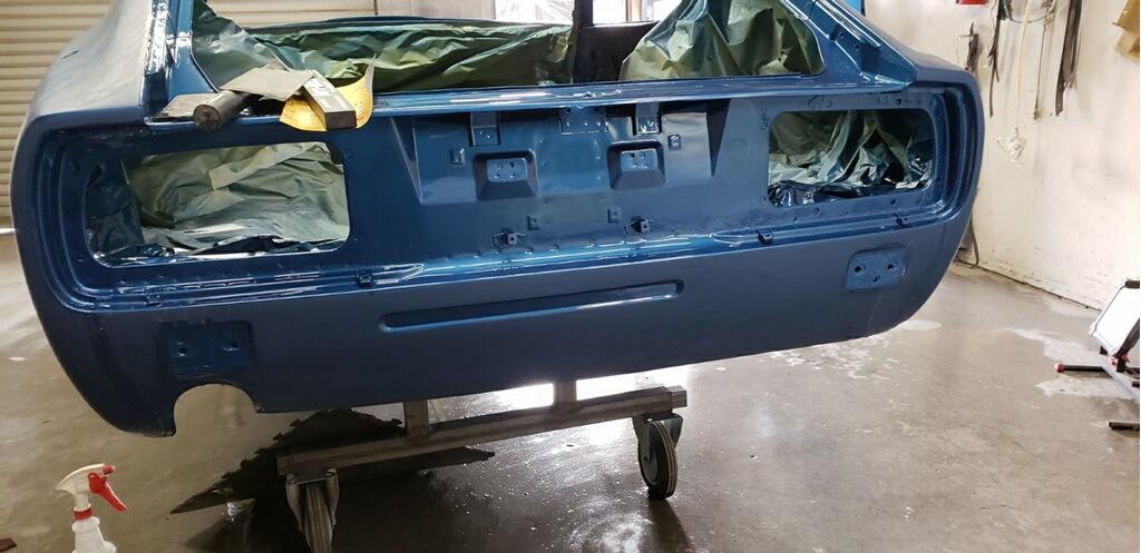

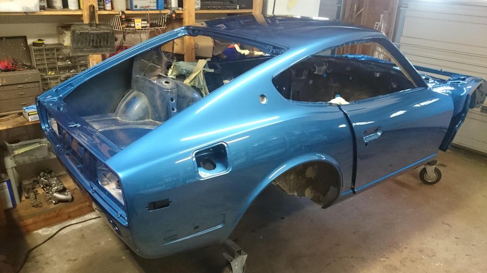

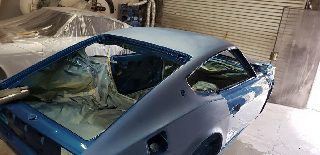

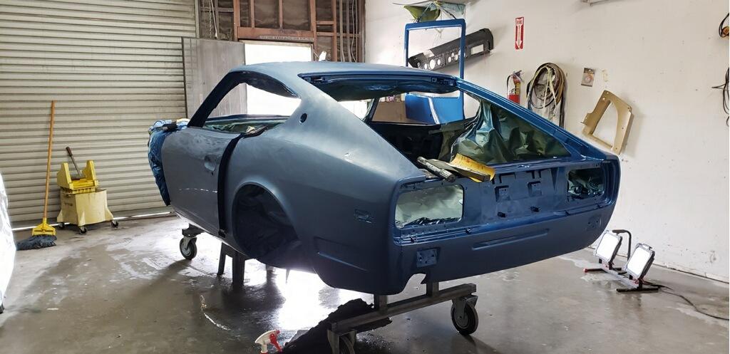

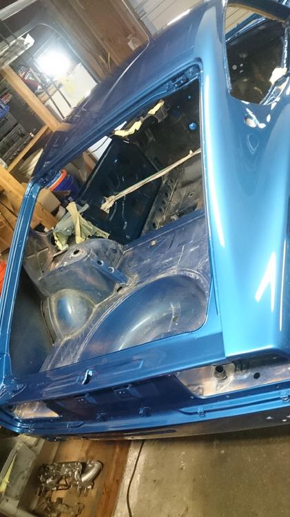

February 4, 20196 yr Author comment_567424 Paint (clearcoat) is finished with color sanding and is now being polished. Will pick up car this Wednesday and get this into my garage. That is when the real fun begins. Link to comment https://www.classiczcars.com/forums/topic/60309-were-bringin-back-the-flat-tops/?&page=25#findComment-567424 Share on other sites More sharing options...

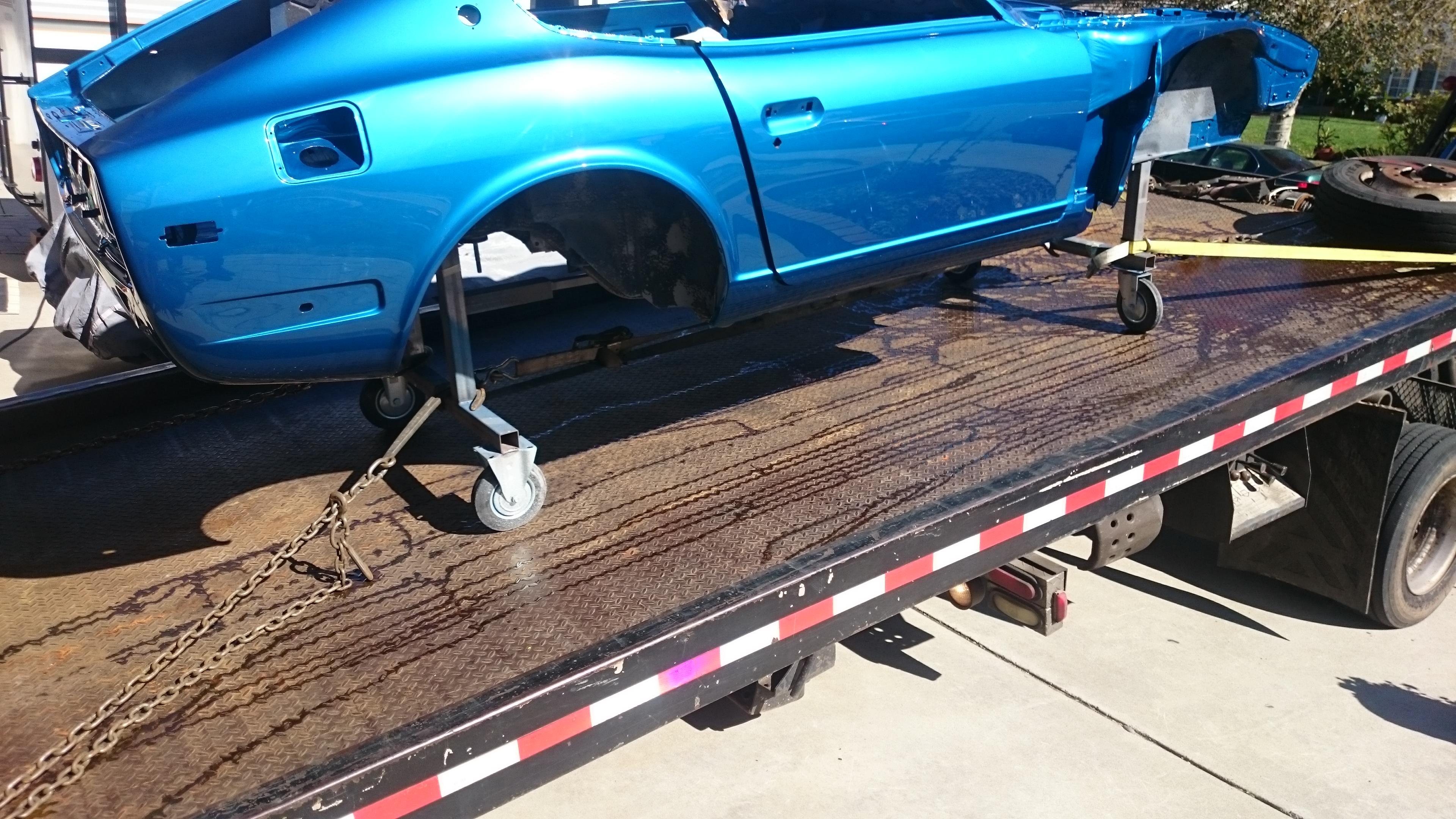

February 6, 20196 yr Author comment_567575 OK, she is safely back home. The paint looks amazing, better than the pictures. Looking forward to finishing up the underside and then installing parts. The air intake ducts look amazing. Too bad no one will see them. Edited February 6, 20196 yr by motorman7 Link to comment https://www.classiczcars.com/forums/topic/60309-were-bringin-back-the-flat-tops/?&page=25#findComment-567575 Share on other sites More sharing options...

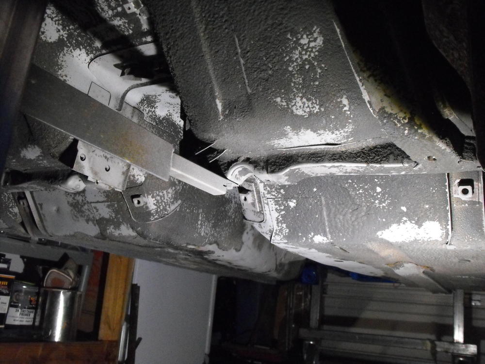

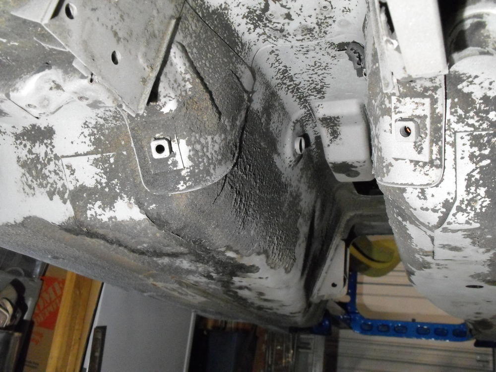

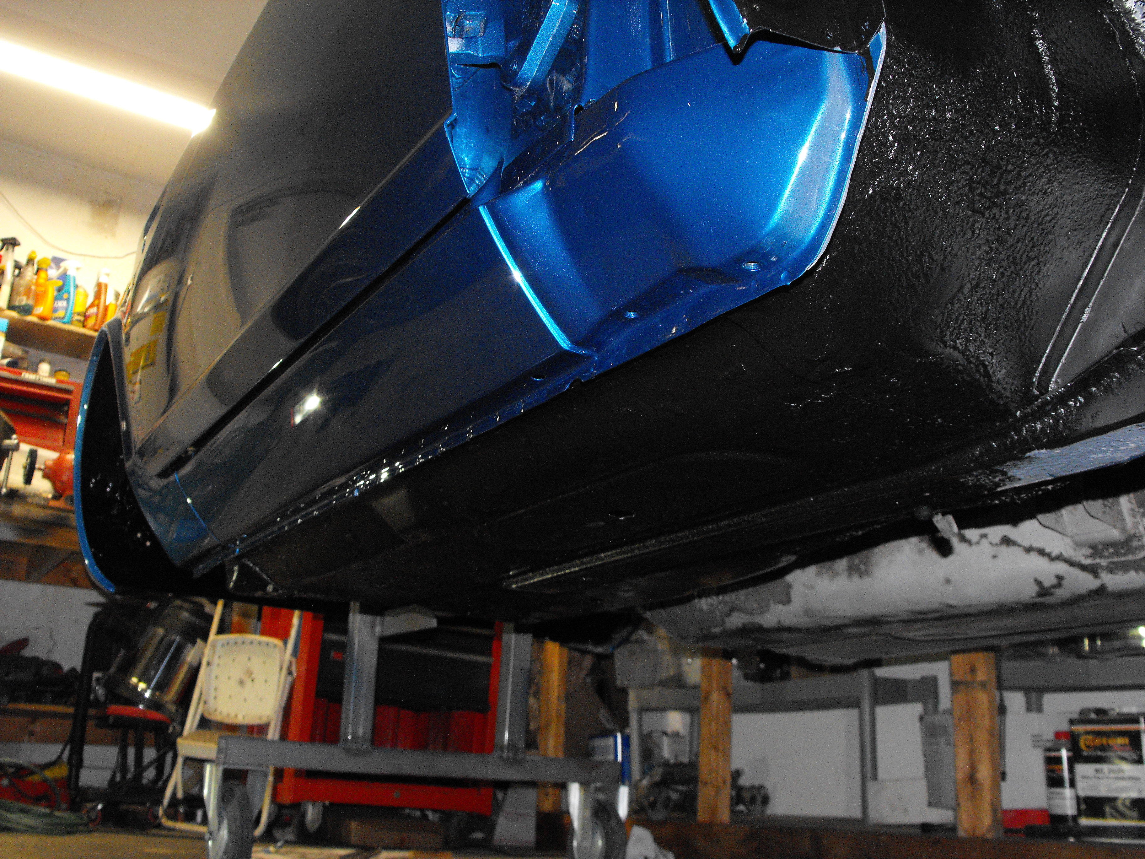

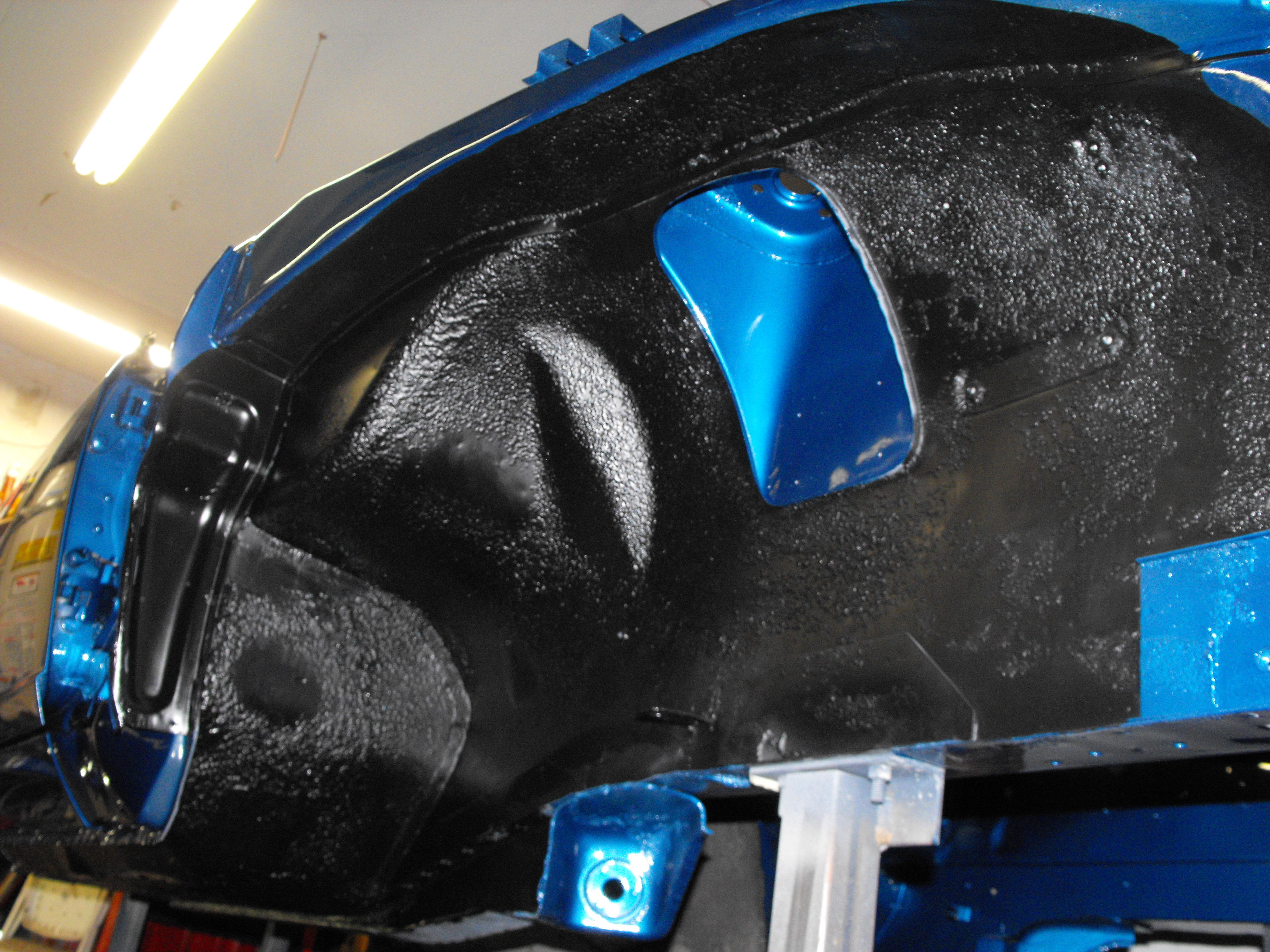

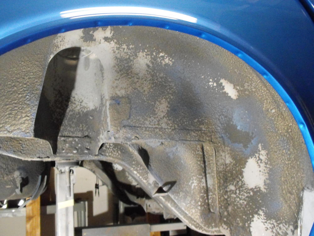

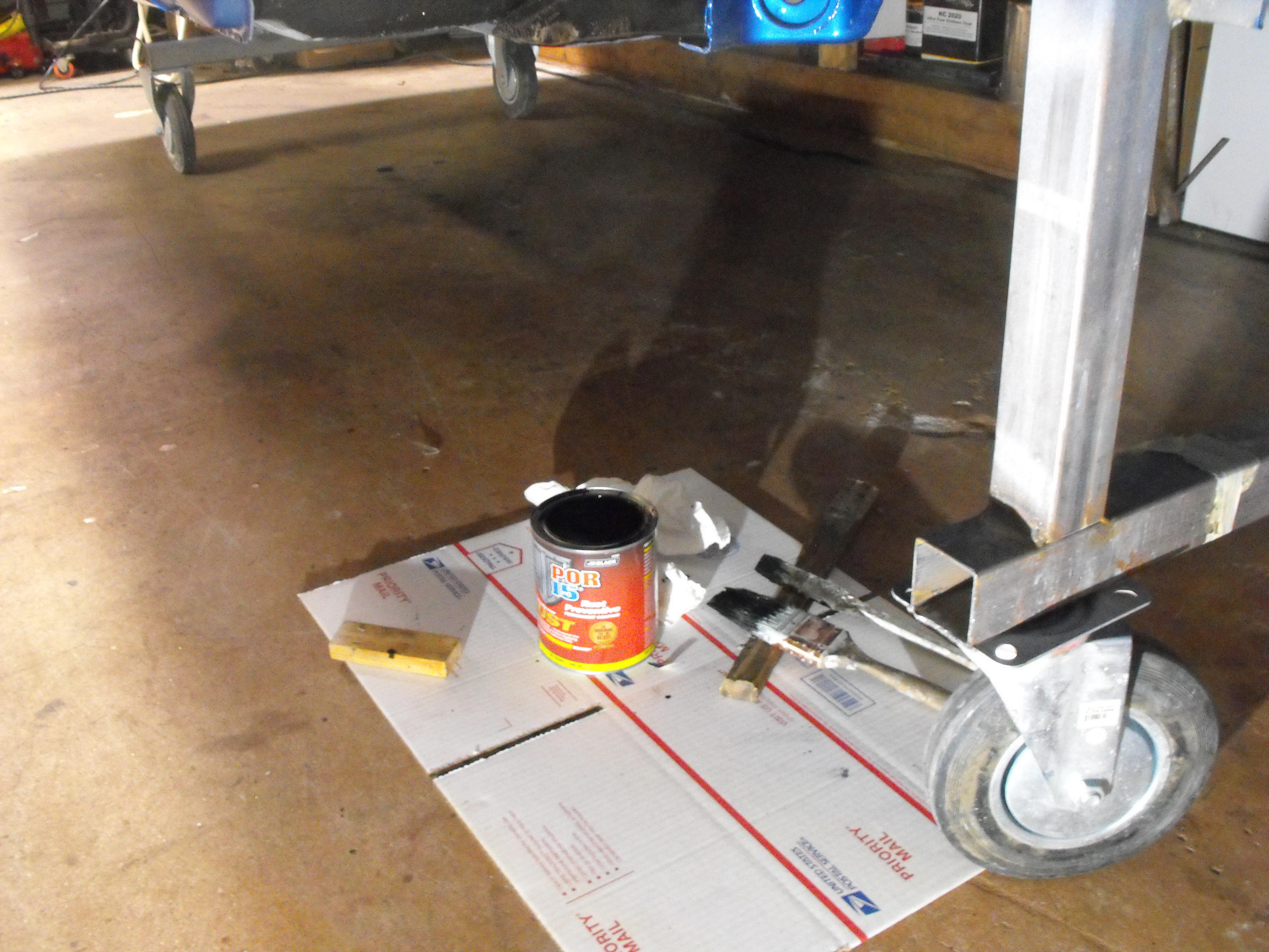

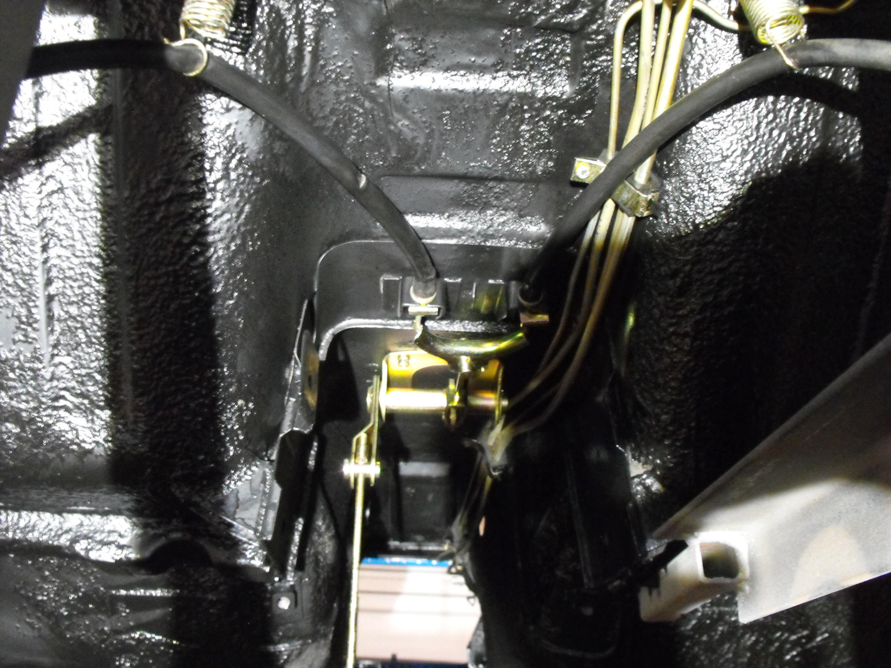

February 8, 20196 yr Author comment_567689 Next step is coating the underside with POR-15 and then spraying on the undercoat over that. The underside was sandblasted at the paint shop so a good portion of the old undercoating is gone with a lot of bare metal showing. I did not remove all of the old undercoating since the underside is in pretty nice condition.  I got most of the passenger side done this evening.  Edited February 8, 20196 yr by motorman7 Link to comment https://www.classiczcars.com/forums/topic/60309-were-bringin-back-the-flat-tops/?&page=25#findComment-567689 Share on other sites More sharing options...

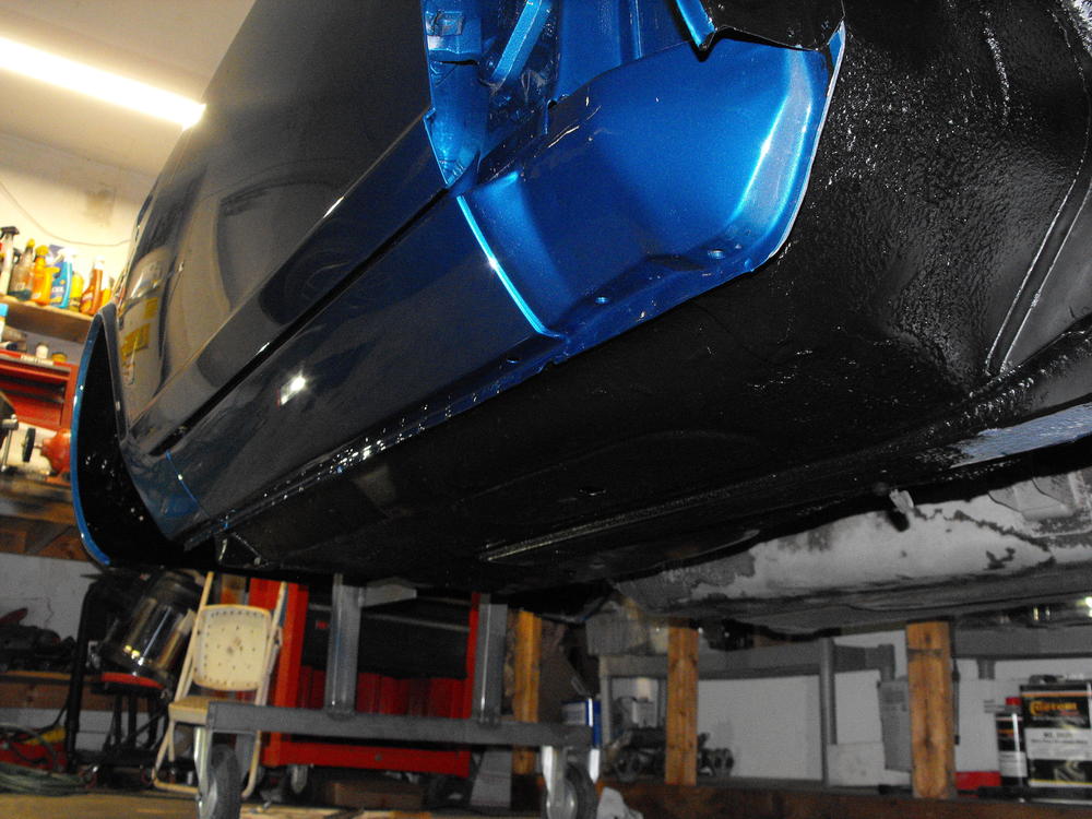

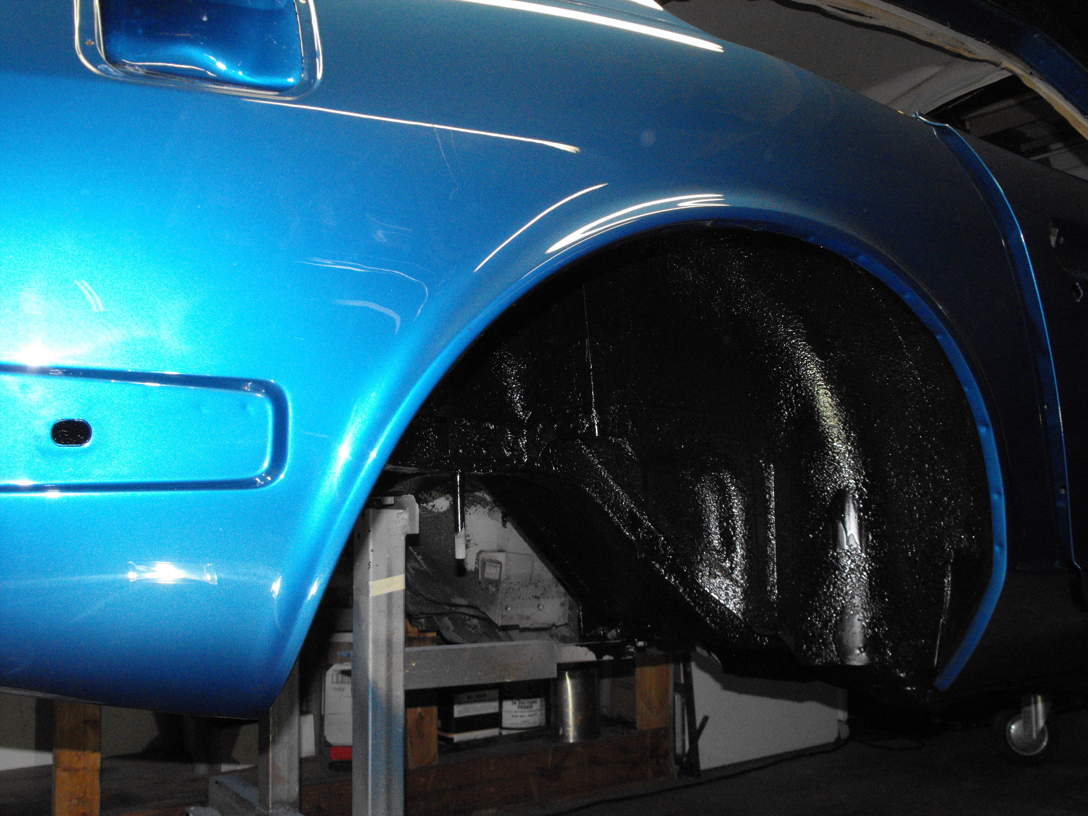

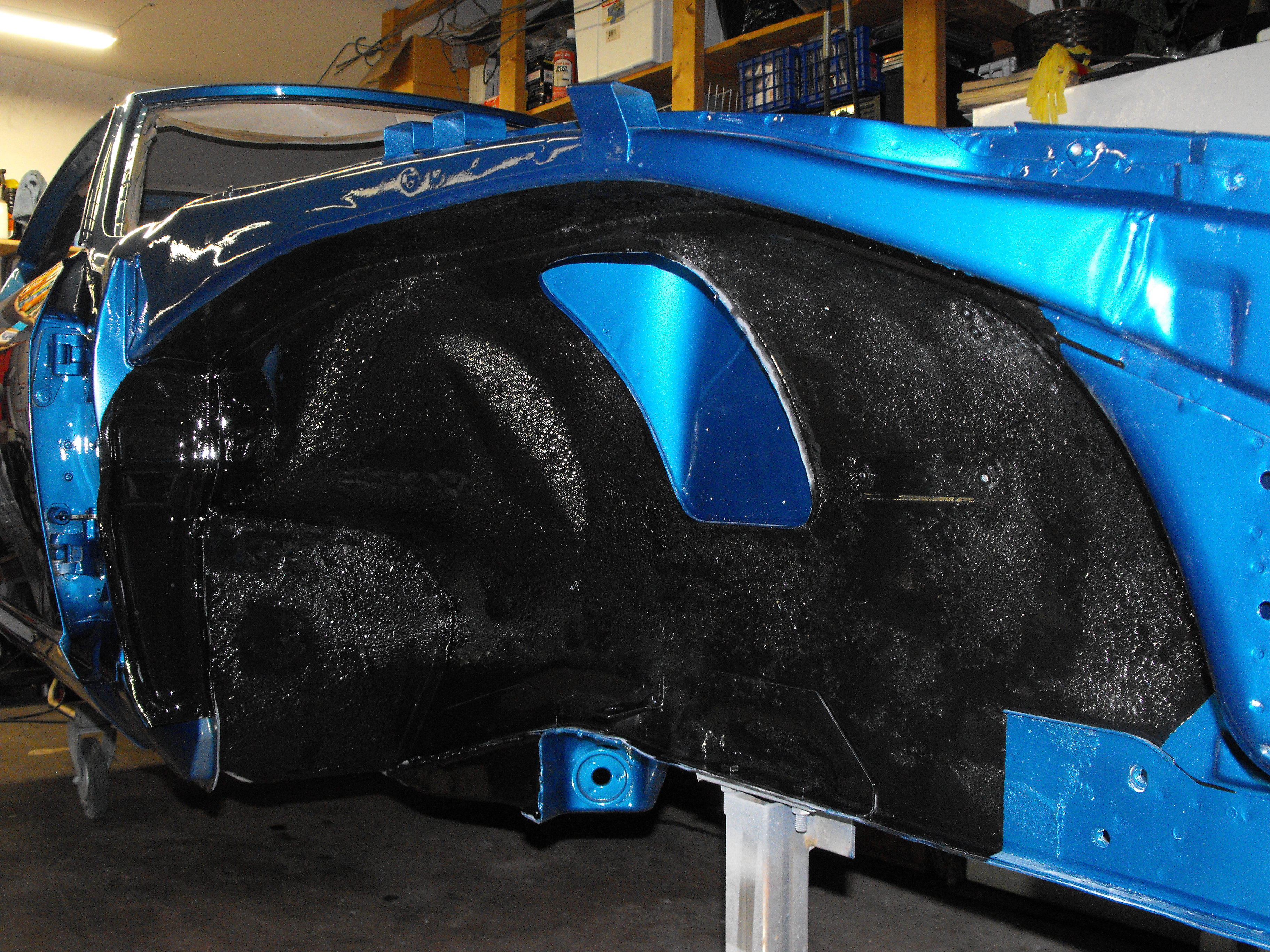

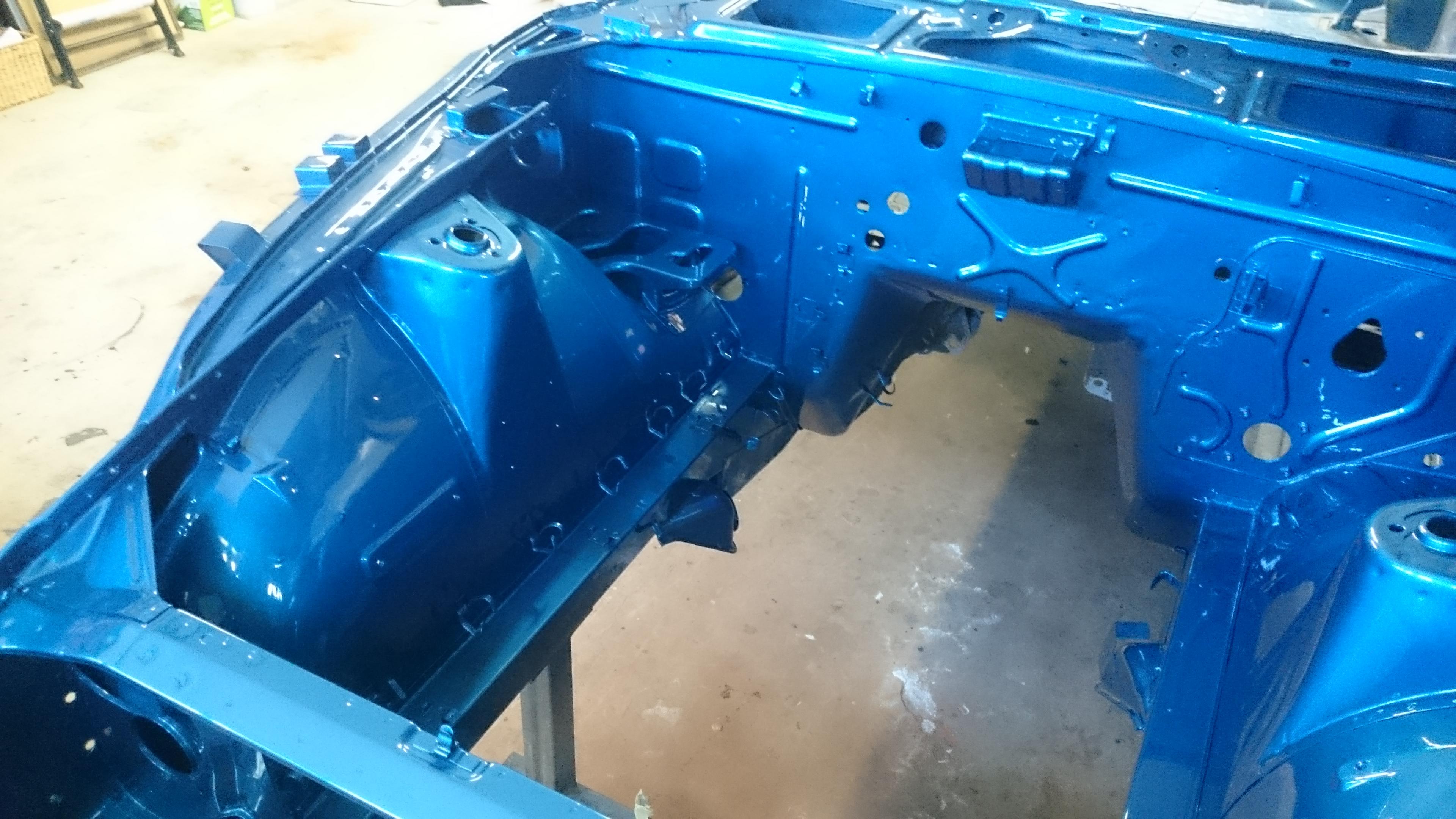

February 10, 20196 yr Author comment_567905 Finished the complete underside with POR-15, then added undercoat. Started assembly. Put on the 4 struts and started the brake line installation. Camera does not do the car justice. Not sure why the plating looks too silverish....paint too glossy.  Edited February 10, 20196 yr by motorman7 Link to comment https://www.classiczcars.com/forums/topic/60309-were-bringin-back-the-flat-tops/?&page=25#findComment-567905 Share on other sites More sharing options...
February 10, 20196 yr comment_567907 The middle portion of the throttle rod bracket seems to disappear from the reflection of the blue paint----really threw me off for a second, as the end of the bracket appeared to be hovering in space! Shiny? Â I reckon!! Beautiful! Link to comment https://www.classiczcars.com/forums/topic/60309-were-bringin-back-the-flat-tops/?&page=25#findComment-567907 Share on other sites More sharing options...
February 10, 20196 yr Author comment_567918 2 hours ago, Zup said: The middle portion of the throttle rod bracket seems to disappear from the reflection of the blue paint----really threw me off for a second, as the end of the bracket appeared to be hovering in space! Shiny?  I reckon!! Beautiful! Not sure why I am getting so much reflection. I tried a few more pics using my LED light and no flash. Color looks a little better but paint is almost mirror like. check out the reflection on the right of the second pic. That's weird. Obviously, I am not a photographer. Link to comment https://www.classiczcars.com/forums/topic/60309-were-bringin-back-the-flat-tops/?&page=25#findComment-567918 Share on other sites More sharing options...

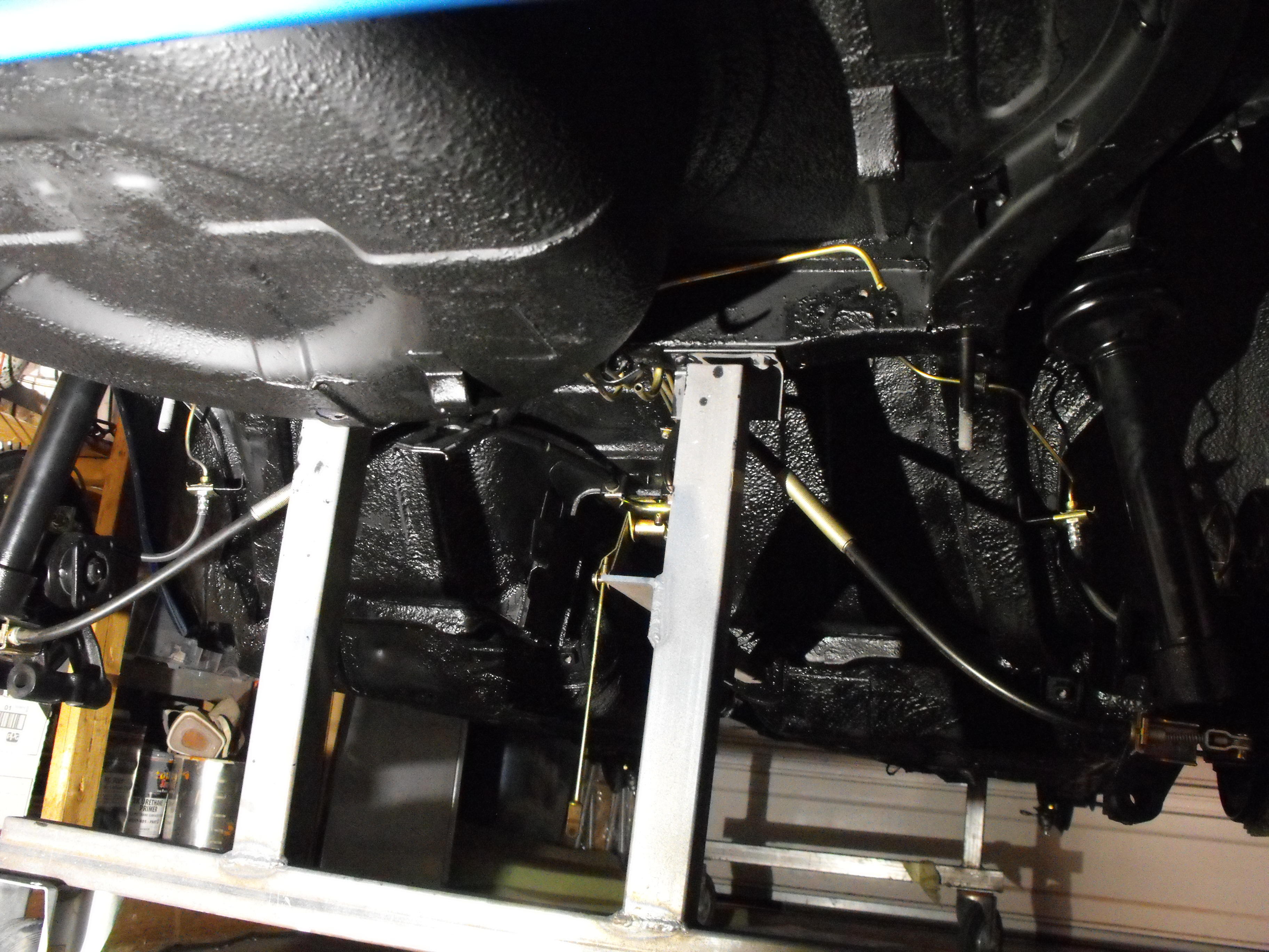

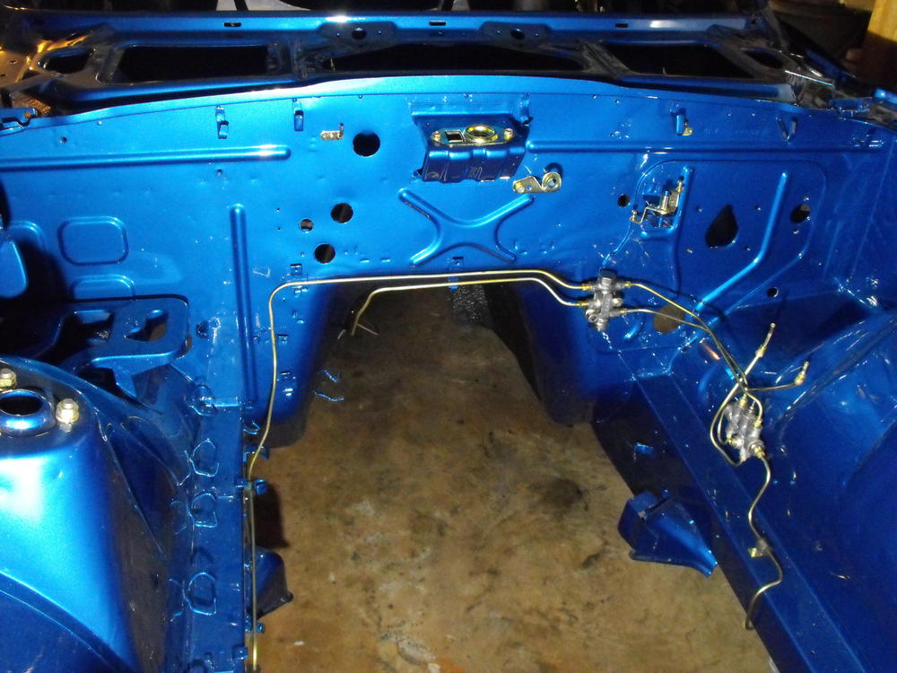

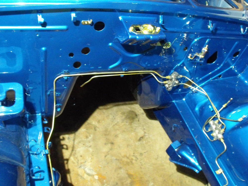

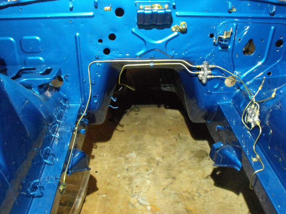

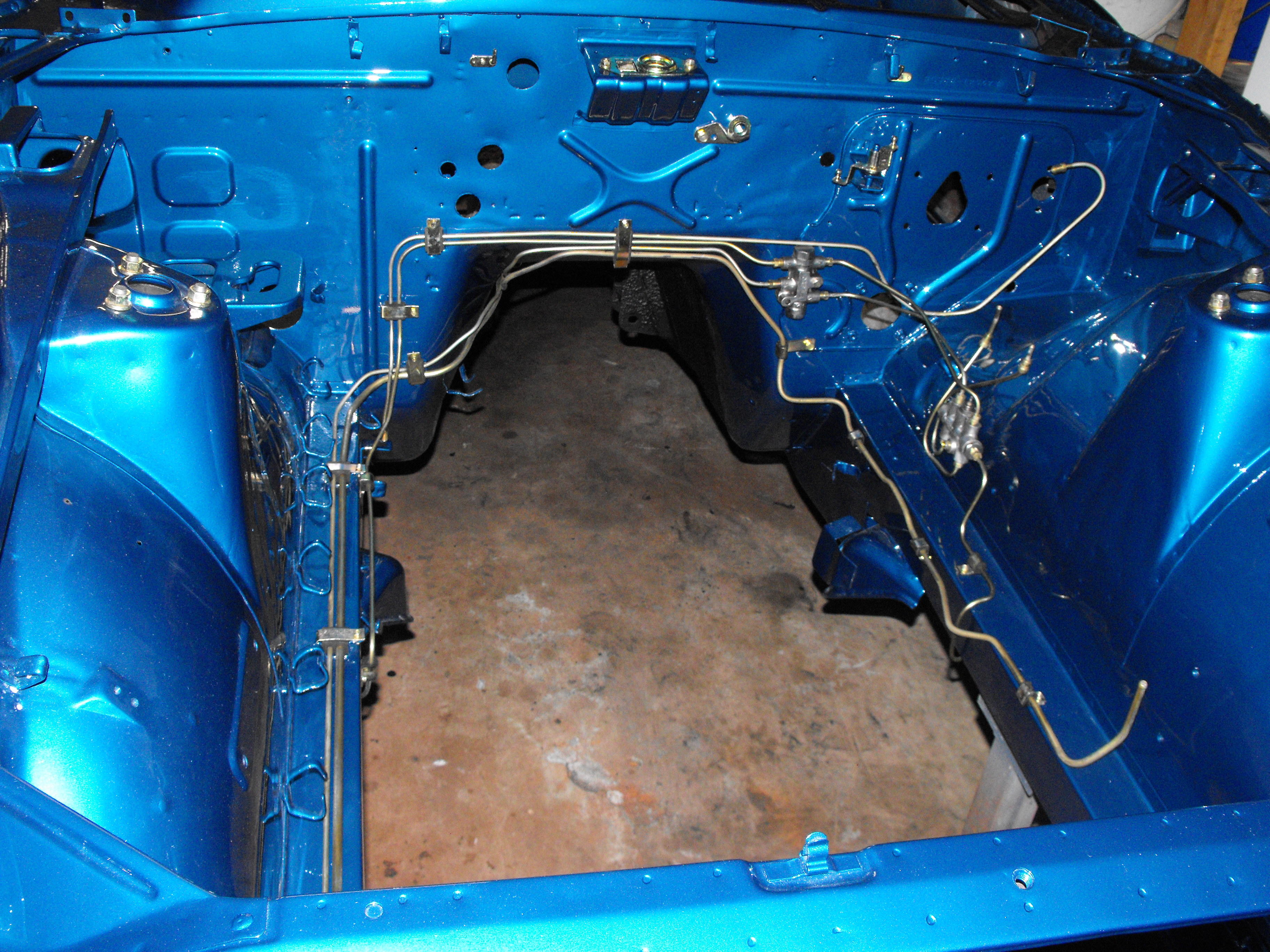

February 11, 20196 yr Author comment_567991 Got the rest of the brake lines in, fuel lines and most of the emergency brake. Link to comment https://www.classiczcars.com/forums/topic/60309-were-bringin-back-the-flat-tops/?&page=25#findComment-567991 Share on other sites More sharing options...
