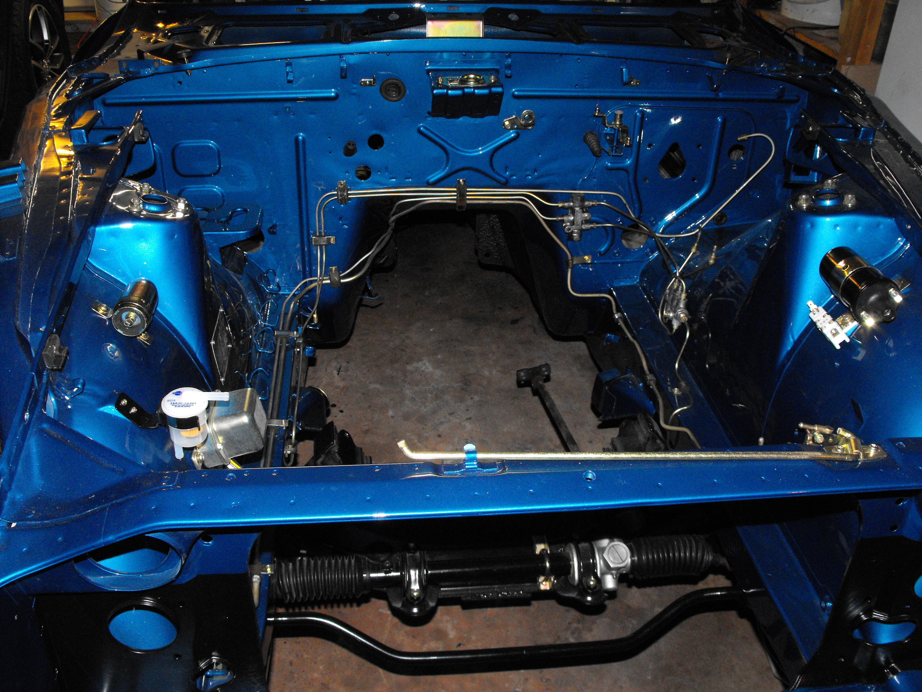

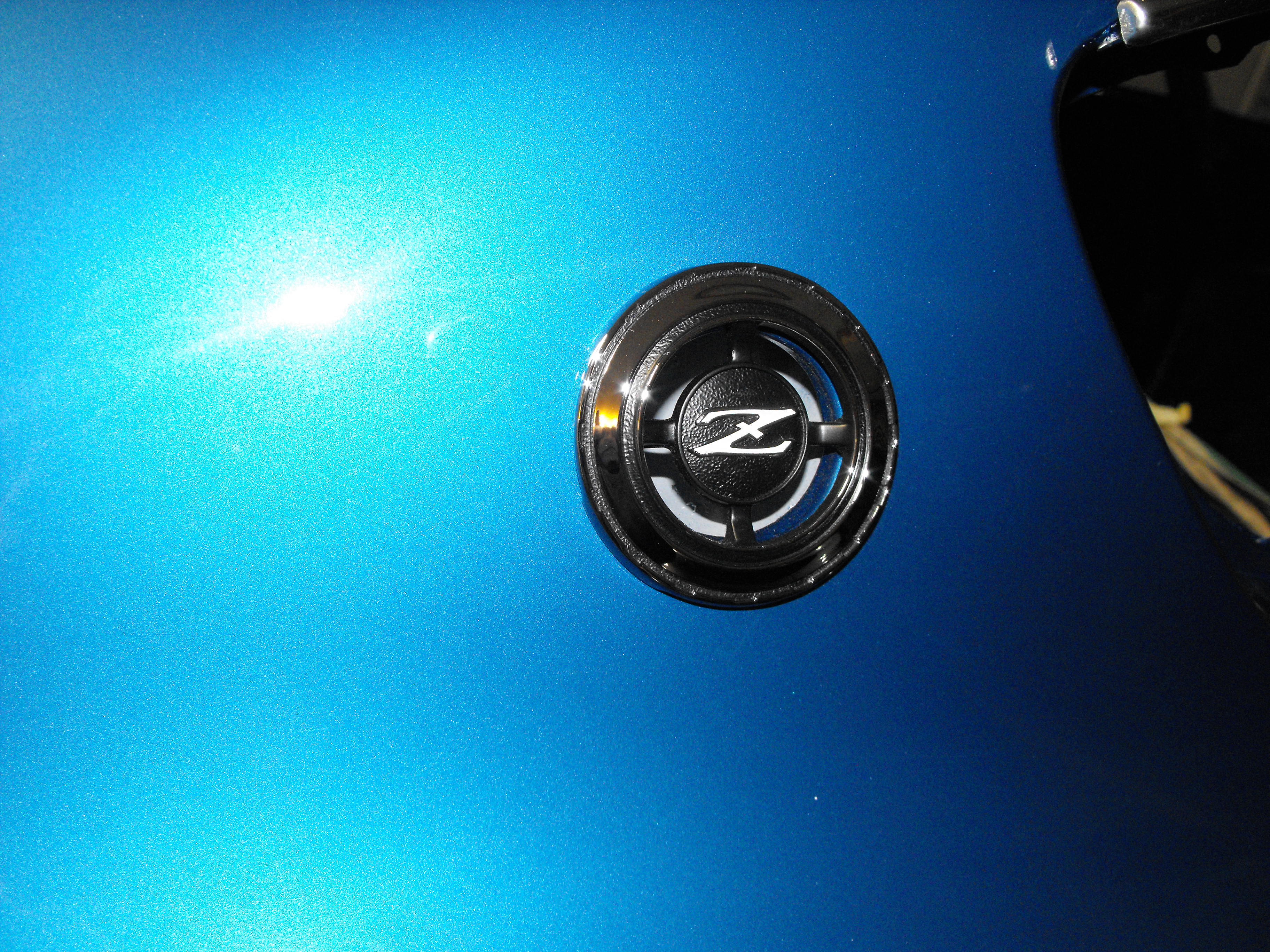

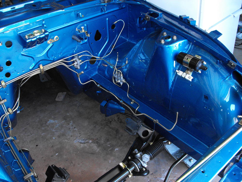

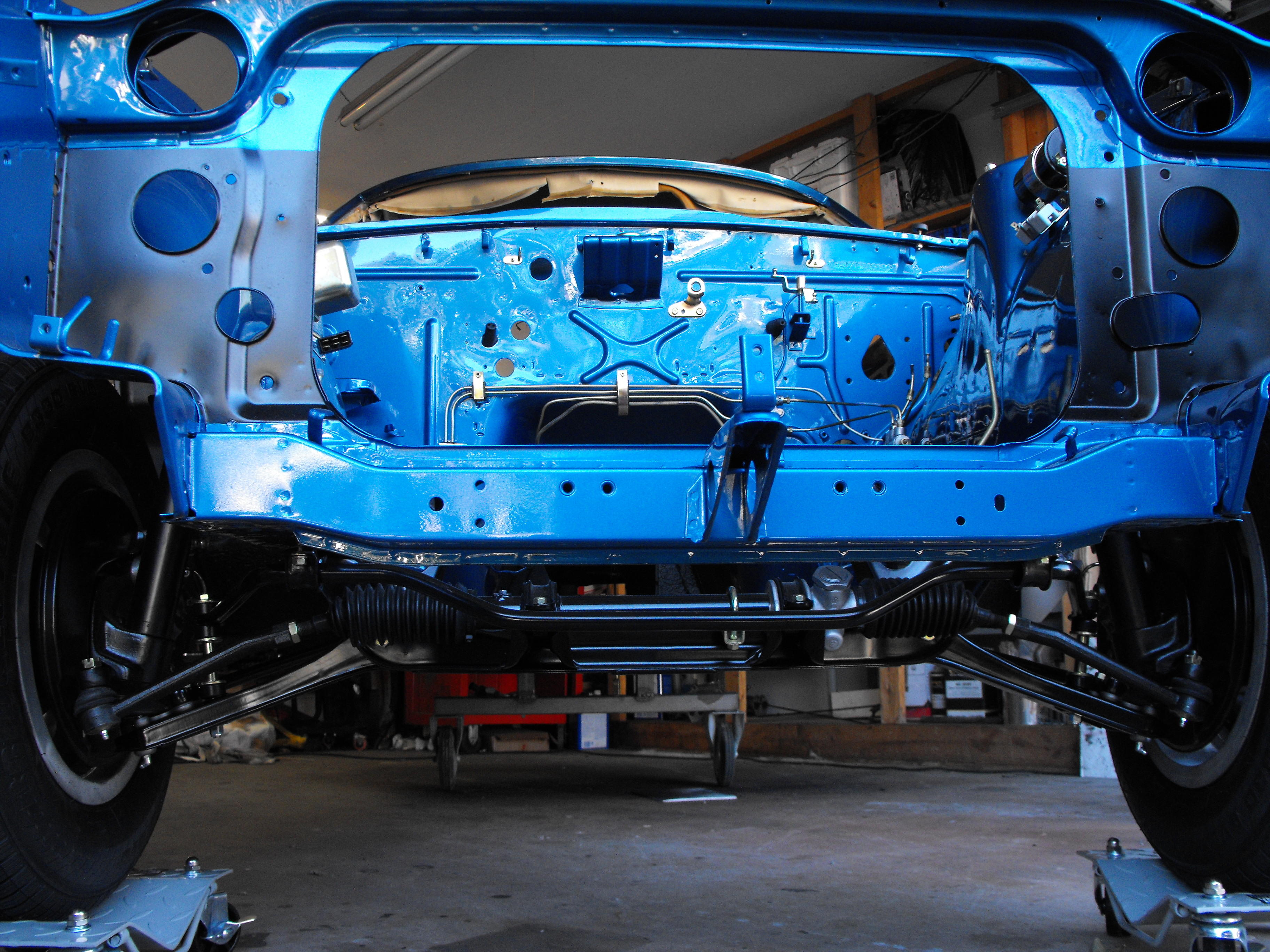

Got my parts shipment in from Zcardepot.  Firewall insulator, glove box, emblems, spindle pins and lots of small rubber parts.  It's the little details that make everything look great.  Still having a hard time getting the pics to come out well.  I have to use the flash, otherwise all I get is reflection.

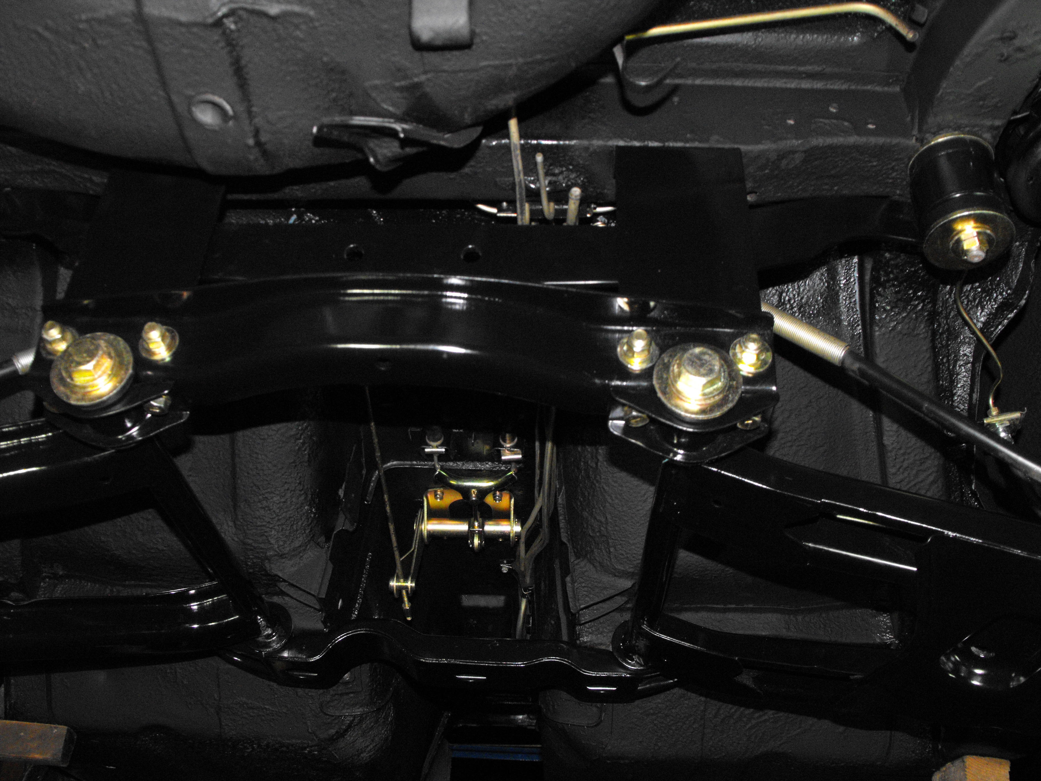

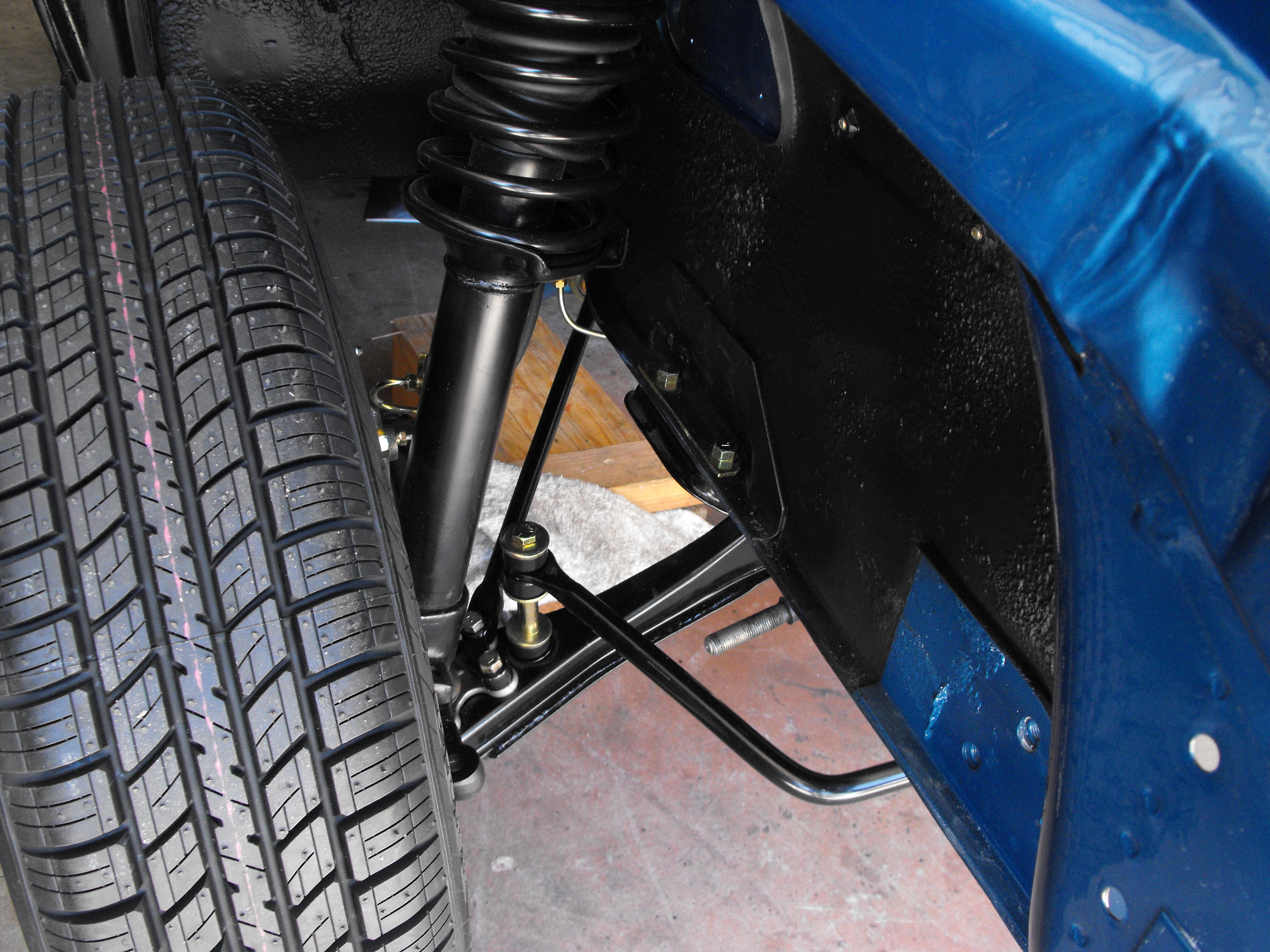

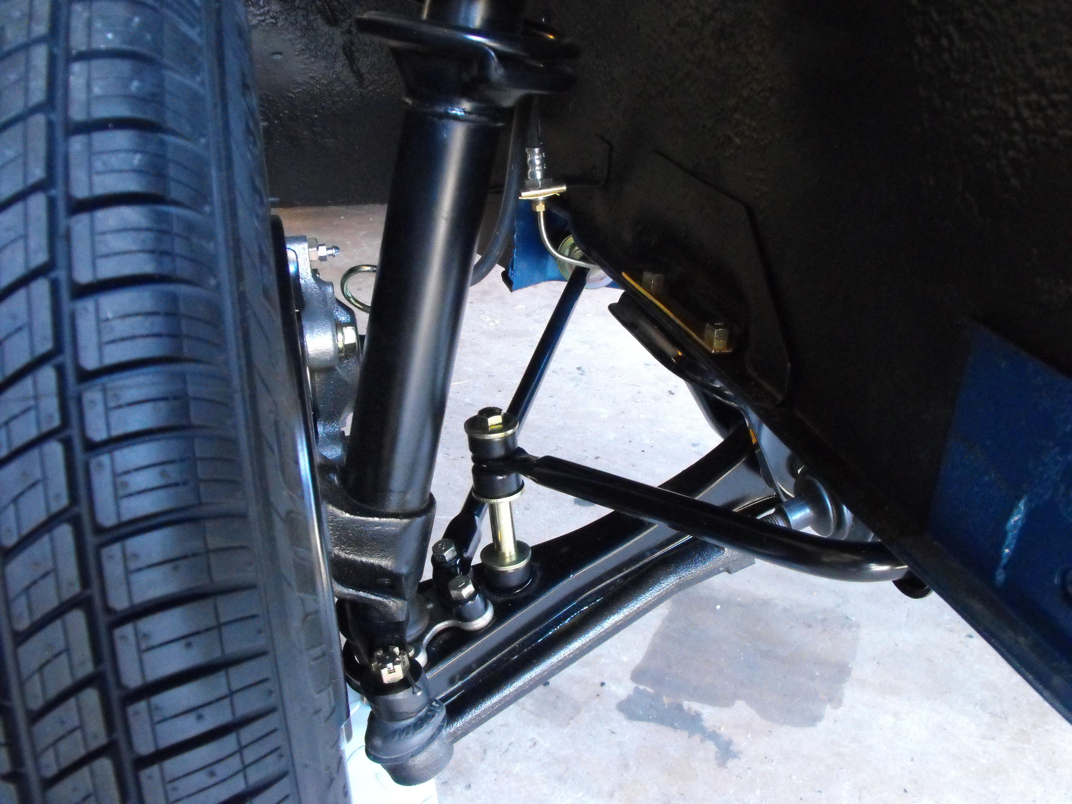

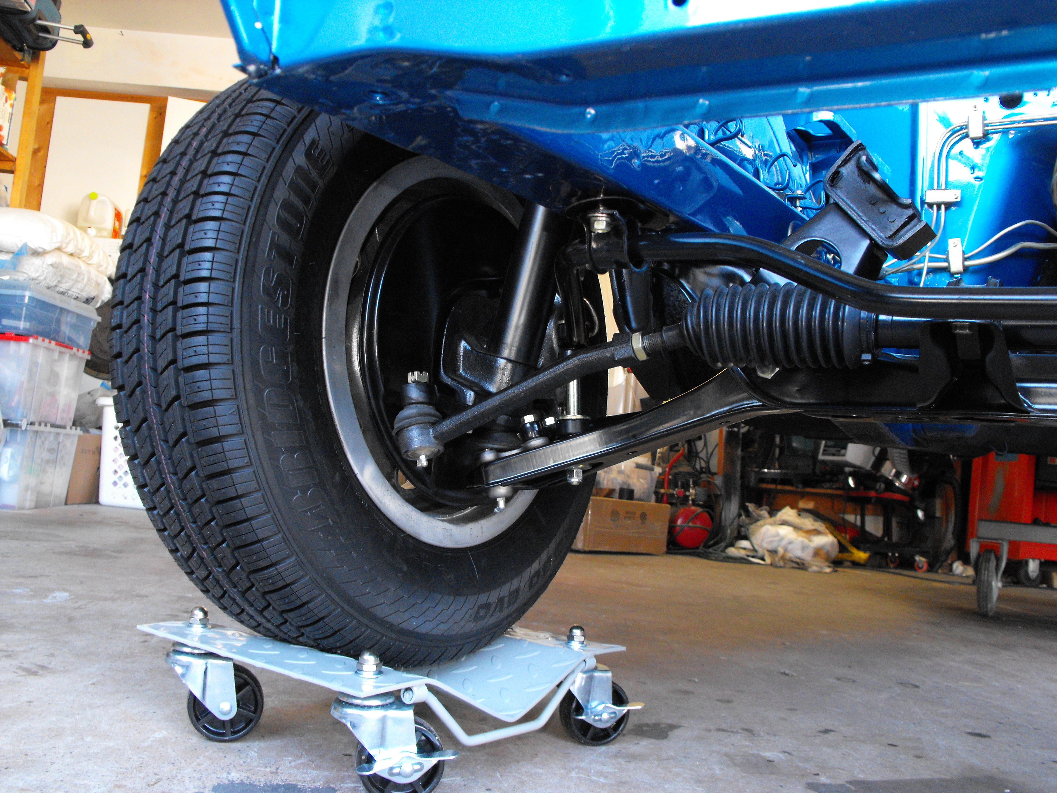

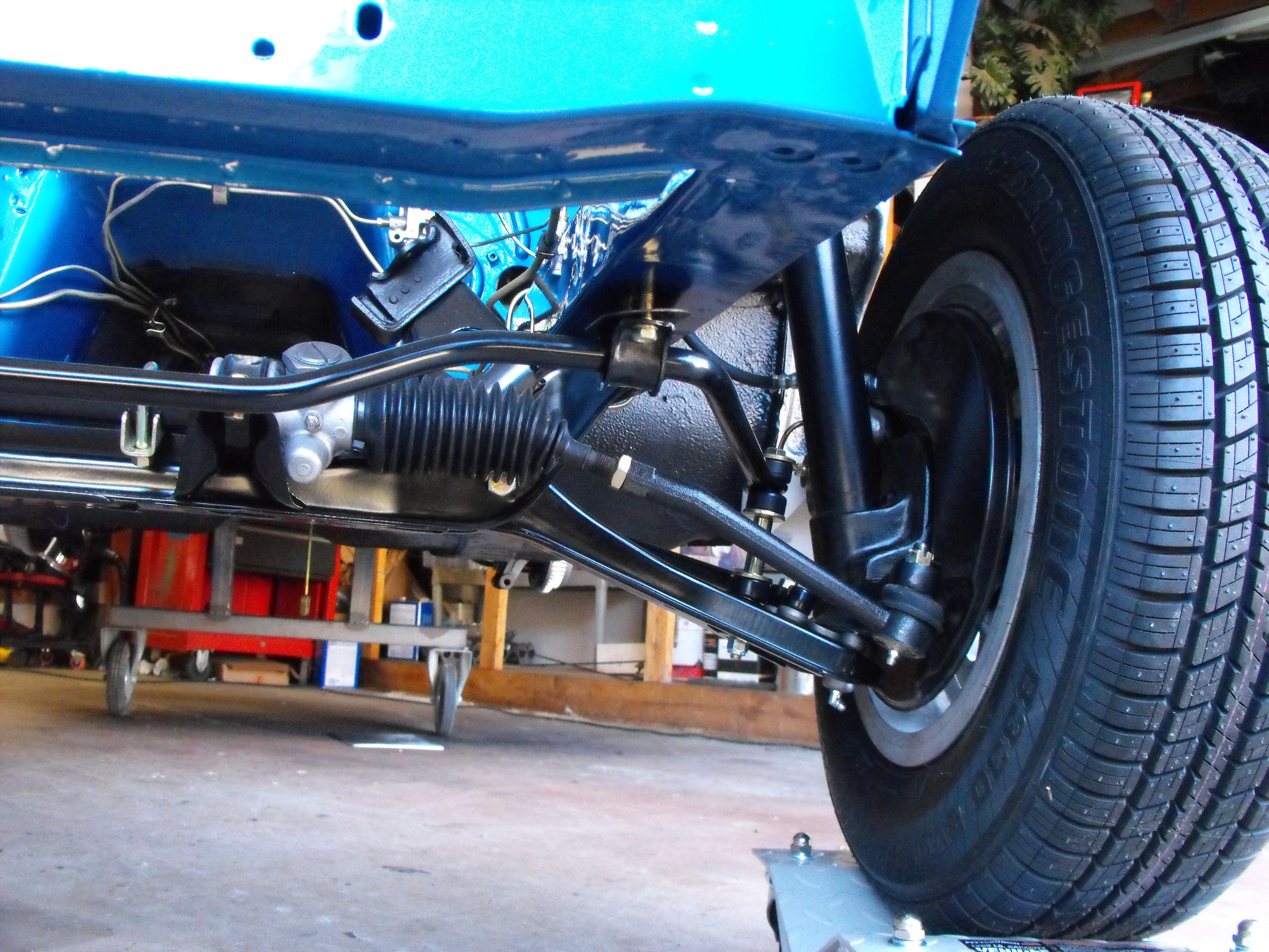

Put most of the front suspension in, except for the sway bar bushings.  Also put in some of the other attaching hardware.  Here are some pics.  Pics look a little better with the natural light.  May try and get the rear suspension in tomorrow.
Edited by motorman7
3 hours ago, Gav240z said:
Where did you get those dollies under the front wheels from?
Got those from Harbor Freight for $48 after the 20% discount with coupon ?.  They had cheaper ones, but these ones had the wheel locks which I preferred.

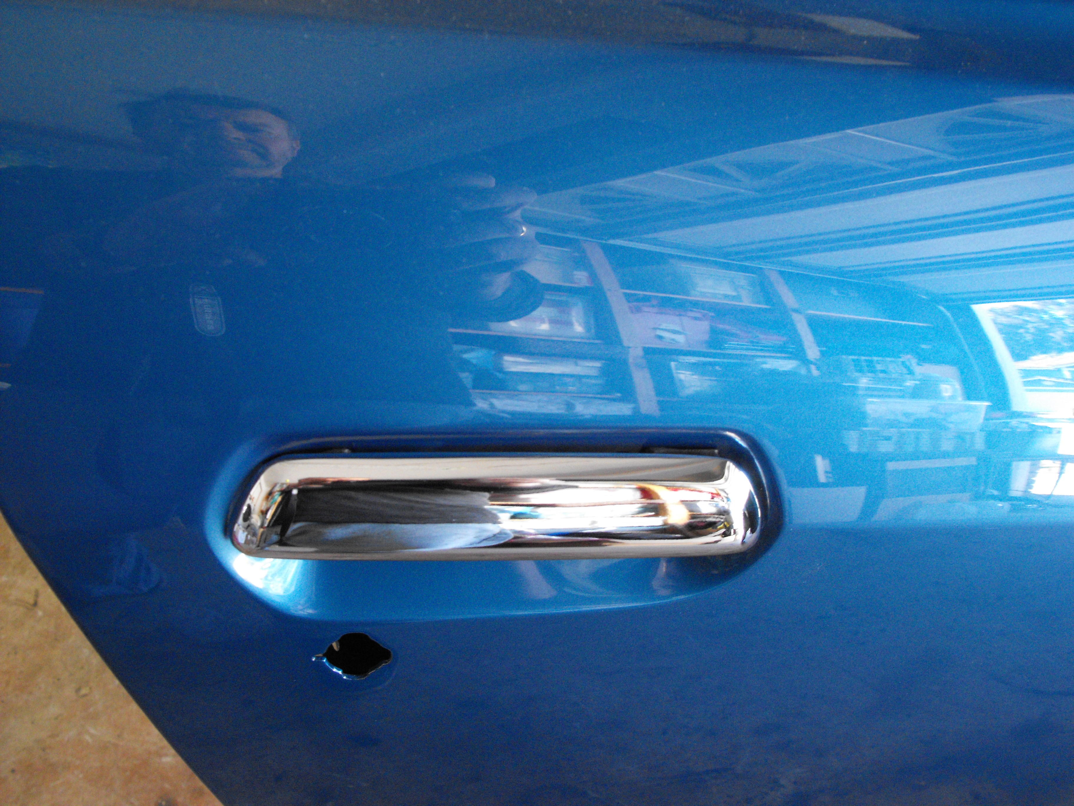

10 hours ago, Patcon said:
The engine bay plate cleaned up good. What did you use? I have heard toothpaste works good...
I used this stuff one the engine bay plate.  I like this stuff a lot and use it on the rain gutter trim and similar items.

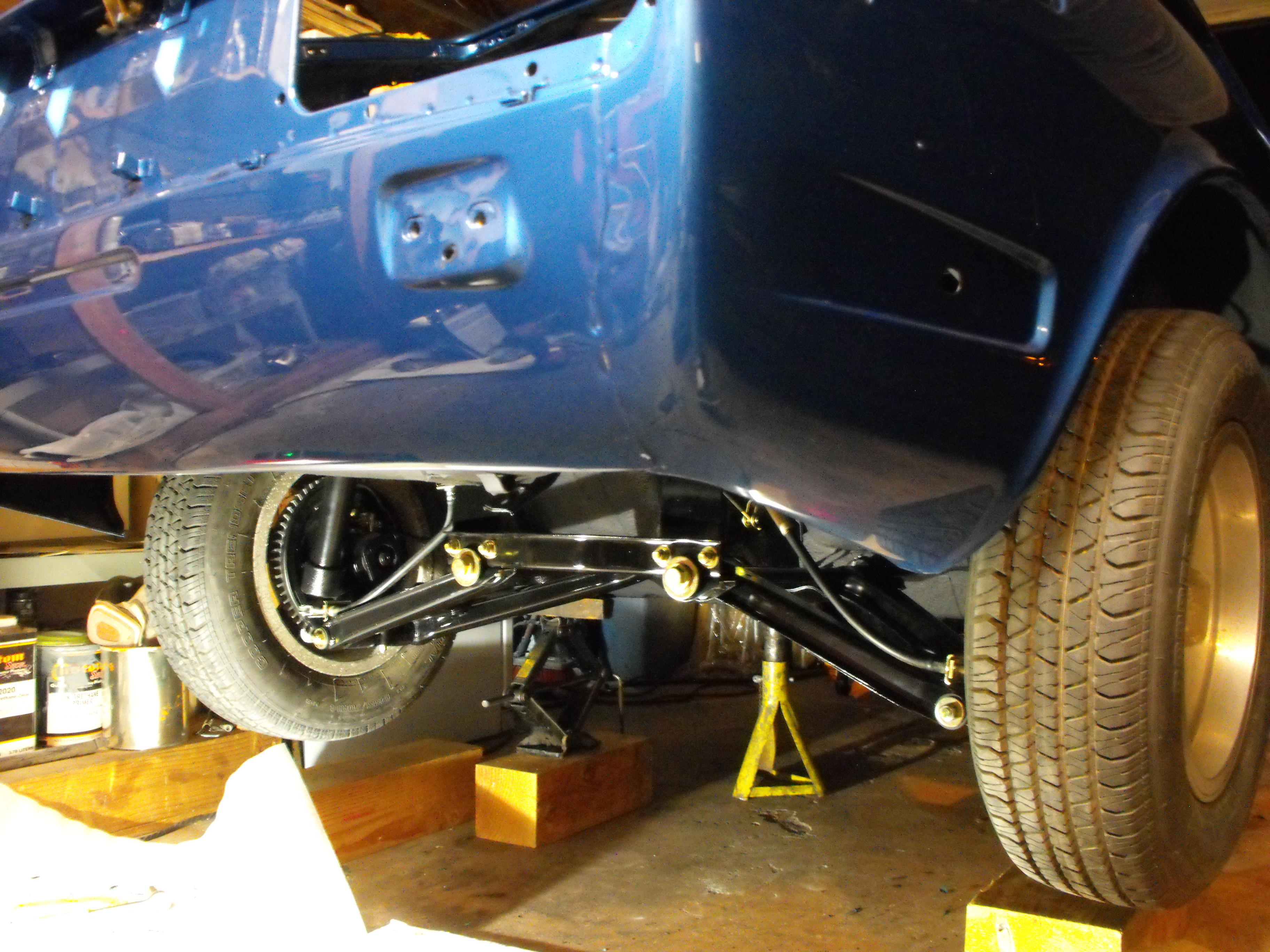

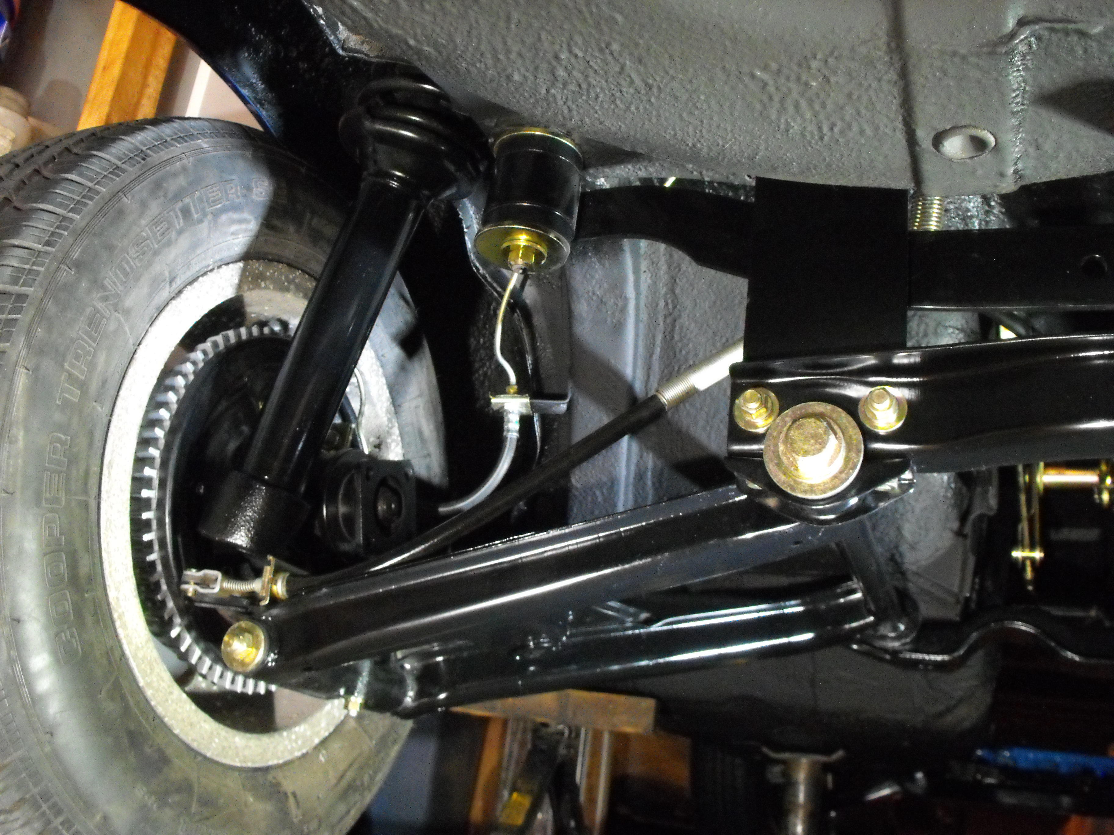

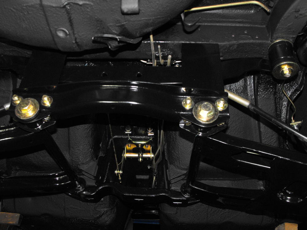

Put the rear suspension in this evening. Borrowed a couple tires for the rear.  Two more Bridgestones will be here on Saturday, so this is temporary.
Lighting is funny as always.  The undercoat looks gray.  It is actually flat black.

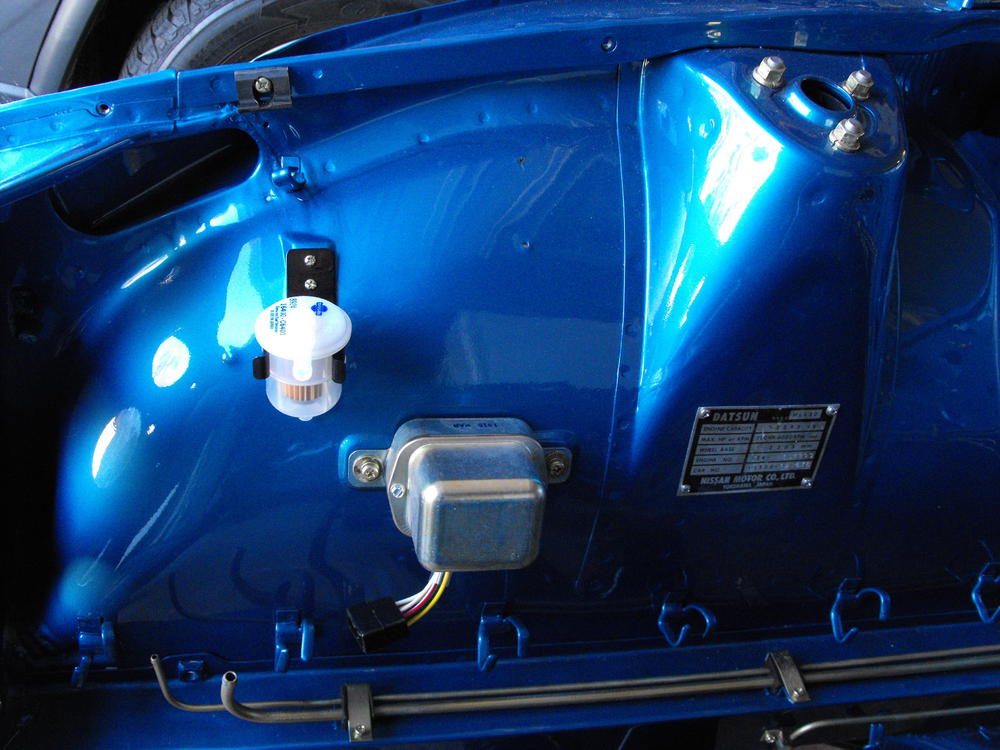

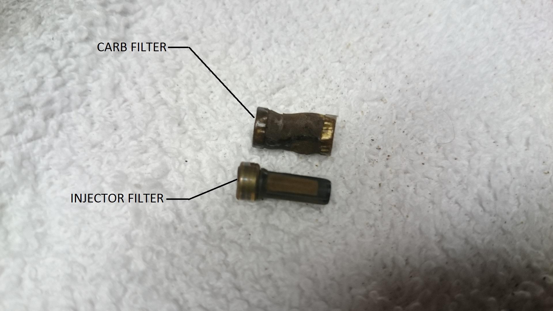

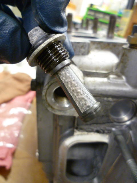

Forgot to mention... I took a couple minutes to look into the possibility of modifying the hex cap to be able to use injector filters instead of the original carb filter, and I came to the conclusion that it's not feasible. Using a custom cap with a recessed area to accept the closed end of the filter seems like it would work, but the problem is the other end. There diameter of the injector filter is just too small and interferes with the raised lip down inside the carb body that's supposed to align the non-cap end of the filter.
On ‎2‎/‎12‎/‎2019 at 11:37 AM, motorman7 said:
I was looking at some old pics from other cars for unrelated reasons though and turned up a pic of a variable valve timing oil filter. This is from a 2006 Hyundai 4-cyl Tiburon. Not the right size, but maybe could be modified to work. Or I wouldn't be surprised if there was something out there in a different car (with oil controlled variable valve timing) that has something that would be closer.
Here's the one from the Hyundai:
A nonpareil knob there Capt'n!   LOL

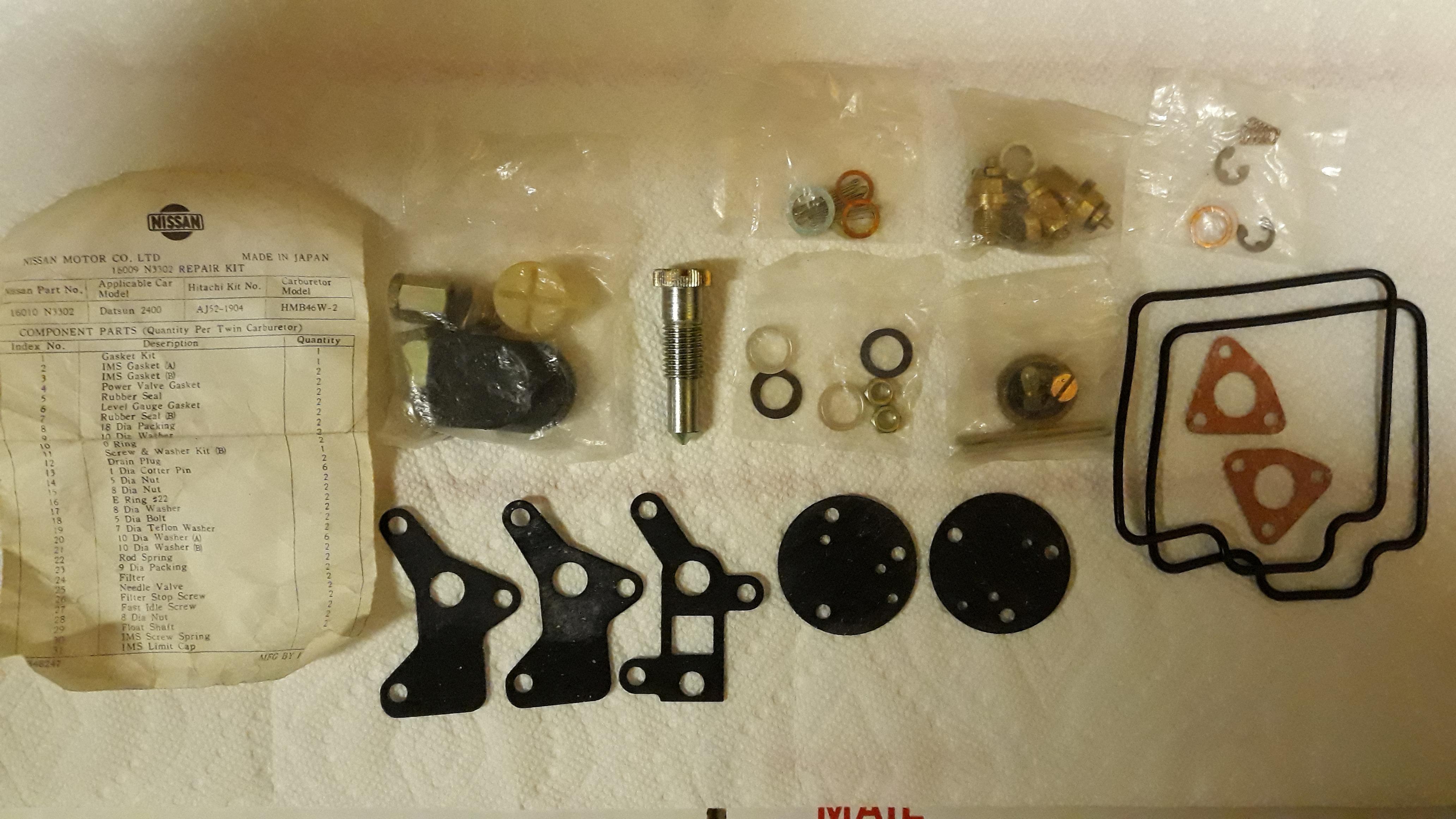

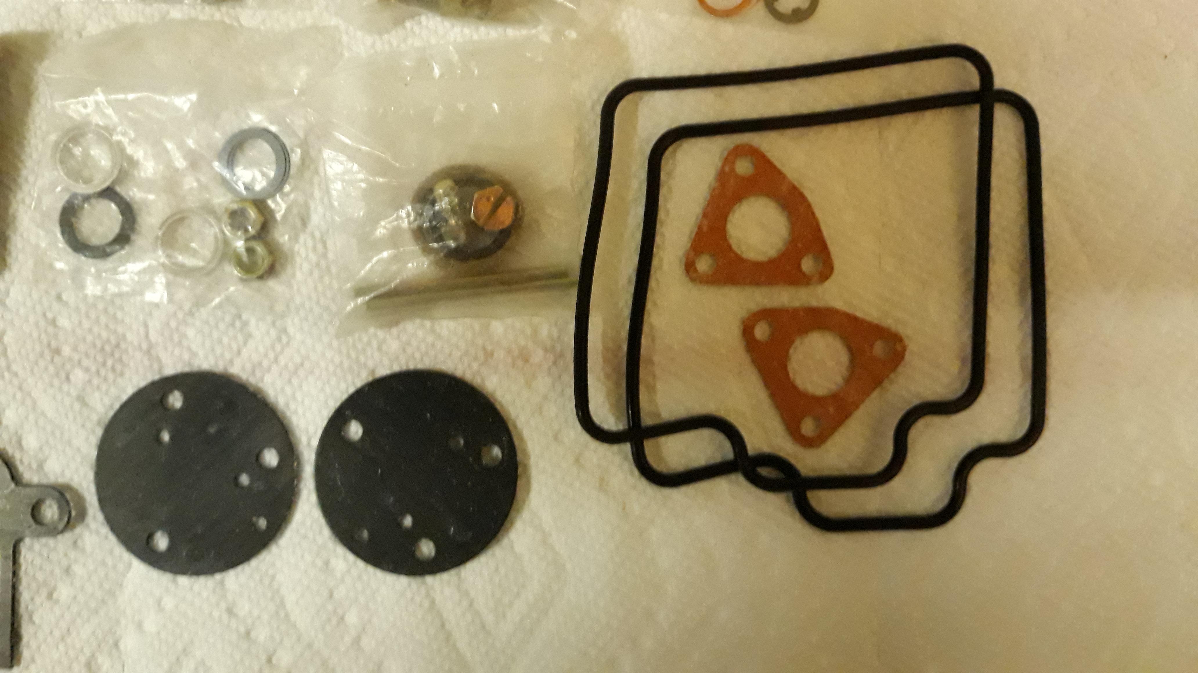

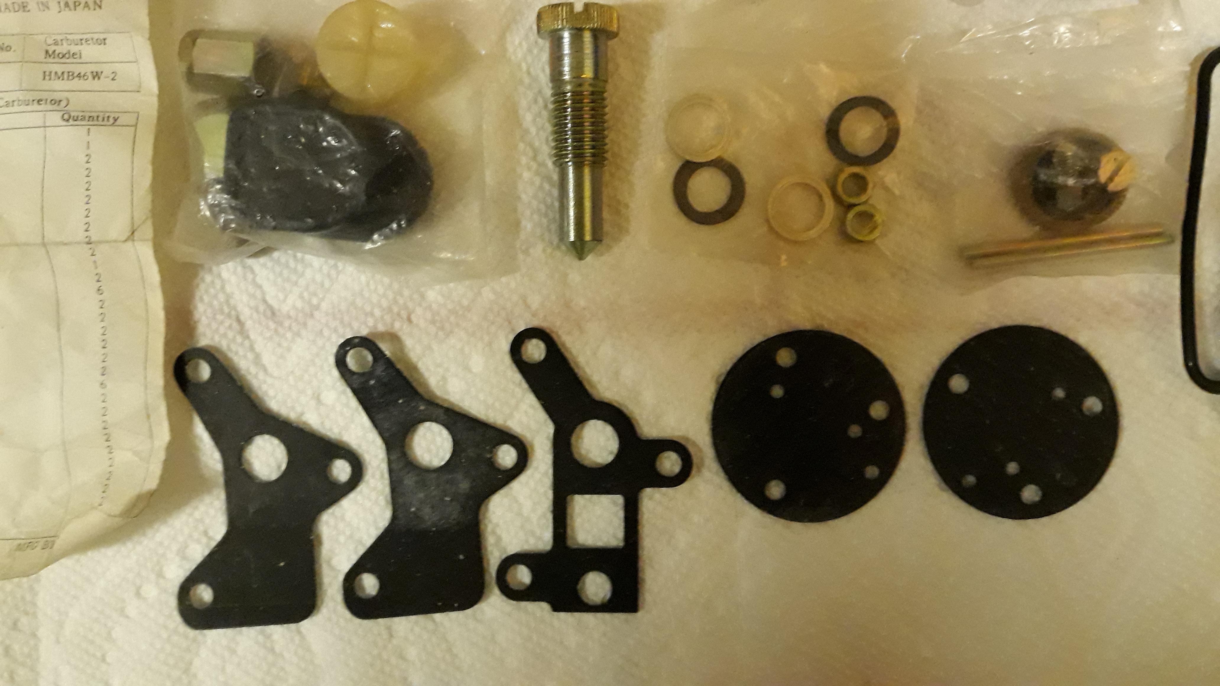

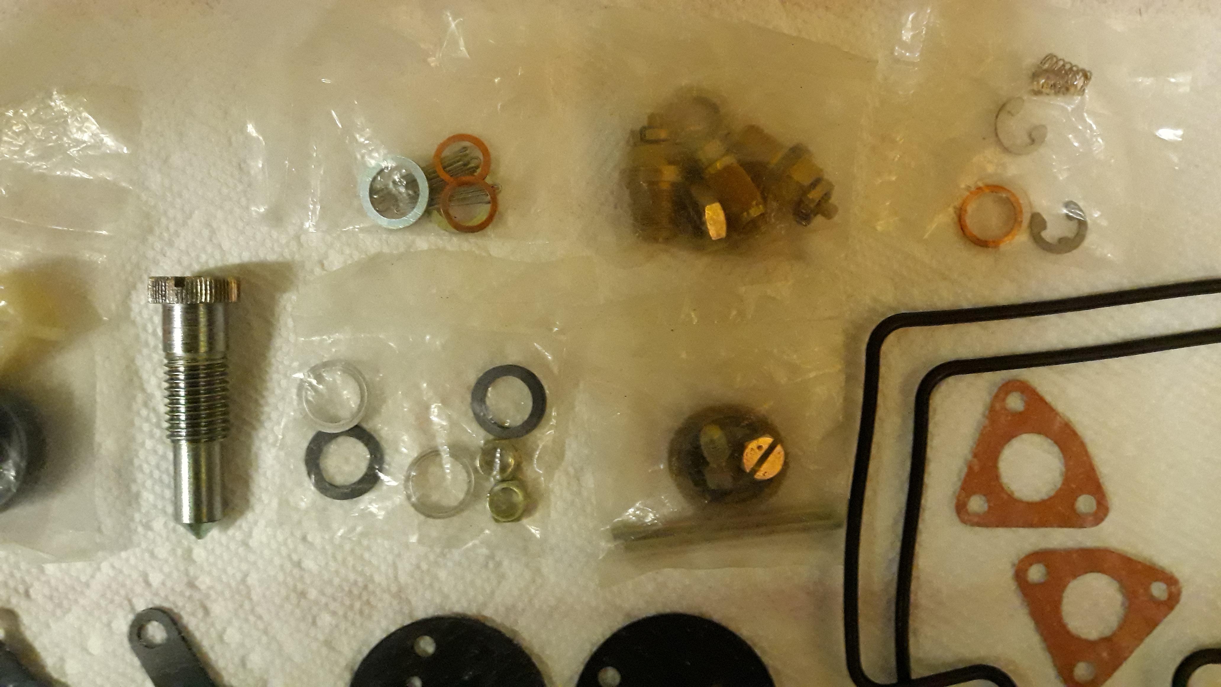

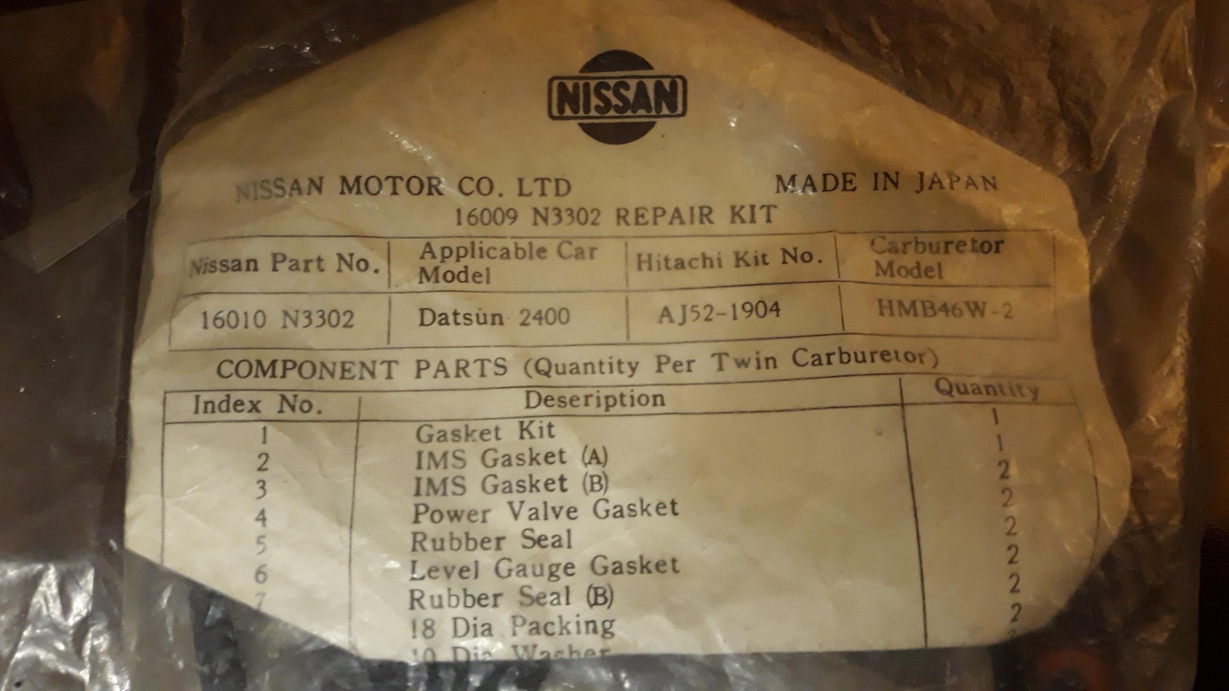

Regarding the HMB46W (flat top) fuel filters:
In post #265 Rich said
Quote
"Also need to look into getting new fuel filters.  Do they exist?  Surprised those are not in the rebuild kit."
They do/did exist and are/were in the rebuild kit.
Nissan Part No. 16010-N3302
Hitachi Kit No. AJ52-1904
A complete rebuild kit for both front and rear carbs.
This is the only one I have found and I feel extremely fortunate to have it.
Probably not many of these around now, but you west coast guys may have better luck finding a source out there in the "Land O' Plenty".
There may be some in Australia and New Zealand, as the 260z was sold there for many more years than in the USA.
At least now you have the part numbers to assist in your efforts to find them.
Good Luck!
