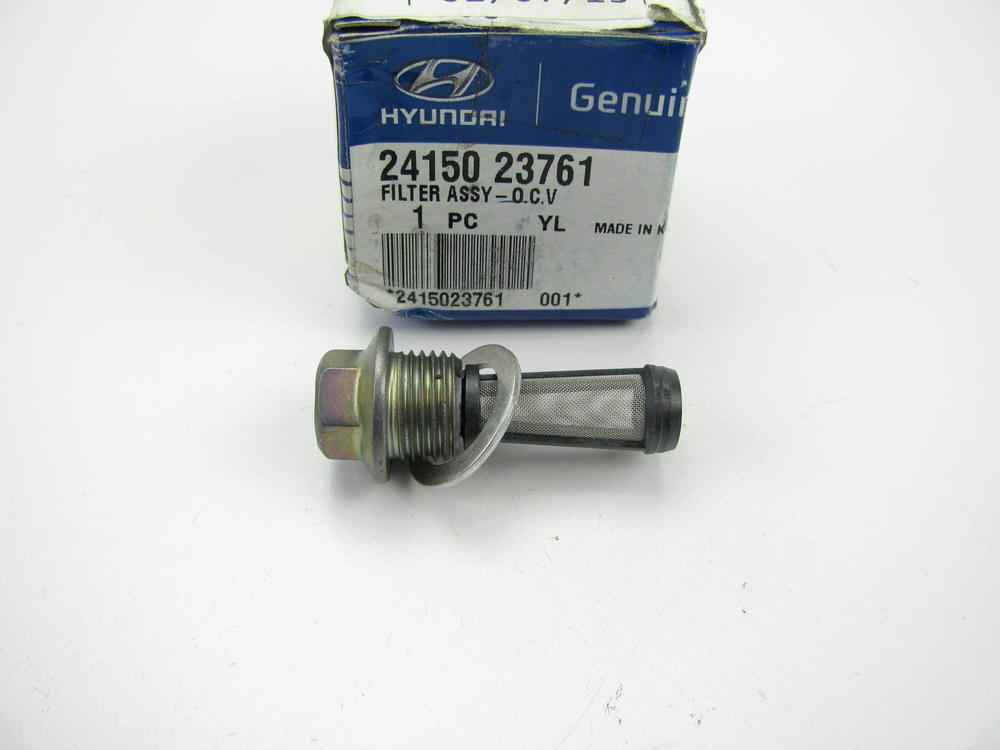

I was poking around on ebay a little today and here's the parallel filter for Toyota's valve timing system. This one has fingers on the interior end that could be cut off if desired:
And another shot of the Hyundai part. This one has that nice tapered seat at the interior end:
The point is... The threaded hex caps are relatively easy to make. If you can find a filter with the open end that's the correct diameter to seal on the face down inside the carb body, you could have a cap made for the other end to account for a slightly different length. I wouldn't be surprised if there wasn't something out there that's close to what you need.
