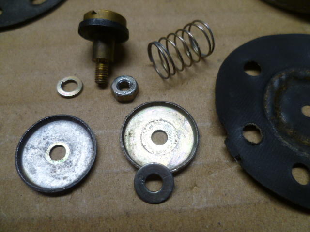

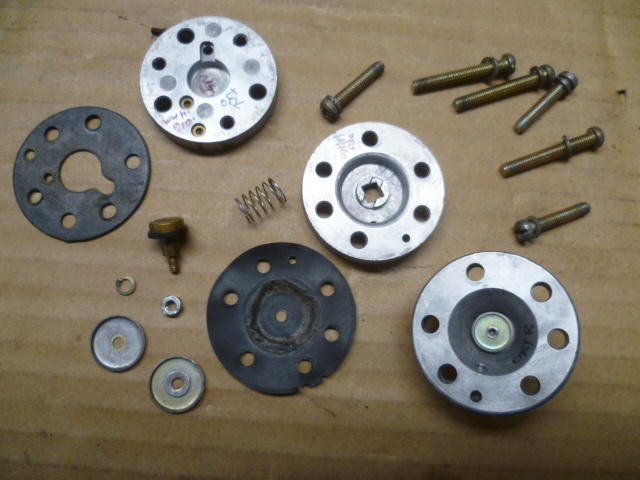

Glad to help. Here's some pics. This is all the parts for the power valve:
And here's a close-up of the washers in question:
Here's the parts assembled on the sealing bolt sans diaphragm. The diaphragm goes between the two large washers:
Good luck!!

That's awesome. I'm in Vegas for work this week, but will start soaking mine when I get back this weekend. thanks again!

I had some family things going on that kept me from getting back to this right away, but I've tried soaking mine and I don't think mine actually come apart. The way they go together is quite different from yours in the pics above. Mine don't have a bolt through the center holding it together. I've added a few pics of mine. Do I have a different model of some type?
I think I see the divot from the original lock washer dug out of the one washer. Something has to go through the middle. I'm thinking you misplaced some parts?
BTW, that float valve does not have anything to do with the power valve, right? It's only in those pics to show scale size or something?

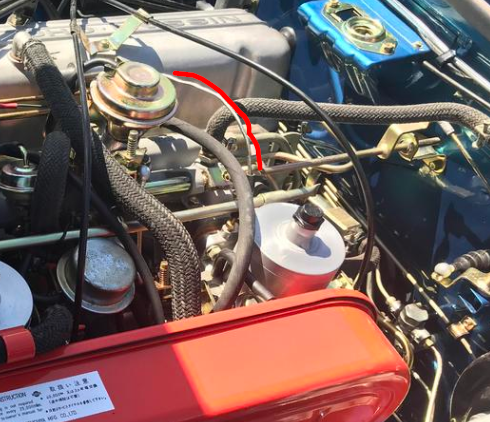

Jaw dropping fantastic! It's been almost 30 years since I had my 73, but I don't remember this smallish tube that I've marked in red. What is it?
That is a small metal vacuum tube that goes to the EGR valve solenoid.  It's a bit kinked, but still functional.

I was surprised the we were marked off for the bead blast finish on the valve cover and intake manifold.  I thought that looked pretty close to stock that way, but apparently not.  I wonder if all judges would mark that off or if it was just this judge.  Personally, I thought the flat tops were too shiny and we would get dinged for that. We were also missing a few small vacuum tube clamps.   That has since been corrected along with the kinked hose that has now been replaced with the correct hose (Thanks @Zup ).
