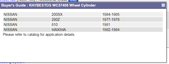

OReilly Auto has them for about $22.  Just realized that there are zero Oreilly's in the Philadelphia area.  Must be some mafia thing.  Weird.  But, the local auto mafia, whoever they are (probably the same crew that sells beer by the case from open warehouses), probably has some.  They're not that NLA yet, I think.
https://www.oreillyauto.com/shop/b/brake-systems-16456/brake-hydraulics-16513/wheel-cylinder-11318/5020ef8206ed/1978/nissan/280z?q=brake+cylinder

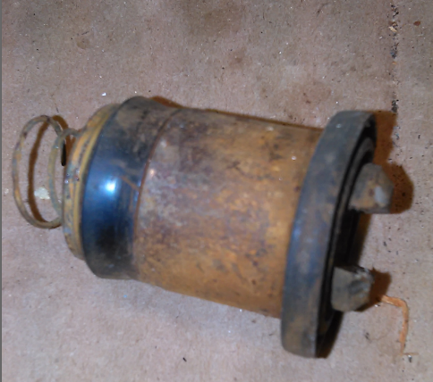

I wonder if the Wagner cylinder is a reman, so they covered the "Made in" mark.  I'm fairly certain that my rusty piston is original Nissan.  So, in 1978, probably made in Japan.
Seems odd that Wagner made molds and had a process for casting Nissan replacements, for a fairly limited number of vehicles.  Things were different back then, I guess.
