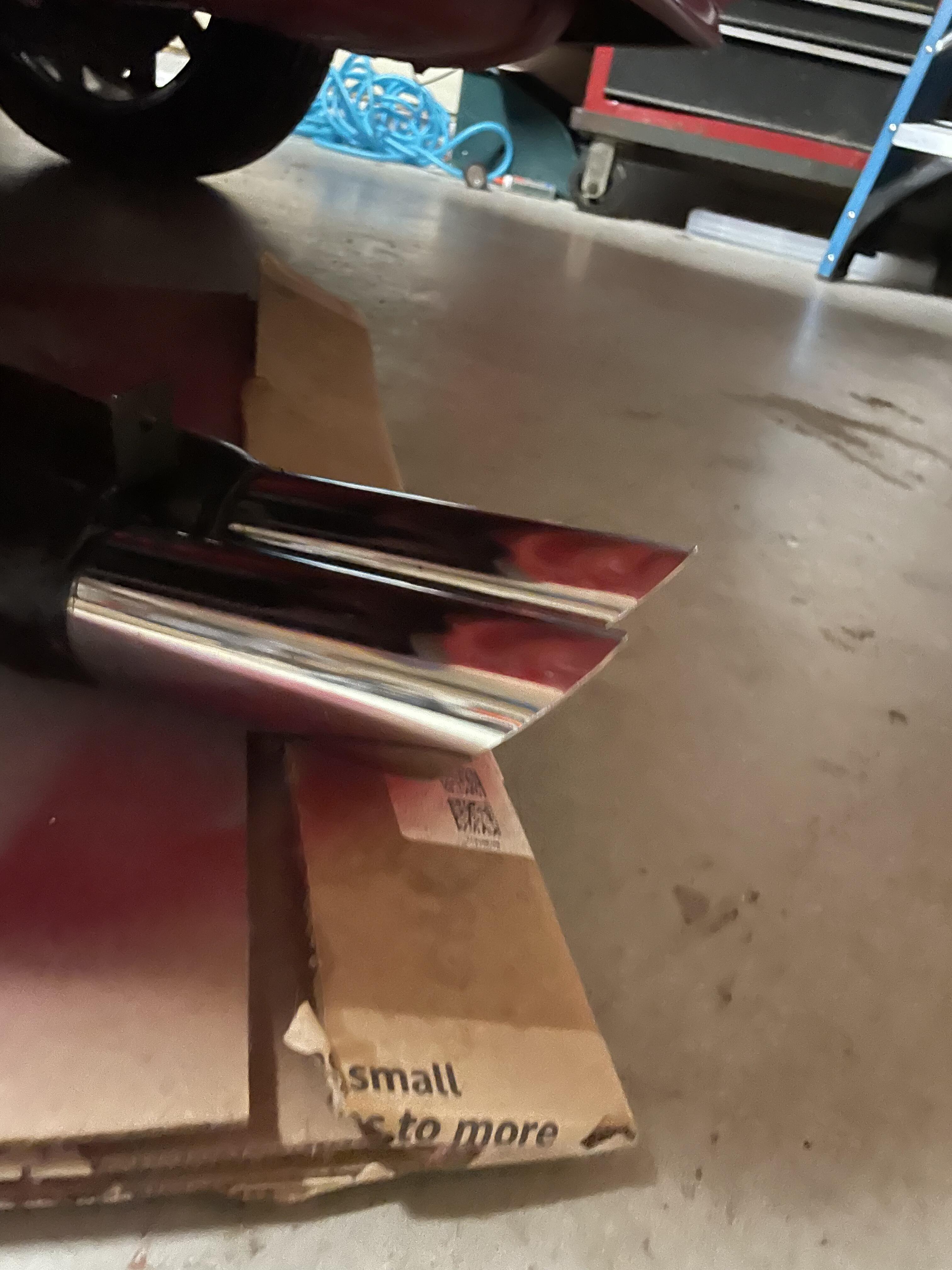

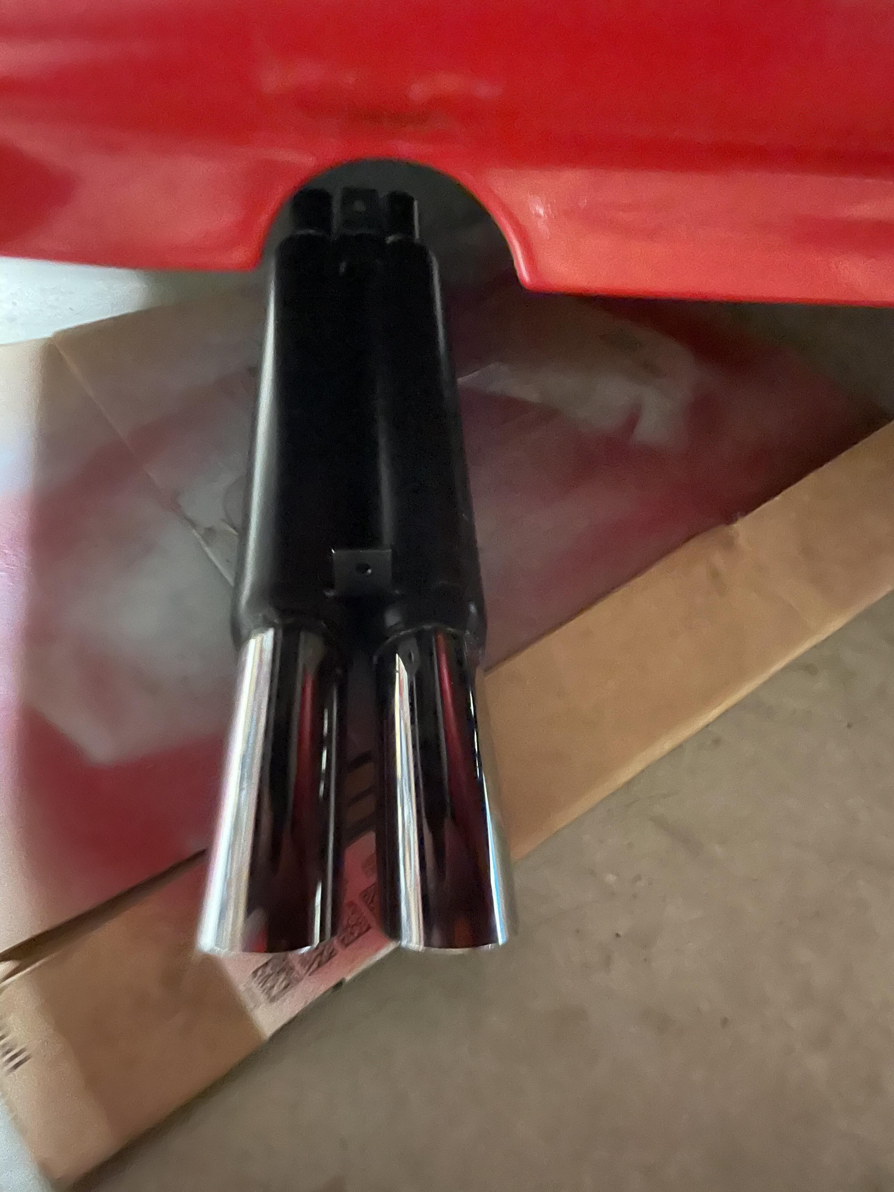

twicepipes arrive tomorow.

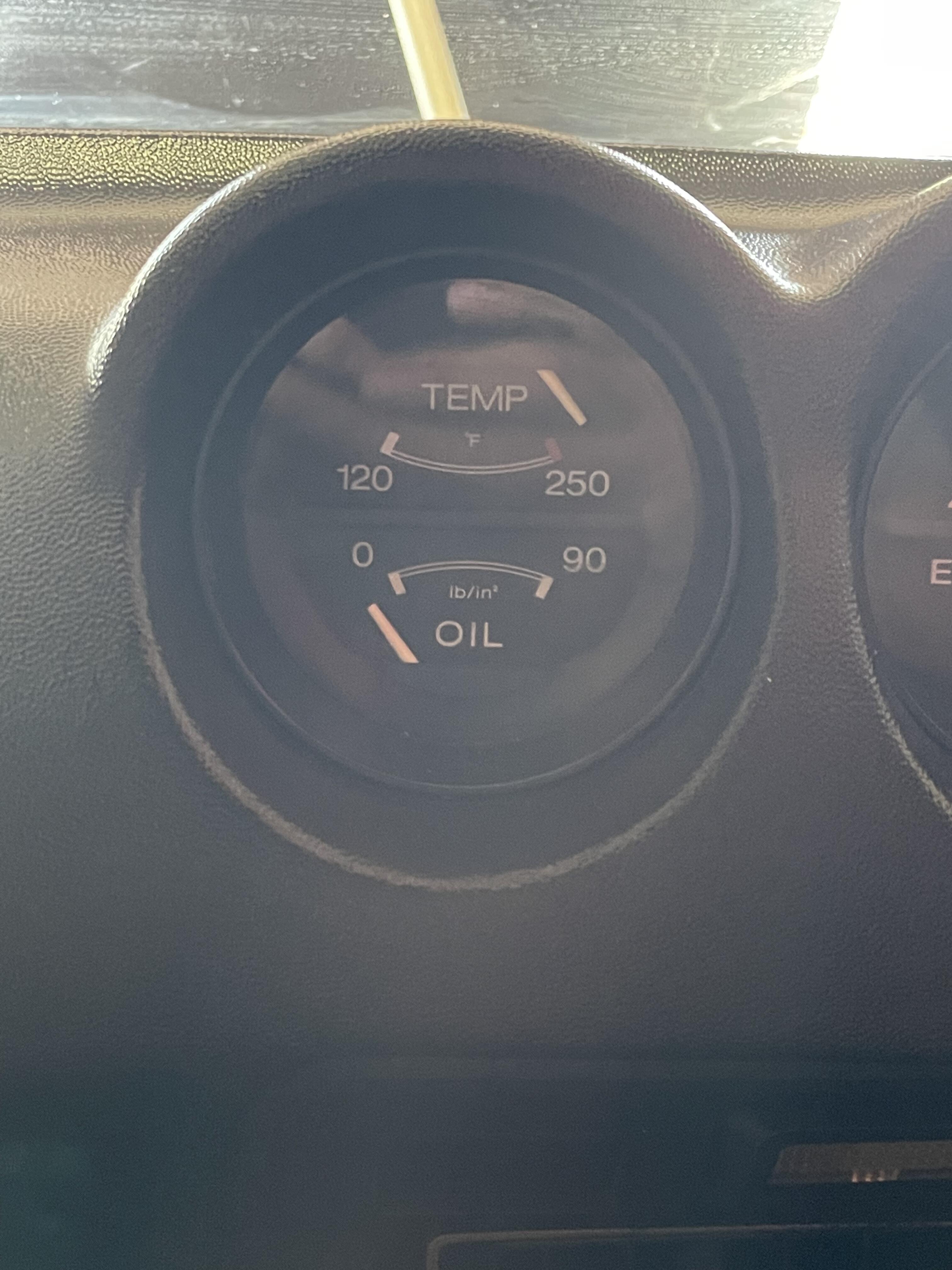

Had a friend stop by. Engine tan for 10 minutes. Smoking, but we figure it’s not engine related and most likely dust/ceiling insulation that fell into the header heat shield over the last 15 years while garaged.
Temperature gauge isn’t working, but he had a thermal gun and was able to determine it stayed roughly 176°.
troubleshooting shows the Guage works, and the sensor has resistance and should theoretically work, but while car is running the gauge doesn’t move.

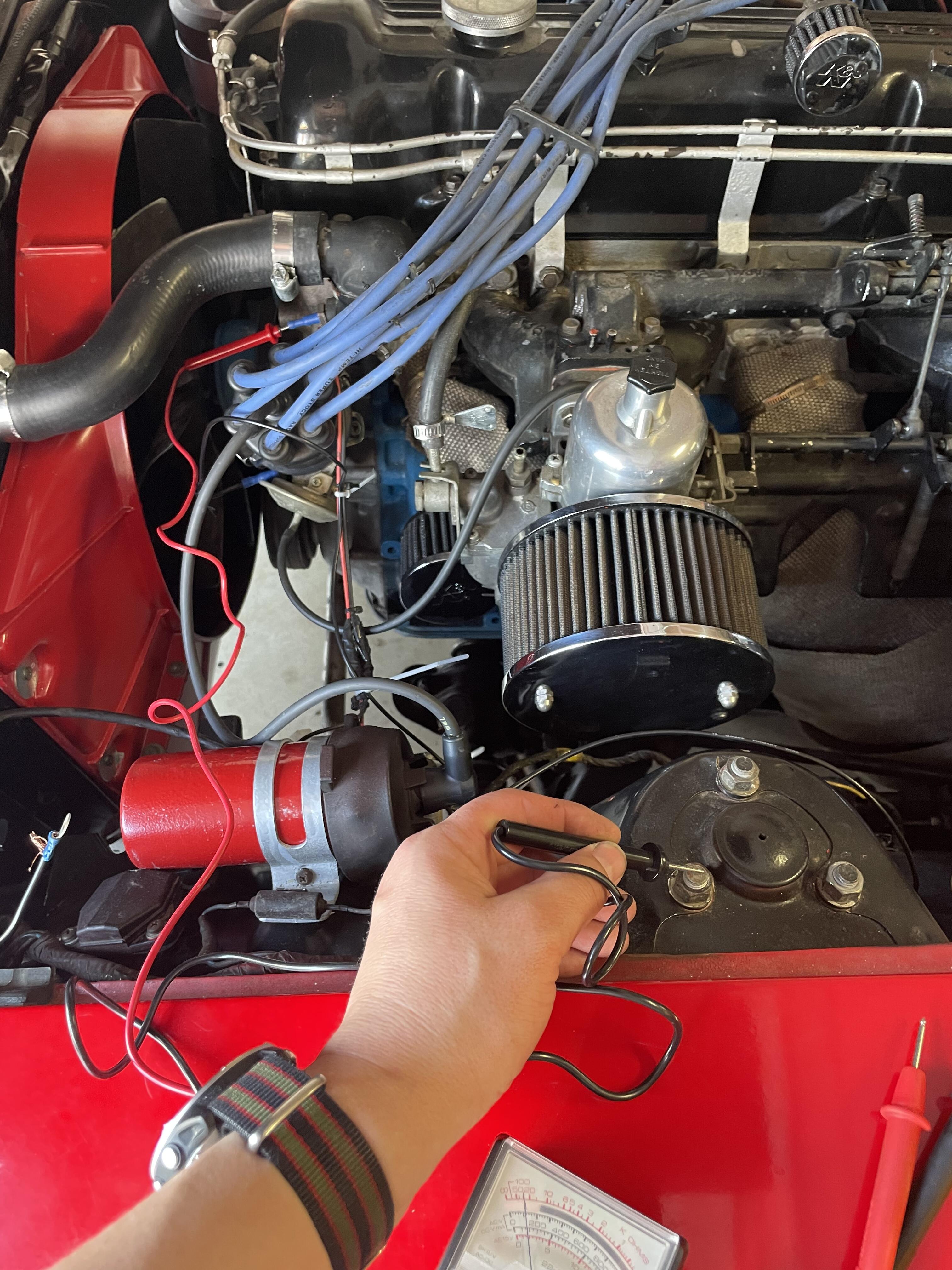

It was too windy yesterday for me to sit and let the car come up to temperature. I was driving it today, so I did before and after photos.
The interesting thing is the narrow band in resistance between stone cold and operating temperature.
Cold:
Operating temperature (from a very nice drive today)
Ran the car for 10 minutes. Checked the ohms with two voltmeters.
no readings. I changed the wires and checked the grounds. Started the car again and it crept to the 120° and then went back down. Radiator is of course hot to the touch.
