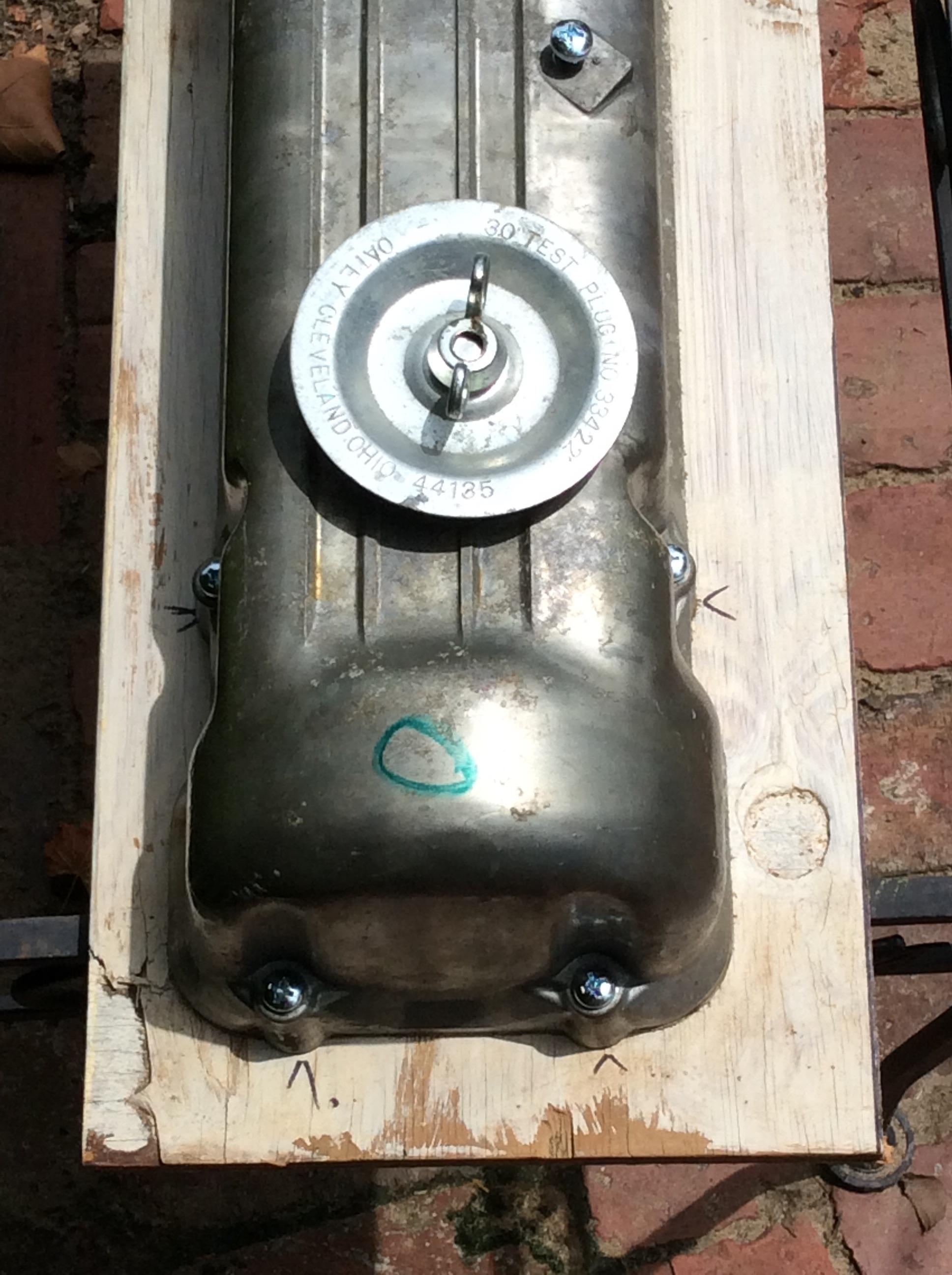

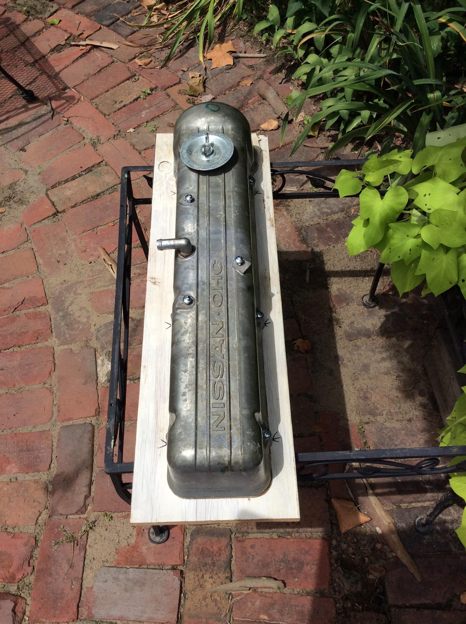

Many thanks! I mounted my valve cover on plywood too. Used an old sewer plug for the oil cap opening. Plugged the rest of the holes with 6 mm dummy fasteners. Not sure how to plug the breather pipe. I’d rather not take it off as it looks like it’s really on there and a new fitting is pricey..

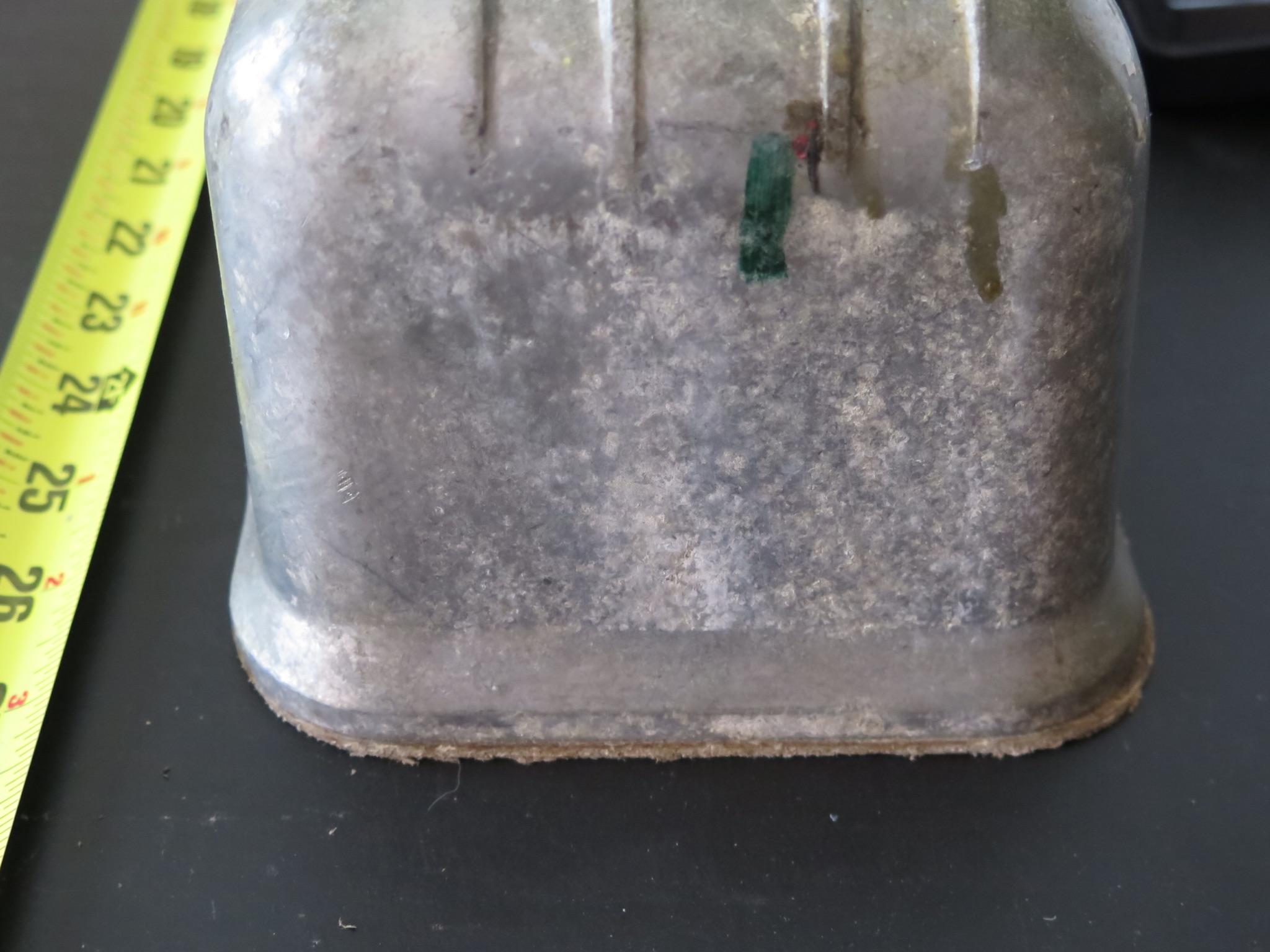

Also, take note of the greenish blue mark beneath the cosmoline. Must have been made by the factory in 1980. Is there any significance to keeping this as I want to keep as much originality as possible. Would I loose points at a car show if it has been removed during cleaning?

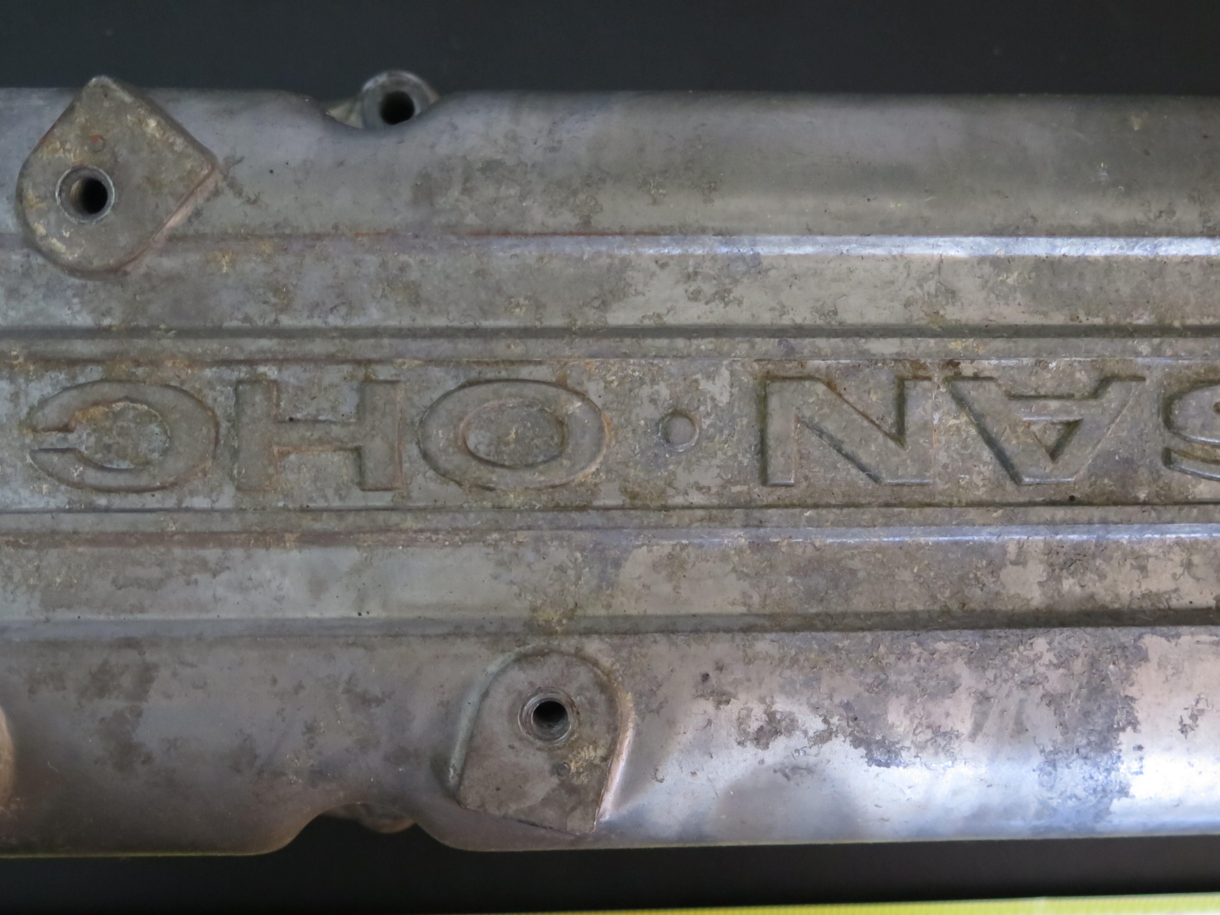

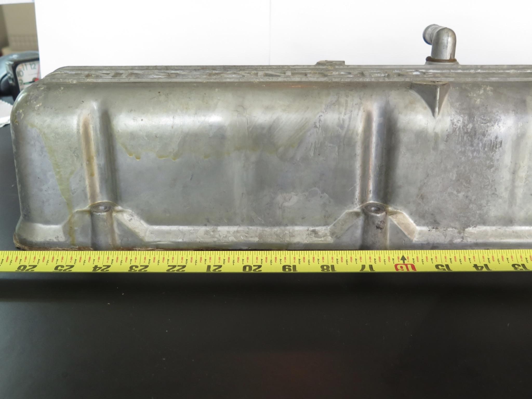

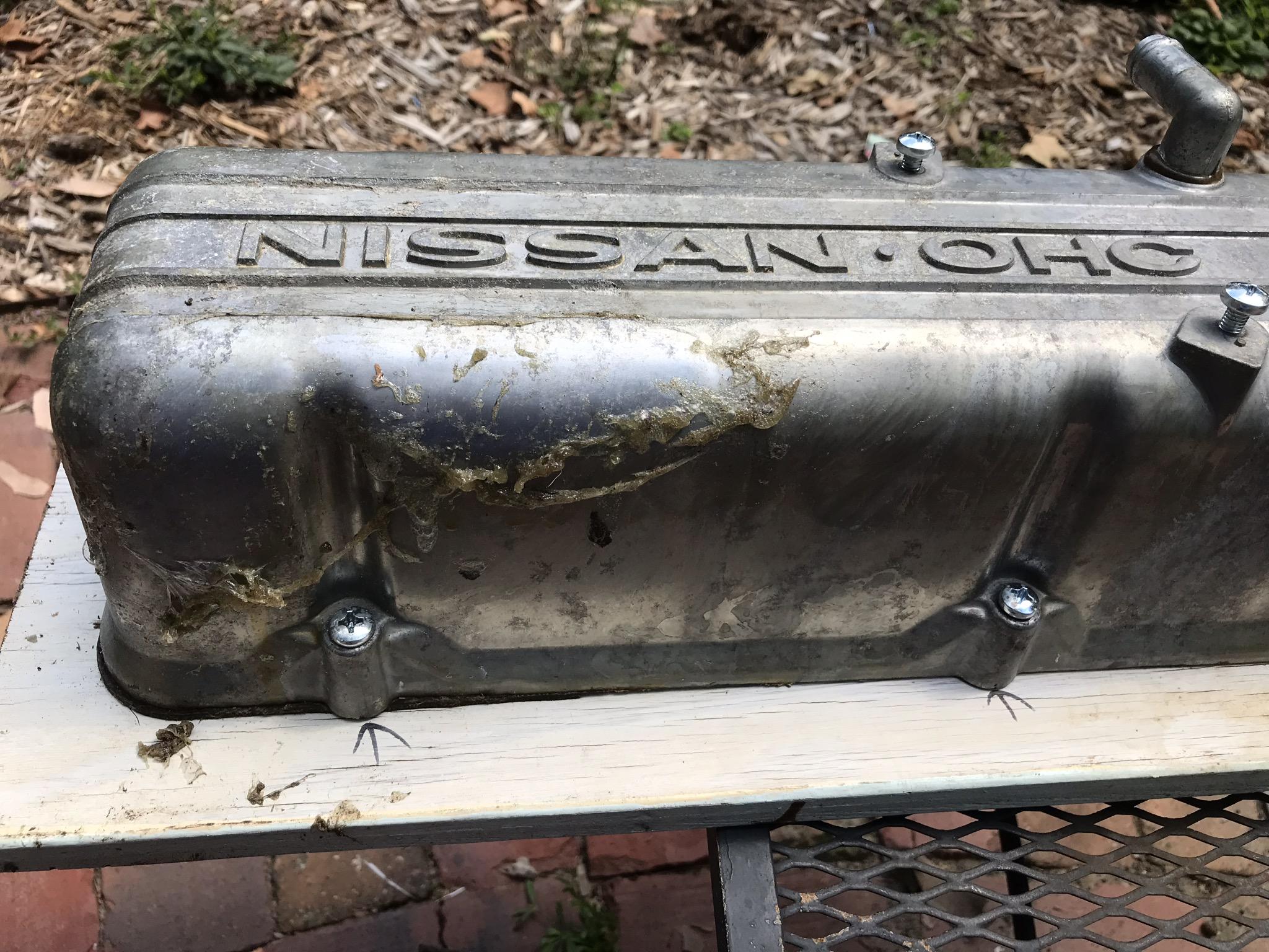

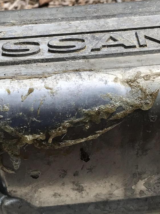

Hmm. This is the valve cover “before” doing any cleaning. It’s under the cosmoline. Looks nice in some places but some mouse urine corrosion on the side of the valve cover near the intake manifold. Mice built a huge nest on the manifold. Car sat for 15 years in a farmhouse garage. 25,600 original miles. Had to rebuild engine which I hope to get back today so I can start putting everything back together.
I always kept it garaged but mice got into the engine compartment. Massive nests on the intake manifold and in the ventilation squirrel cage blower (another problem). And of course the mice loved the exhaust pipe too.
Maybe I should mask off this mark. Also there is another mark on the other end of the valve cover that I should mask before cleaning?
Another option is “do nothing” but not sure how it would fare in a show.
Comments are appreciated!

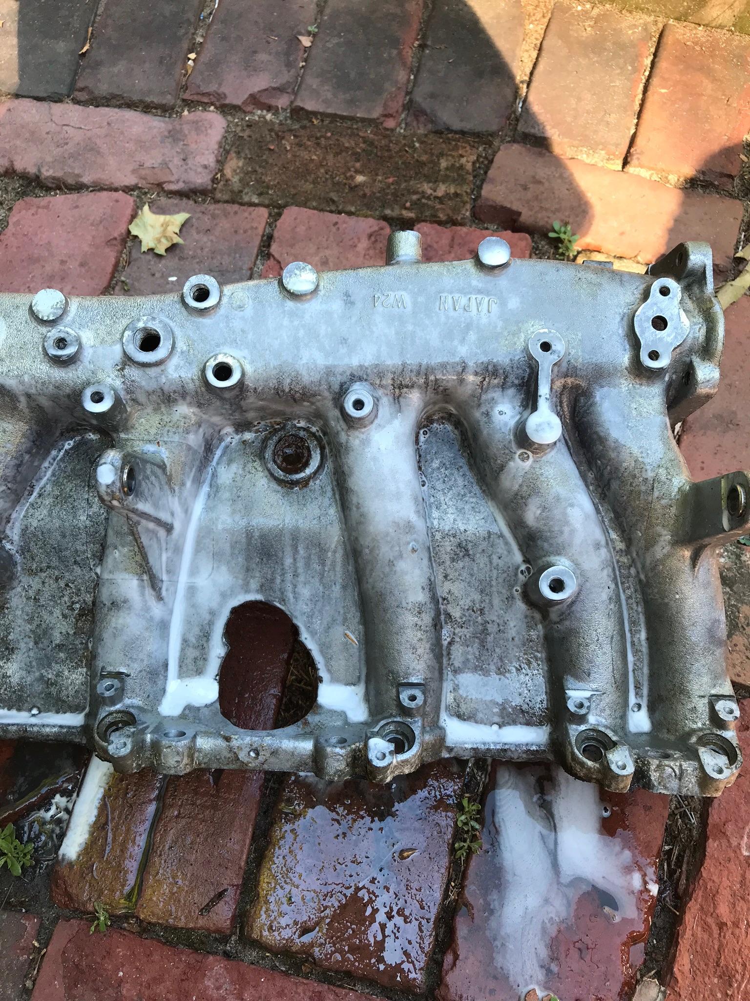

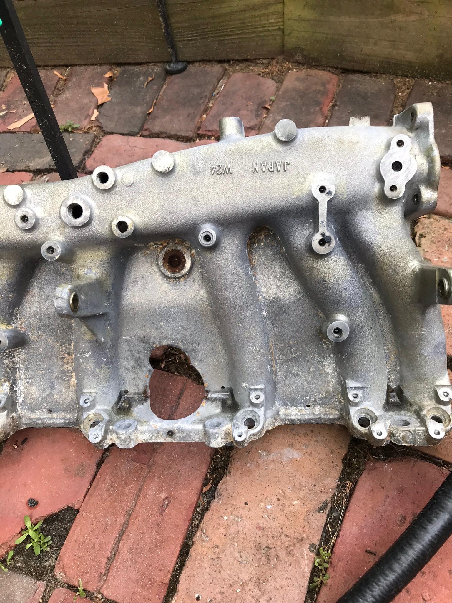

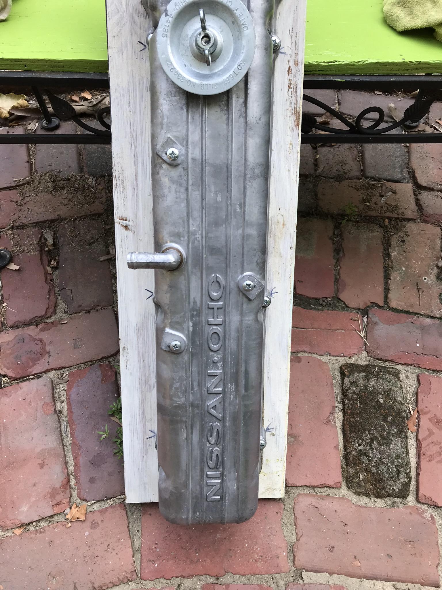

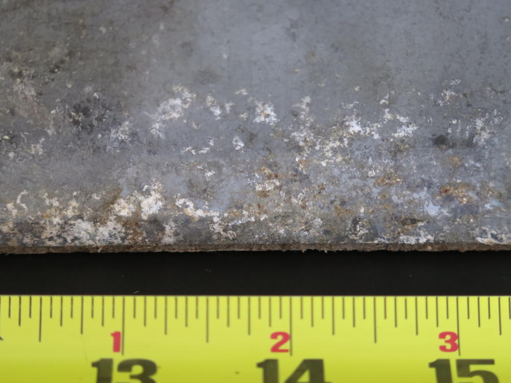

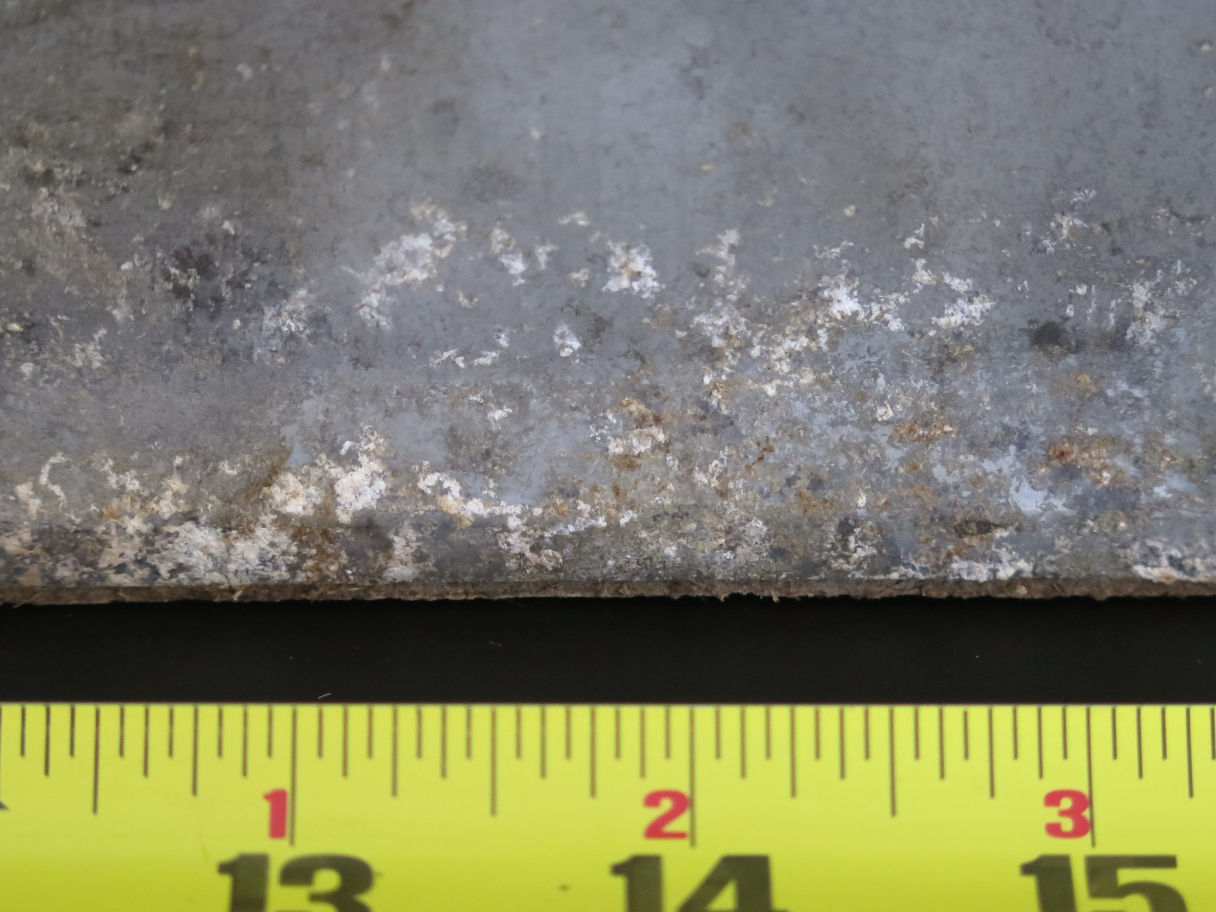

The Sharkhide doesn’t do squat on the cosmoline/ urethane. It did well on cleaning my manifold. But it’s slow. Like watching corn fields grow. See the two photos, before and after. But not finished yet.

Great news to report on valve cover cleaning. I’m using a variety of chemicals and I’m constantly watching it, never walk away when doing this.
I’m using “Zip-Strip” Premium Paint and Finish Remover, Mineral Spirits in a chemical spray bottle and a very fine powdery cleanser called “Bar Keepers Friend” with water.
Results are amazing. Takes the lacquer / cosmoline off and beneath is a very nice aluminum surface.

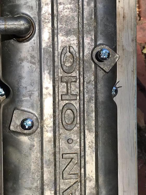

I still need to get the cosmoline off the edges of the letters on top of the valve cover and do more light scrubbing with Bar Keepers Friend before I spray it with Sharkhide aluminum cleaner and then with Sharkhide aluminum protectant.
Here are a few photos. More to come.
