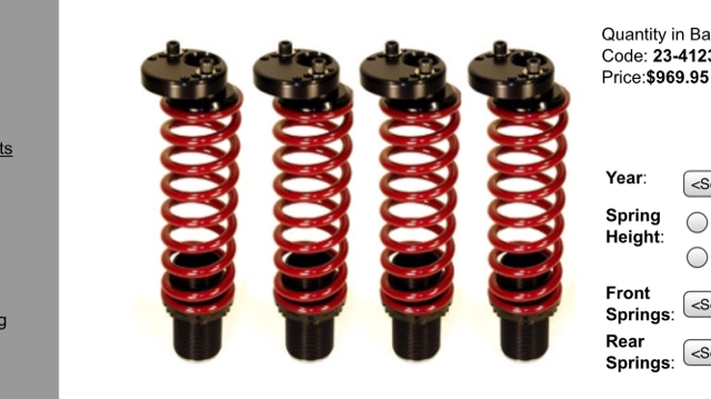

Those are just 2.5" springs with universal 2" collars and DP Racing camber plates. You can save a few bucks sourcing the parts separately. You will have to modify your strut housings, there are lots of threads on HybridZ about strut sectioning and building your own coilovers.
I have the same camber plates. They're great if you don't want to cut up your strut towers but they limit adjustability to just the 4 settings (plus a few more if you get creative).
