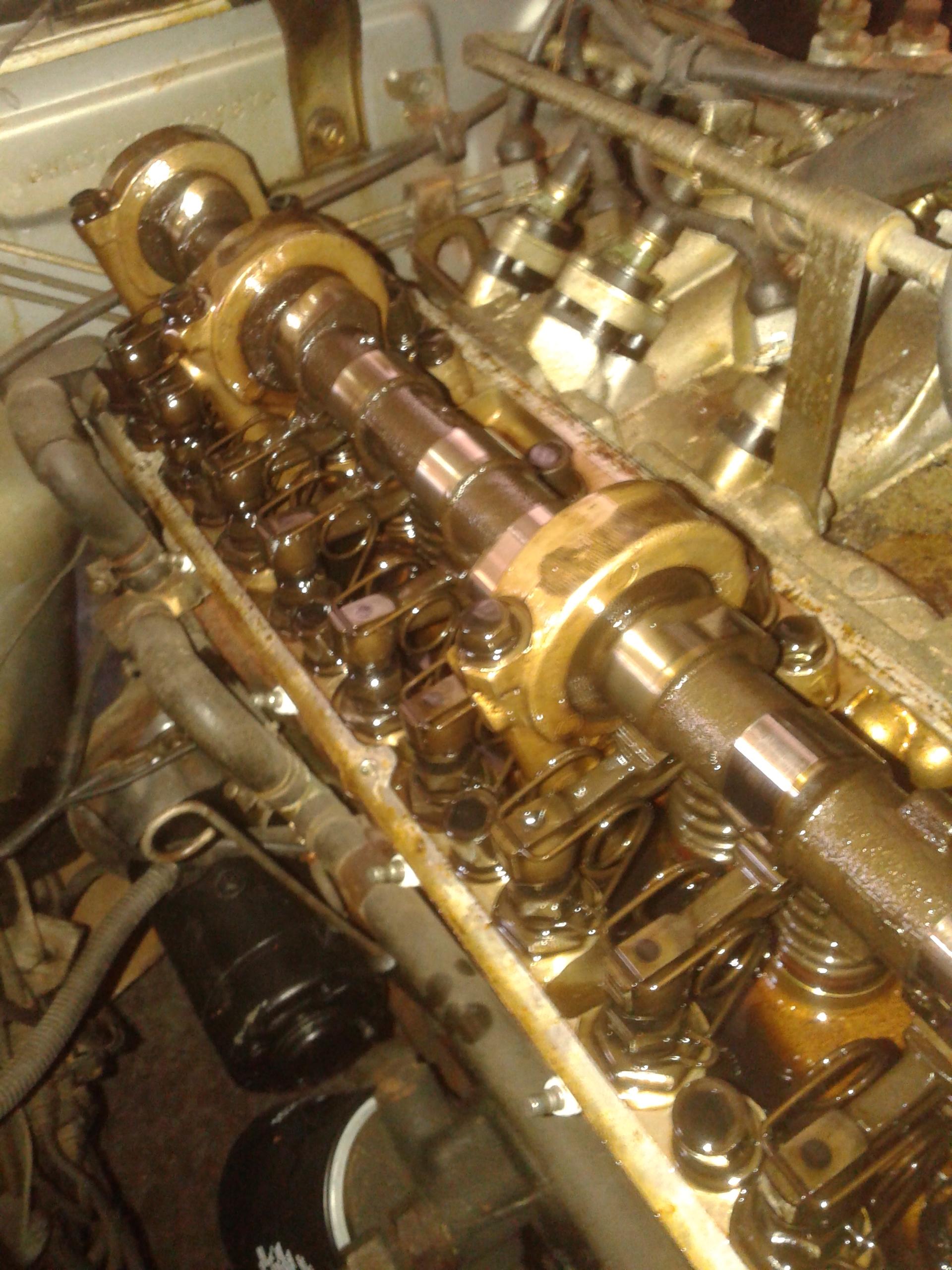

16 hours ago, siteunseen said:
N47 was the first oiling cam as far as I know, N42 had spray bars.  My 9/'76 N47 had both
Nope... N42 in my euro 280zx from early 1979..   ('79 was it's first year in the Netherlands! )  was already a self oiling cam..
