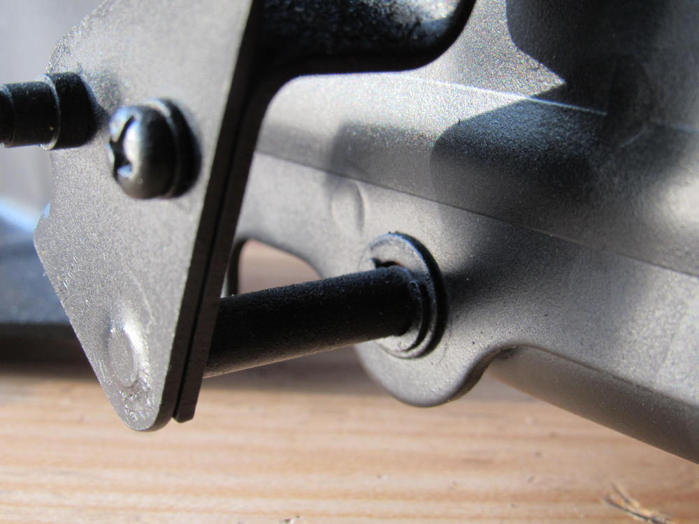

One Way Posted July 28, 2018 Share #1 Posted July 28, 2018 Continuing to rebuild the smaller components on the 78 resurrection project. There are a few small pin holes that can be easily repaired in the fan housing. Fan motor bench tests very nicely. Will be needing new foam seals throughout the assembly. My main concern is the housing section with the door that opens and closes. It is badly rusted and seized. I am soaking it in BLASTER over the weekend and hope to tackle this project on Monday. It is so badly rusted it is difficult to determine how the door is attached to the pivot shaft. My plan was to remove the shaft and fabricate a new door and seal material. It is very strange as we dig into this car and find so many pieces beautifully preserved at 40 years old and other parts right next to them are so badly deteriorated. So many of the other components in this heater system look like brand new with just a quick cleaning. Thanks for any helpful ideas, John-Lugoff, SC. Link to comment https://www.classiczcars.com/topic/60458-blower-fan-box-78-280z/ Share on other sites More sharing options...

grannyknot Posted July 29, 2018 Share #4 Posted July 29, 2018 (edited) John, there are two C clips on the hinge shaft for that door right up against the housing, pop those off and there should be enough room to slip off the short end of the shaft and hopefully get a look of how that door is attached to the hinge shaft. Pretty tight in there. Edited July 29, 2018 by grannyknot Link to comment https://www.classiczcars.com/topic/60458-blower-fan-box-78-280z/#findComment-554070 Share on other sites More sharing options...

One Way Posted July 31, 2018 Author Share #6 Posted July 31, 2018 As usual, BLASTER did it's job. Very slight persuasion with the pliers got the hinge and door moving freely. After rotating I was able to see 2 small Phillips head screws, or better stated, what was left of 2 Phillips head screws, attaching the door to the hinge pin. Some heat and patience got the screws removed and the shaft came out easily after removing the small E clips as suggested in the previous post. Unfortunately a new door will have to be fabricated and will have to source some type of foam covered with a vinyl material that was on both sides of a badly rusted door. The more difficult part may be the hinge pin. One section of it is 30-40% rotted away. That will be a project for another day. Keep the helpful tips coming, especially for what would be an available material suitable for covering the door. Thanks, John-Lugoff, SC. Link to comment https://www.classiczcars.com/topic/60458-blower-fan-box-78-280z/#findComment-554207 Share on other sites More sharing options...
One Way Posted July 31, 2018 Author Share #7 Posted July 31, 2018 The strange thing is that much of the blower fan housing looks almost as nice as the pictures from grannyknot but rusted out in a few areas. Hard to figure, but I will be spraying it with some rust converter followed by some primer and chassis epoxy paint. Link to comment https://www.classiczcars.com/topic/60458-blower-fan-box-78-280z/#findComment-554208 Share on other sites More sharing options...
