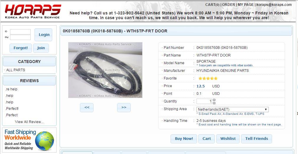

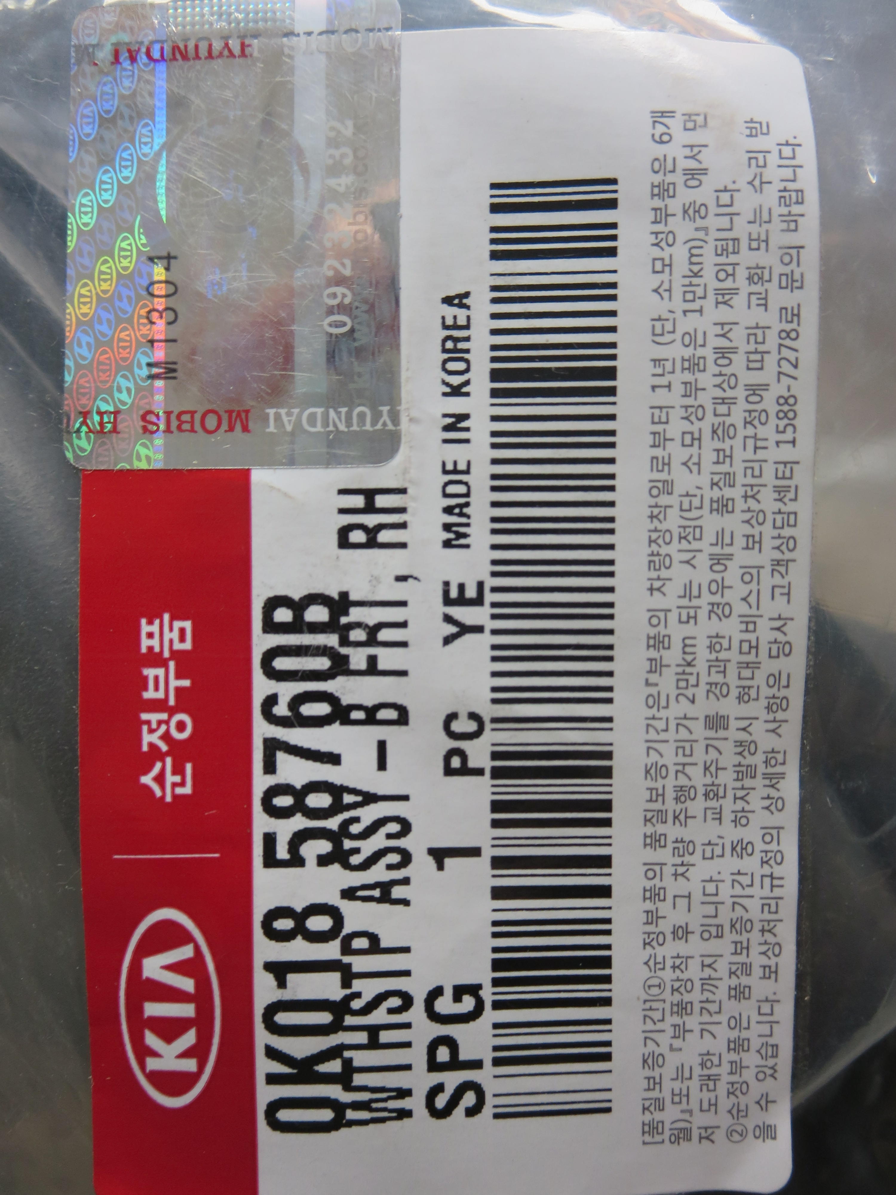

Im using the KIA sportage seal on the hatch and doors. I manage to get in in without cutting on the hatch. They need to be cut for the top back corner on the doors.
They work fine and passed the garden hose test. I have never had my Zed in the rain.
They were only $37.50 + $7,50 shipping to the netherlands for all three.
