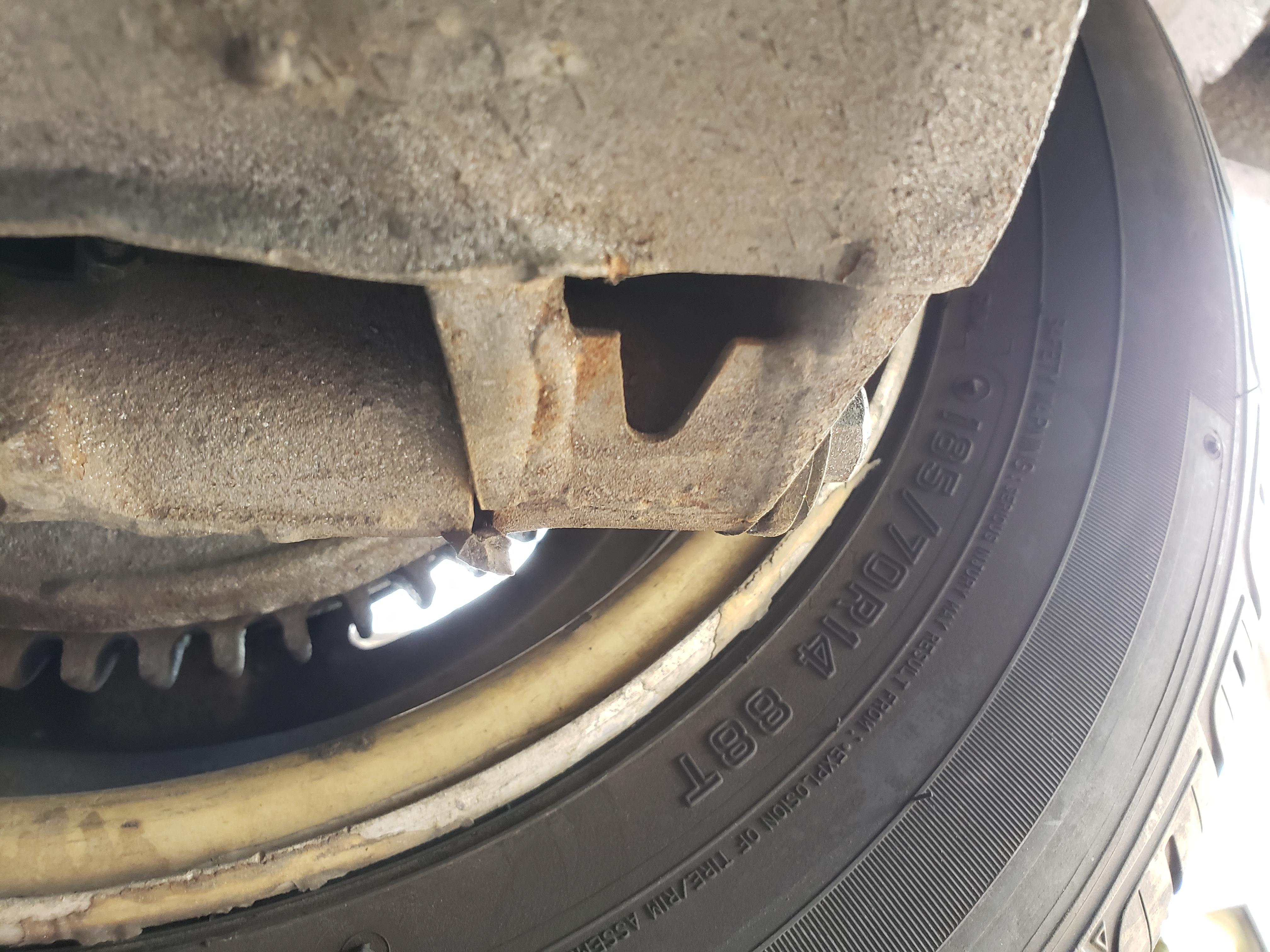

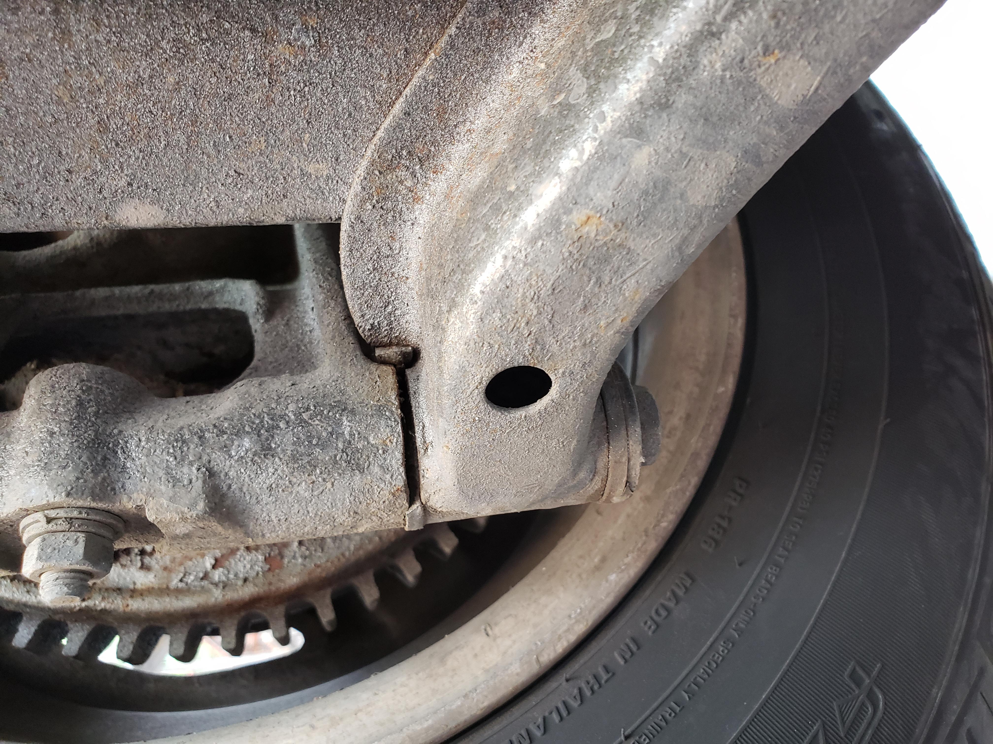

Yes.  Nissan refers to those as "Rear Transverse Link Bushings".  We mostly refer to that as the "Rear Lower Control Arm" and "Rear Lower Control Arm Bushings".  But there are "inboard bushings" (64 on the diagram) and "outboard bushings" (57 on the diagram) (or- inner and outer).  Most of us call the outboard bushings the "spindle pin bushings".
If the shop installed poly bushings, they would have already removed the old bushings and the pesky outer casing of the stock bushing.  Removing the poly bushings and installing stock should be pretty easy - depending on how the spindle pin removal; goes...
