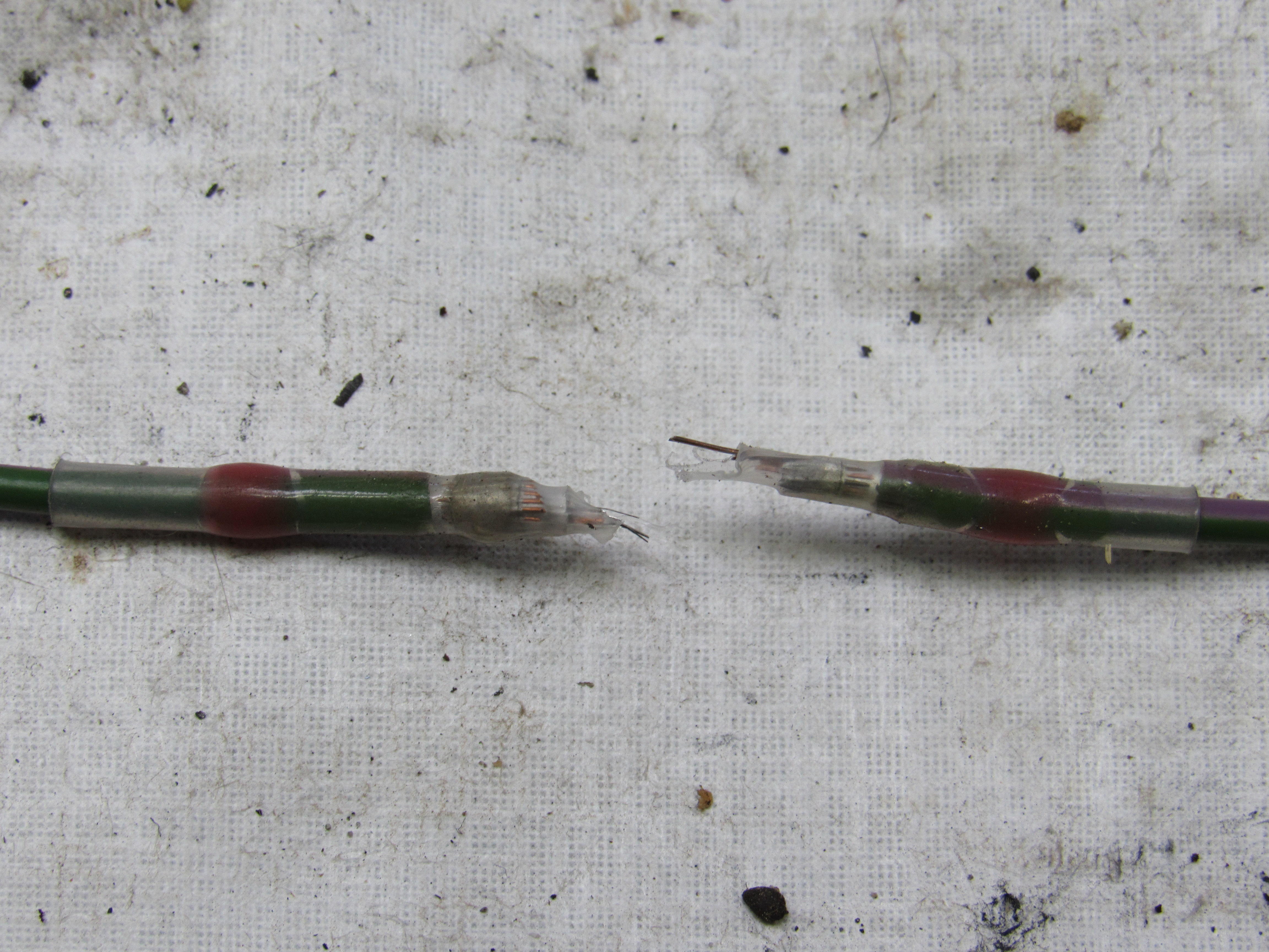

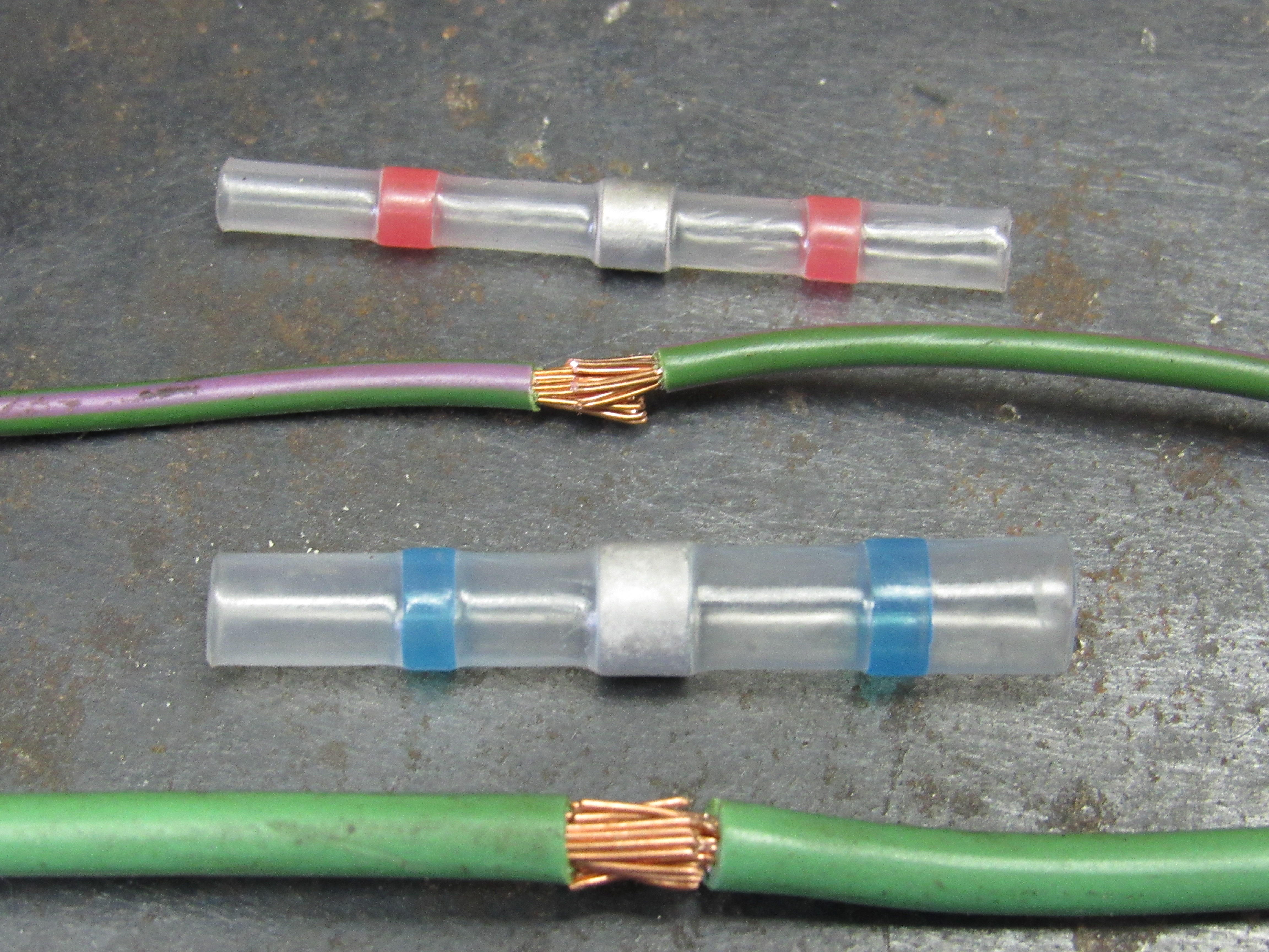

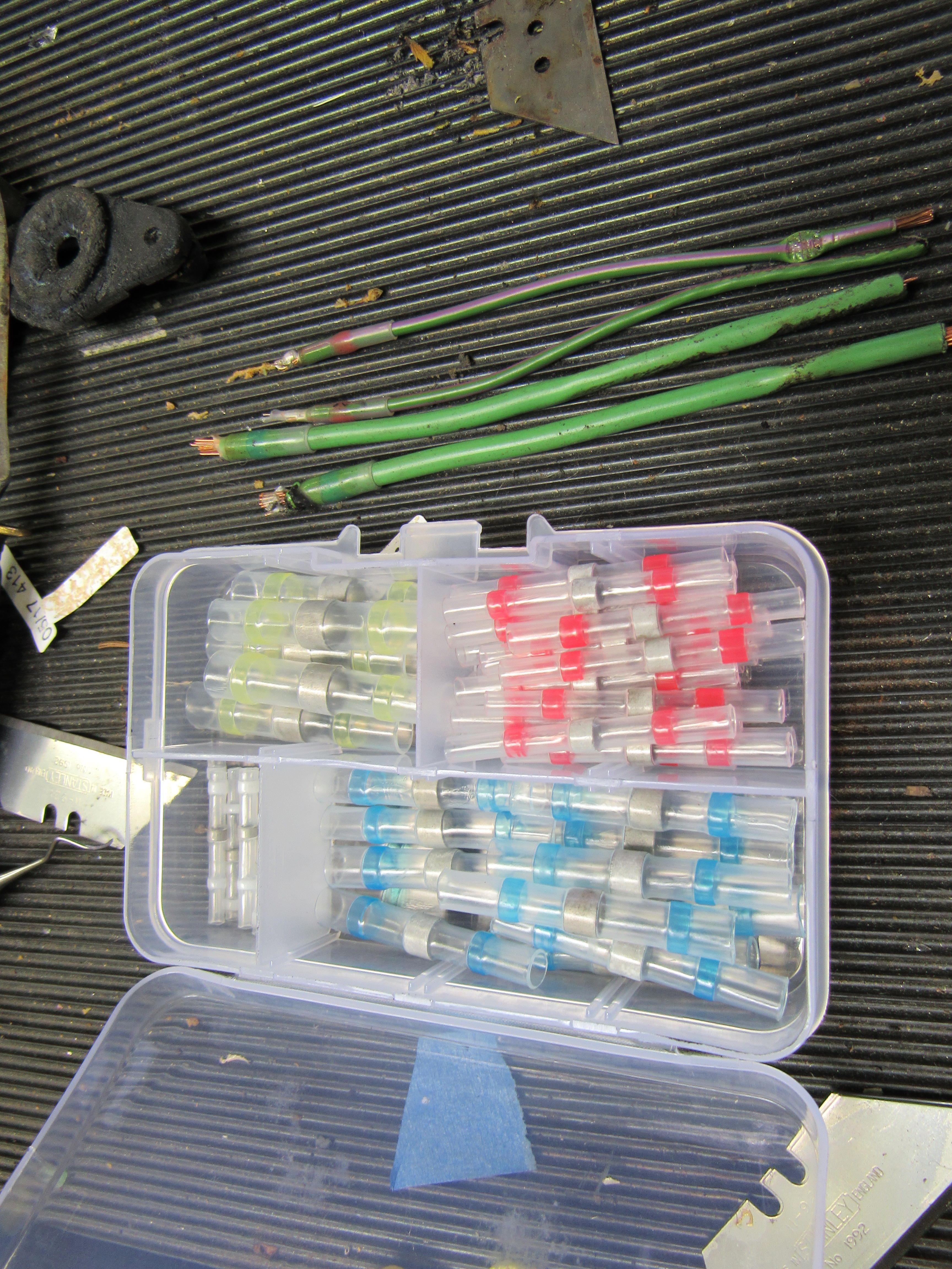

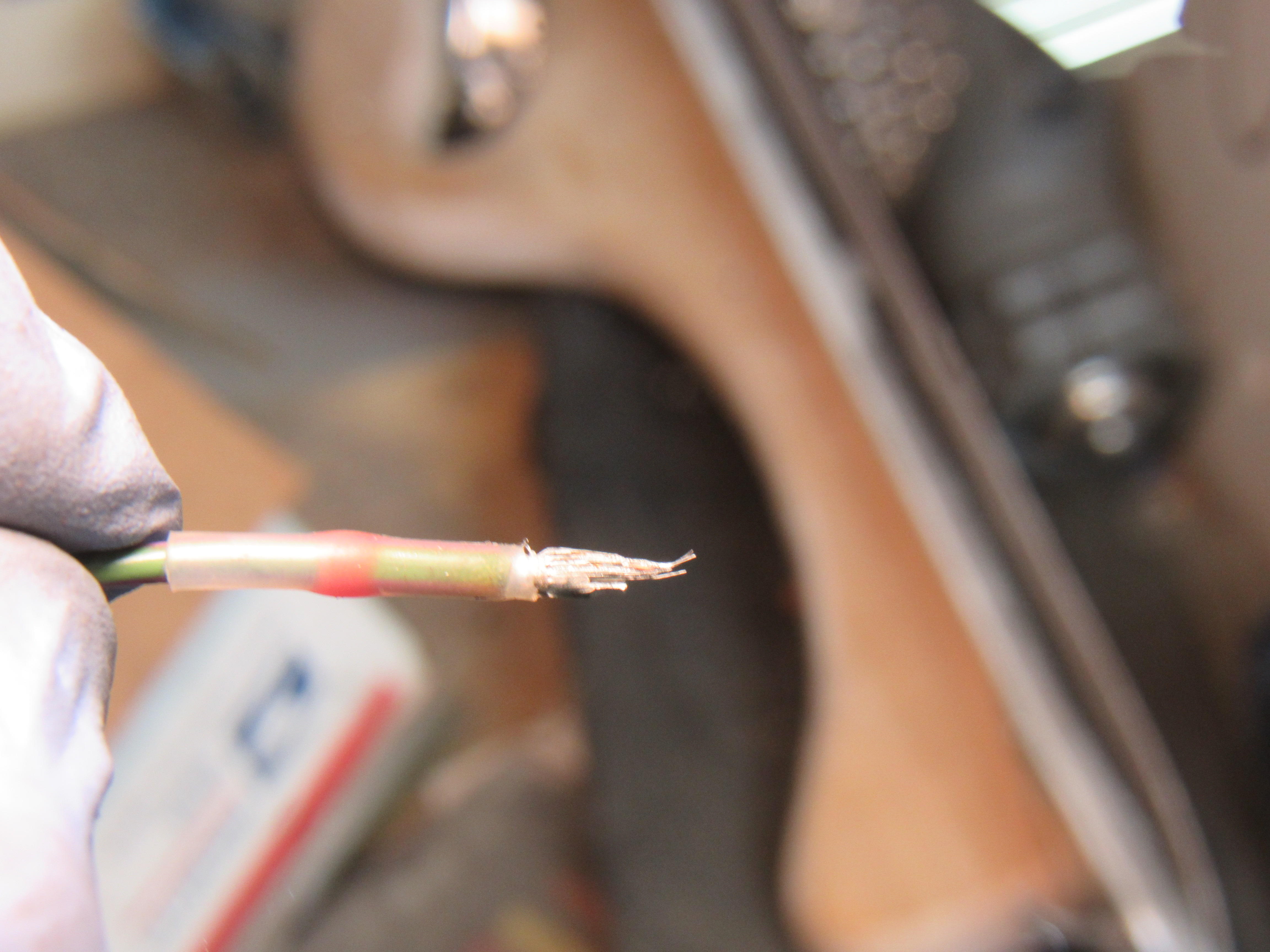

Some 14 ga and 12 ga for the test pieces, using my paint striping hot air gun on Max which is about 800* F

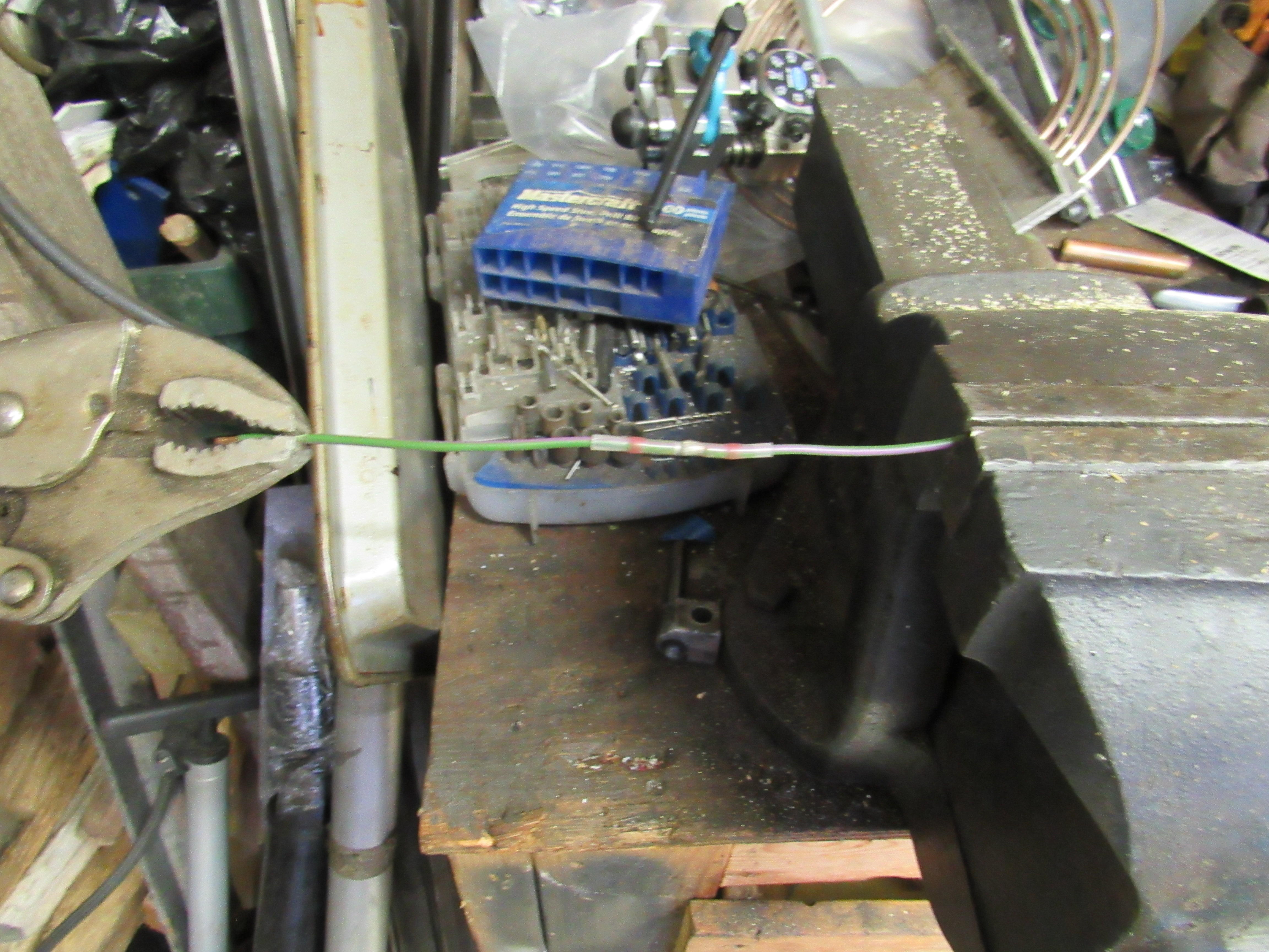

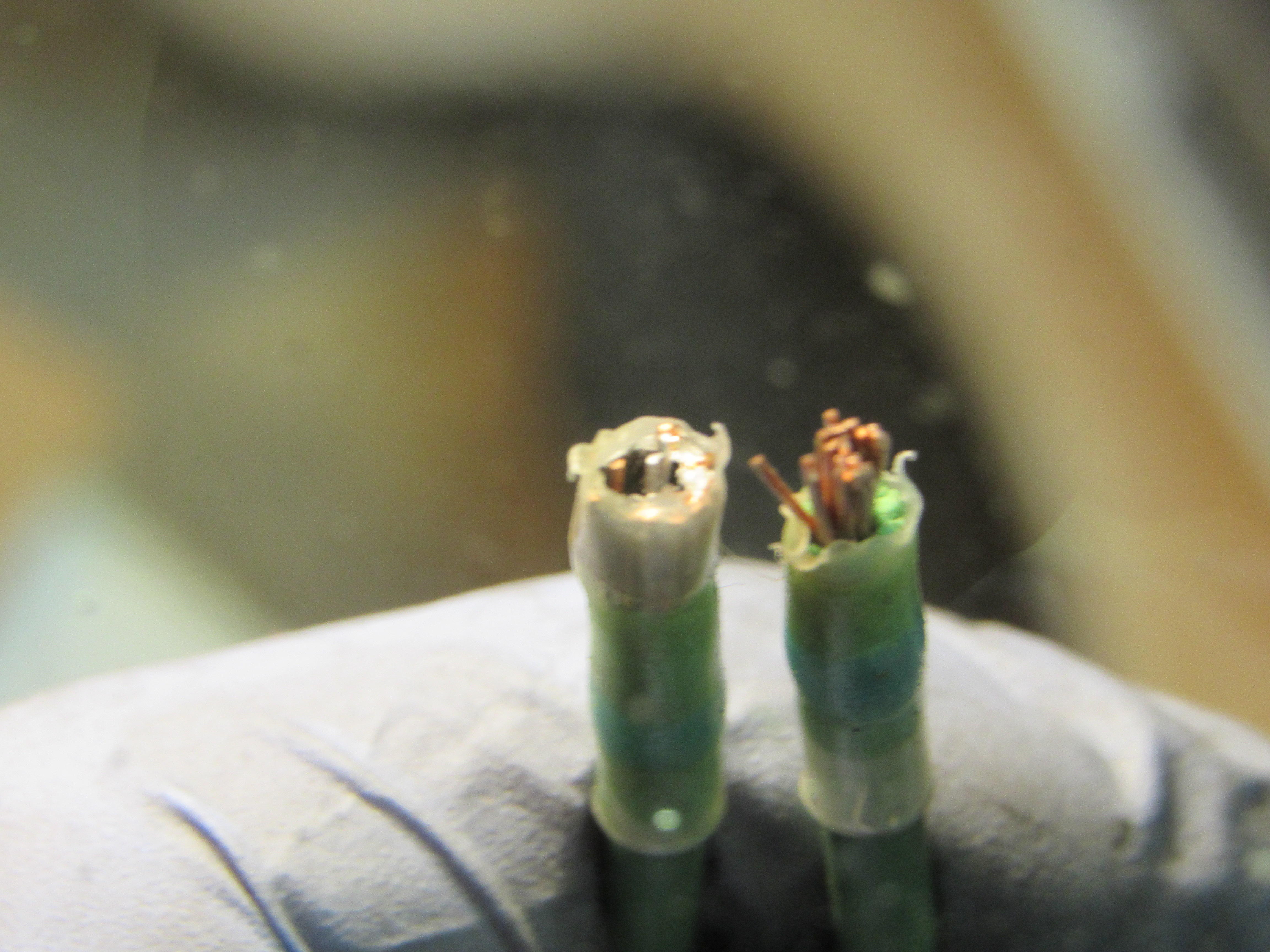

IMG_1202.JPGIMG_1208.JPGAfter cooling I mounted them one at a time in the vise an pulled with a pair of ViseGrips, I really had to put my weight into them to get them to break, very good bond, It is the solder that breaks, I could have held the heat to the 12 ga wire longer and got better penetration of the solder.

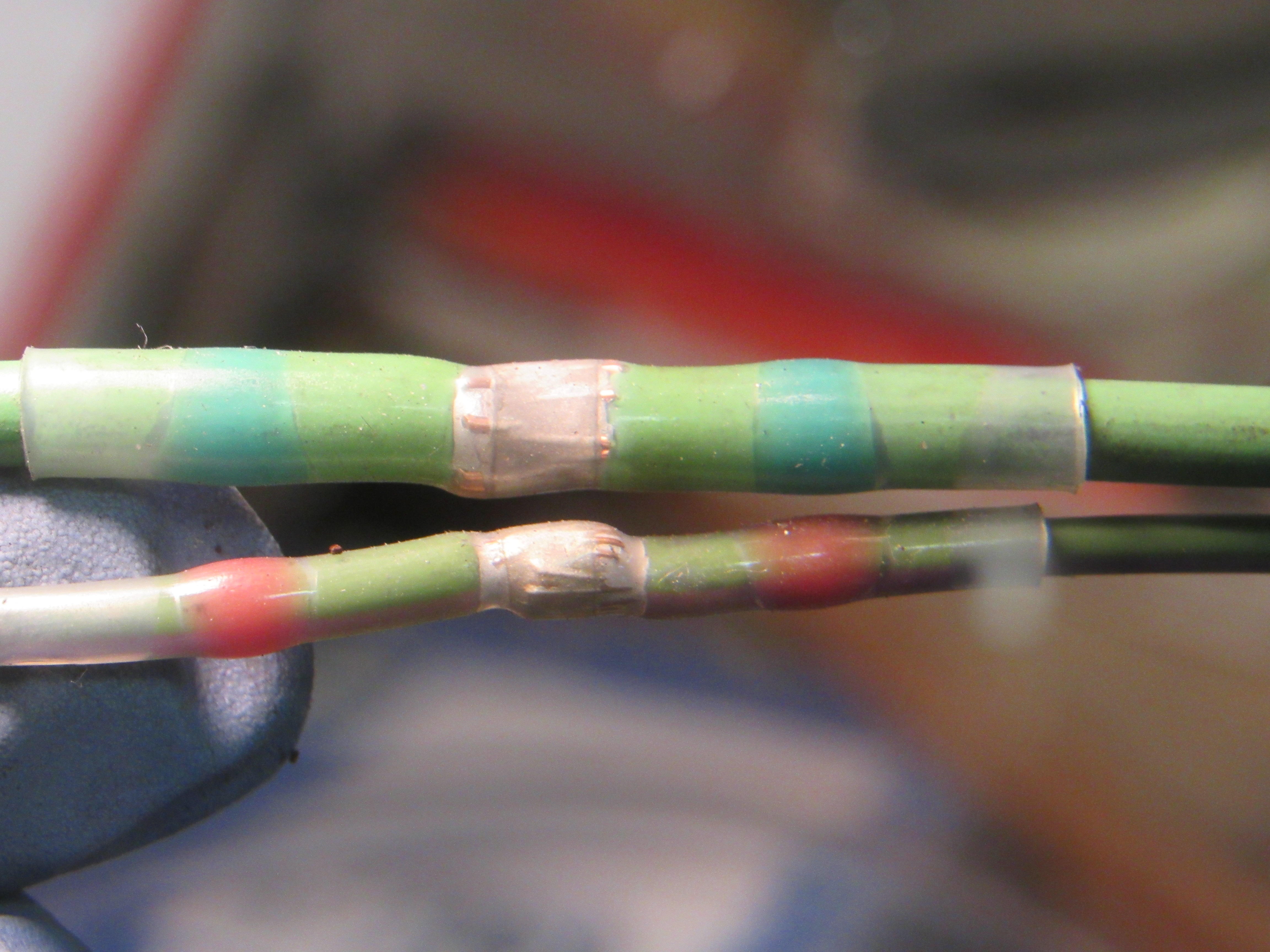

This style does provide a slim finish though. Looks like the wire tore before the solder joint so that’s good.
I prefer the old way as well but I can see these coming in handy in those situations where there is limited access and you need 3 hands to juggle the wire, solder and torch or soldering gun. I forgot to mention I did an Ohms test because I thought there might be some resistance with that low heat solder but there was none.
It is actually the solder that breaks the most with a few strands of the other wire tearing away, it was difficult to get a good pic as I was shooting through a magnifying glass.  But as I mentioned I had to really haul on it to get it to snap, I guess low heat solder would have more lead in it. I might try dipping the ends of heavy ga wire in flux next time so I get better penetration to the center of the joint.
