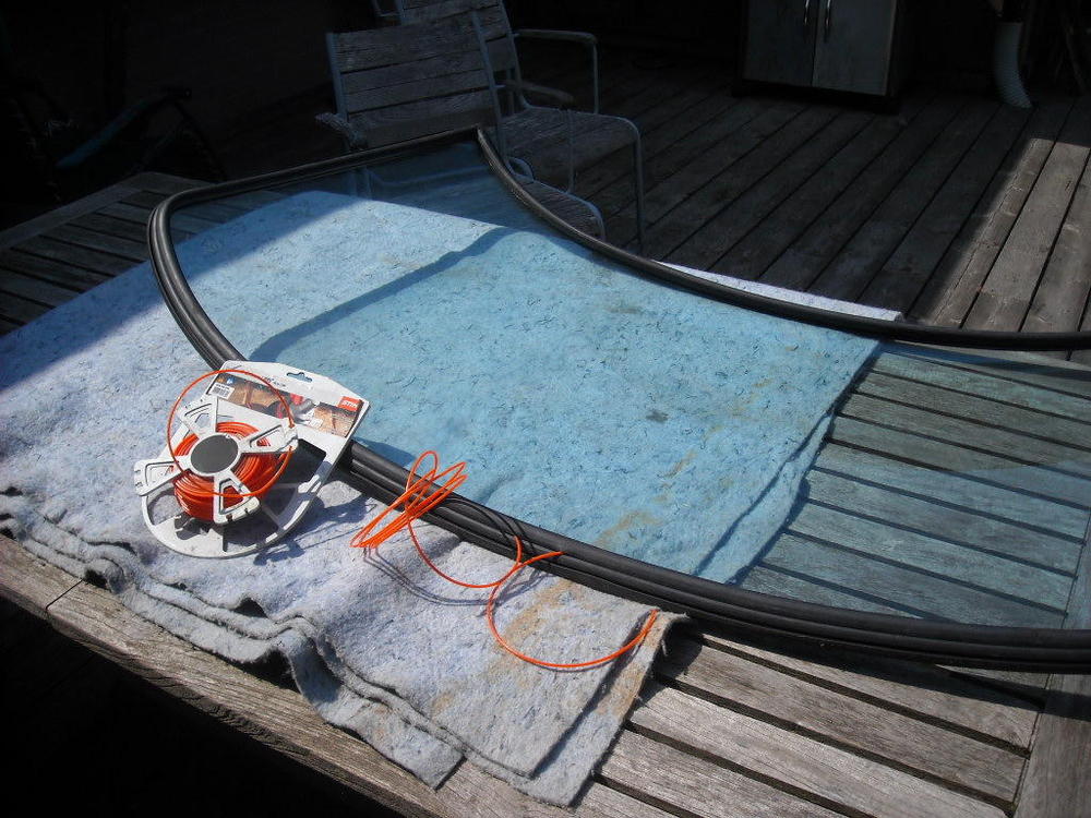

(Use a cotton rope or cord, get it wet before you put it in the channel, better to have two guys outside holding the glass - don't let it slip, at the top corners work the cord in a circular motion to get the gasket corner to pull through)
