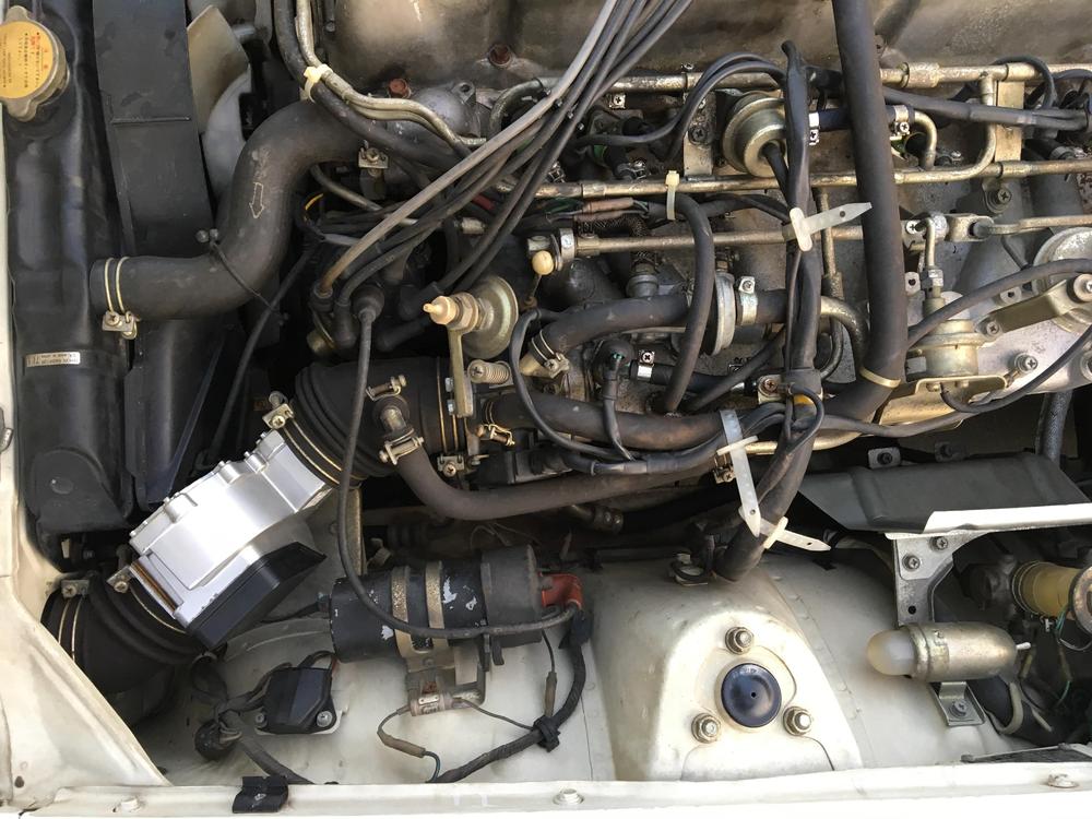

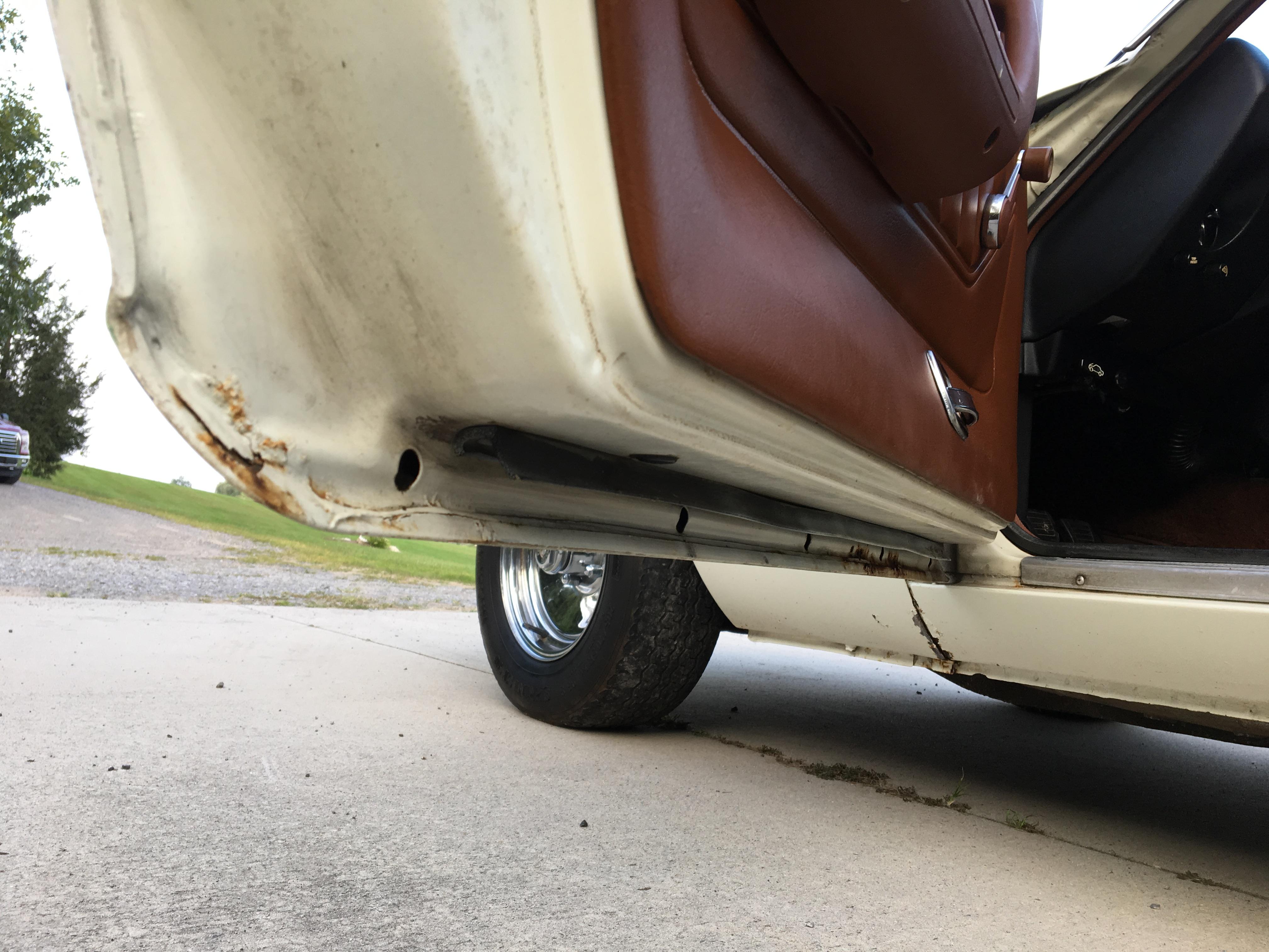

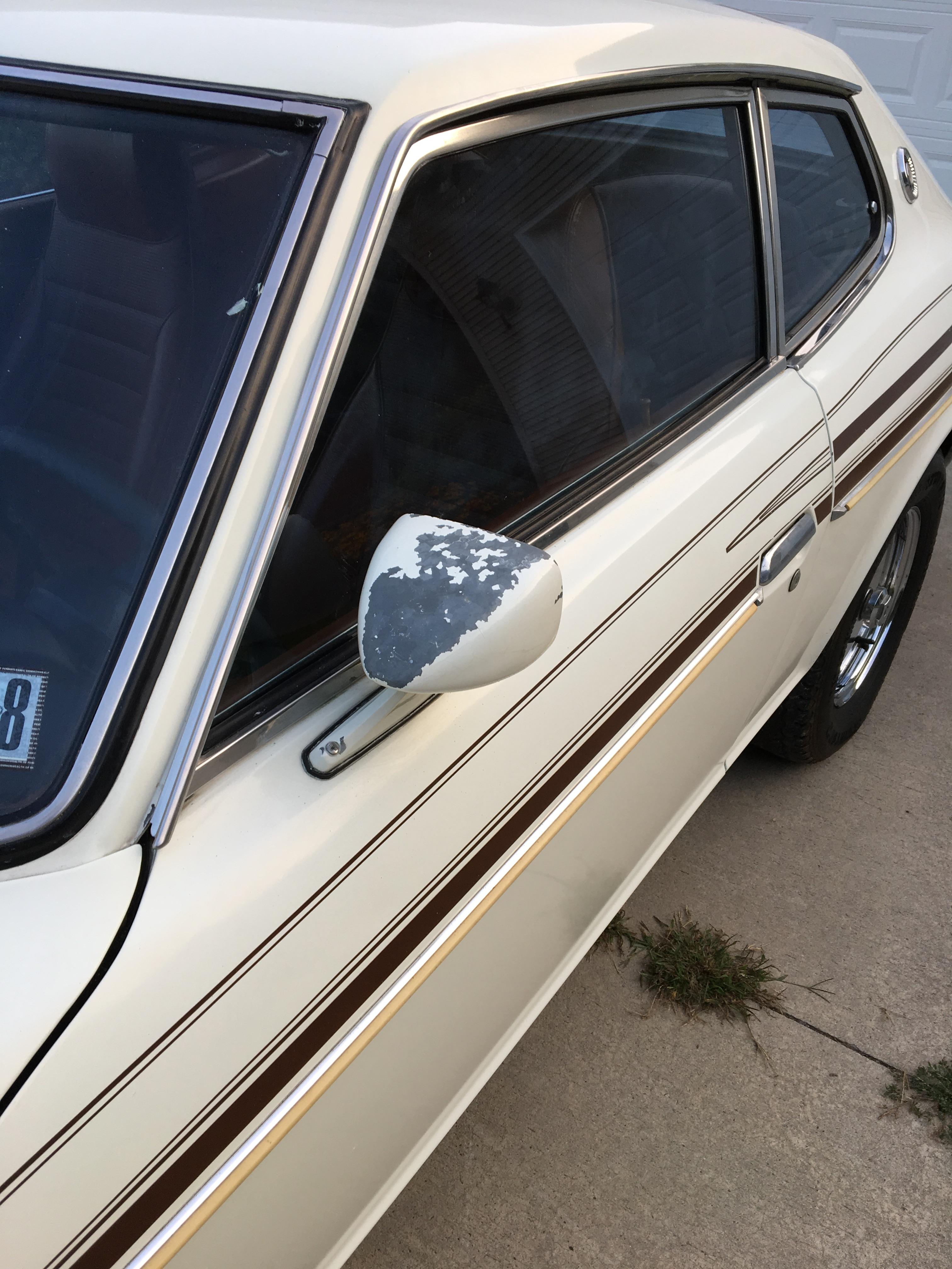

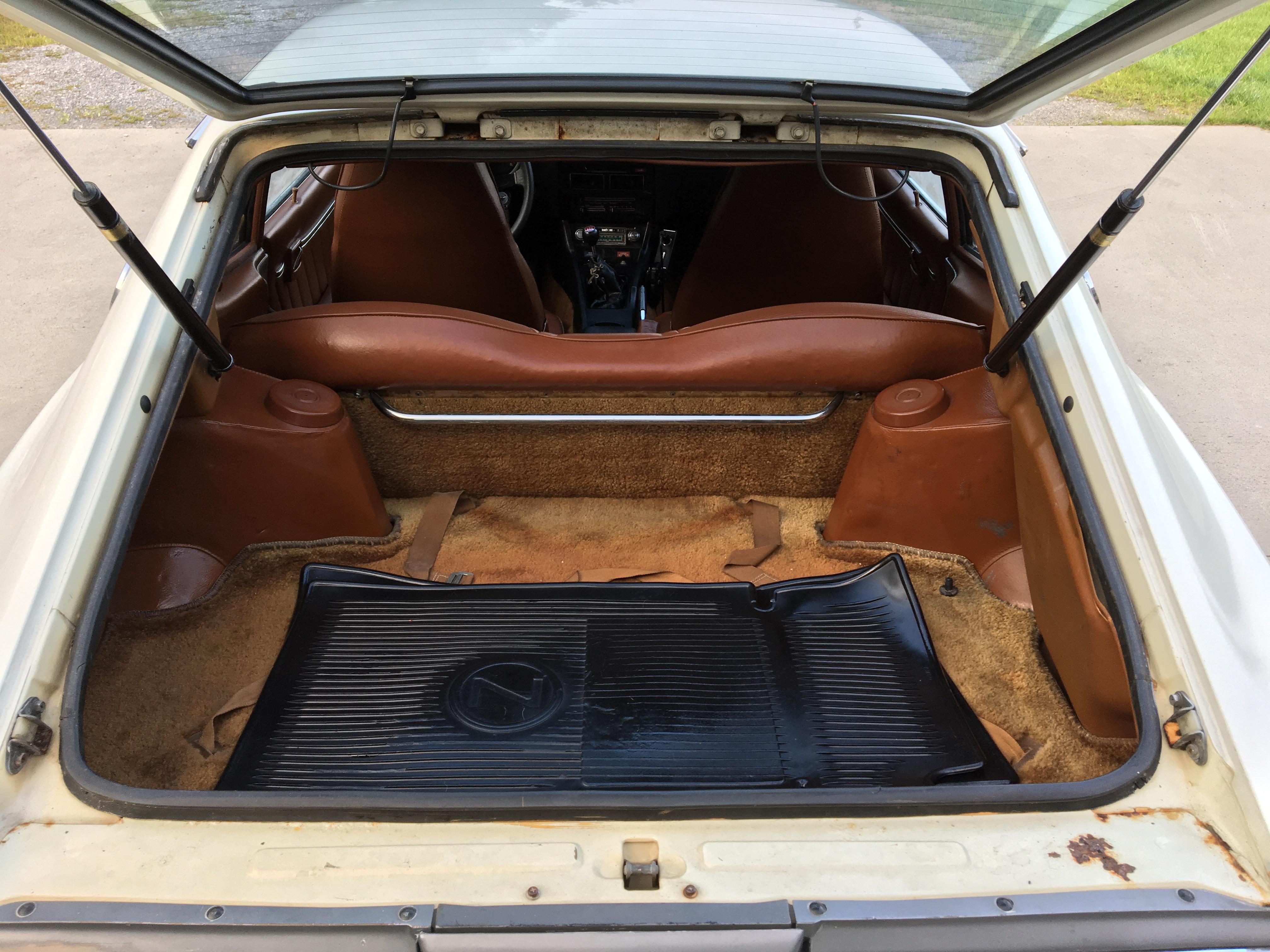

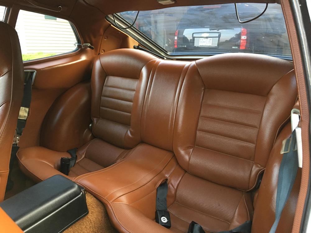

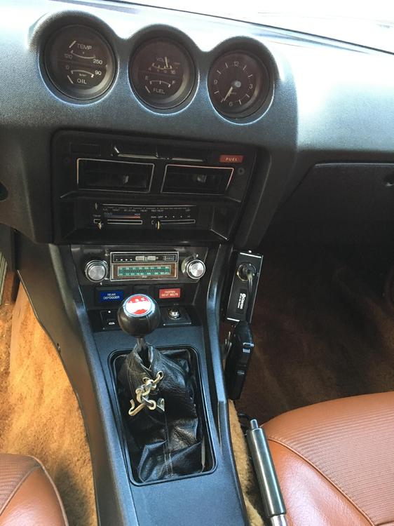

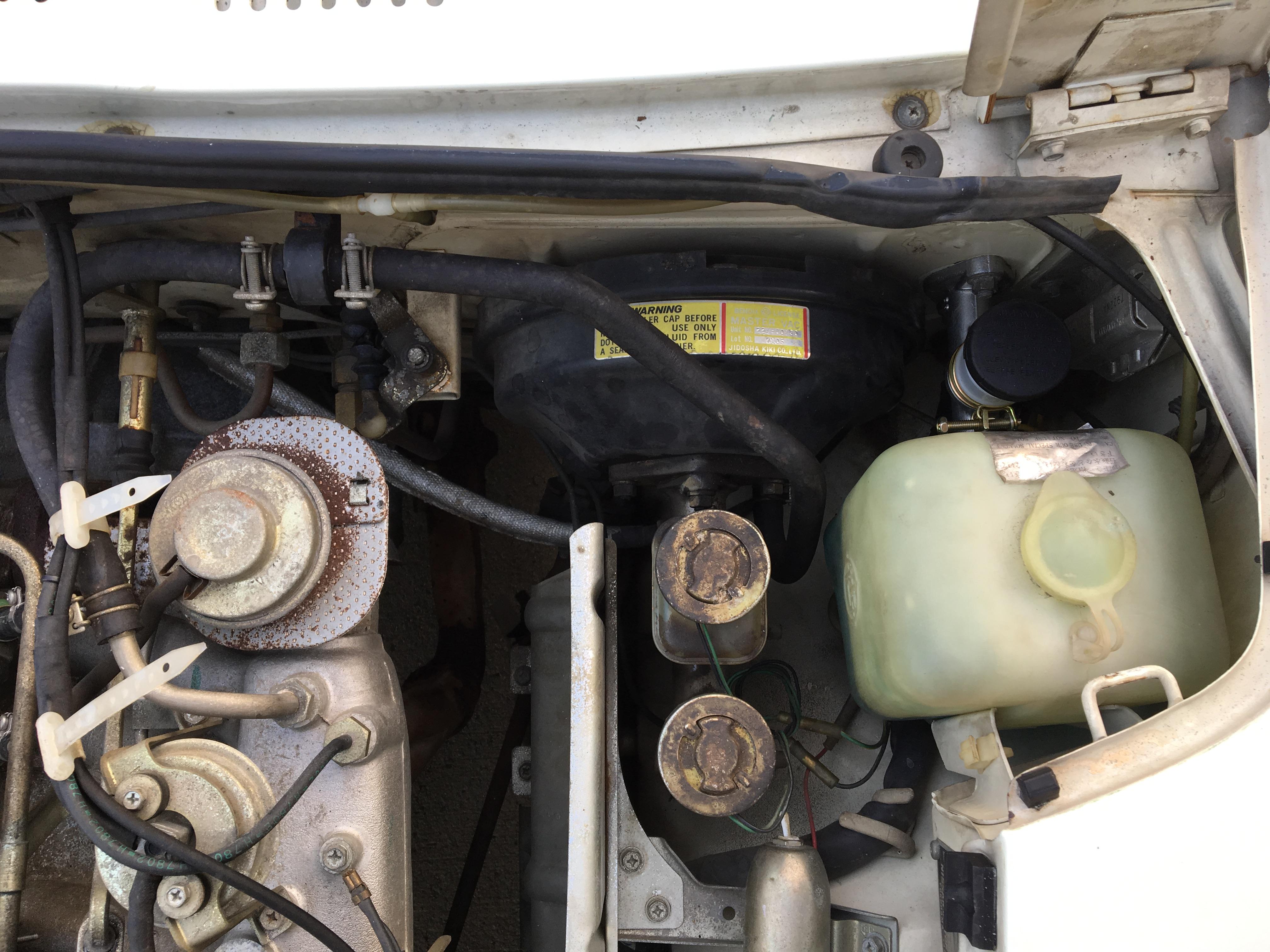

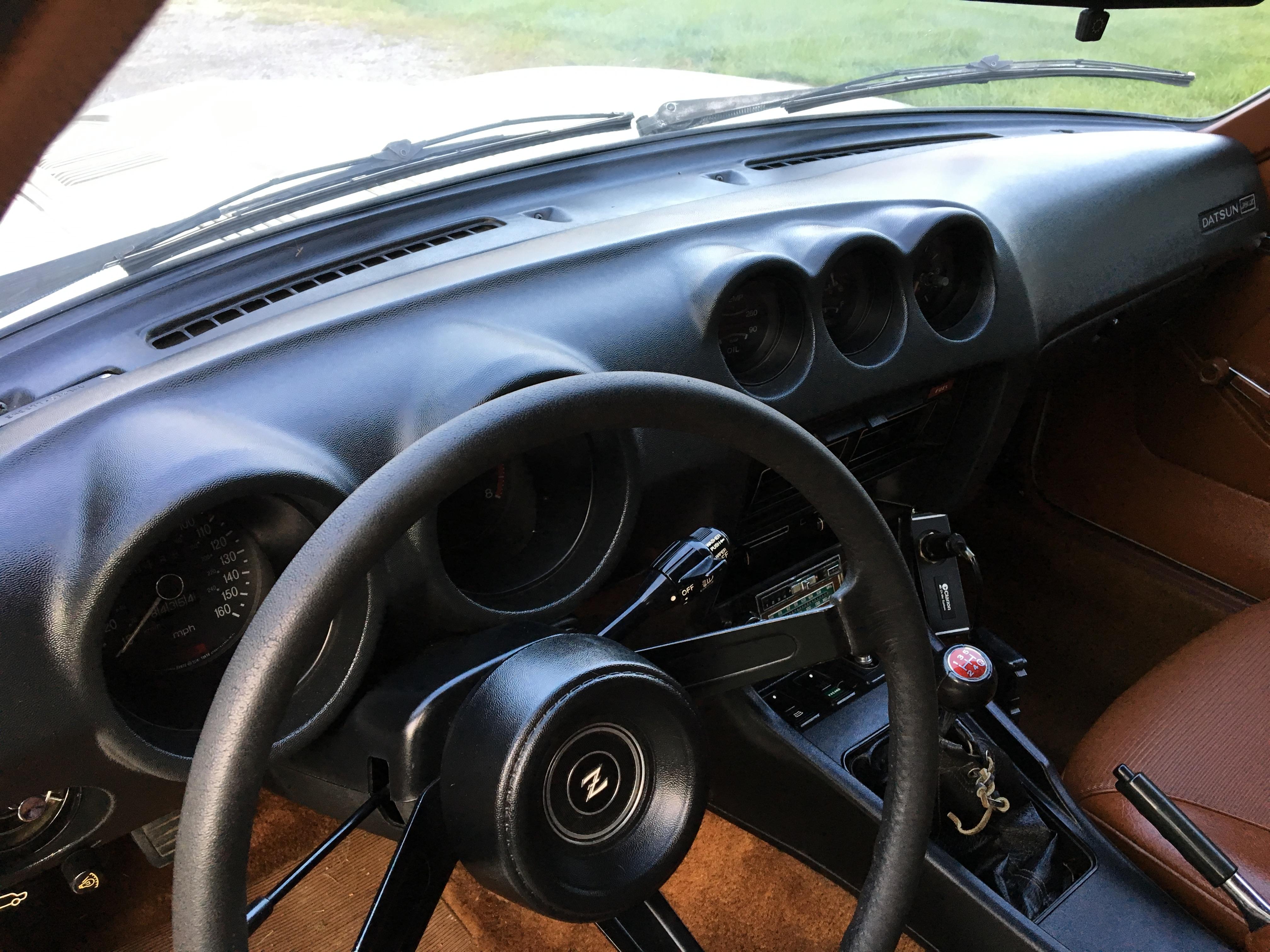

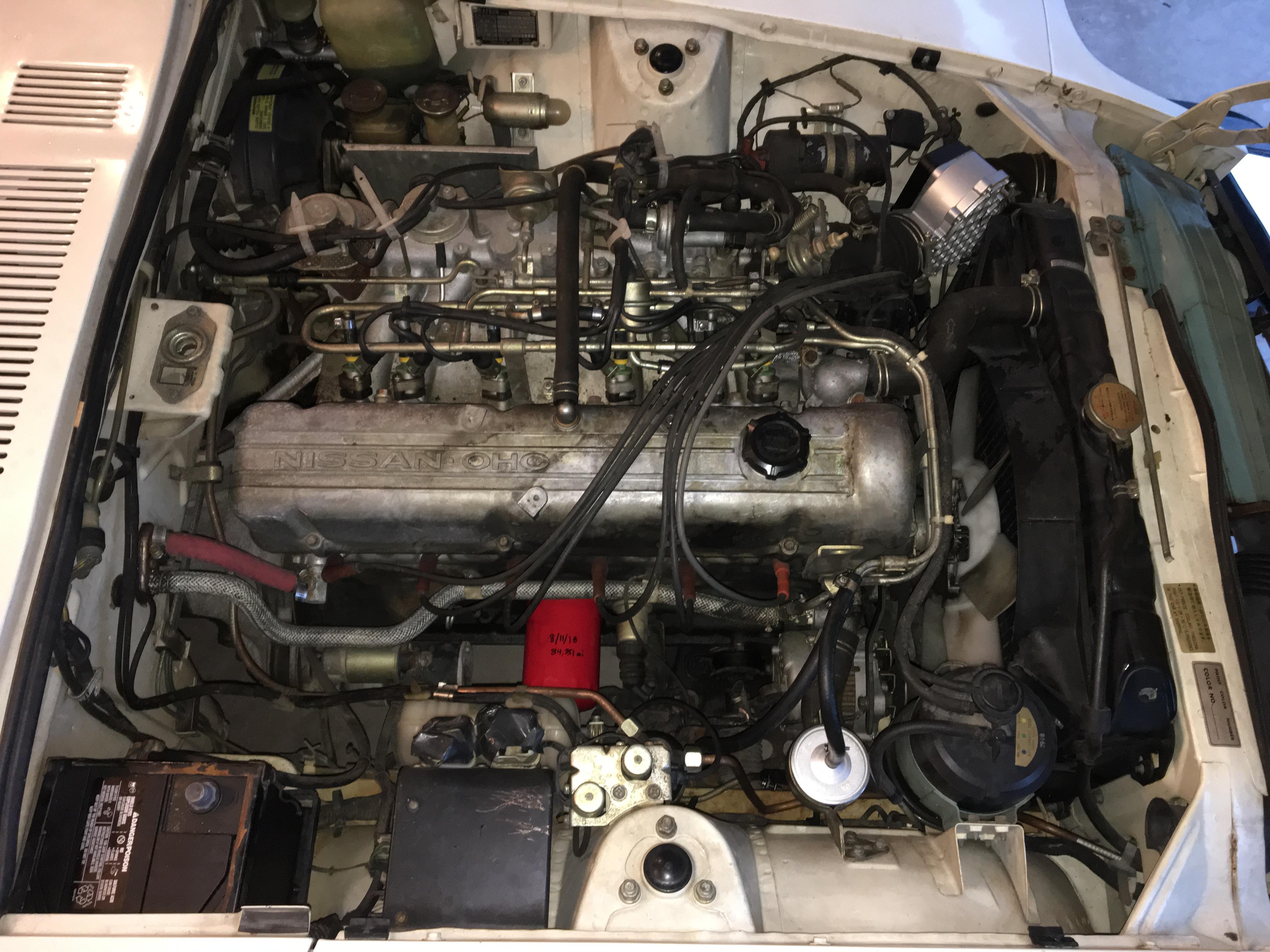

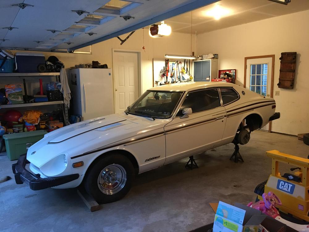

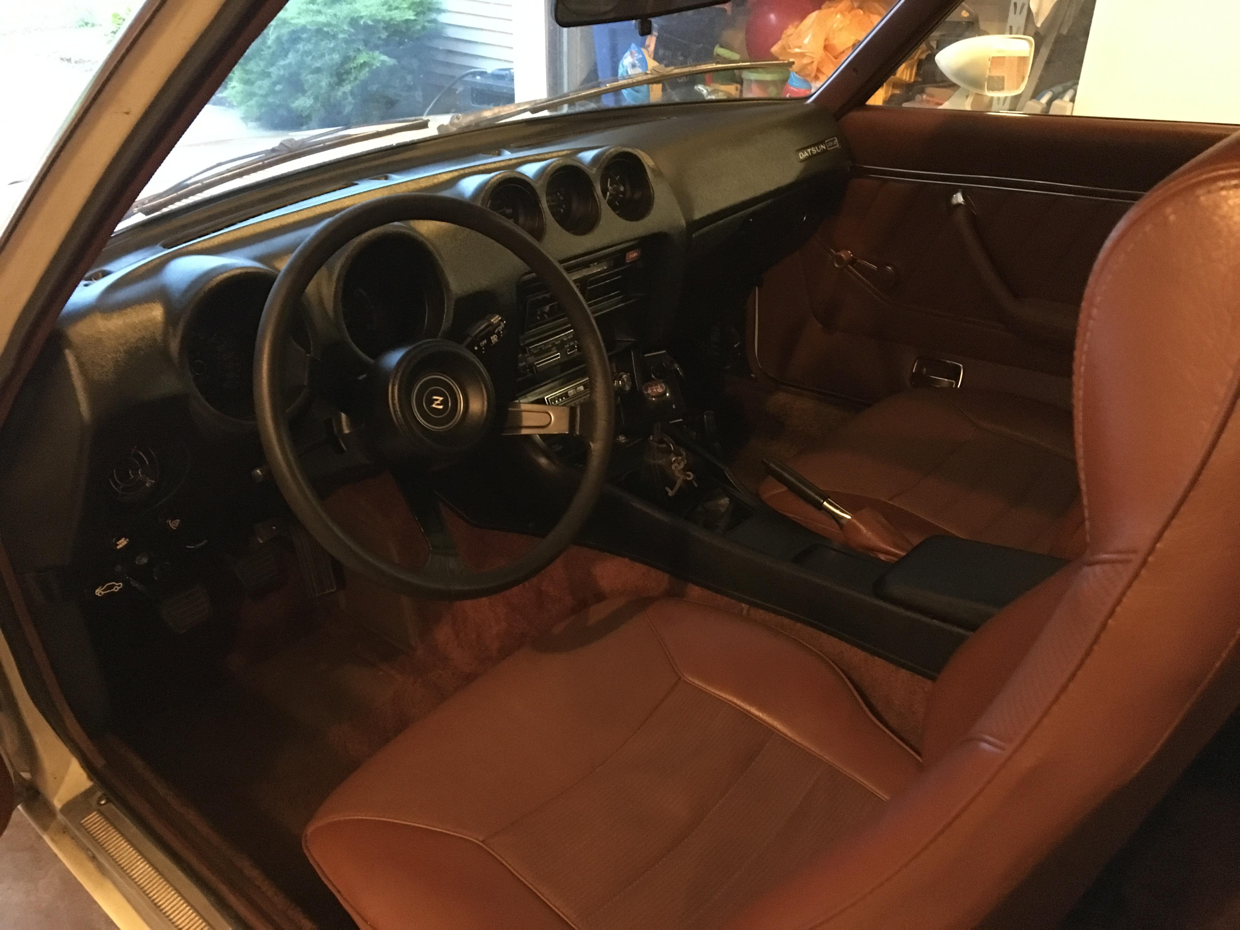

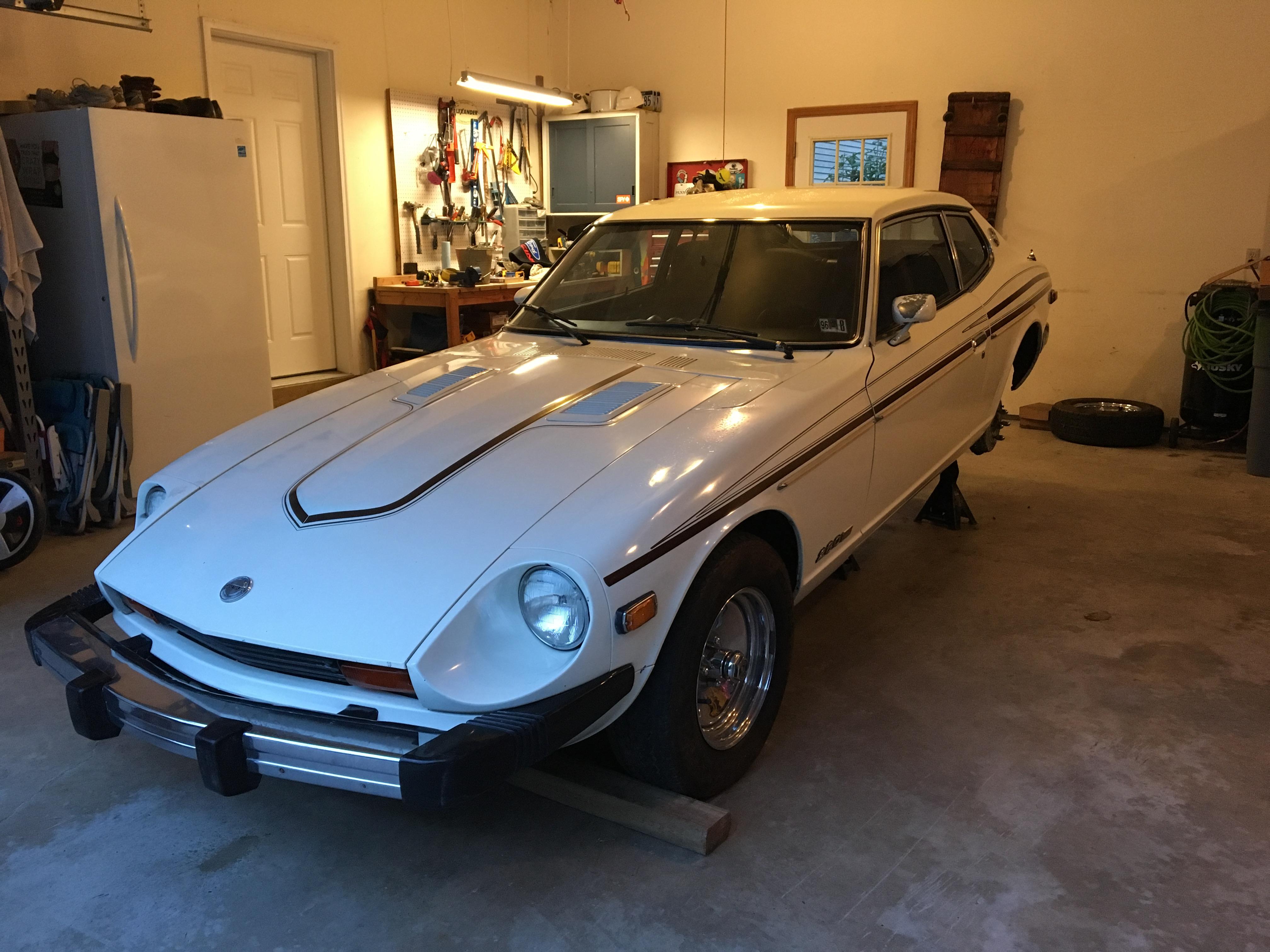

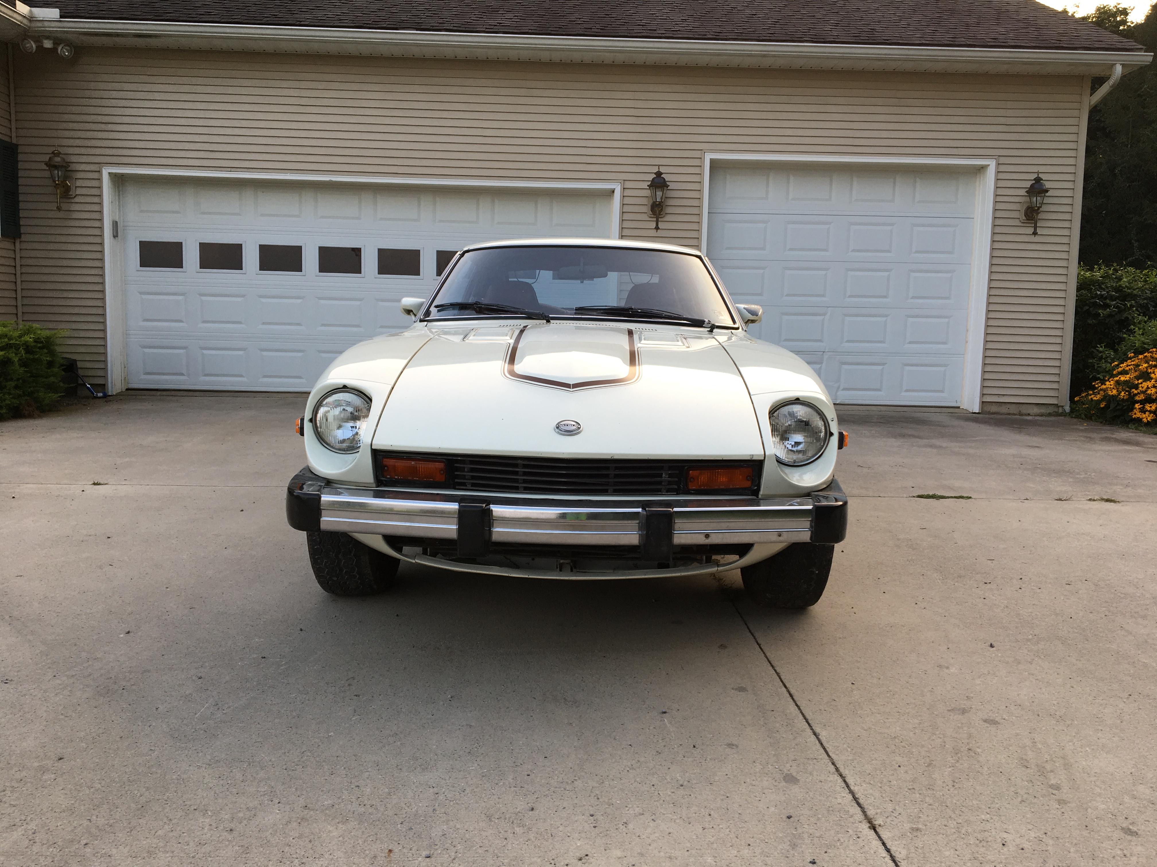

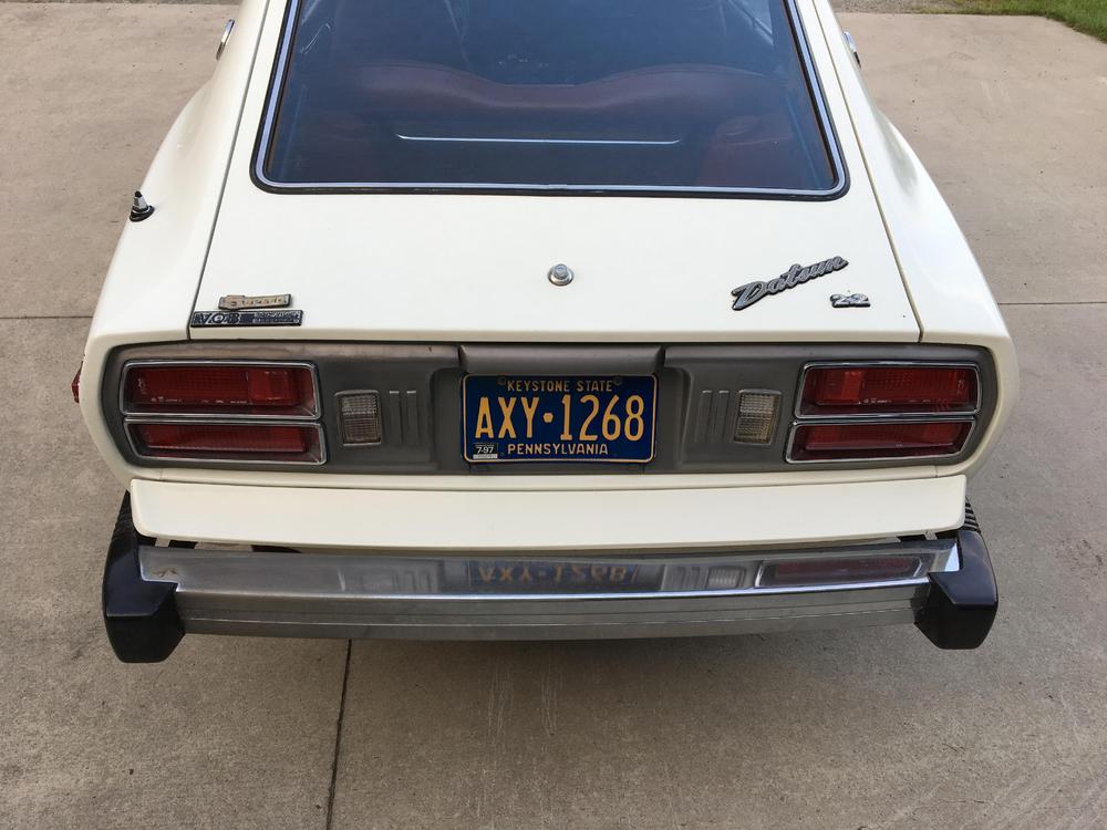

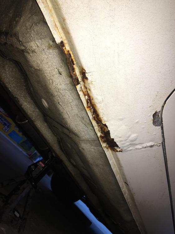

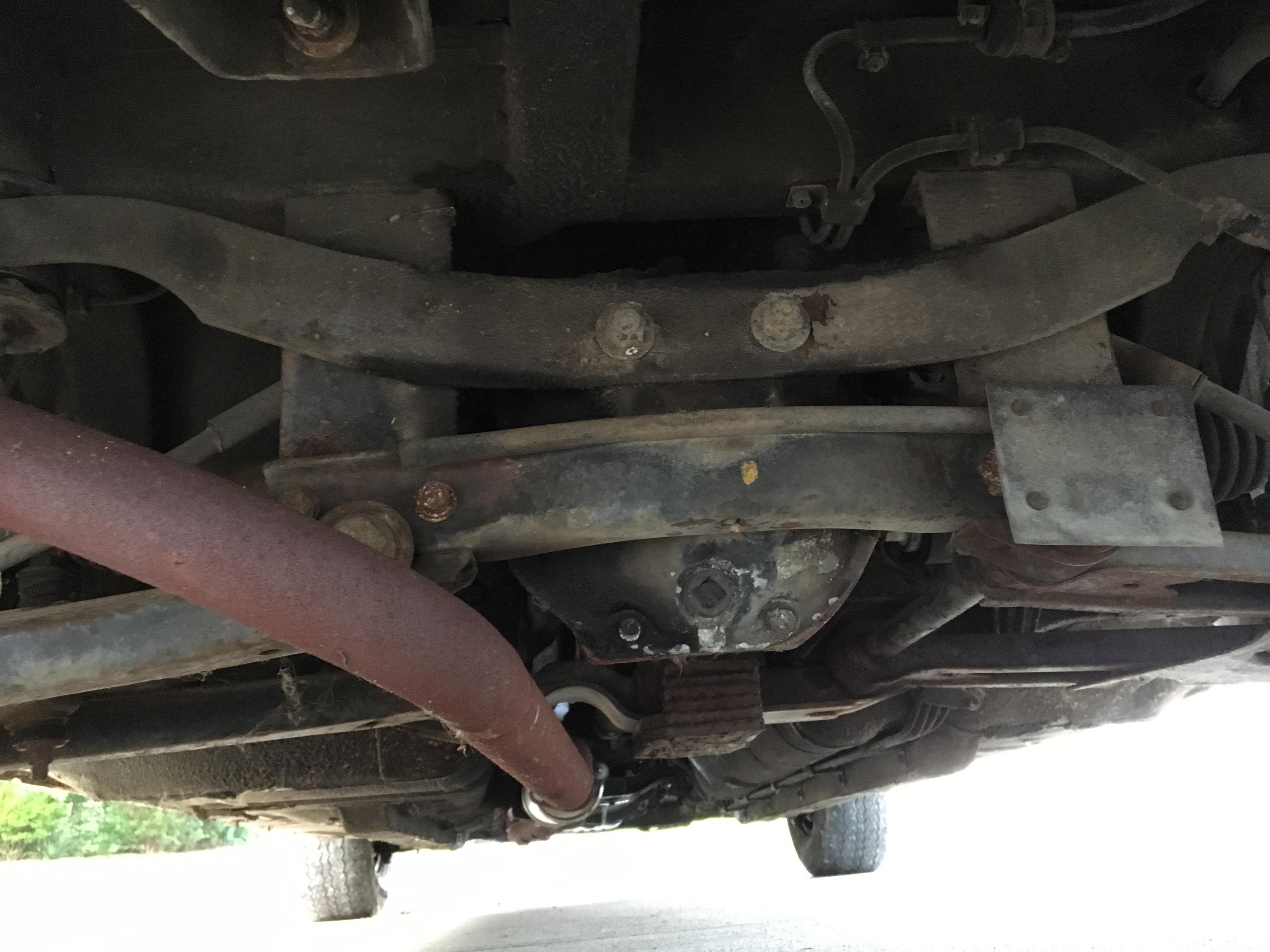

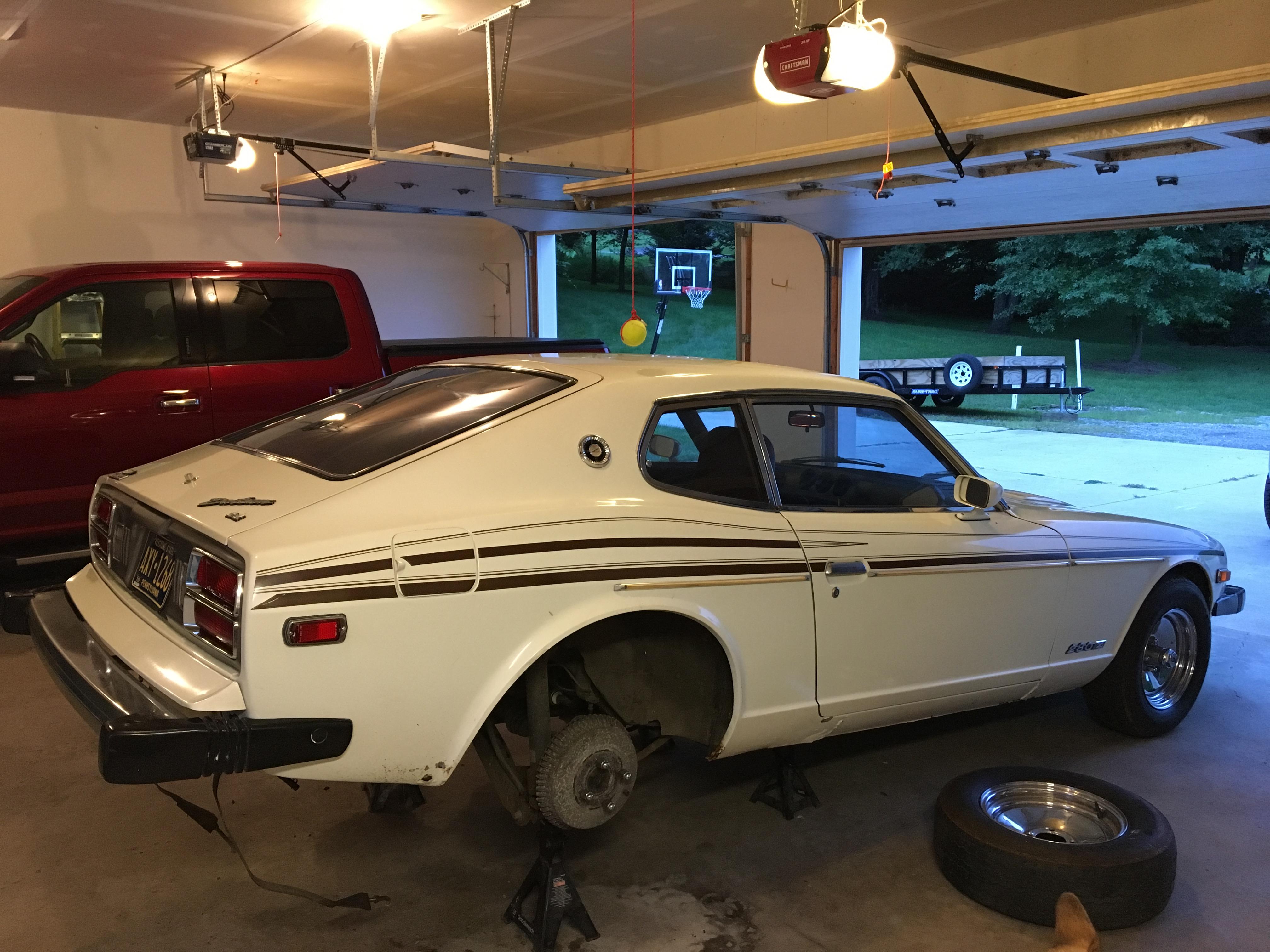

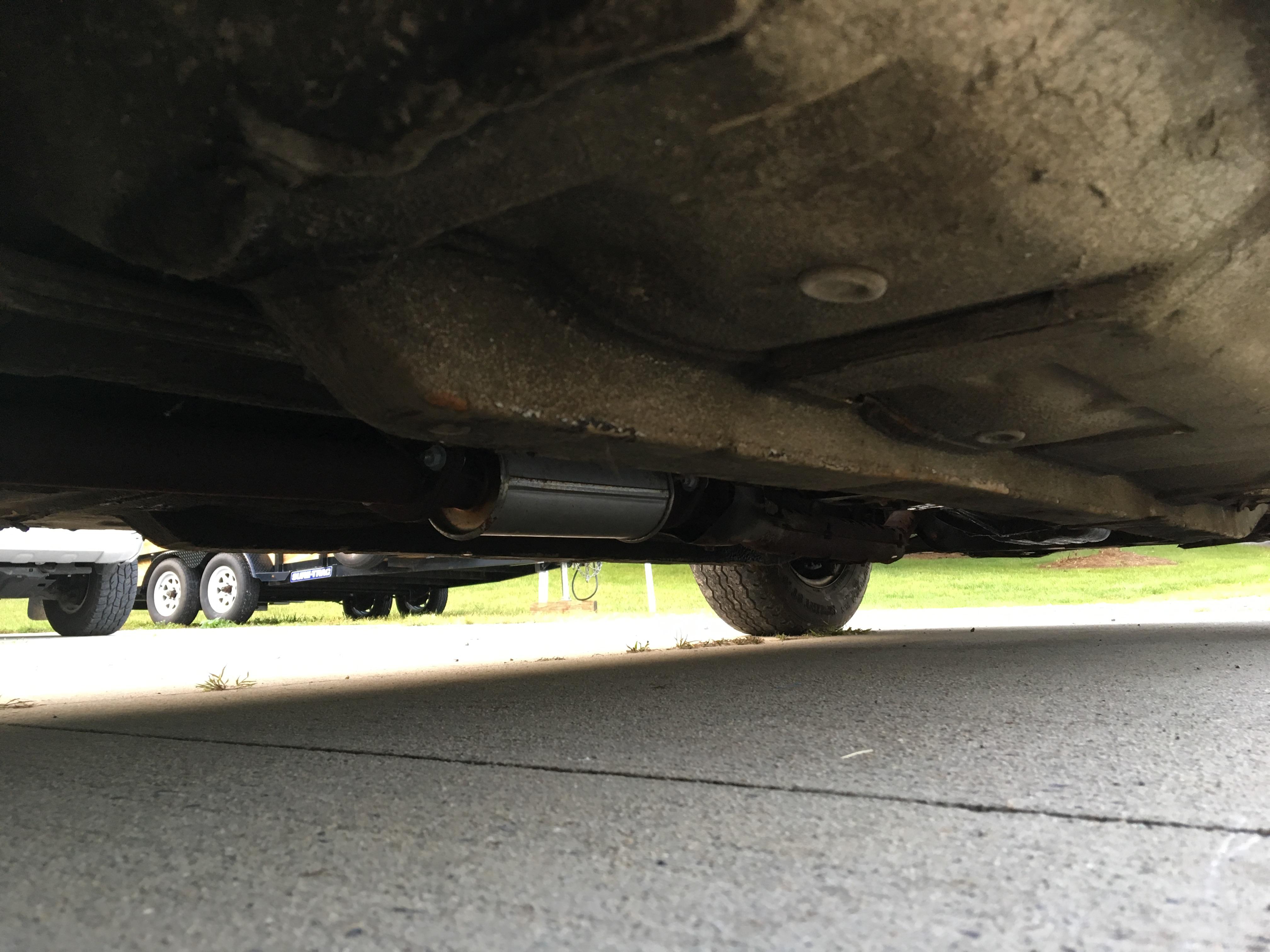

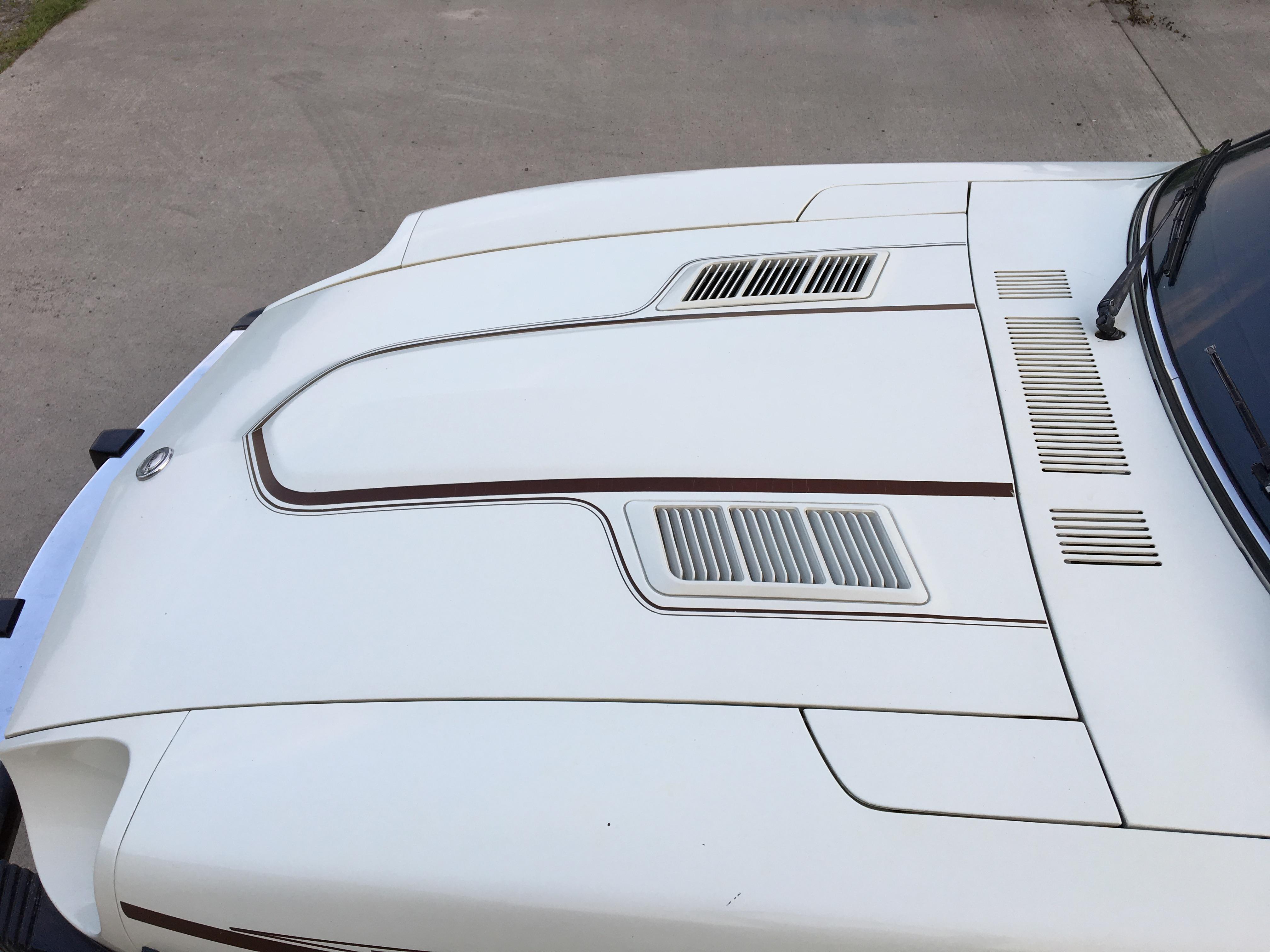

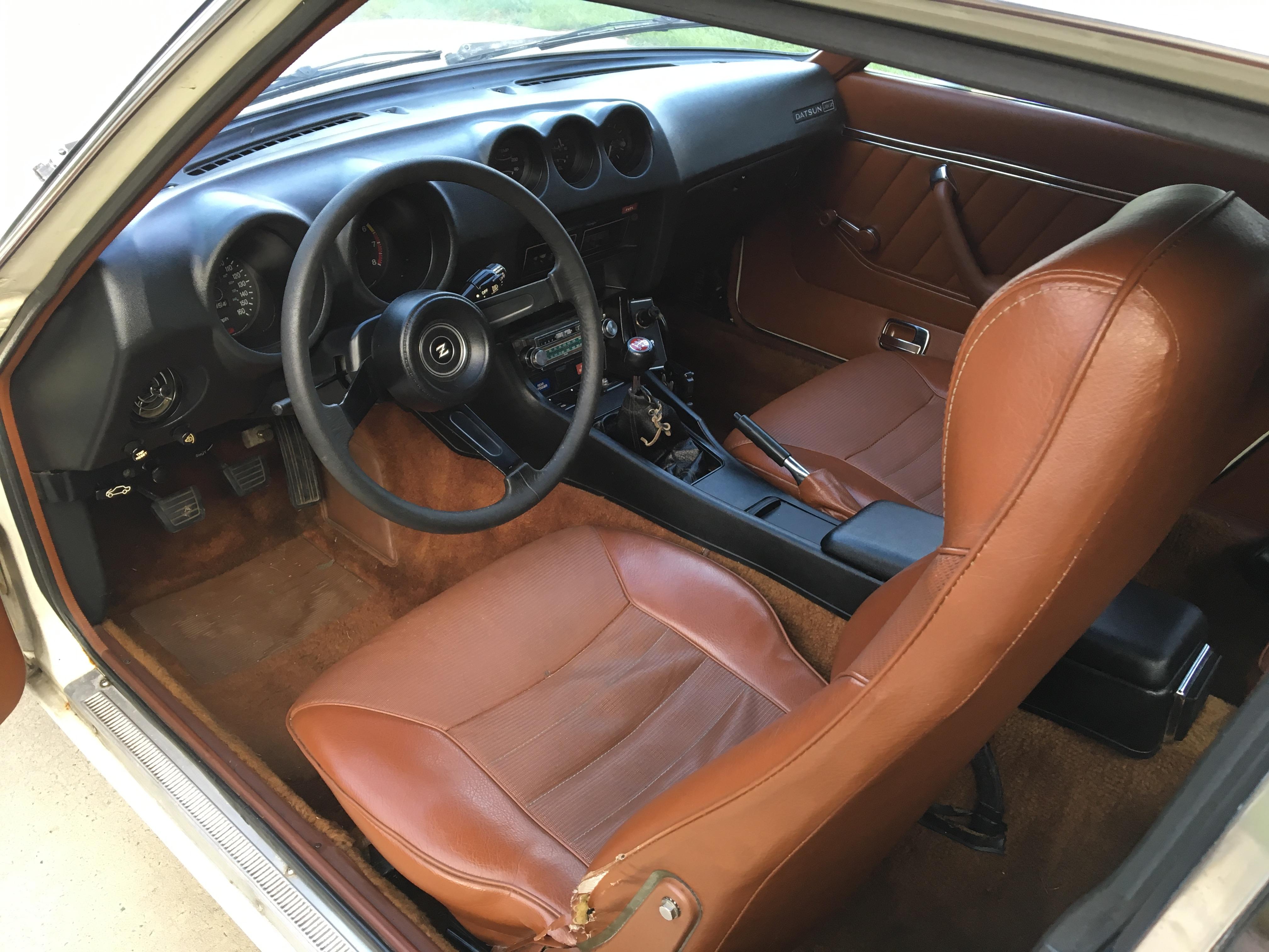

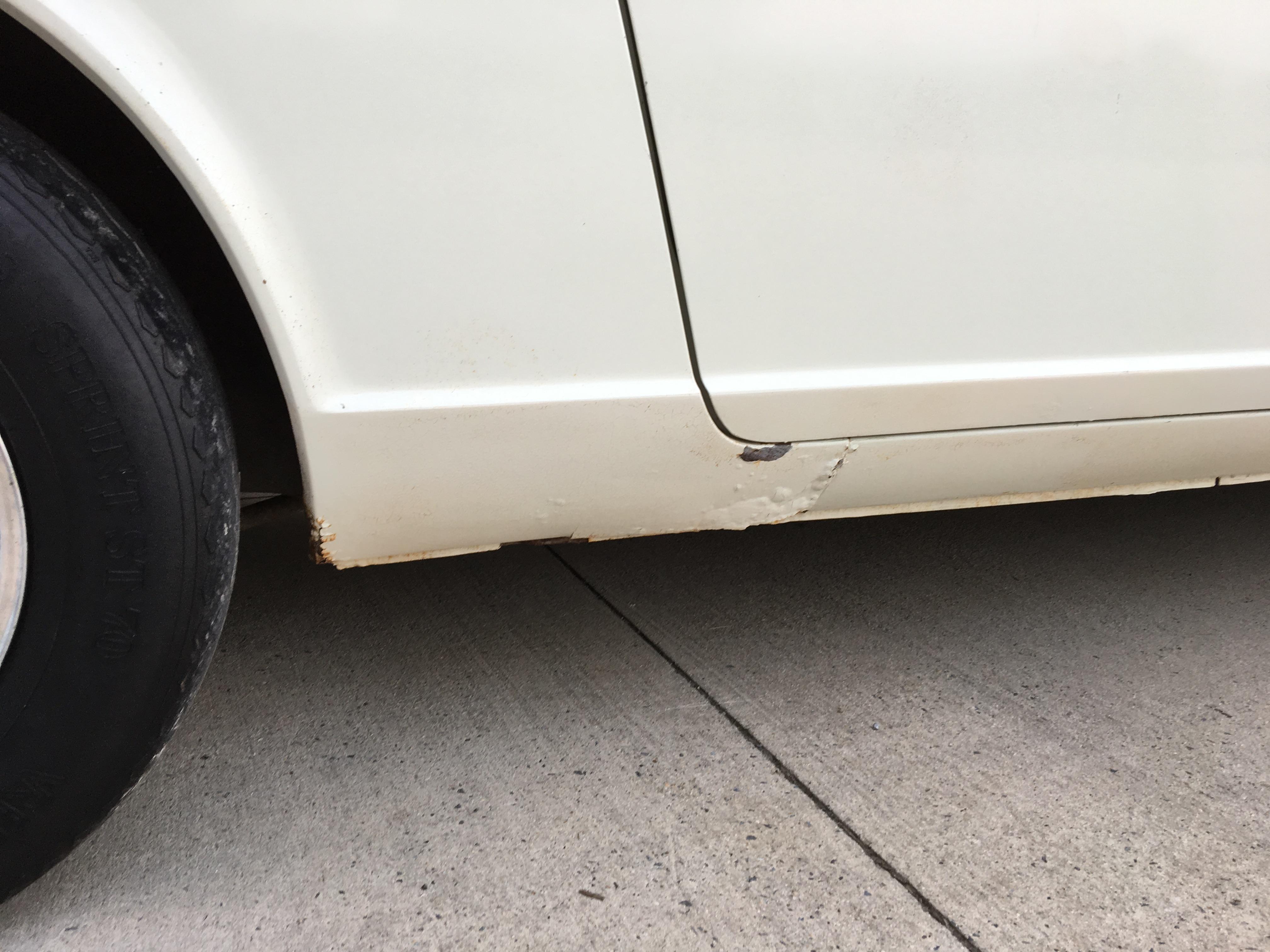

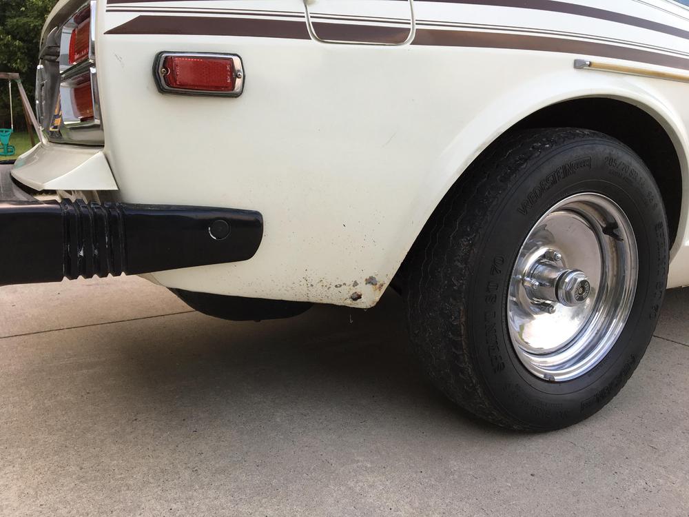

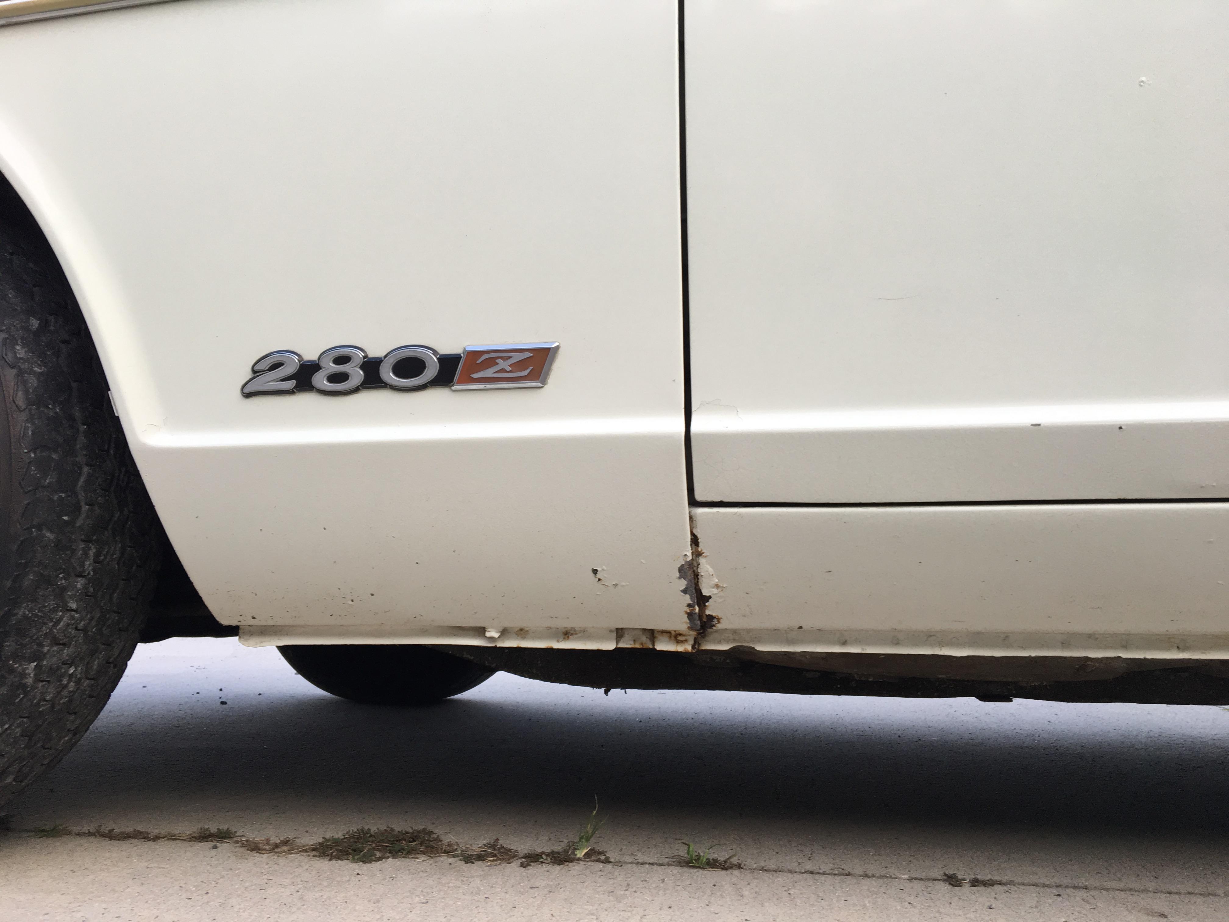

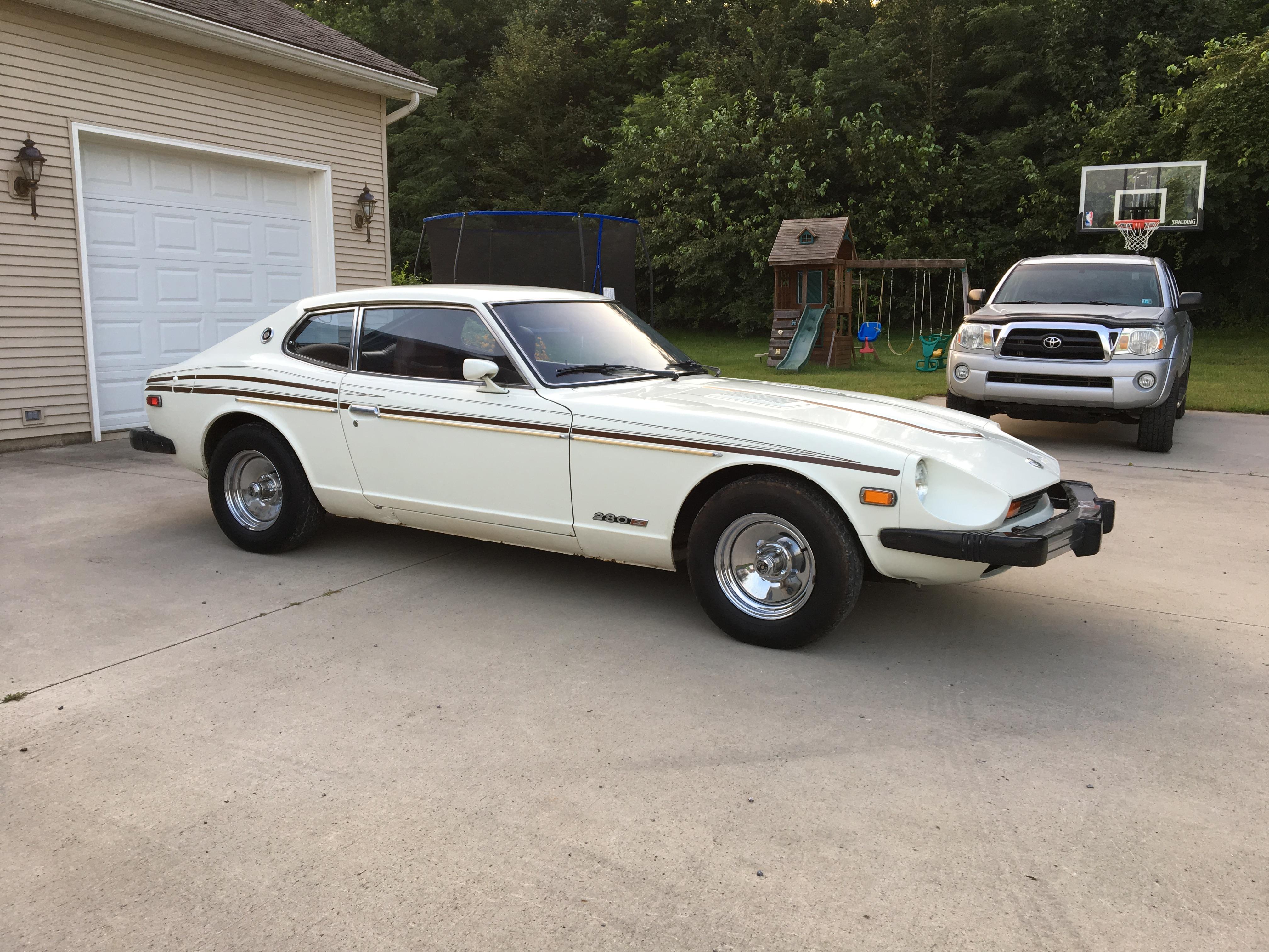

I am glad you reminded me to take some pictures. I get caught up in it and forget to take photos. Here are some photos of it in the garage now jacked up for the gas tank removal. Hopefully, when I get the tank back in (should have tank back end of this week) and clutch working, I can pull it out for a full detail. I also included some pics of interior, engine bay, underside, and worst spot of rust on rocker. Other than a quick wash job this is how I found it under the car cover.
nice looking car. the rust too look for is under the battery, under the brake master, rockers and rear hatch deck. Yours looks to be very solid. You may want to bone up on jacking points, IIRC the rear should be on the diff crossmember.
hopefully the AC works, they are a blast to drive, and not your typical 57 chevy or 60's muscle car. Good gas mileage to..."Datsun Saves" Awesome!!!
check out some of the old 70's era commercials on you tube, it explains a lot about style.
Ask about the curing time for the Red-Kote.  I've done two and both needed about a week baking in the sun.  The directions say to not put fuel in until you no longer smell the liner's chemically smell.  They may have a way to bake it though?
The car looks great!
