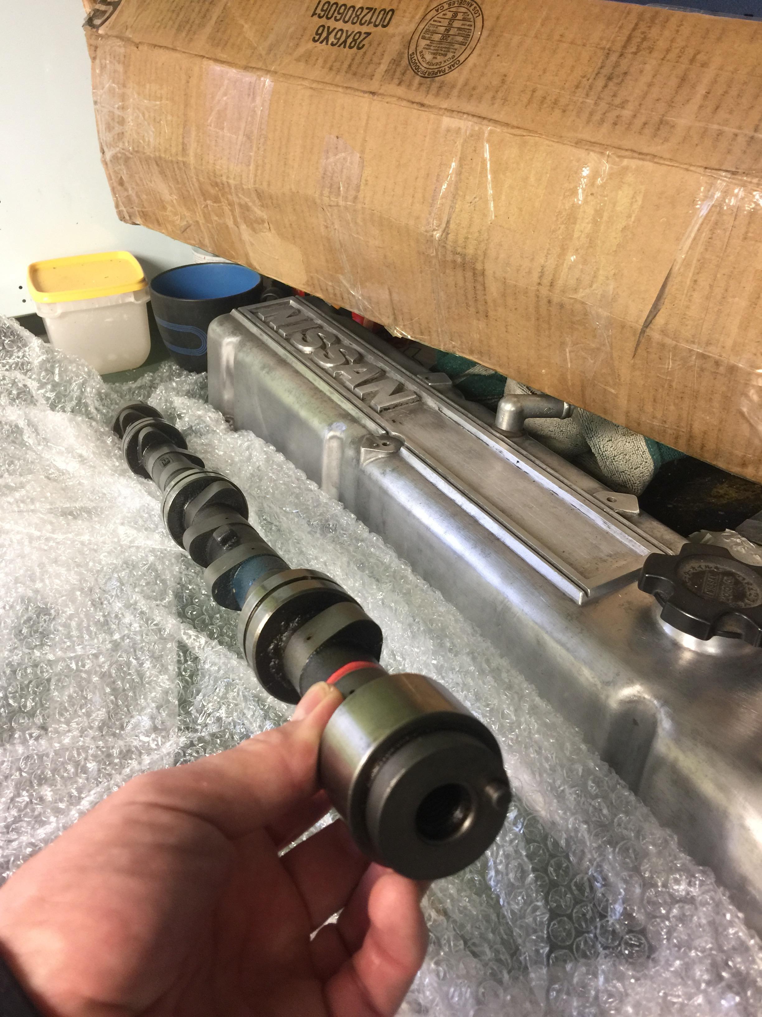

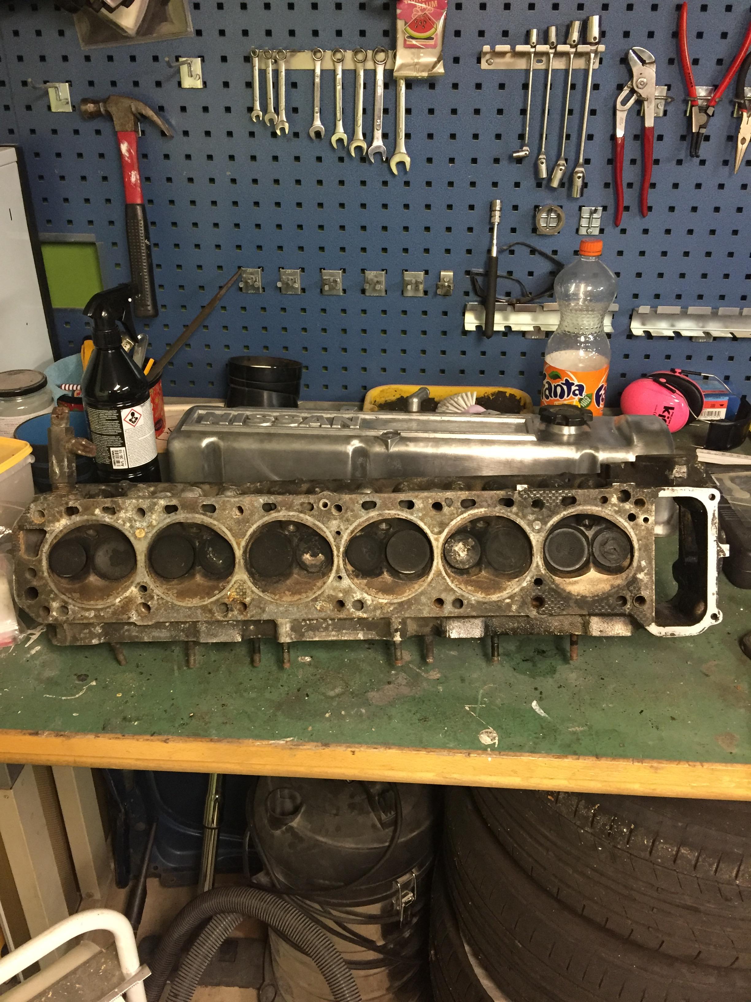

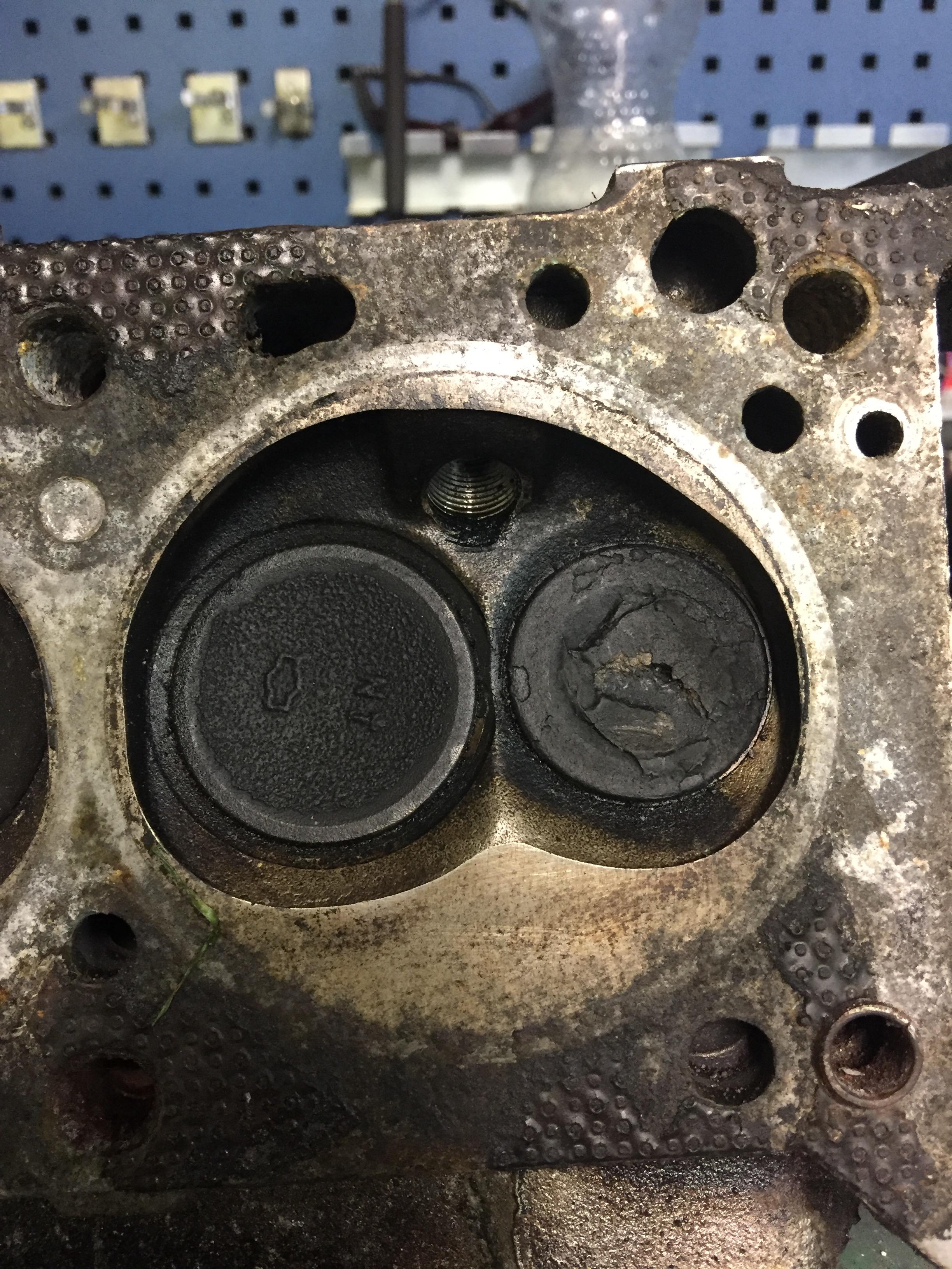

Well, as usual things changed. I found and bought two E88 EFI MR30 skyline heads. Will build a completely new head with the DP cam. Will install bigger intake valves 44 mm or 45mm, get it ported and aim for CR 11.0 -11.5
Hope to see a good increase in power.
How are you going to handle pre-ignition or ping with a compression ratio that high? Will you be using race gas?
These chambers can handle “ping” better then the ordernery E88/N42 chambers. The bigger cam will also help. Will see how it goes but I don’t see a big problem with it as many people seams to make it work with these type of heads.
Will be running pump fuel 95 or 98.
Nice combo ! I’m jealous . Great combo of small chamber and square port exhaust !
