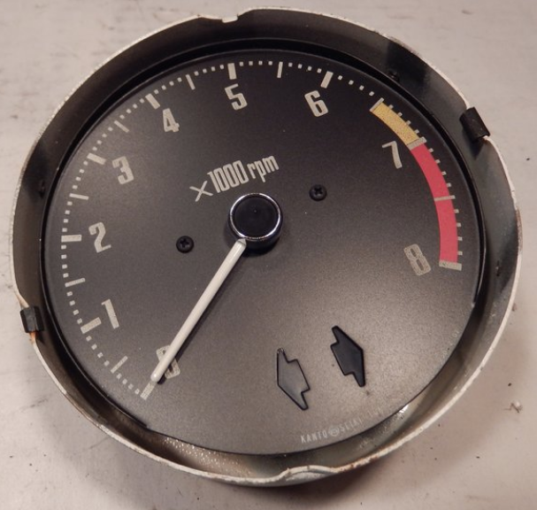

The tachometer needle is a good clue for spark problems.  It's a spark monitor and counter.  Might add some detail to "made it worse".

You didn't answer the question about the tach needle either.  Could be a carb problem.  Good luck.  Make sure you can go back after you make your changes, you might end up making new problems.

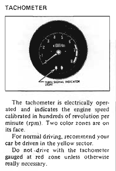

You're way up in the "unless otherwise really necessary" zone.  Danger.
