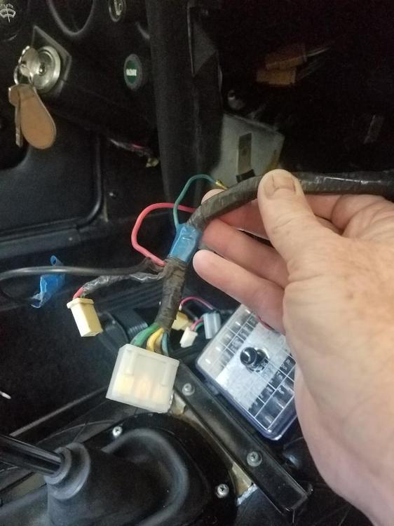

After looking a this closer looks like the red (+) wire from the blower motor harness is blower motor power source.  So where does this go?  The only wire I have left over to hook this too s a blue wire (See photo attached)

The FSM says the map light RL wire connects to a R wire that is common to all the gauges - you should have an open female connector nearby.  The black wire should be a nearby ground.  At least you figured out the male plug red wire  on the blower harness is for power - could have been exciting! :finger:
Do you have the FSM and '71 Supplement downloaded for reference?
Both are easy to identify as both have a fuse holder in the same line.

The FSM shows the R blower harness power connected to a L (blue) wire - looks like you are on track there.  And it looks like a blue wire is also power for the radio.
Jfa.series1 thanks for the help.  I just wanted to confirm I was on the right track.  I'll look for the red wire with the open female connector for the map light tomorrow.
Thanks again for your help!

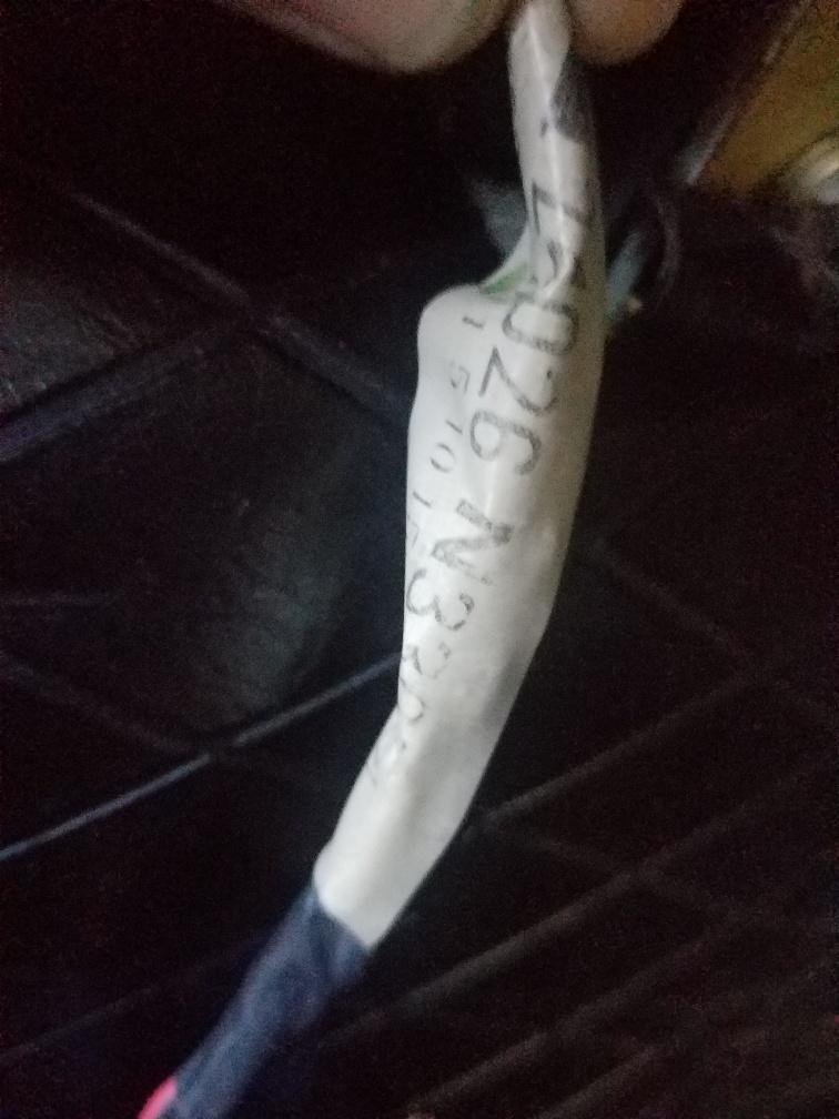

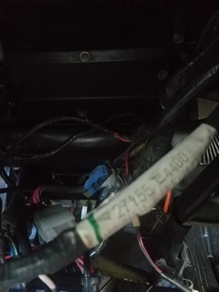

Have the same wiring harness part number as the start of this post 21755-4400 (73 240Z). See attached. Connects to blower motor and blower switch. The ground (black) coming off this harness, I had marked as radio ground. Like a DA didn't take a pic of where this ground wire would have attached to the stock radio. Is it as easy as pick one of the mounting screw on either side of the radio to ground? My FSM is delete of a radio wiring diagram.
Also harness number 24026-N3300 carries the three small panel lights (fan switch and heater/vent controls) in the dash. This harness also includes a black ground. I marked as console ground. Again DA no pic upon removal. Where is the this ground mounted? (back of the fan switch plate?).
