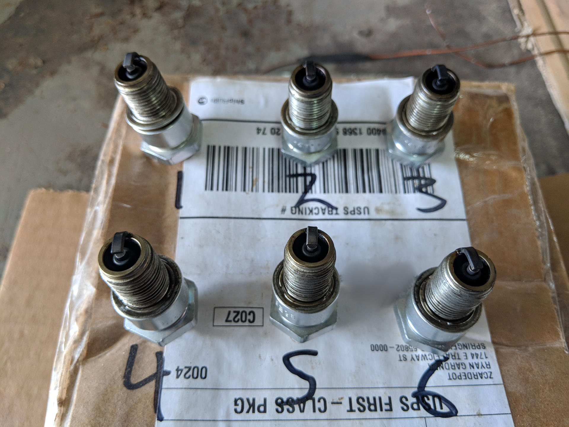

He said he has strong exhaust fumes but it pops through the AFM so I'd do what Bob says above, shows us your tips. ?
Related image
I have never been an expert spark plug whisperer but I will add 'Pictures of tips' to my to-do list.

  • Take pictures of the spark plug tips

Alright reporting back some findings.
  • Fuel Pressure: 34 PSI @ 800RPM
  • Vacuum:  18 inHg @ 800RPM
  • AFM rotated back 6 teeth (original setting)

fuel pressure to high, with that kind of vacuum you should be close to 29psi at idle. are you sure the vacuum lead is connected to the FPR? is the fuel pressure changing with the vacuum? If those are newish plugs you are too rich, again too high a fuel pressure could account for that.
