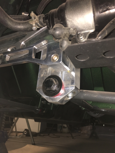

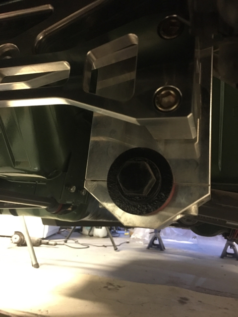

I have the TTT control arms and Arizona Z mustache bar. My bushings have fallen off a couple of times. I found one on the road, luckily. I put a thin piece of rubber around the bushings to help hold them on. In the pic, there are threads inside the control arms. What are they for ?  Thank you.

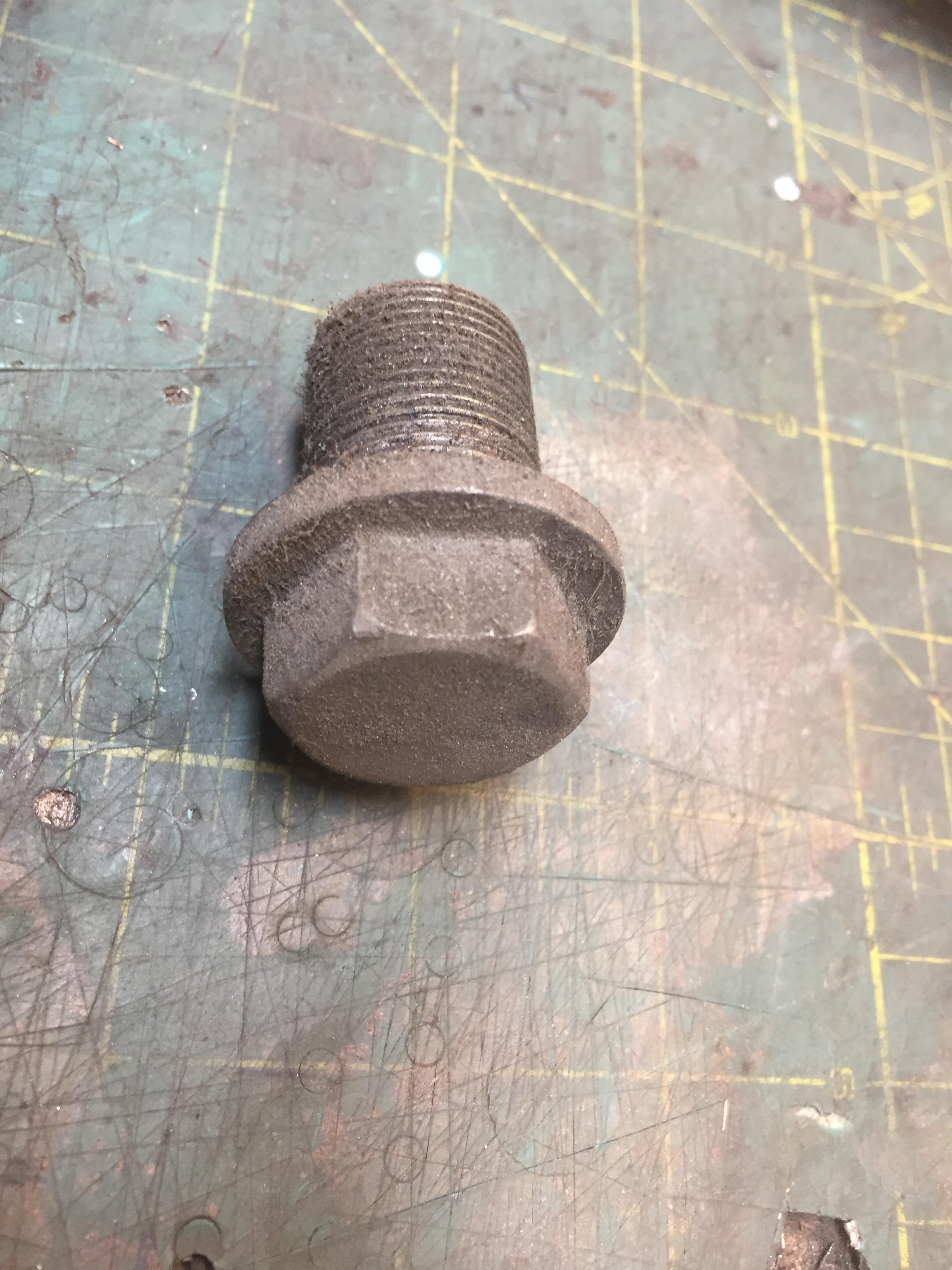

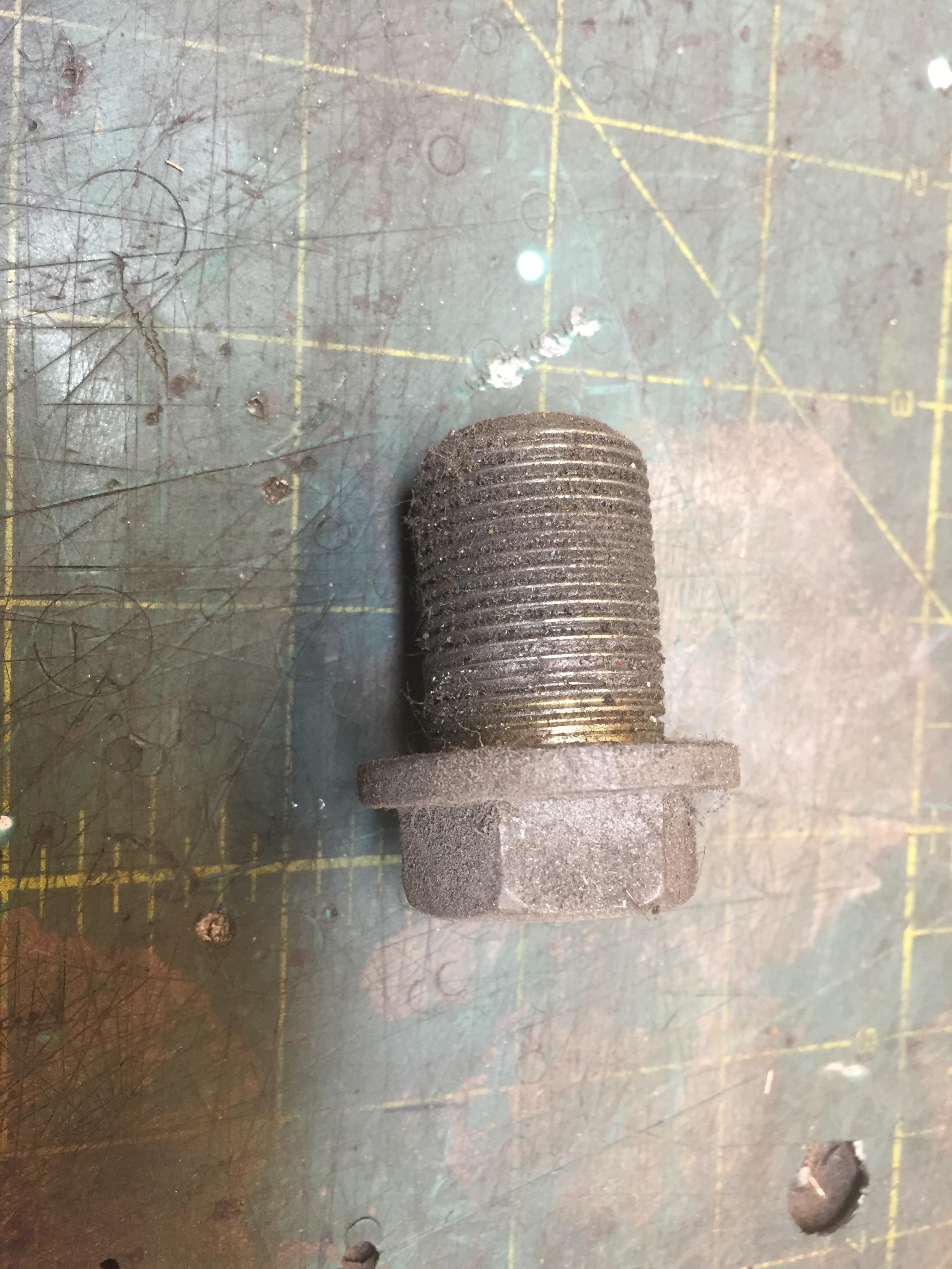

I snagged a set of those bolts from a wreck the other day if you can't find yours. They are M22x1.5 and NOT easy to find as a generic bolt. There is a biga$$ flat washer and star lock washer that goes with as well.
Haha! In case you haven't already figured it out from the previous posts... Those threads inside the control arms are what accepts the bolts that hold the control arm bushings in.
Without those bolts, the bushings will fall out as you drive. Repeatedly.  LOL
