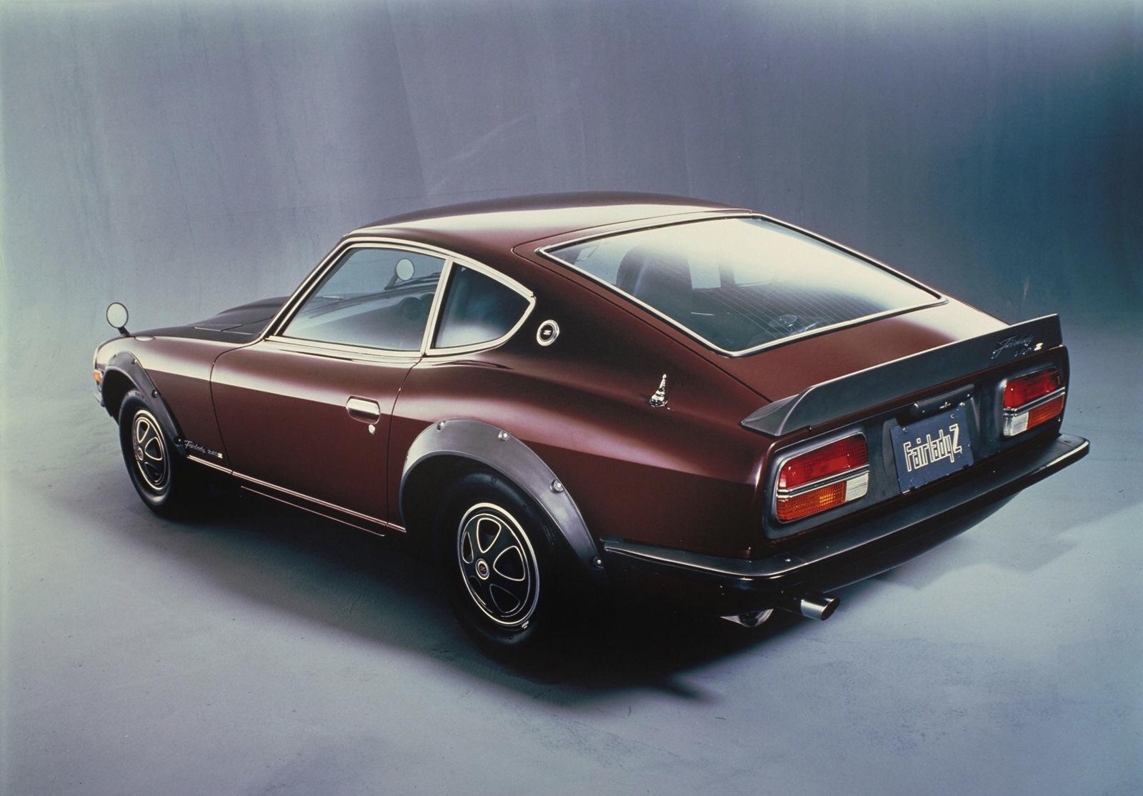

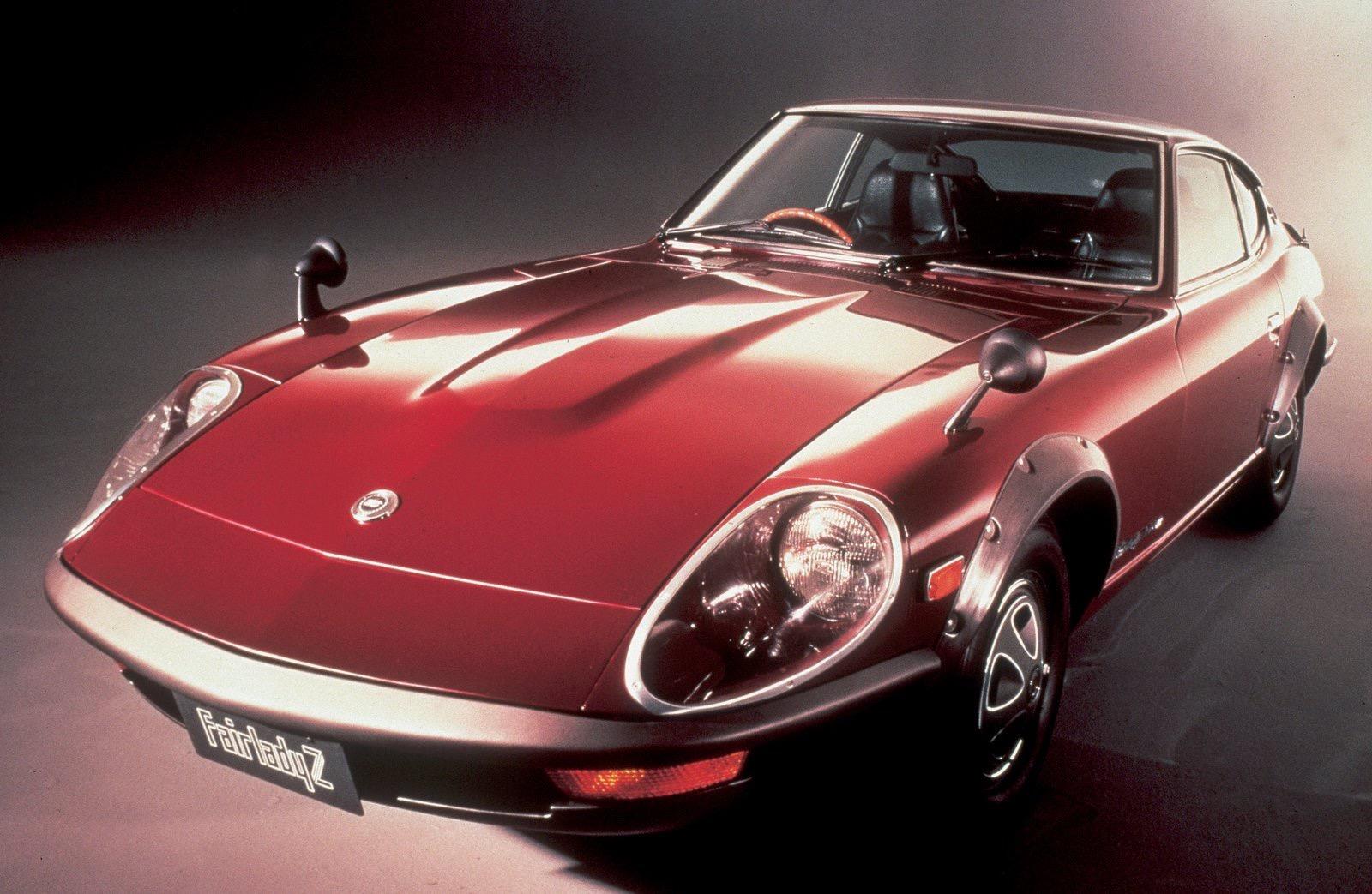

ZG is a little tricky for the kind of auction, I am afraid how many people can feel “ZG is fantastic “ .
#1. Can Maroon be attractive for the people?
#2 Sticking to the stock condition must be required for the kind of the auction ,the car must have hub caps and 5 inch steel wheels , in this style ZG looks little wired , you may think “why the car has over fenders? “
#3 G nose urethane bumper must have certain gap between the head light case ,
but the bumper itself must be nice and straight when you see the front of the car .
And like Alan said , the upper front extension panel also must be nice and parallel with having the equal gap between the bumper and the bonnet.
So , ZG is complicated, some must be looked “ imperfections “ but some must be looked neat and perfect.
Small thing makes a big difference, and I hope when a perfect ZG is showing up the auction, people can feel it’s beautiful atmosphere from the car .
Even more , when you are behind the wheel, you can feel the acceleration is really good and also handling is very well in high speed cruising, with a silence.
The Nissan test crew reported ZG gains its stability when the car put a rear air spoiler.
