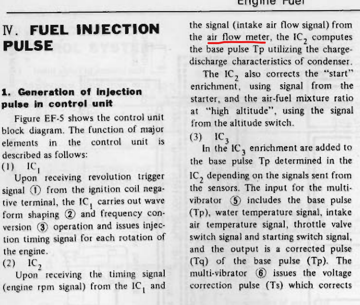

You can get the ECU to open the injectors just by triggering three sparks, with the key on.  If the circuit works.  You could probably build a testing device with just power to the ECU, some lights on the injector grounding transistors and a voltage pulse to Pin 1.  People often run their engines with the AFM unplugged.  The base pulse is very basic, apparently it doesn't really need any sensor data.  It's the starting point and all else is an addition to its length.
Just saying, it's a simple input-output device.  A scope would tell you base pulse length but might be more than needed to see if the ECU works or not.
The FSM implies that the AFM signal is necessary but it must not need to be generated by the AFM.  Since the engine will run with the AFM unplugged.  The ECU just uses whatever is on those wires at the ECU connector.  Open circuit seems to be enough.
