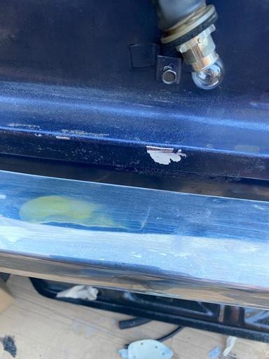

I would think a good buffing compound and a  rotary buffer would take care of the lines
That is a great idea! It also worries me that it may leave swirl marks behind. I have a spare rear screen, so I will have a go on that one at some point in the winter. There is a part of me that wonders if you would ever notice the 2cm difference in defroster height if the lines were totally rubbed out and frost fighter installed!?
And masking tape on the roof around the hatch hole where the hatch might touch too.
Masking it is great advice!! [emoji106] Just one word of caution, masking tape is EVIL stuff especially if you leave it on the car for any length of time. Ask me how I know! This is what happened when I peeled off the tape just below the rear plate a few days after I was doing some work in that area!

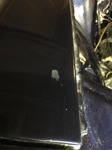

Another time, it had a really weird reaction with the paint that looked like Yellowstone park and took 2 months to disappear by itself!
