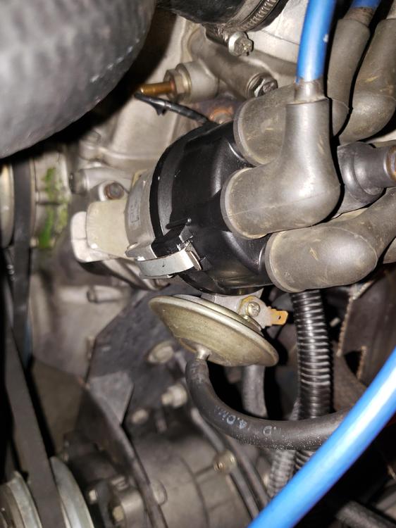

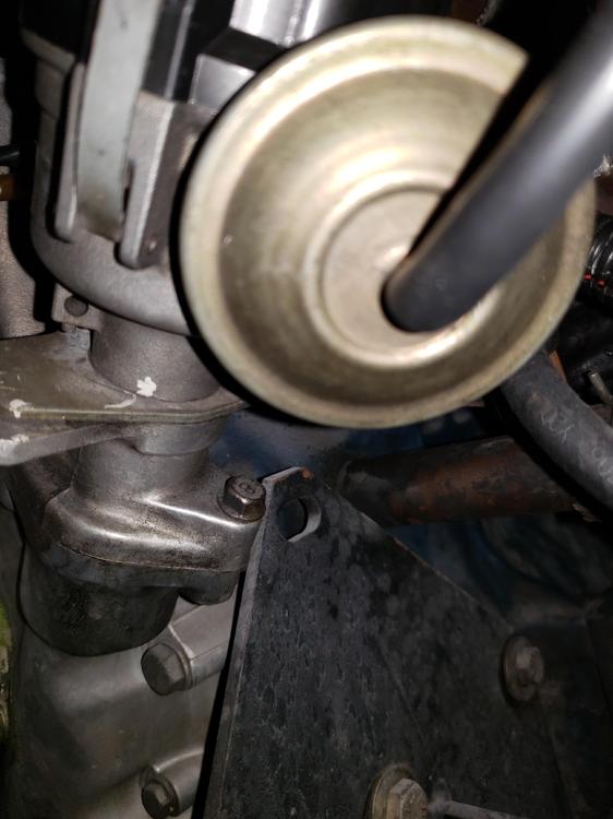

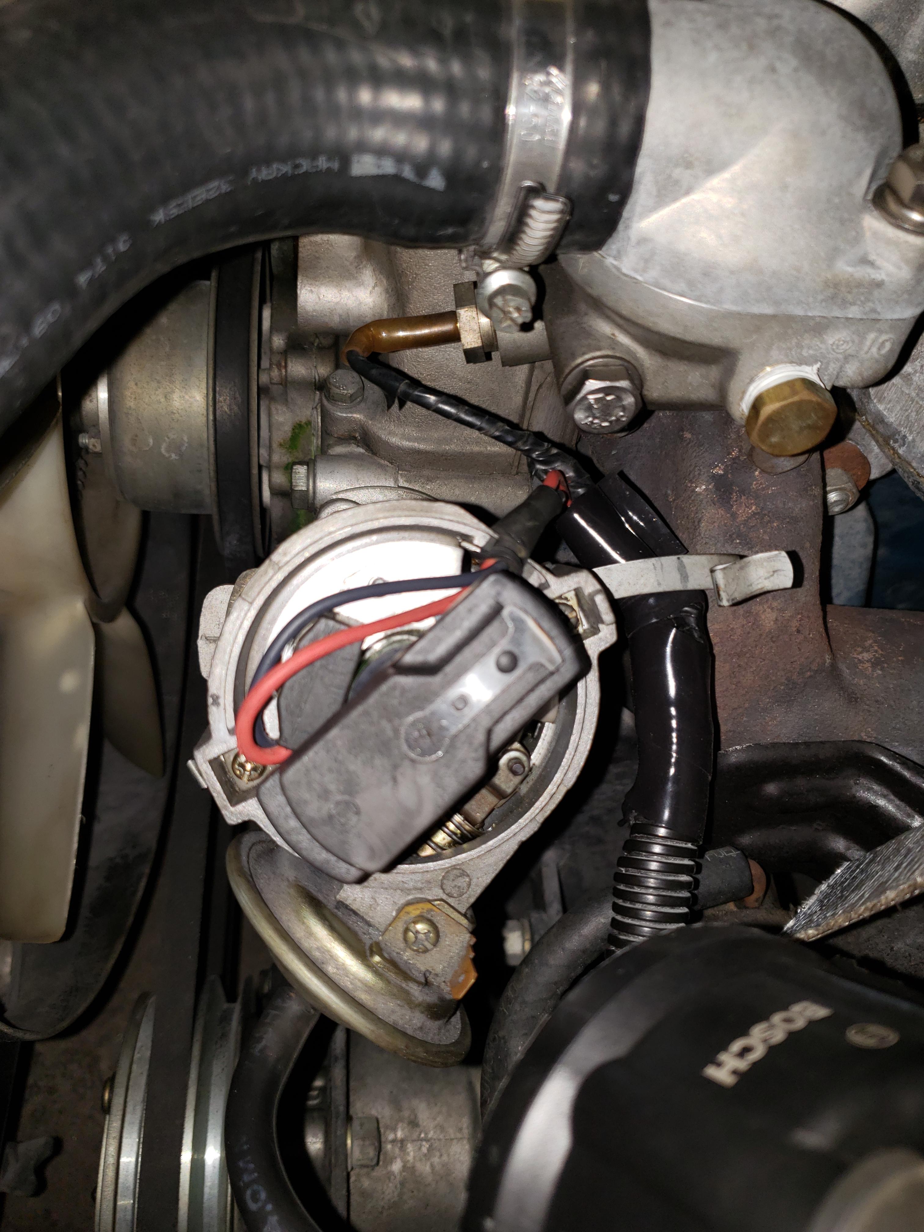

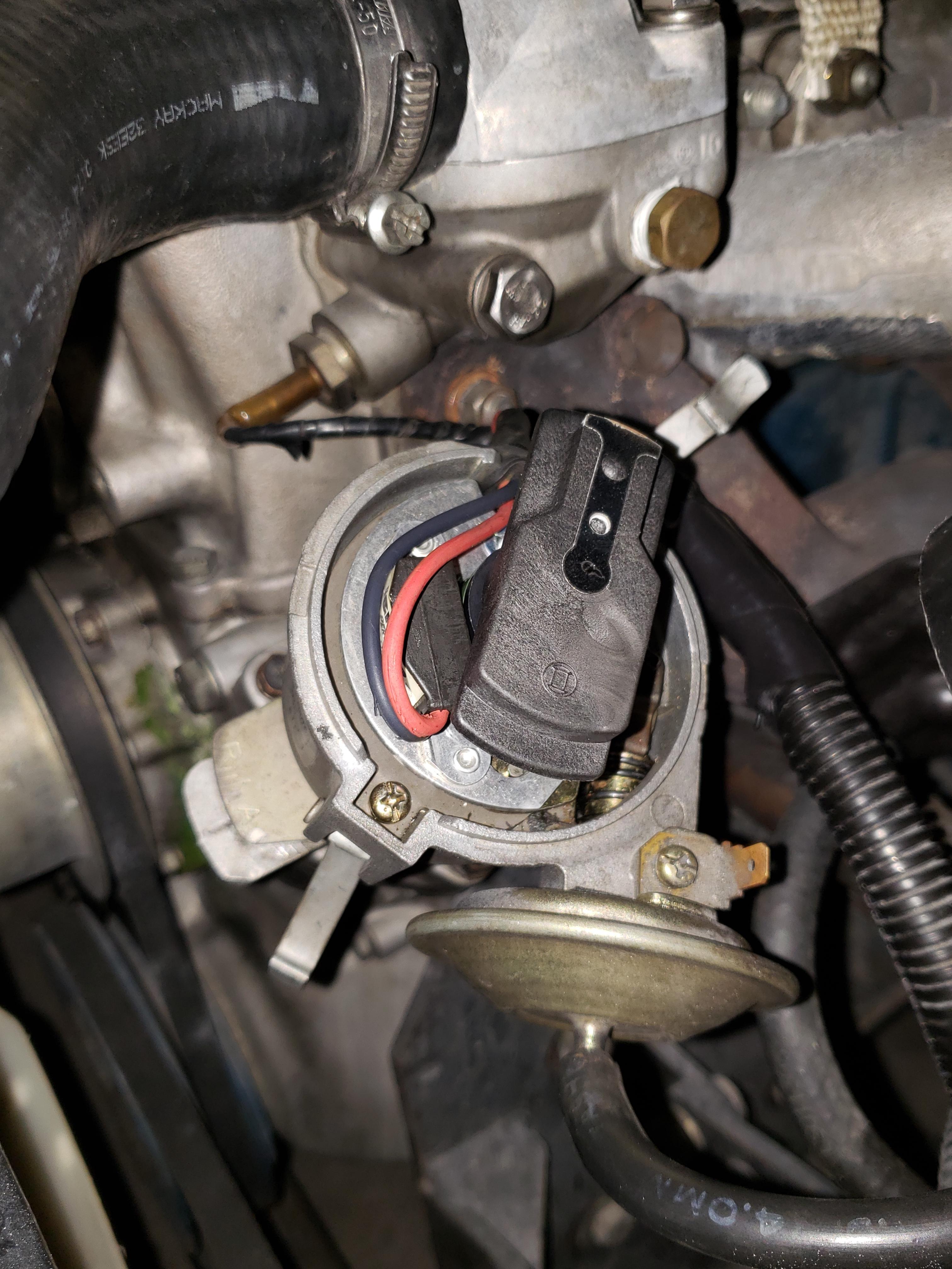

Just took some pics of the original hitachi single point distributor before i attempt any removal, inspection of gasket and reinstallation. Dont notice any oil leaks but would like to be sure it has the o ring and base gasket in place. Please guide me on the removal and reinstallation process. Last time i did this the engine did not start.
