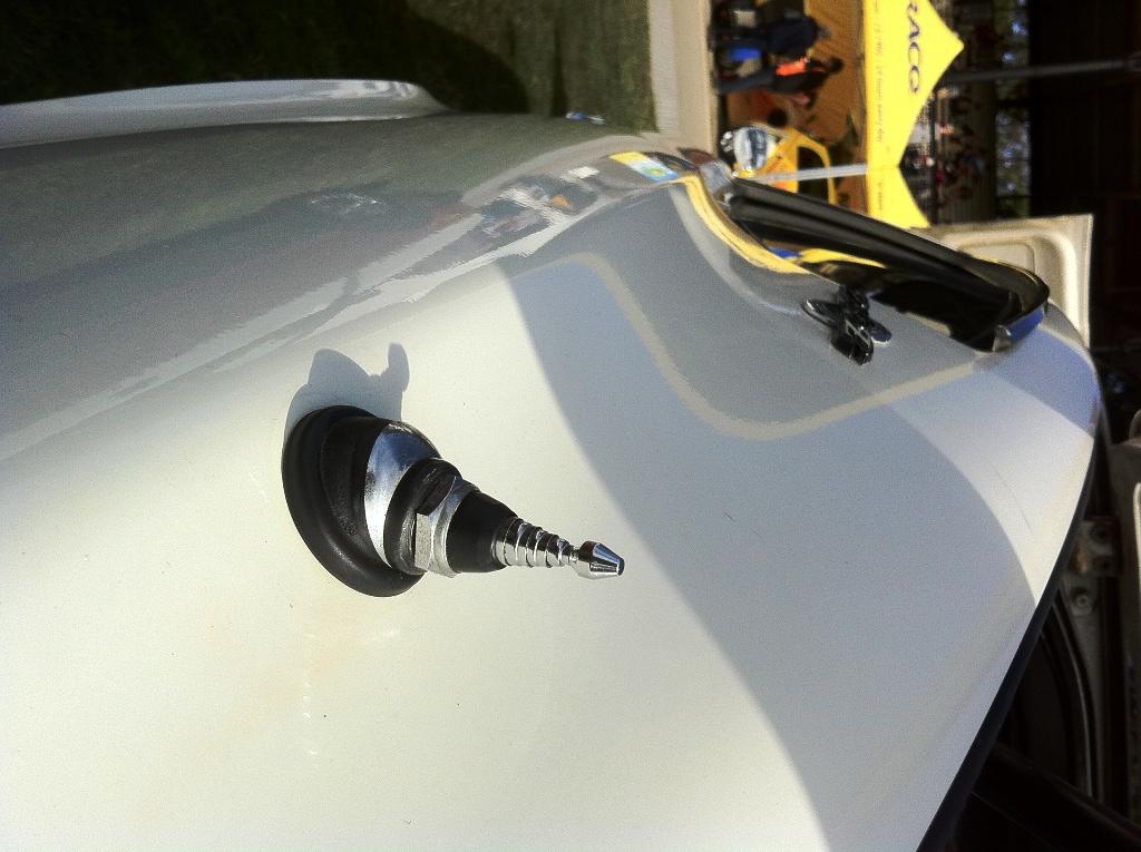

The mast tip is different from the earliest versions.  We discussed this years ago.  The very earliest versions had a pointed tip where as this version has a flat tip.  I don't know about the length.  It IS the original manufacturer and I believe will fit all S30 models.  Sorry for the rotated picture.

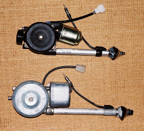

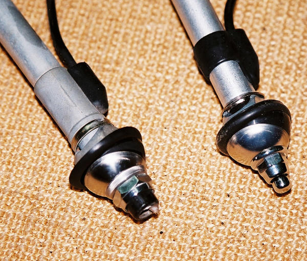

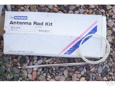

Here's some antenna porn from my files.  I don't know anything about the black coil antenna.  It has a different tip as well.  The Harada antenna is the one shown in my parts book and the tip is the blunt topped version with the black ring.
