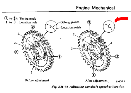

Set the damper pulley ignition timing mark on zero, it's almost there now.  Install the head with the cam lobes up on #1 as you described.  Then install the cam sprocket so that the notch and groove are aligned as shown in the FSM.  You'll probably have to turn the camshaft slightly to get the sprocket on.  Since your timing chain is worn you might have to use the #2 hole on the sprocket.  Make sure that the driver's side of the chain, the straight side, is tight, and the damper pulley mark is on zero, when you compare the notch and groove positions. Once you get those three marks lined up you can spin the engine with no fear.

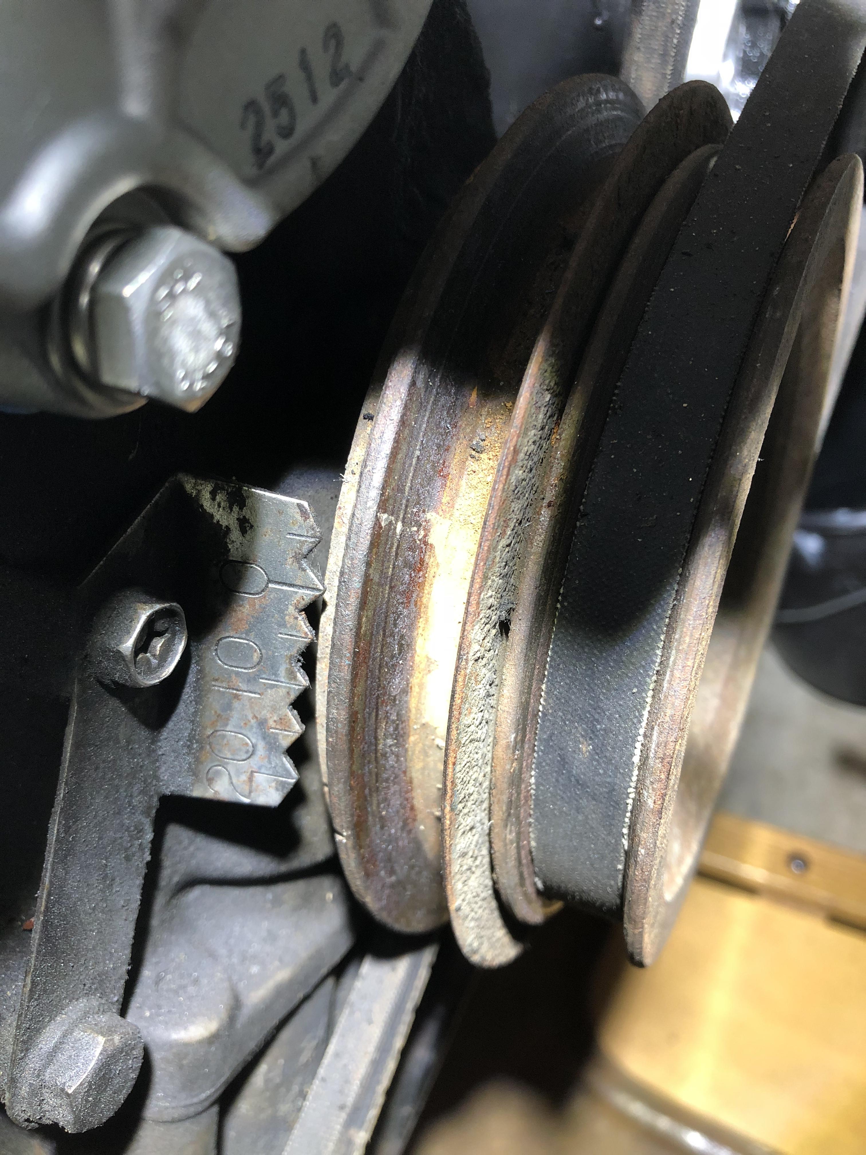

Yep got the sprocket installed on the cam as well. Here’s a pic of the damper pulley with notch mark close by the zero marker. Do I rotate crank to line up the notch from the pulley to the 0 mark and that’s it?
DO NOT ROTATE THE ENGINE YET!
You should have lined up the crank sprocket on 0 first before putting on cam sprocket . It will be tricky to keep tension on the chain , but you should be able hold the tension tool in place and move the crank that small bit. THEN install the sprocket
He could also turn the camshaft the few degrees to match the damper pulley.  The key to not damaging a valve is that the cam timing matches the crankshaft timing.  If he's 30 degrees advanced on the crank the cam should be 15 degrees advanced.  Then install the sprocket and chain.  The chain is what actually controls the cam and crank relation.
There's basically two steps involved here.  1. Get the head on with the valves in the proper position to not hit piston tops.  2. Get the sprocket and chain on so that the crankshaft can be rotated without valves hitting piston tops.
Keep those two things in mind and come up with a solution.  People have used a pipe or lever to hold up the sprocket and chain while they moved the crankshaft.  The big risk now is having the tensioner pop out.  Then he's in a whole new world.  The tensioner really really wants to pop out of its hole.
Many possibilities.

Why do more guessing than he needs to. If he turns the crankshaft slowly and carefully while holding the chain he can get it to O. It wouldn’t take hardly anything to get to TDC, then figuring the camshaft location is much easier since you have the alignment marks to judge where to put the sprocket. I just went thru this because I forgot to mark the link when I removed the sprocket. I knew it was on #3 when I removed the sprocket , but dummie me forgot to mark the link. I was able to locate sprocket properly by using the factory alignment marks ( the - and the v) Logically if you are TDC on the crankshaft that is just one less thing to guess.
