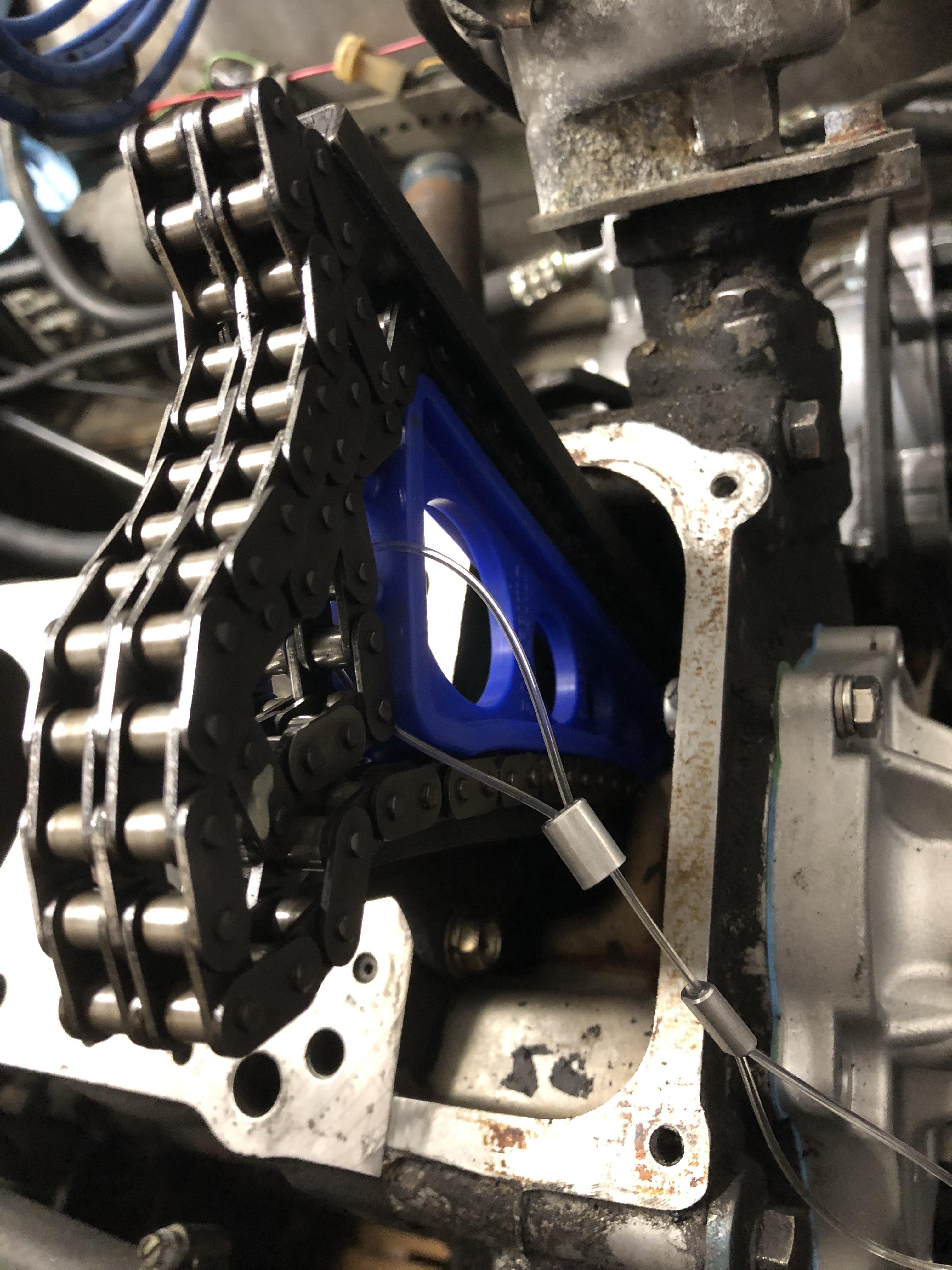

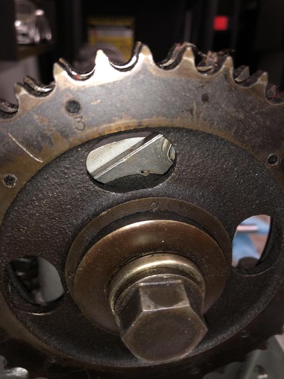

Does the crankshaft bright link end up in the same place every time the engine turns? I was under the impression that the bright links didn't line up on every revolution. I understand getting it to TDC that's easy enough with some measuring tools. Just trying to figure out how you can be sure which link is supposed to go on the cam gear. I never could find the stretch test marks on the head we just installed. I looked and looked and could never find them. I had to rely on the bright links to set it properly. I am not sure the camshaft gear was the OEM one though.
Probably wasn’t an OEM sprocket . I believe it’s every fourth revolution the links end up correctly.

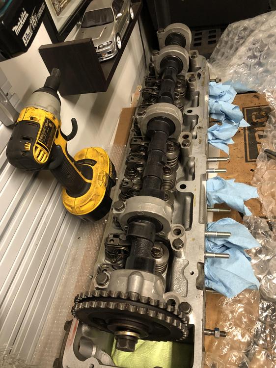

so just to be absolutely sure, I should only be turning the crank when the head is on right? Or the other option is Leaving the head off makes it a bit easier to hold down the chain tension tool while cranking the engine to zero mark. As soon as the crank pulley is lined up to zero mark I can install the head on and then install the chain onto the cam sprocket and then remove chain tension tool. Does that sound right? Seems like the easier way, also the head is in correct position currently. I attached a pic of the head.
Cylinder #1 looks close enough to TDC in top picture above.
Here are steps:
1. Install sealant at junction of block and timing cover
2. Ensure valve alignment matches head is at TDC.
3. Install head gasket and head.
4. Torque head bolts correctly.
5. Remove cam sprocket.
6. Fit chain on cam sprocket
7. Install cam sprocket (don't torque cam nose bolt yet)
8. verify timing marks on crack pulley and on cam sprocket.
9. If timing marks are off a little: Turn cam a little so that the crank pulley timing mark is aligned then note how many teeth the cam sprocket is off.
10. Remove cam sprocket and adjust to match the correct teeth.
11. repeat 6 to 10 until aligned. (You can use sprocket settings 1,2,or 3 to optimize cam advance).
12. Torque cam sprocket
13. Remove timing chain tensioner tool.
