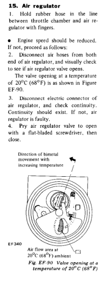

Both madkaw and myself have mentioned that the AAR should be more open than a sliver.  I can't remember what it looks like but Nissan provided a drawing.  Pinch that hose when it's cold.  If it splits fix it with a piece of heater hose.  Then you'll know.  But you still have vacuum leaks.

Per the instructions I copied, your AAR is out of adjustment.  Adjust it so that it is open on the average morning.  It moves, which is good, but it's starting from the wrong spot.  And you still have vacuum leaks.
