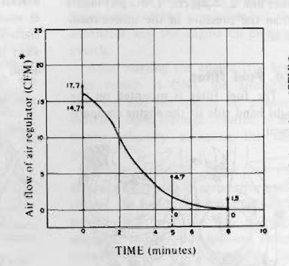

Whatever parts you're moving, if it's open at 68 F (not freezer temperature), and closes after about 5 minutes of 12 volts, it's good.
I forgot to copy Nissan's chart in before.  EF-18.
