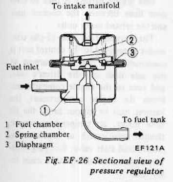

Just looking back here...this should have required very high pressure to do because in reverse the FPR has a very very small area to press on to get the valve to open.  You might have actually blown a hole in the diaphragm, or maybe even expanded the FPR body.  In normal flow direction the fuel has all of the diaphragm to press on to get the valve off of its seat.
If you blew a hole inthe diaphragm you'll be pumping gasoline through the vacuum hose to the intake manifold.
Imagine the fuel flow in reverse in the image.  That's what would happen if you used compressed air from the return line at the tank.

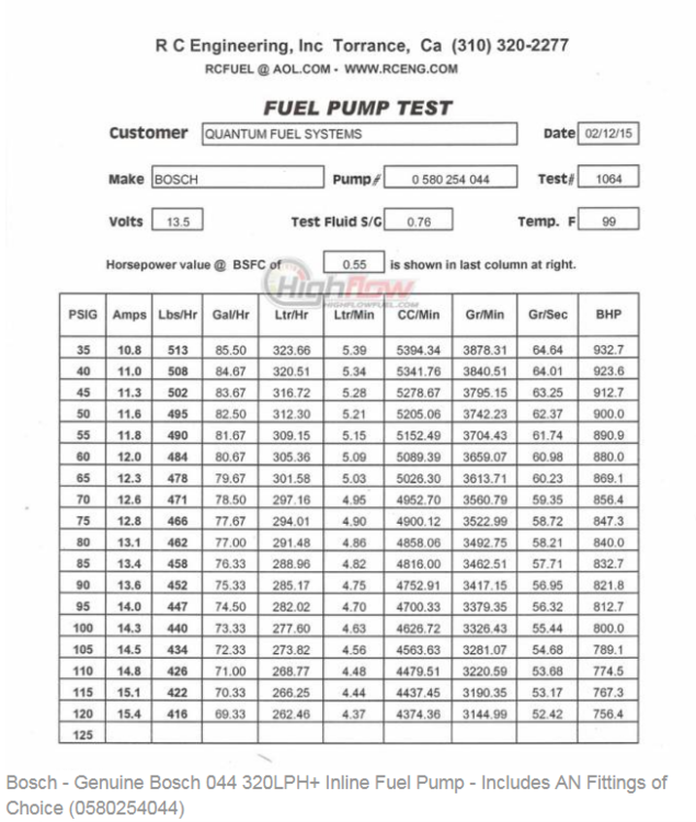

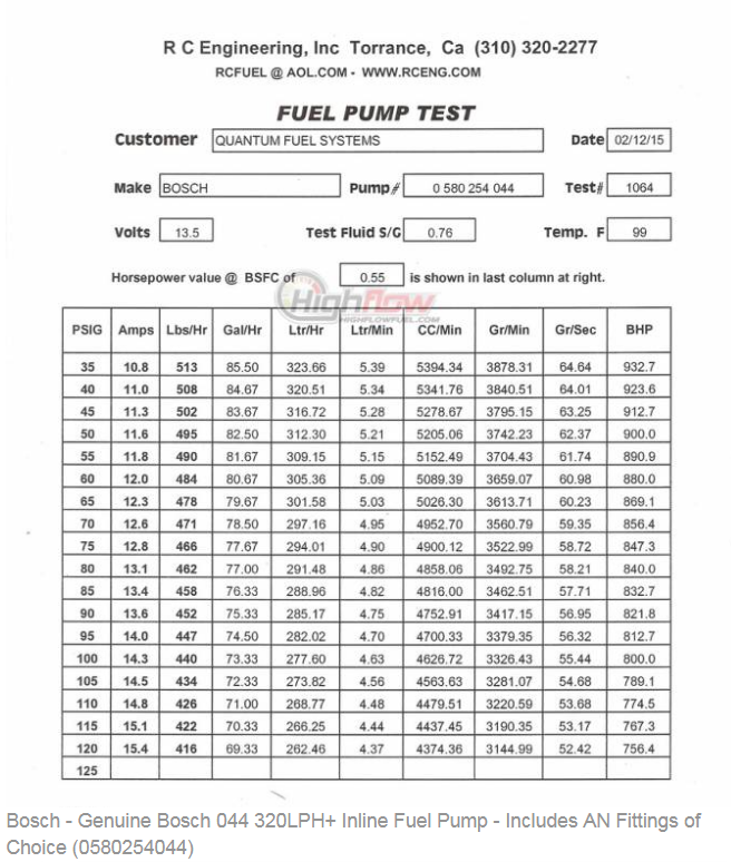

That Bosch pump should get you about 120 psi.  I don't think that they have a pressure relief inside.  They just keep cranking until flow stops.  Be careful you could easily pop a hose, or balloon your filter.  The Bosch 044 is way over-spec. for what your engine needs.  You might reconsider.
https://www.highflowfuel.com/i-13775895-genuine-bosch-044-320lph-inline-fuel-pump-includes-an-fittings-of-choice-0580254044.html
