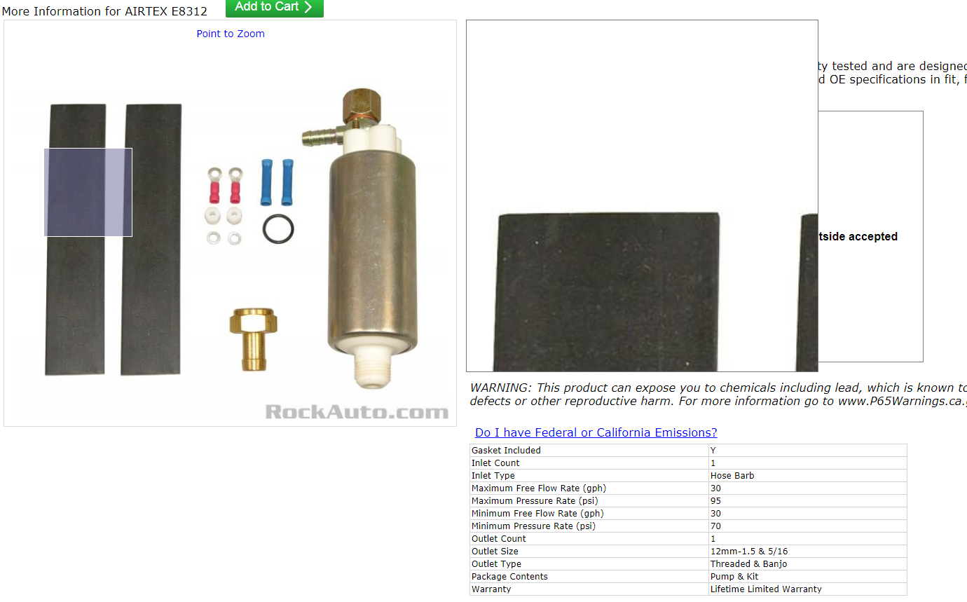

That’s the same pump that I got from a different vendor on Amazon and only get 26PSI. AirTech unit does not say how much PSI or GPH.
It's out there, hard to find.  Rockauto has the specs I think.  Your old pump is broken.  It's not meeting its specifications.  A new pump very likely will.
Just trying to help.  Go ahead and get one of those high volume pumps.  You'll know when it's spinning, for sure.

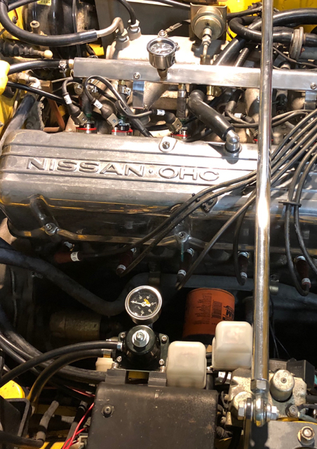

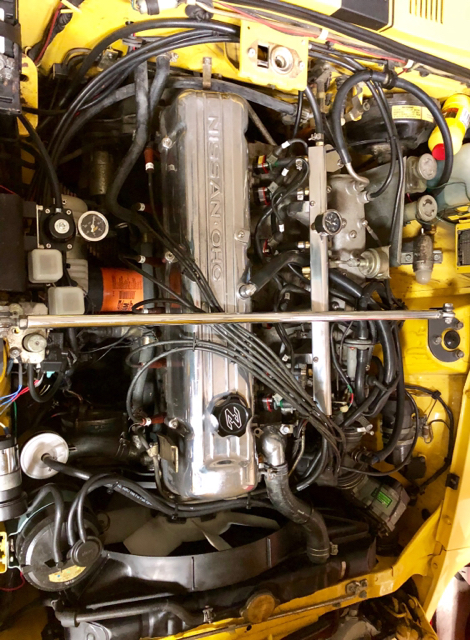

THE NEW Fuel System
1. Brand new in-line AIRTECH fuel pump.
2. Brand new rubble lines 3/8” from tank AIRTECH PUMP.
3. Brand new rubber 5”/15” fuel lines to AIRTECH fuel pump.
4. Brand new rubber 5”/15” fuel lines fuel filter.
5.Brand new rubber 5”/15” fuel lines to Brand new PELLERT rail.
6 Brand new rubber 5”/15” fuel lines out PELLERT rail.
7. Brand new rubber 5”/15” fuel lines out to a FUEl REGULATE;
8. Brand new rubber 5”/15” fuel lines in of FUEl REGULATE;
PELLERT.
9. Brand new rubber 5”/15” fuel lines out of FUEl REGULATE;
Again thanks for all you HELP
