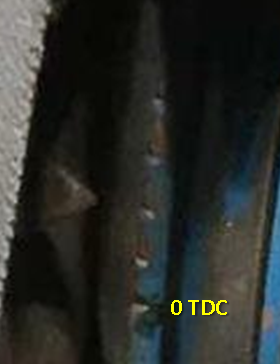

1. Which of the 5 marks should I use on the camshaft pulley? See picture. Some sources say the first and other sources say the second. It doesn't really matter with setting the chain on the camshaft but it does matter a lot with reading the timing notch and grove on the camshaft sprocket. Which brings me to question 2.
2. Use 27mm socket on crank to turn the engine clockwise as viewed from the front of the car. If you overshoot TDC on the crank, you can back up CCW then re-approach CW. (Don't go backwards (CCW) and stop at TDC).
3.  Removing plugs makes turning easier and more precise.
Make sure you are on compression stroke if you are checking chain stretch using the cam marks. I usually find something to stick in #1 spark plug hole that will pop out easy when you are turning over the engine and it builds compression. My favorite hole stopper is a large vacuum plug shoved into the spark plug hole. Believe me , you’ll know when TDC compression is coming.
as far as the pulley marks, if you look closely , one V mark is bigger then the others , that’s TDC.
