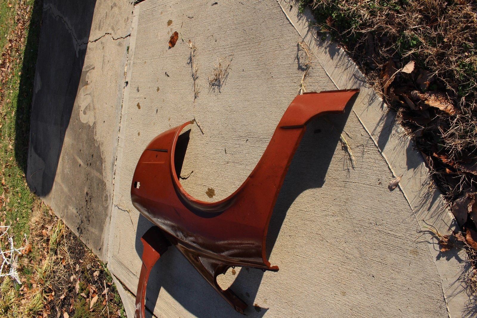

240260280 Posted January 1, 2019 Share #44 Posted January 1, 2019 More on Ebay $4k Price Link to comment https://www.classiczcars.com/topic/61045-s30-nos-quarter-panels/?page=4#findComment-564994 Share on other sites More sharing options...
gundee Posted January 1, 2019 Share #45 Posted January 1, 2019 31 minutes ago, 240260280 said: More on Ebay $4k Price 1987 Dealer suggested retail price was $466.79 ea. Link to comment https://www.classiczcars.com/topic/61045-s30-nos-quarter-panels/?page=4#findComment-564996 Share on other sites More sharing options...
240260280 Posted January 1, 2019 Share #46 Posted January 1, 2019 If Santa was good: https://www.ebay.com/itm/Datsun-70-78-240Z-260Z-280Z-NOS-OEM-Quarter-Panels-Pair-LH-RH/183612252327?hash=item2ac024a0a7:g:eWkAAOSw1rpcKRNF:rk:6:pf:0 Link to comment https://www.classiczcars.com/topic/61045-s30-nos-quarter-panels/?page=4#findComment-564998 Share on other sites More sharing options...
