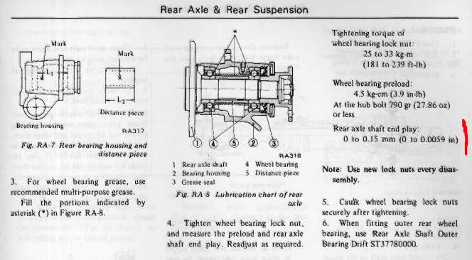

My first thought was a worn bearing or one that wasn't replaced properly.  People have problems installing the rear bearings.
If it only happens when it has a side load that implies that the wheel and everything attached to it might be shifting slightly.  If you take the wheel and drum off you might see some grind marks and/or be bale to feel the wheel flange play.  There is a spec for side play.  It's not much.
It's not uncommon for the backing plates to get bent on the edges when people try to remove the drums.  I had one of those.  You'll see a shiny spot on the edge, where it almost meets the drum.  Actually, where it meets the drum but is not supposed to.
If axle play isn't bad you can just tap or plier (ply?) the ding out and put it all back together.  The rear bearings aren't really super precise.  You can wait to change them.

The drum brake noise came from a bent edge on the backplate (thx for the hint zed head). Wheelbearing  play was minimal.  After pulling the drum it was pretty obvious which part was rubbing (ground some nice groove into half of the cooling fins).
