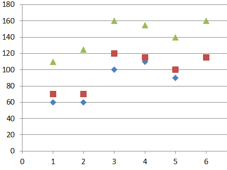

AK260, thanks for the support! Got back in the saddle today with new tool, and also increased starter time from 3-4 seconds per cylinder to ~10 seconds per cylinder to test. Here are the results:
  1. 110
  2. 125
  3. 160
  4. 155
  5. 140
  6. 160
So, feeling much better about things but still have something to investigate in cylinders 1 and 2. Any concern about cylinder 5?

 If you started the compression test with #1, #1 and #2 may be reading lower because the engine didn't have any oil pressure at first. When I start with #1 and test them all, I usually go back and retest #1 and #2 again and usually find the compression has gone up. Did you reset the valves before the latest test?
On 11/18/2018 at 12:51 PM, Geoff's 240z said:
Tested Cold/Warm
  1. 60 / 70
  2. 60 / 70
  3. 100 / 120
  4. 110 / 115
  5. 90 / 100
  6. 115 / 115
His first set of measurements seem to show some increase on the second one, but not near the difference between cylinders.  Are we over-hoping?
1
Over hoping? Yup. Just the Pollyanna in me. But the realist in me would be pulling the valve cover, taking a good look at the cam and valve train. Adjusting the valves and retesting.
Agree.  The whole engine really needs a good checking.  Obviously it's got problems.  If there's one there might be others.  Best start with the basics and run through the list.
