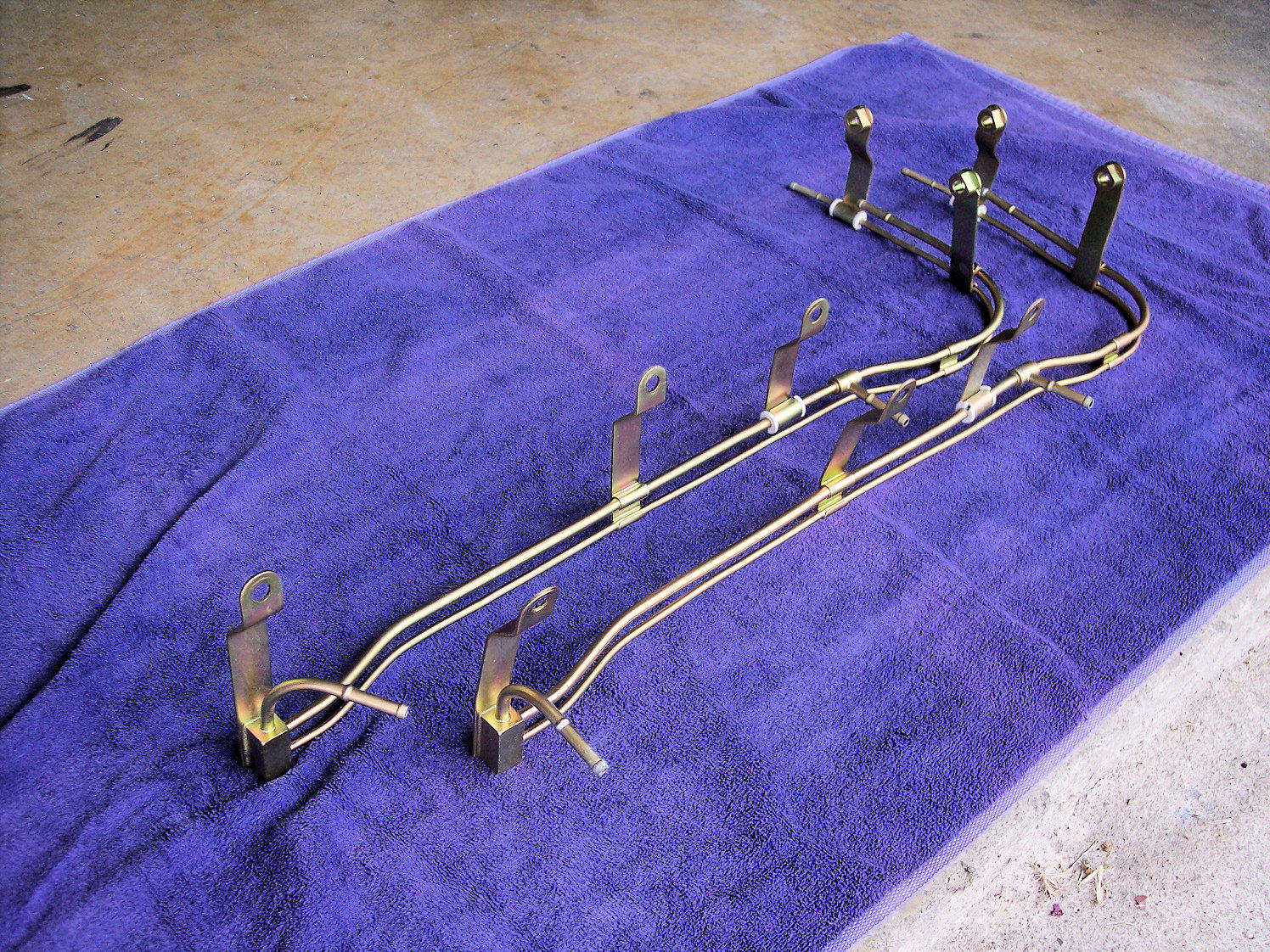

I know you asked for info on chromate plating.  There has been quite a bit discussion on this site recently about whether Nissan used chromate or yellow zinc plating.  I think the consensus is Nissan used yellow zinc and clear zinc for plated parts, not chromate.  Just FYI, your car and your choice as always.  Examples of recent yellow zinc replating:
@Zup - Jim, thanks for the kind words.  I get all my plating done locally at a commercial facility, they know me by sight.  I've found that its all about the prep work beforehand.  Recall the old IT saying - GI-GO.  Lots of wire wheel and Dremel work to remove rust, scale, ...whatever.  Even a bit of wet sanding when required, straighten anything bent, ...etc.  Its a great hobby and I enjoy seeing good parts get a second life.  Not the least, the hours keep me off the streets at night! ROFL
