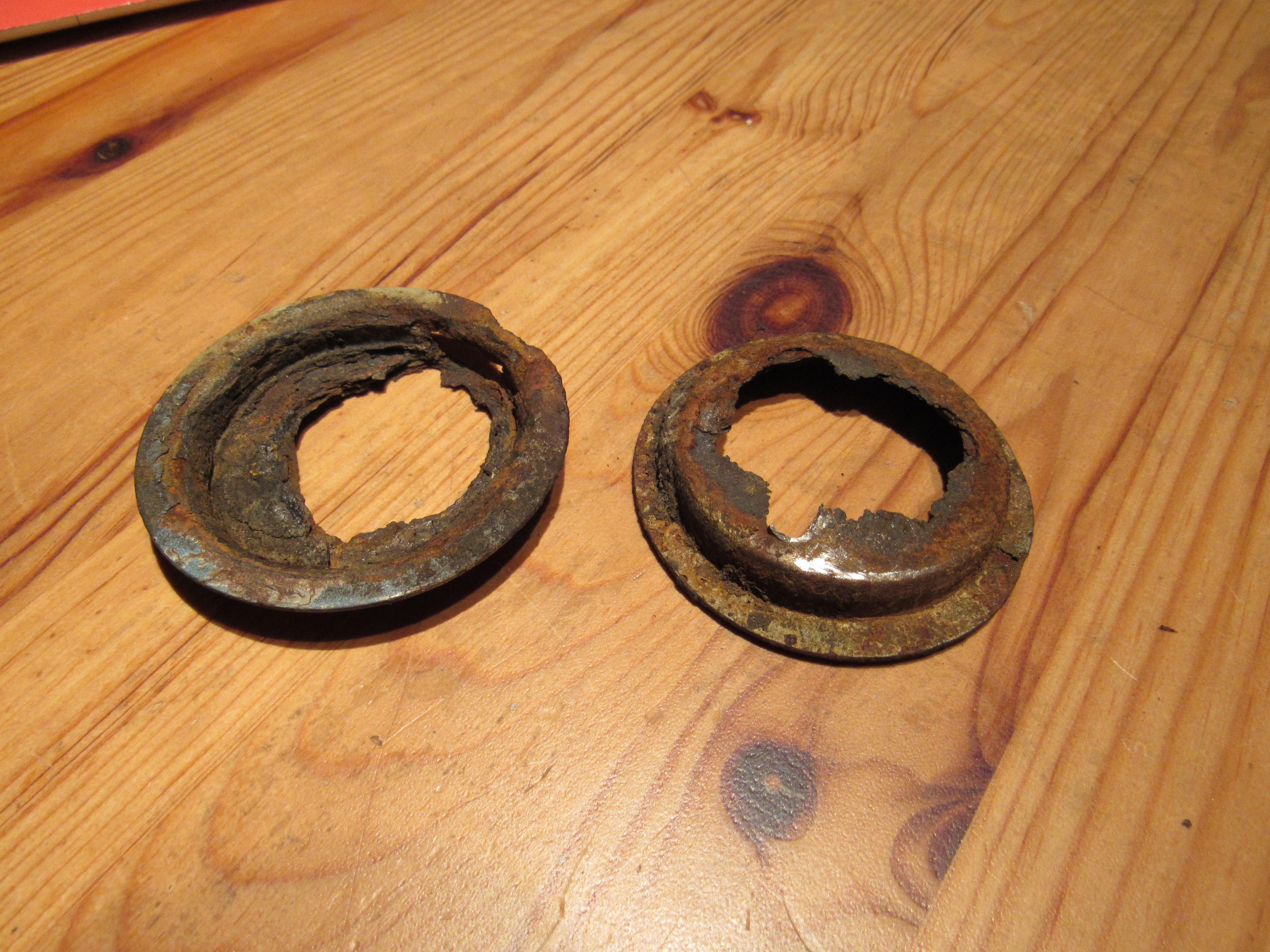

I need to make up a couple of the T/C rod rubber bushing locator-flange thingys,  can anyone tell me what the diameter of the central hole is? It is somewhere between 13-20mm.

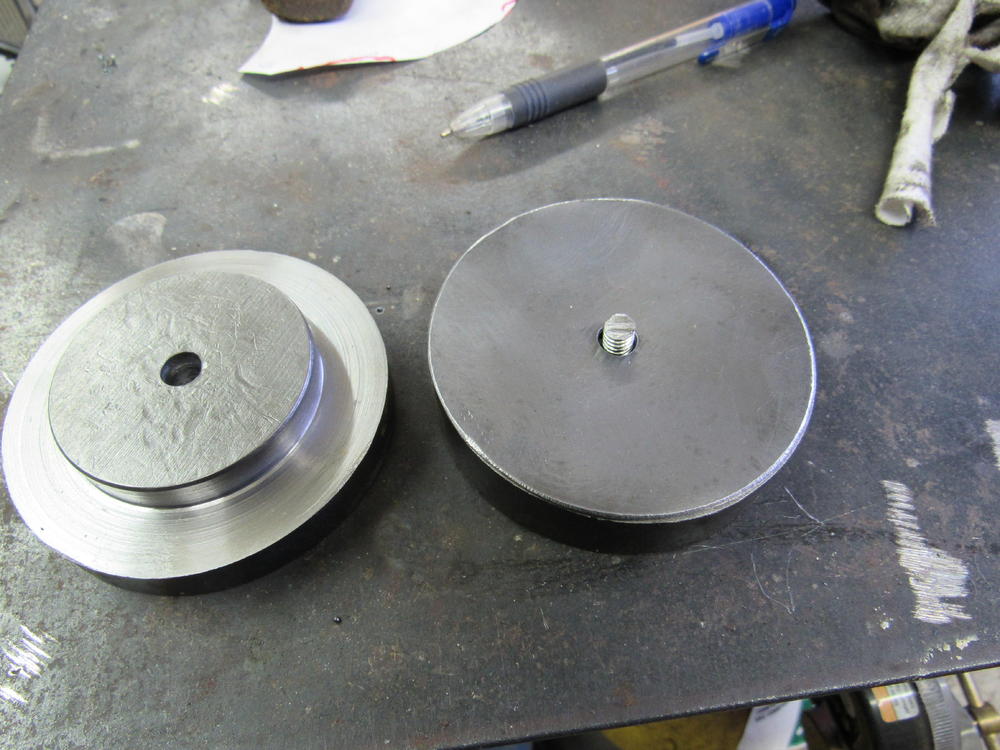

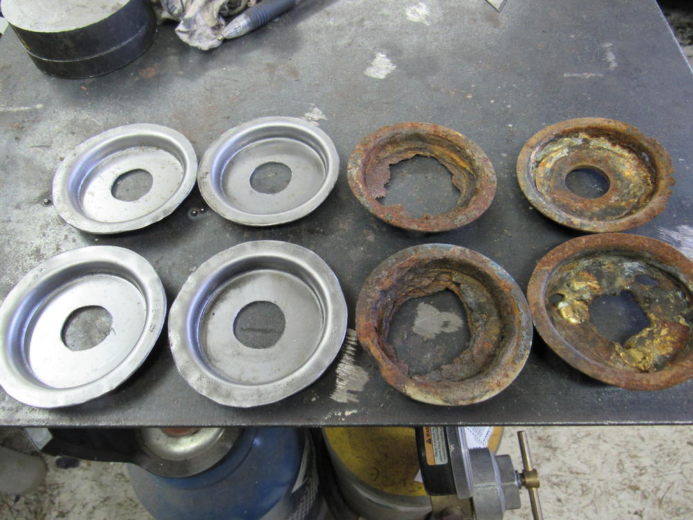

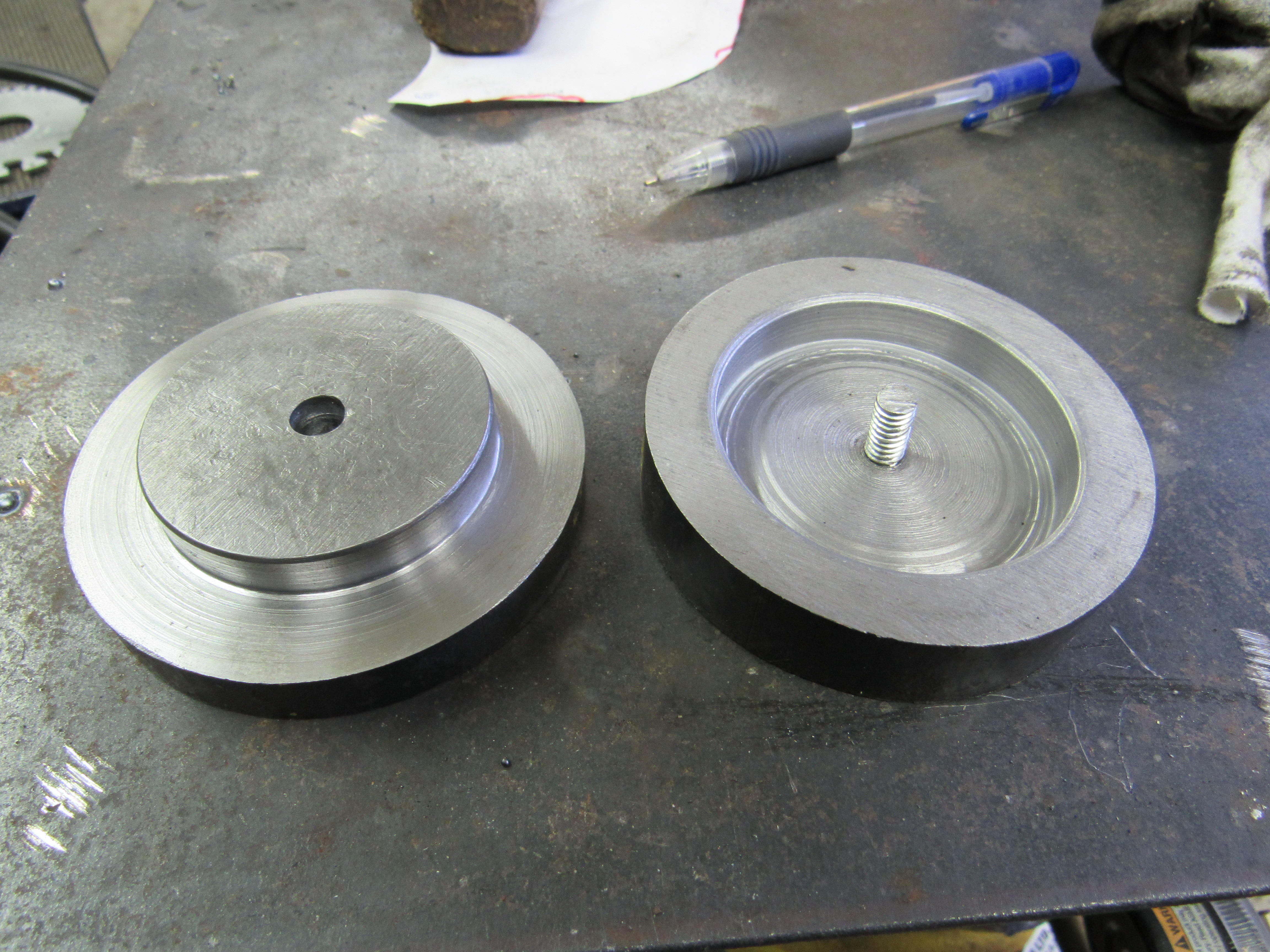

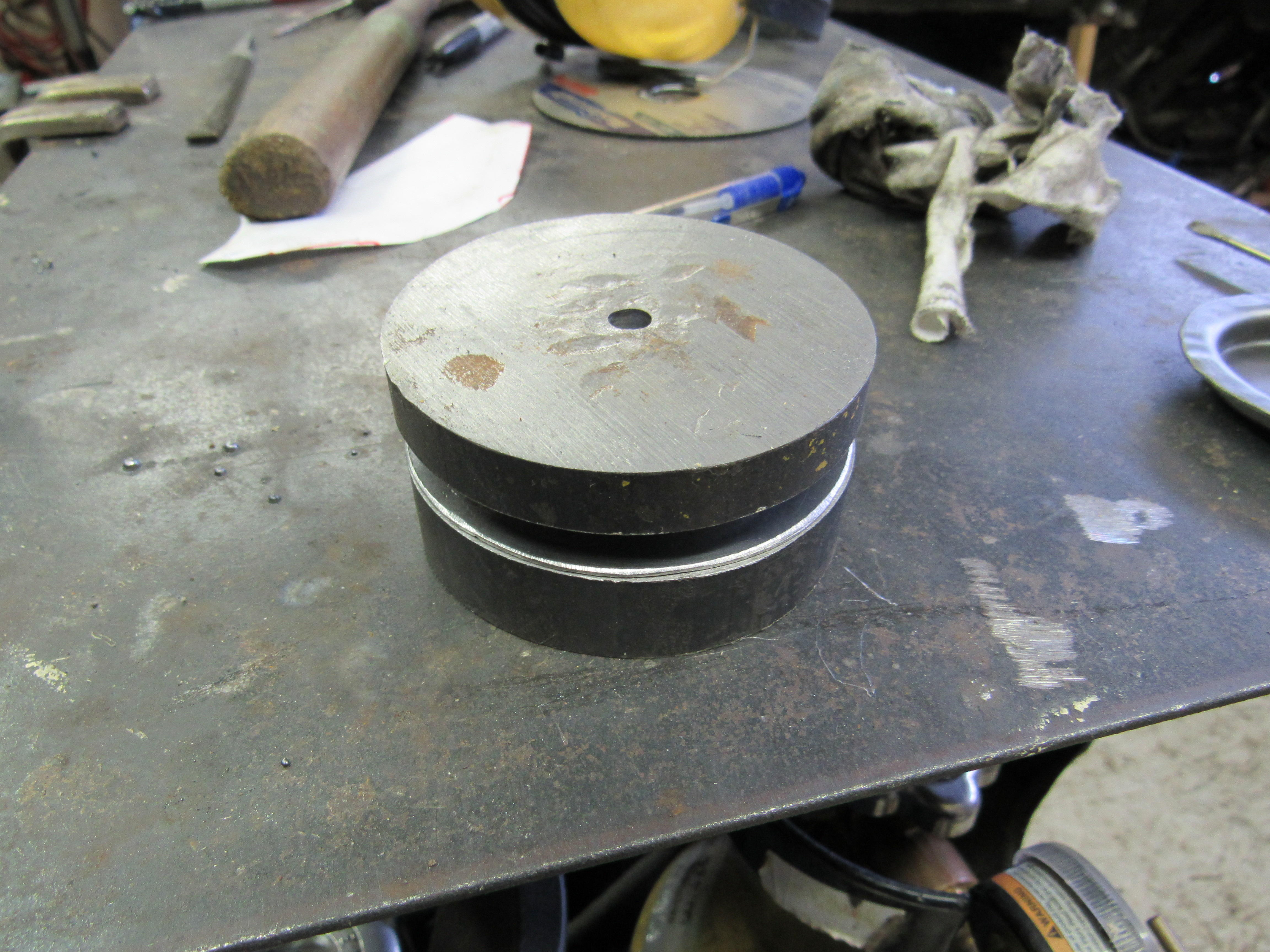

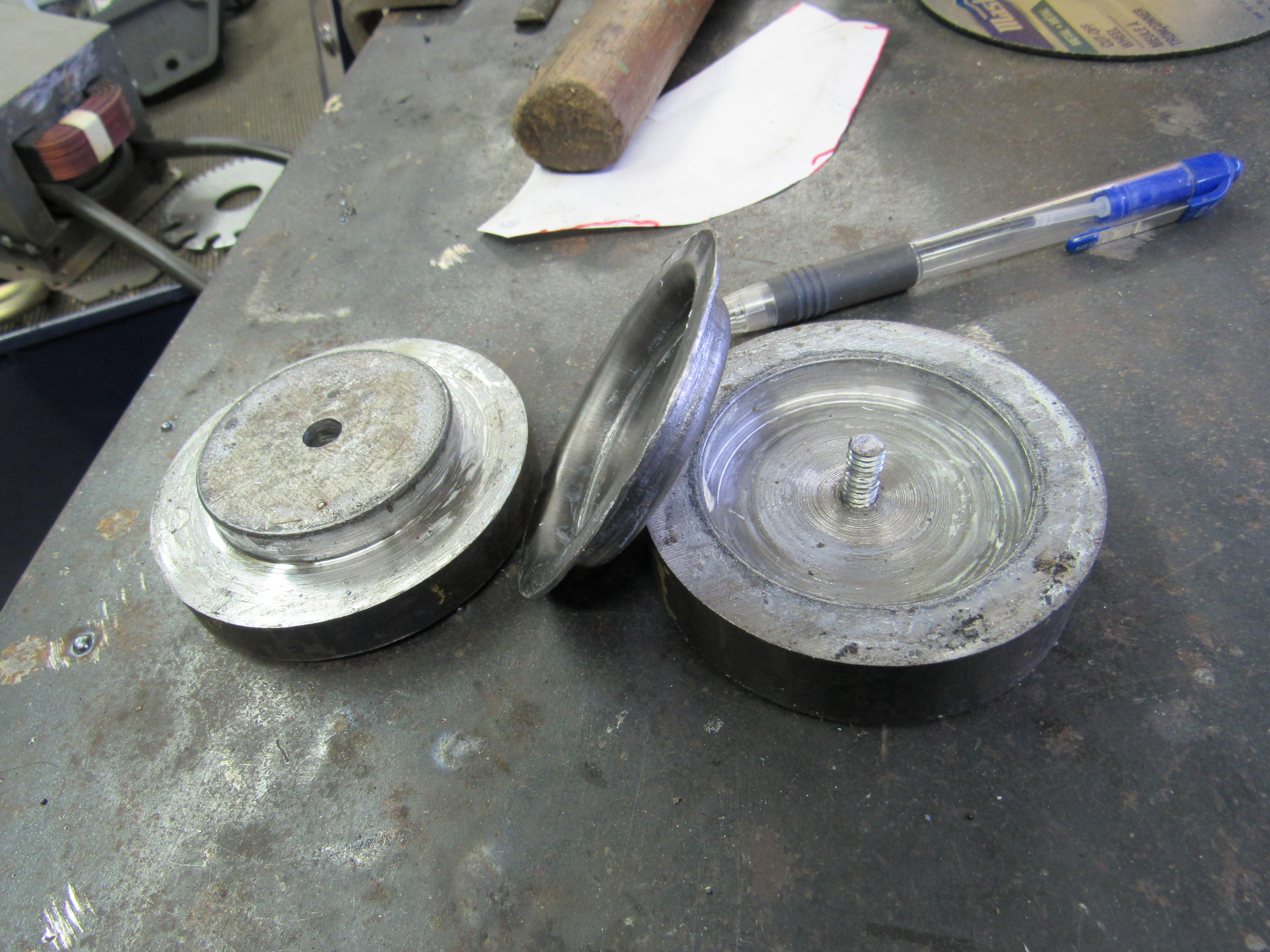

So I made up a two piece press on the lathe for shaping the T/C rod bushing collars, I thought at first my big vise would do the job but then ended up with the press on the anvil using a sledge as a hammer. The blanks are 16ga sheet metal, same as the originals.
If anyone has a need I can punch out a few more, start to finish, about an hour to make 2
