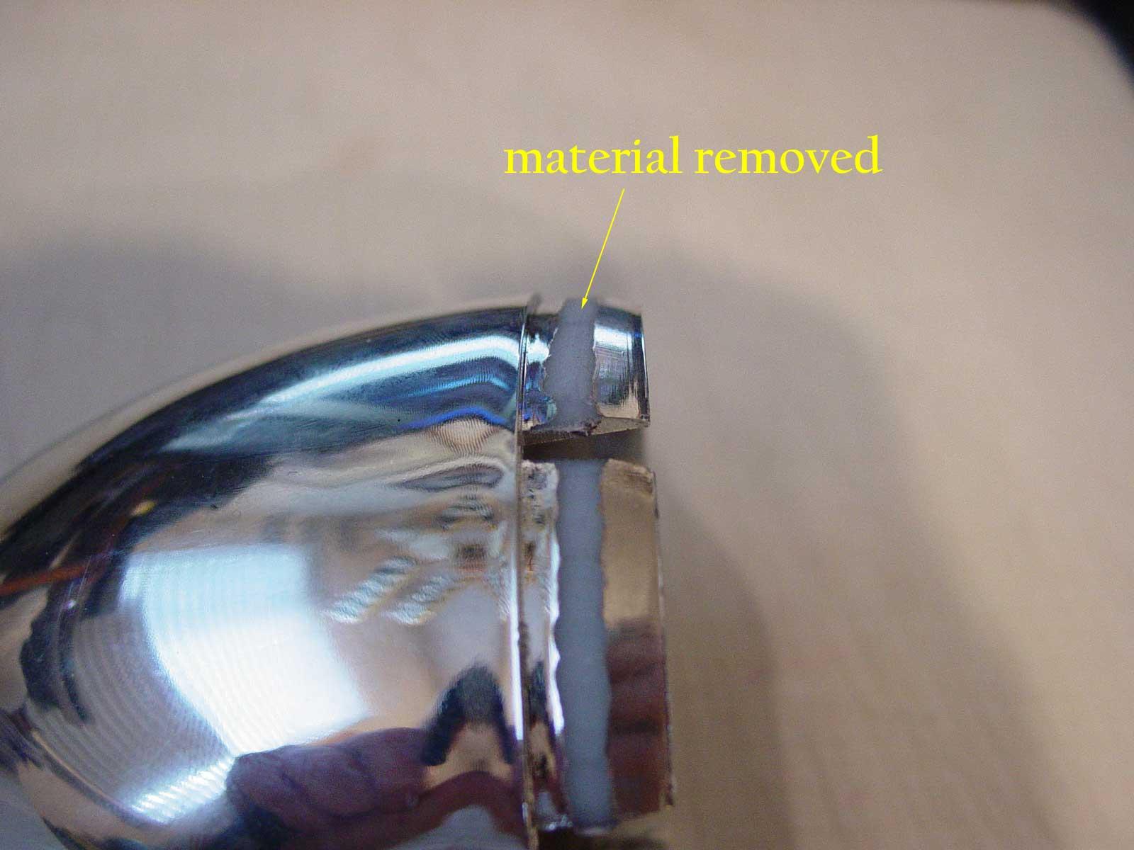

What I've discovered is that the caps have a range of interference fit and most of what I was finding, with new caps, was this interference fit was 0.055 inch. This fit would not work with my wheels  and I suspect with others. Anything more that 0.045 in and the fit was so tight you couldn't remove the cap by hand. I suspect that over the years the injection mold tolerance and thickness of copper /chrome plate have grown.
However, with the use of my magic grinder I took off 0.006 in and NOW it fits very nicely. So if your looking to replace or need center caps keep interference dimension fit in mind.

I haven't started polishing yet and wanted to make sure I had caps and lugs fit the 14"wheels. I did see the other caps on eBay , but they are slightly larger than the MSA. I could get the caps on without removing any material , but it took a rubber mallet to get them off. Also, the stress on the plastic over time might crack the cap. By removing a few thousands the caps fit just like OEM and are easily removed.

Those caps look exactly like the ones I bought, and they seem to fit the same way.  My wheels are the mesh type, but the center and lip of the rim look exactly like yours.  So, I am pretty sure they are Western, that's what I wanted a picture for.  I think if I ever buy any more caps for these, I will shave them down like you did.  They have been in the wheels for a couple of years, and I popped them off one time to change tires.  No cracks so far.  Also, I was sent a little "Z" sticker with the caps, but I didn't put them on yet.

I'm sure each wheel is slightly different ( center hole) and maybe the cap dimensions might have have grown over years of production. I could get mine on without shaving them down, but like I said a mallet was needed to remove.
