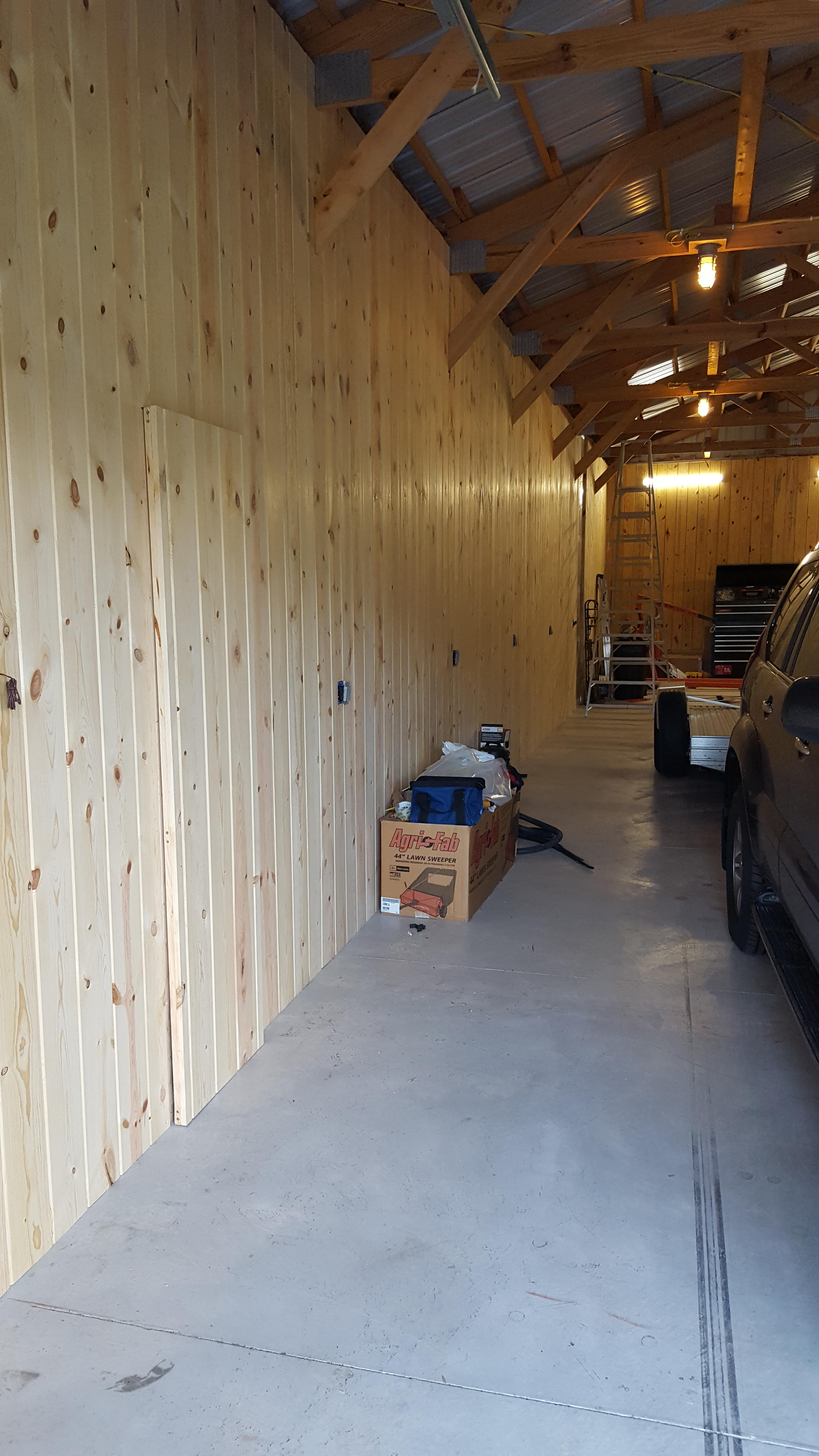

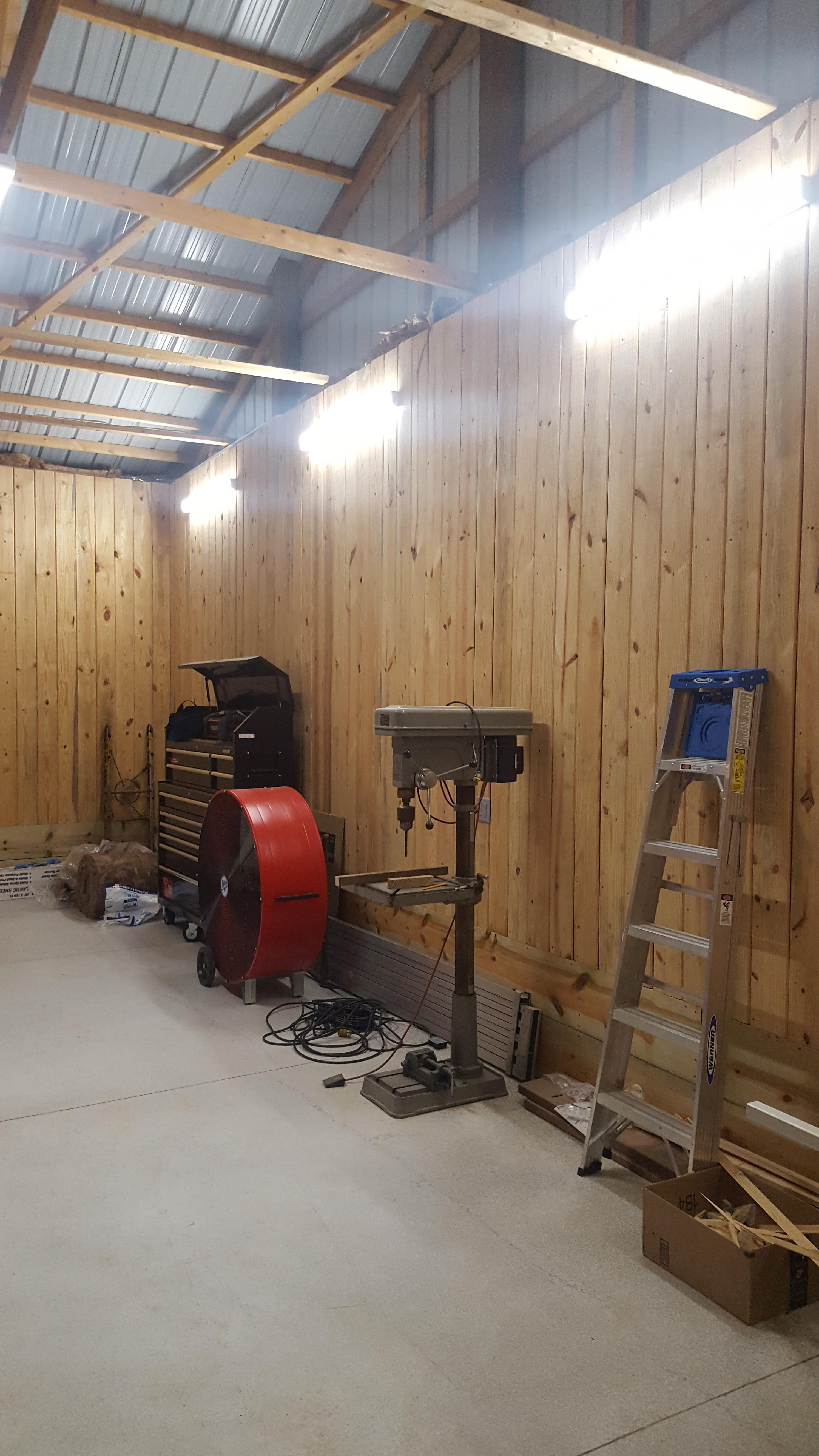

The wiring, vapor barrier and walls are all done. I fired up the LED lights at the back wall to see how bright they are.  They should work out pretty nicely, especially with a white ceiling.

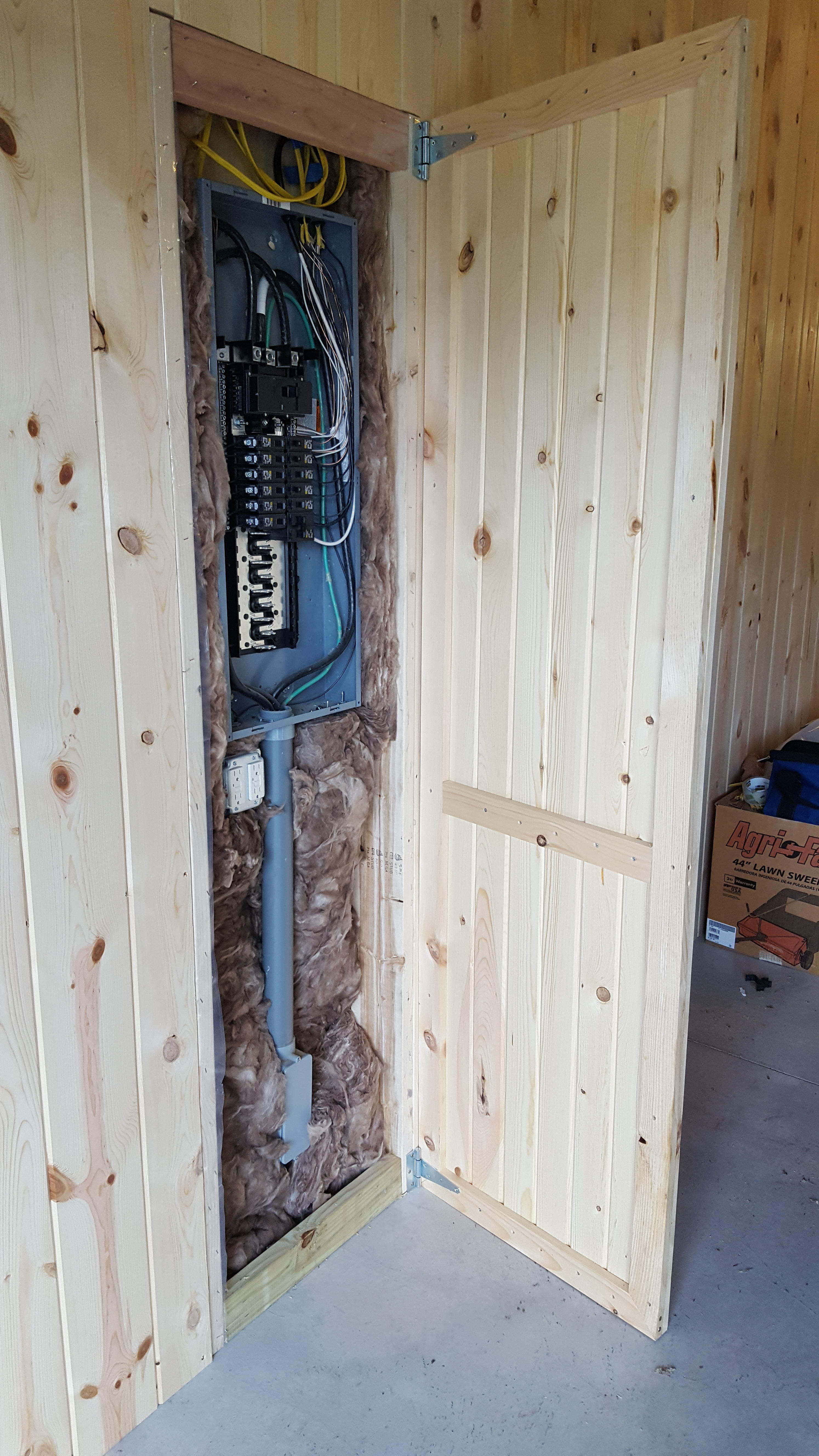

The walls turned out really nice.  I built a neat access door to cover the power panel out of the same boards.  It blends in so well, you almost don't notice it.

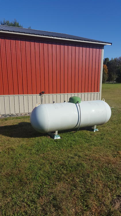

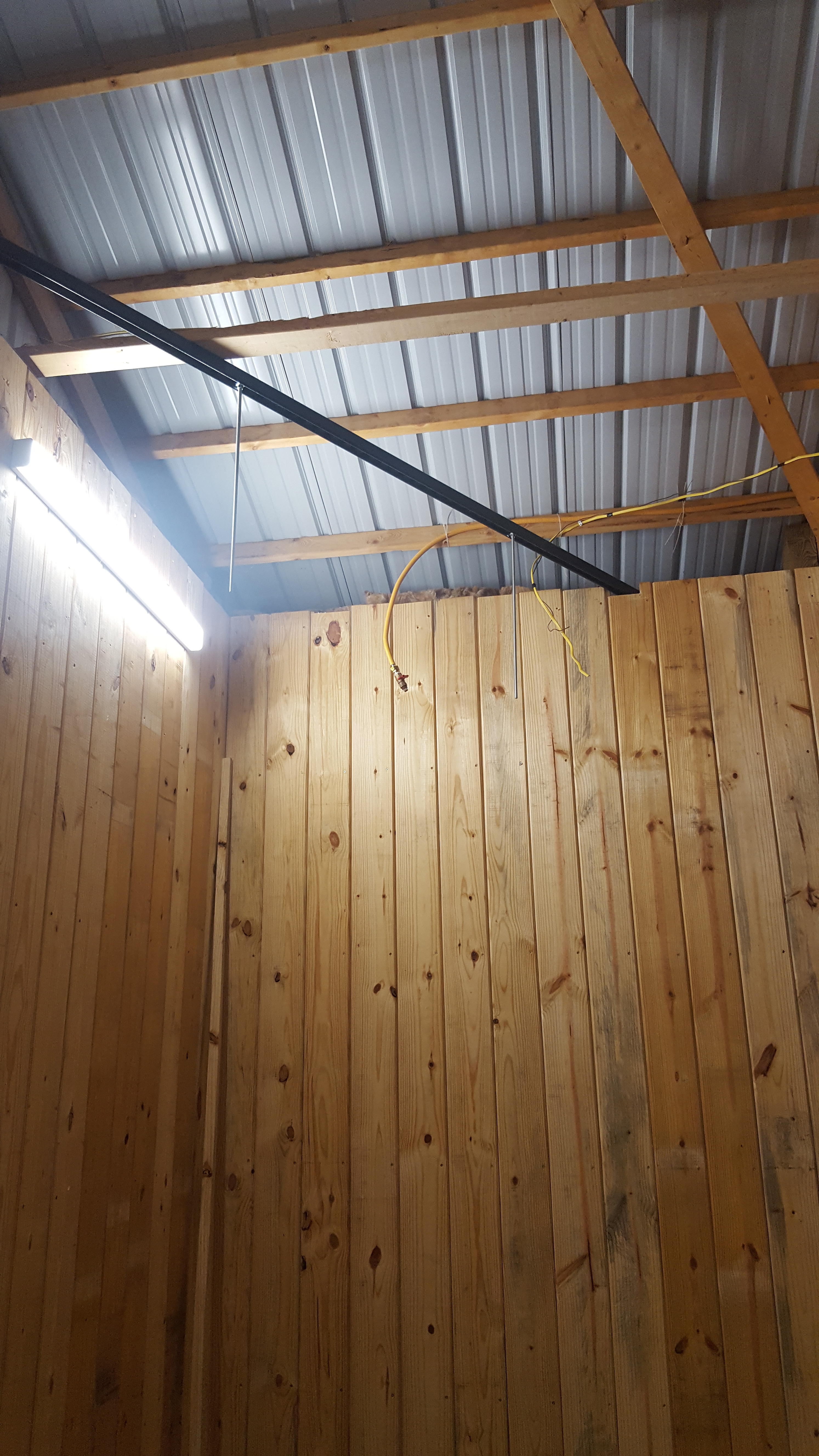

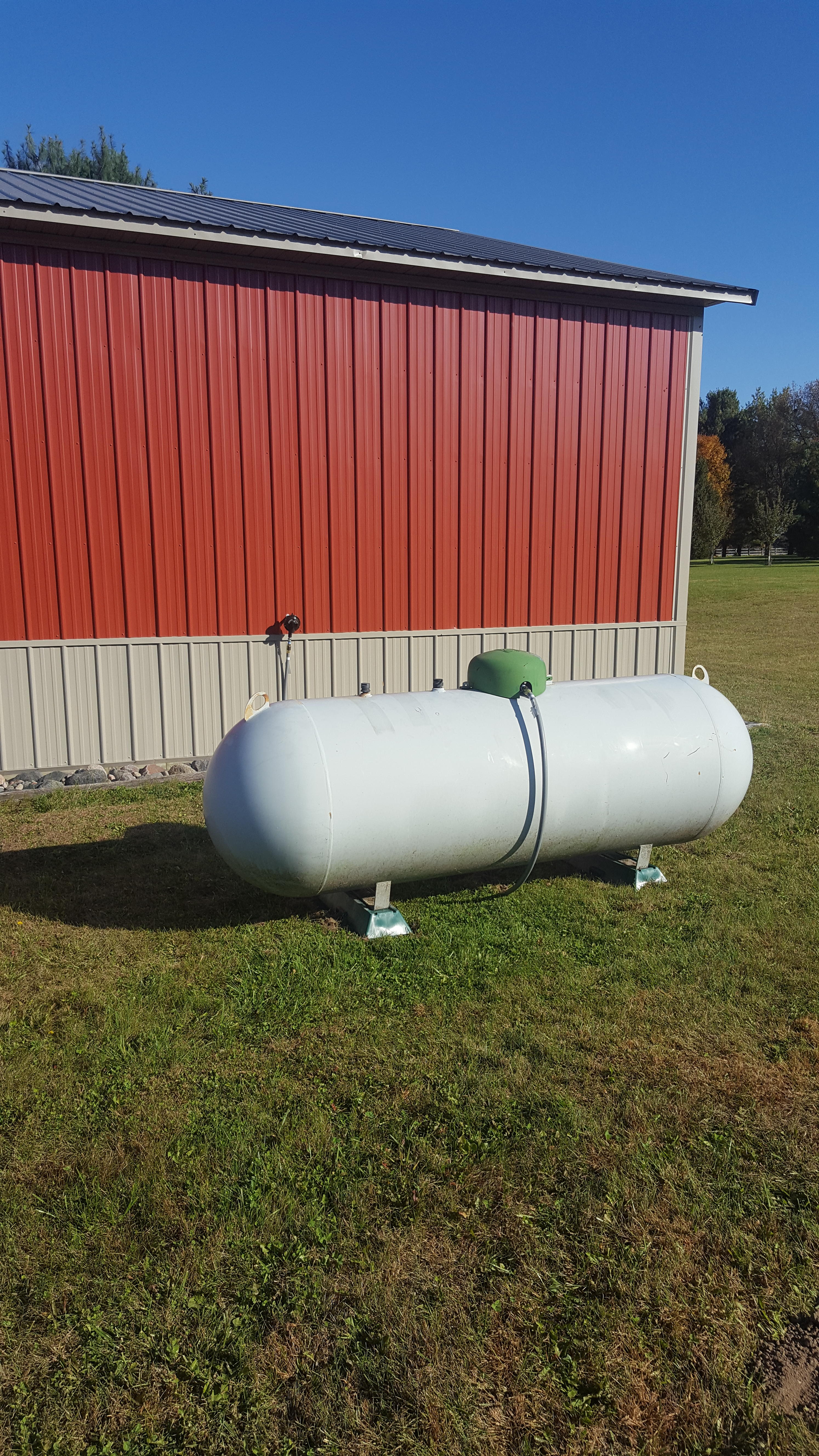

The piping, wiring and structure are installed for the 125K Modine unit to hang from the ceiling.  The propane tank was delivered and installed on Friday.  Unfortunately, the ceiling contractor is backlogged until February or March.  He said he would try to work me in on bad weather days when his guys can't work outside. If it wasn't for that delay, I would have been right on time to get it heated before winter.

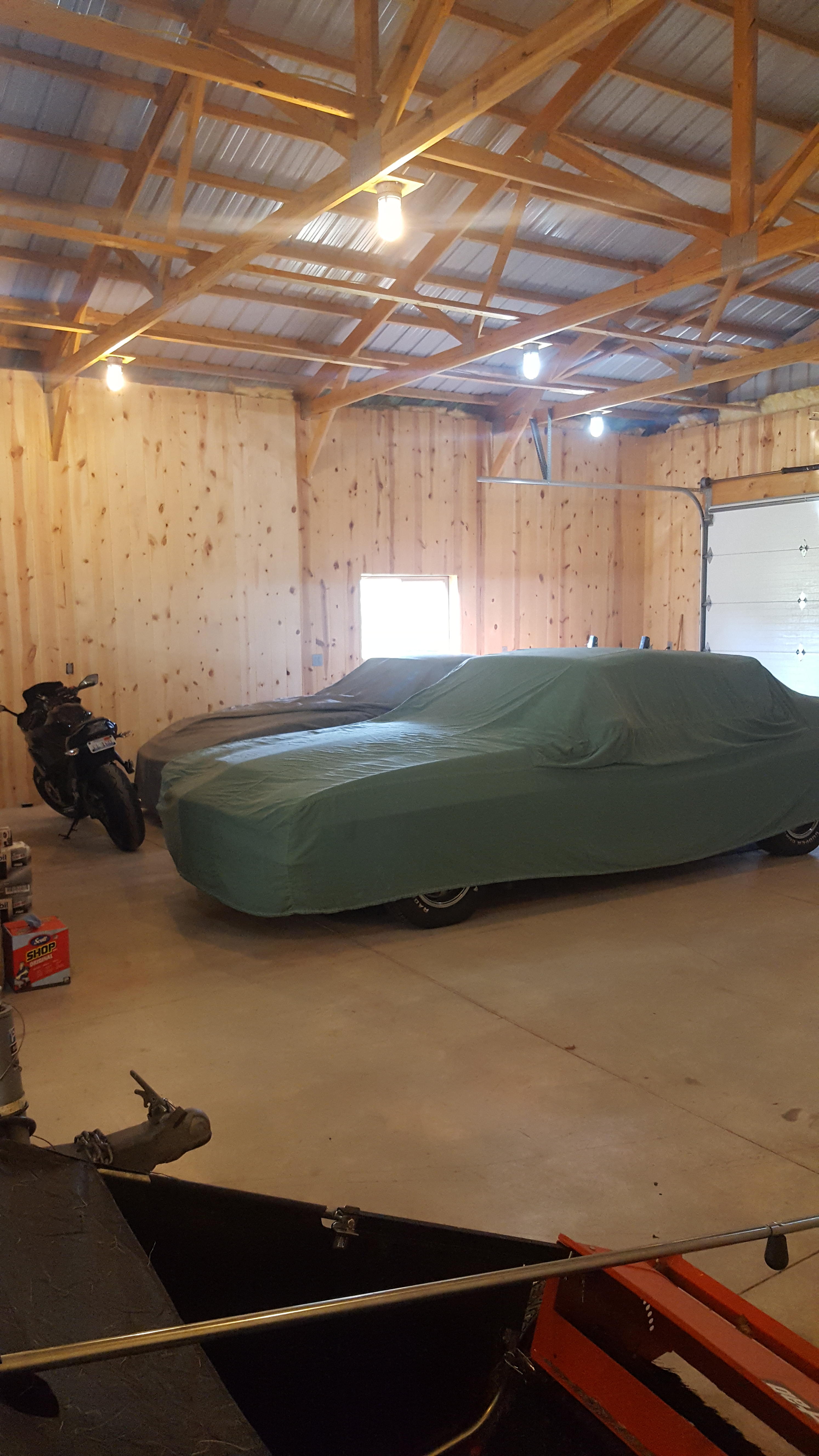

Well, I have done as much as I can do until the ceiling is installed.   I really can't wait to get it done, so I can start organizing the place.  All of my car parts and supplies are just piled in the center of the barn right now.
