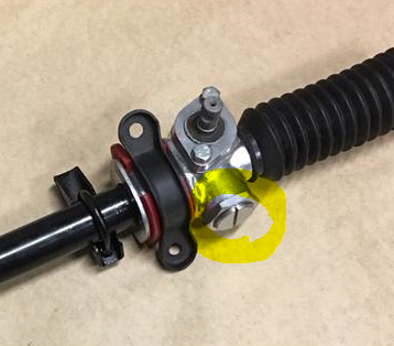

Lock to lock could be separate from ratio, maybe.  Not sure exactly where the stops are but aren't they on the hubs?  280Z hubs different from 240Z.  Different knuckles.  Shouldn't we just measure the ratio?  Not sure how to make that a one man operation.

Yes, lock to lock can be different from ratio. The stops are on the rack. The rubber washers bottom out on the ends of the rack housing at each lock.

So according to the parts breakdown, all of the 240's used the same rack gear and pinion gear set from inception until summer 73 (7307) when both the rack and pinion gears changed part numbers. And then from that point forward until the end of the run in 78, everything used a new pair.
In other words... The 240's used one set of rack and pinion gears, and the 260s and 280s used a different pair. At the same time is when they changed the whole rack housing to the newer style with the wider bushing groove. That could certainly explain differences in steering ratio or L-L between 240 and everything later.
But based on the part numbers, I think the 75 and 76 steering is identical to the the rest of the bunch from 74 through 78 and there are some documentation issues that make it seem like they are different. I don't think they are.
And.... None of this explains why my steering is so much heavier than my buddy's 260.
I really don't think so. I don't think that tension adjuster really adds that much friction. More just to keep the rack loaded under all conditions so it's not so floaty? Mine is adjusted according to the manual and the spring is not binding. Other than that, I don't think it's that much of an impact.
