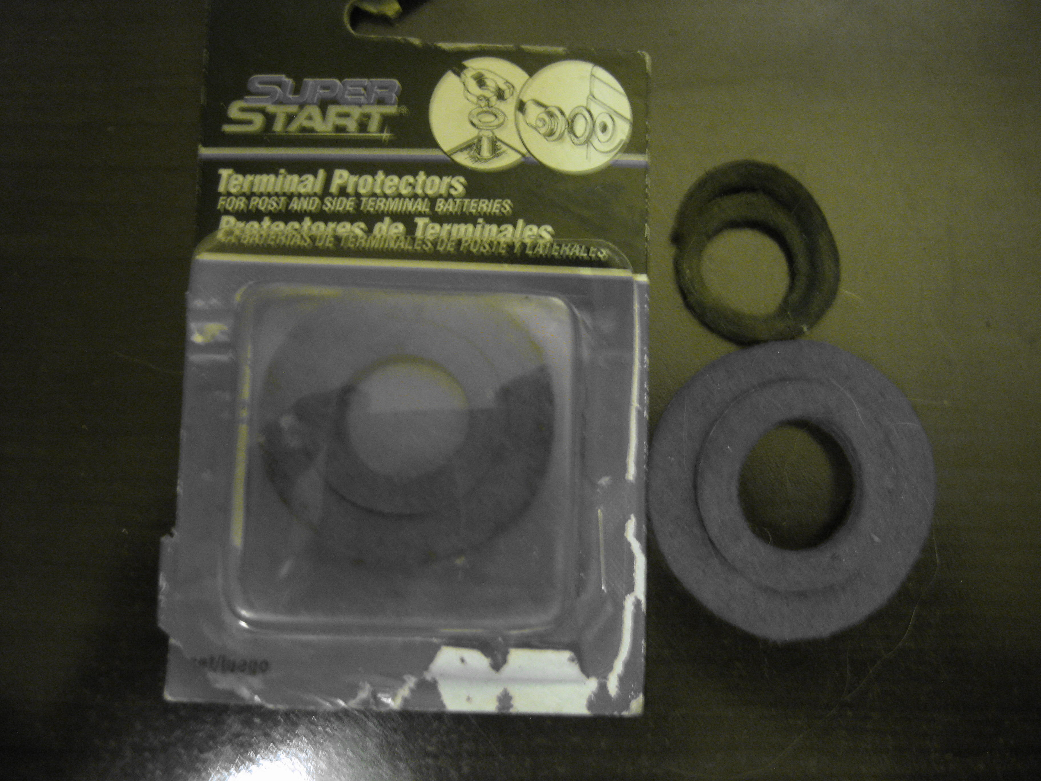

Zup Posted December 7, 2018 Share #2 Posted December 7, 2018 @Randalla I used the circular anti-corrosion felts for battery terminals. They came pre-punched for the terminals to pass through. They came several to a package and although they were Christmas-y, (red and green), they worked well for me. I slathered them in Lubriplate bearing grease, working it into the felt and then re-assembled. Four years later the refurbished wipers work as new. 1 Link to comment https://www.classiczcars.com/topic/61211-rebuilding-wiper-mechanism/#findComment-563219 Share on other sites More sharing options...
Randalla Posted December 7, 2018 Author Share #3 Posted December 7, 2018 Great idea! I assume from the picture that you just used the inner felts. Appreciate your response as those are readily available. Link to comment https://www.classiczcars.com/topic/61211-rebuilding-wiper-mechanism/#findComment-563224 Share on other sites More sharing options...
