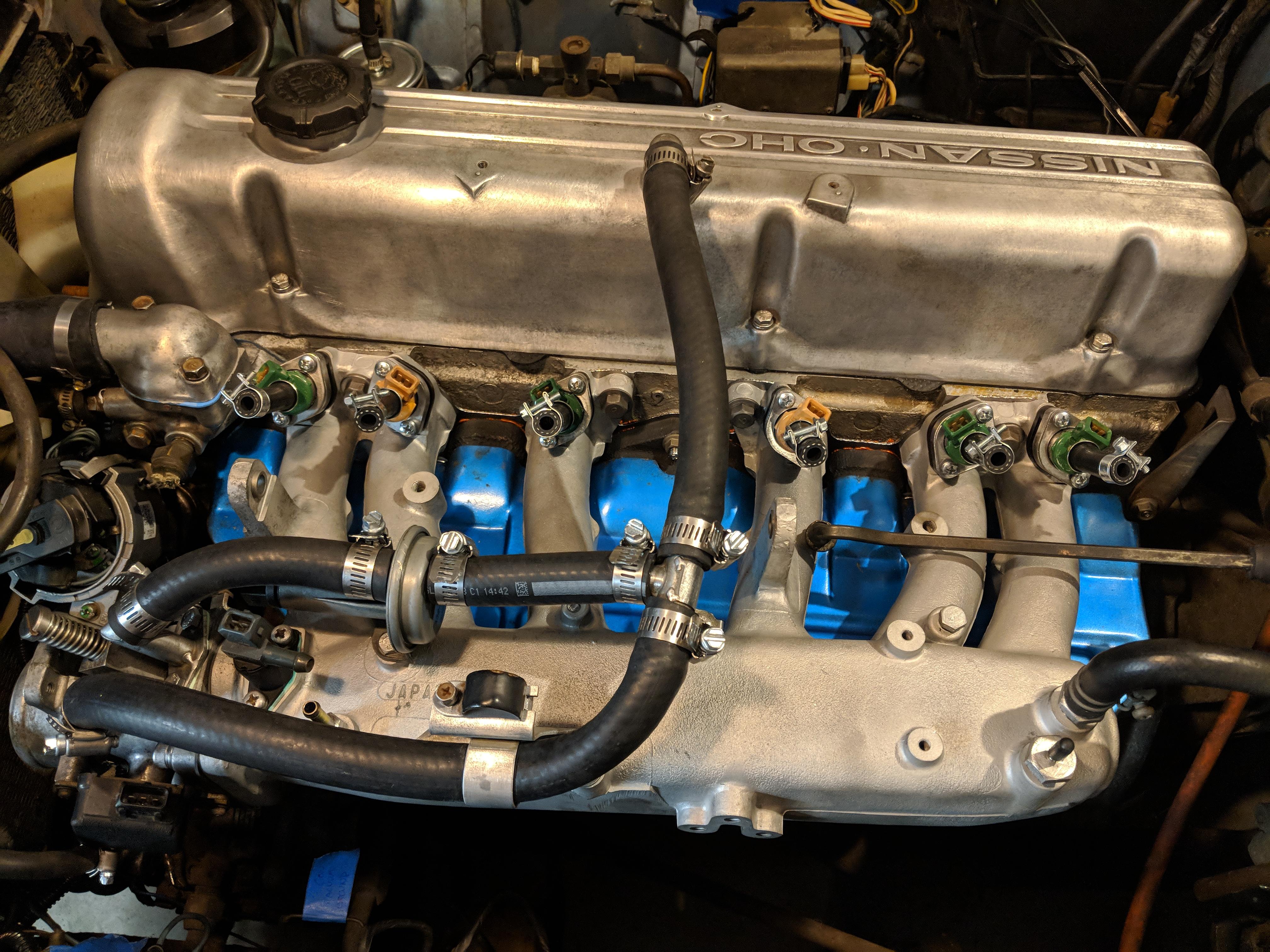

Are the injectors the stock "green top" injectors?  And have you measured the resistance of the coolant temperature sensor?  That test is in the EFI Book.  Could be that the PO installed "turbo" injectors.  Never know.  Or adjusted the AFM.   Or that your coolant temp. circuit is open.

Injectors are all fresh refurbs from RockAuto; I ordered all 6 at once.  4 came in 'green top', and 2 are kind of a beige color.  I figured they were equivalent.. might be a bad assumption though.  Picture attached
