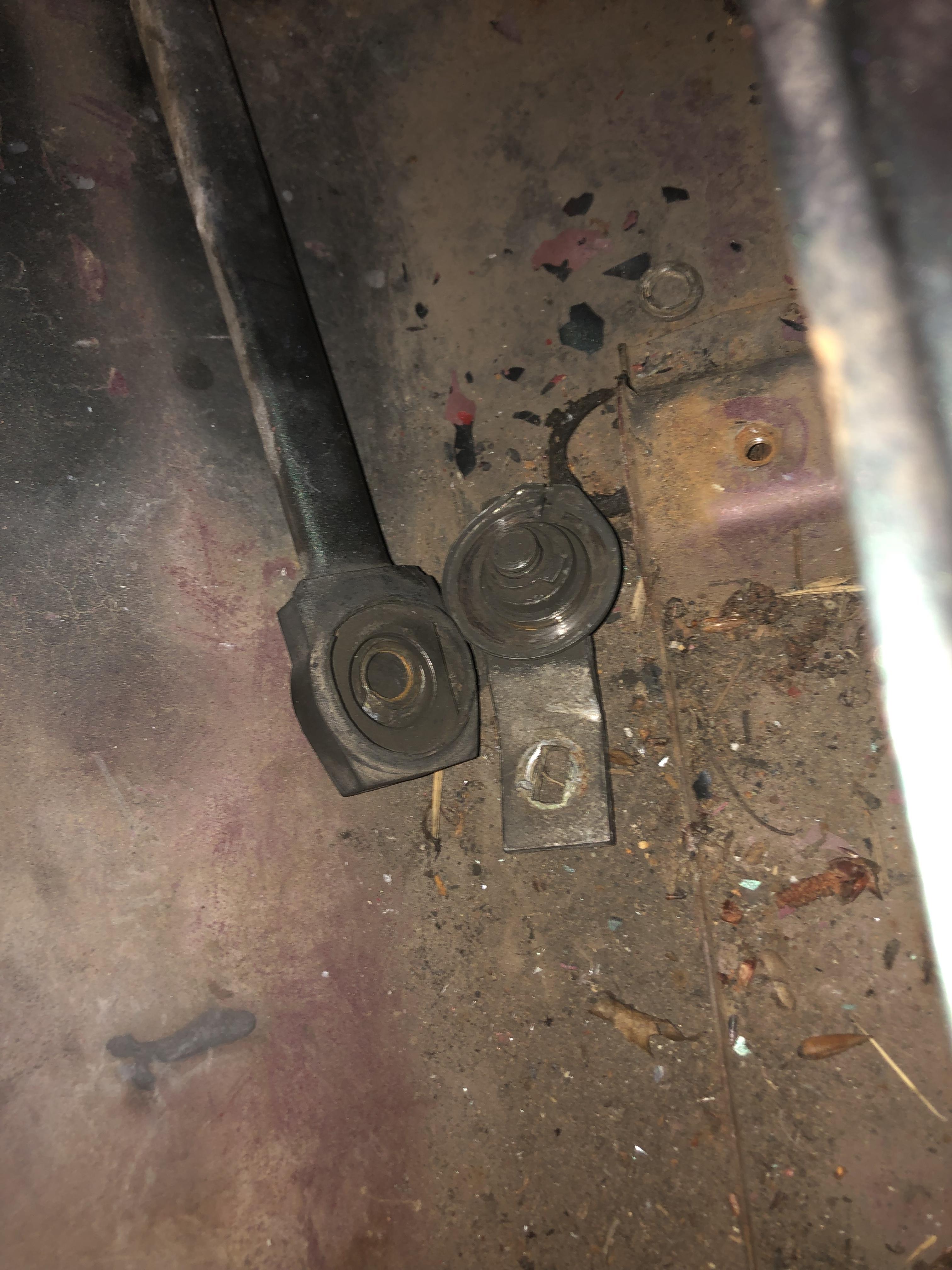

Hey guys, my wiper motor gave out while driving my Z home in the middle of a huge rain storm. Was a terrible time getting her home safe and never want to do that again. So I started the Honda motor swap, but once my center wiper linkage came off, I can’t figure out how it went on in the first place. I feel like I am missing some parts. Anyone know how this thing goes back together? Is there a section of the FSM I am missing?

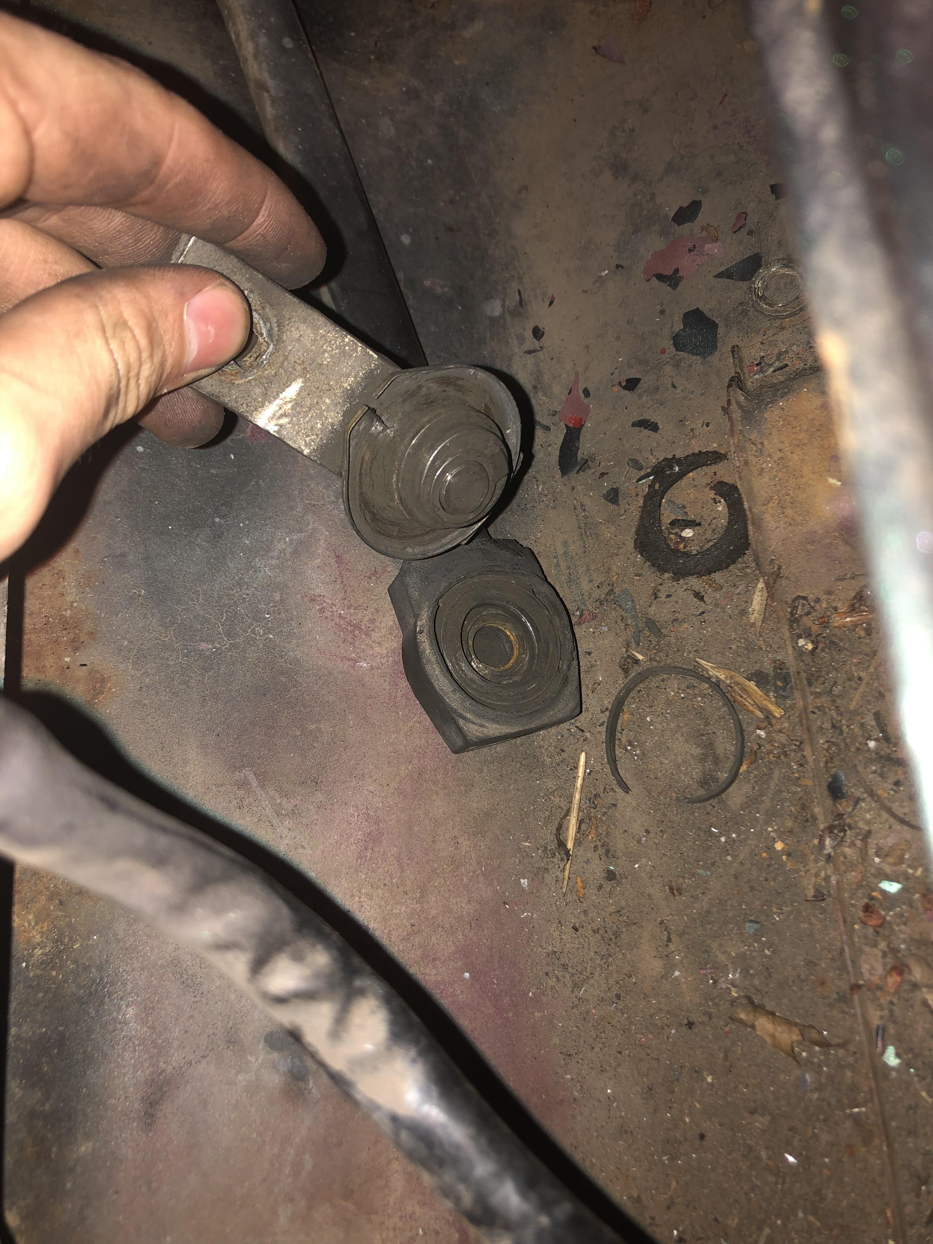

Someone has been in here before me, the linkage moves very smoothly without any problems. I don’t even think my wiper motor died. I just think the linkage broke in the center there
Does anyone have one of these center linkage pieces they could sell me? Also I read somewhere that there’s an E clip that holds it together and I could just find a new one and put it on. Anyone know what size? And how to install.

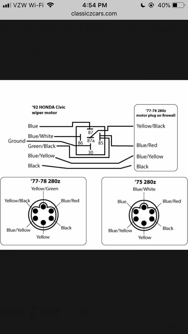

1. My 78’ 280z wiper motor wiring is completely different from the FSM! The FSM shows yellow/black, blue/red, blue yellow, black. I have yellow, blue/red, blue/white, black, then two more black! The wiper motor in there was not stock and those two extra wires were going directly into the side of the motor. I followed the wiring diagram, just supplementing blue/yellow for blue white and the wipers work. But only at one speed. Any ideas? I followed the wiring diagram. Bet it has something to do with those two black wires. Edit: If I could find a chart showing voltage of each wire that would be very helpful
