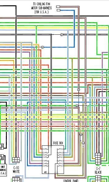

Well, I looked at the harness I removed from my first '77 (splices and cuts everywhere), but could not find any EXIT point of the harness of the WHITE/RED STRIPE and the BLUE wire, noted as "FOR U.S.A." on the wiring diagram.
What's even more confusing, and I double checked the original black and white from the FSM, is that both aforementioned wires are fused from opposite sides of the fuse box. Didn't realize that until just now.
@Captain Obvious, @EuroDat, does that make any sense to you? I poured through the FSM and could not find any written documentation regarding this, even in the AC supplement (I had thought it may have been part of the AC sub-harness, but the FSM does not explain it, it only shows it on the fold-out diagram in the back.....
Edited by wal280z
forgot to attach diagram snip
https://www.classiczcars.com/topic/61285-fan-quiz/#findComment-564336

I reattached a couple of my previous pics here... The two connections for that sub-harness are under the dash above the passengers right knee. Tucked up to the right of the glove box:
  • Thanks 1
https://www.classiczcars.com/topic/61285-fan-quiz/#findComment-564339
Dang, I just realized my goof - I was looking at the ENGINE BAY harness, not the body harness INSIDE the cabin (as the diagram does show)
6 minutes ago, Captain Obvious said:
Thanks @Captain Obvious for clearing up my confusion.....
https://www.classiczcars.com/topic/61285-fan-quiz/#findComment-564340
